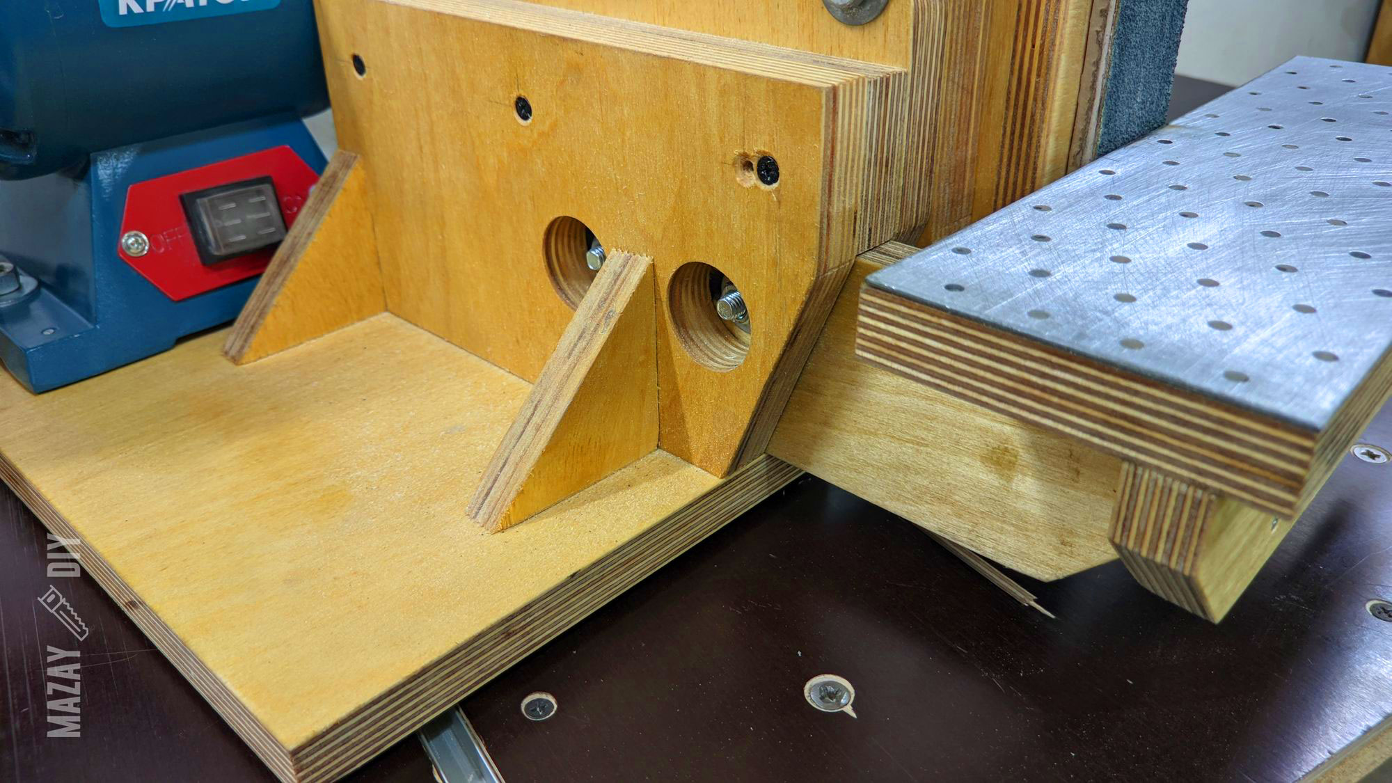

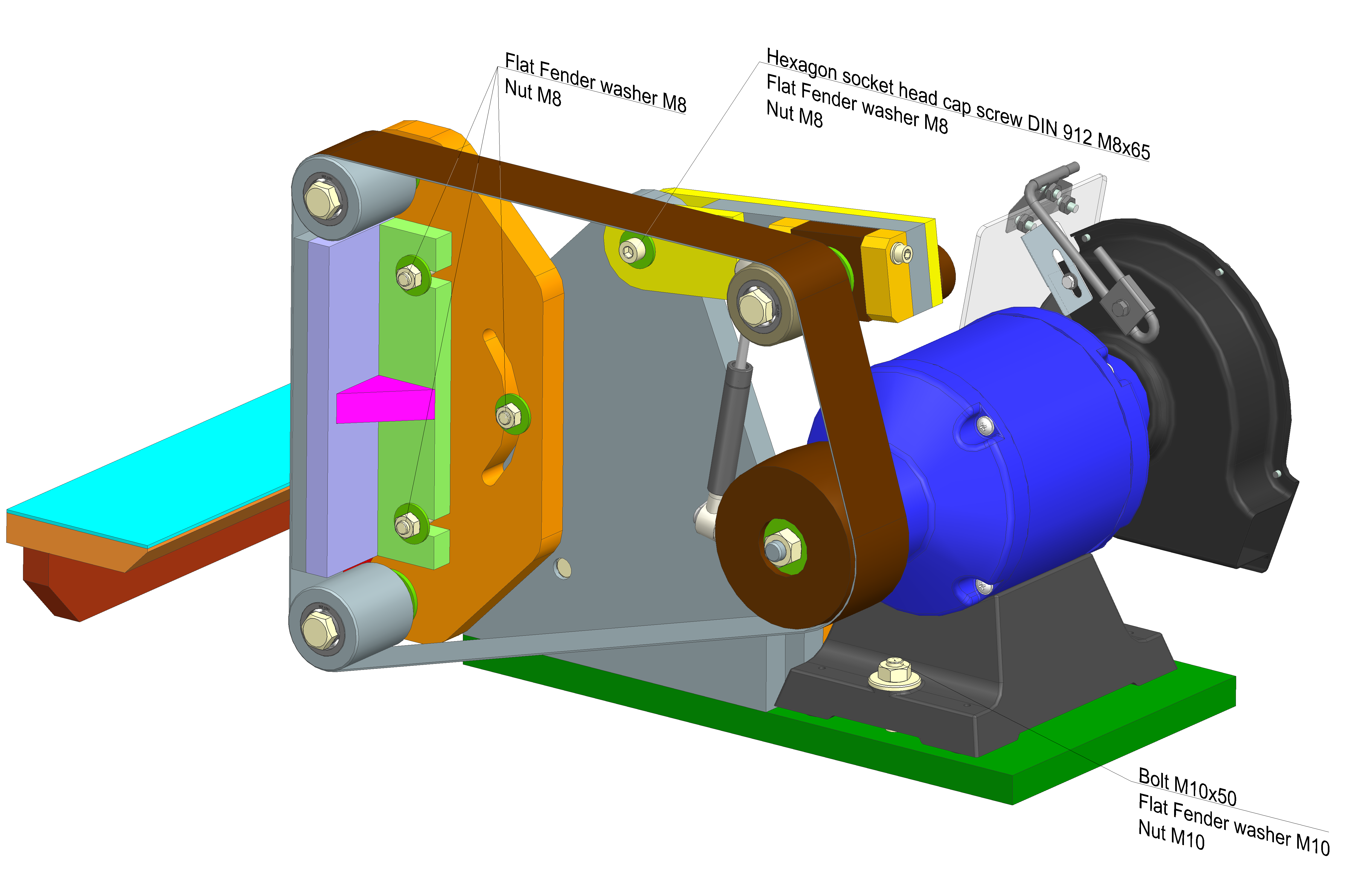

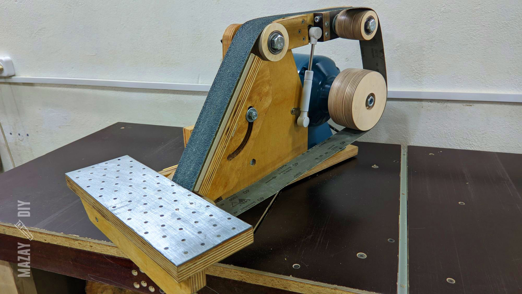

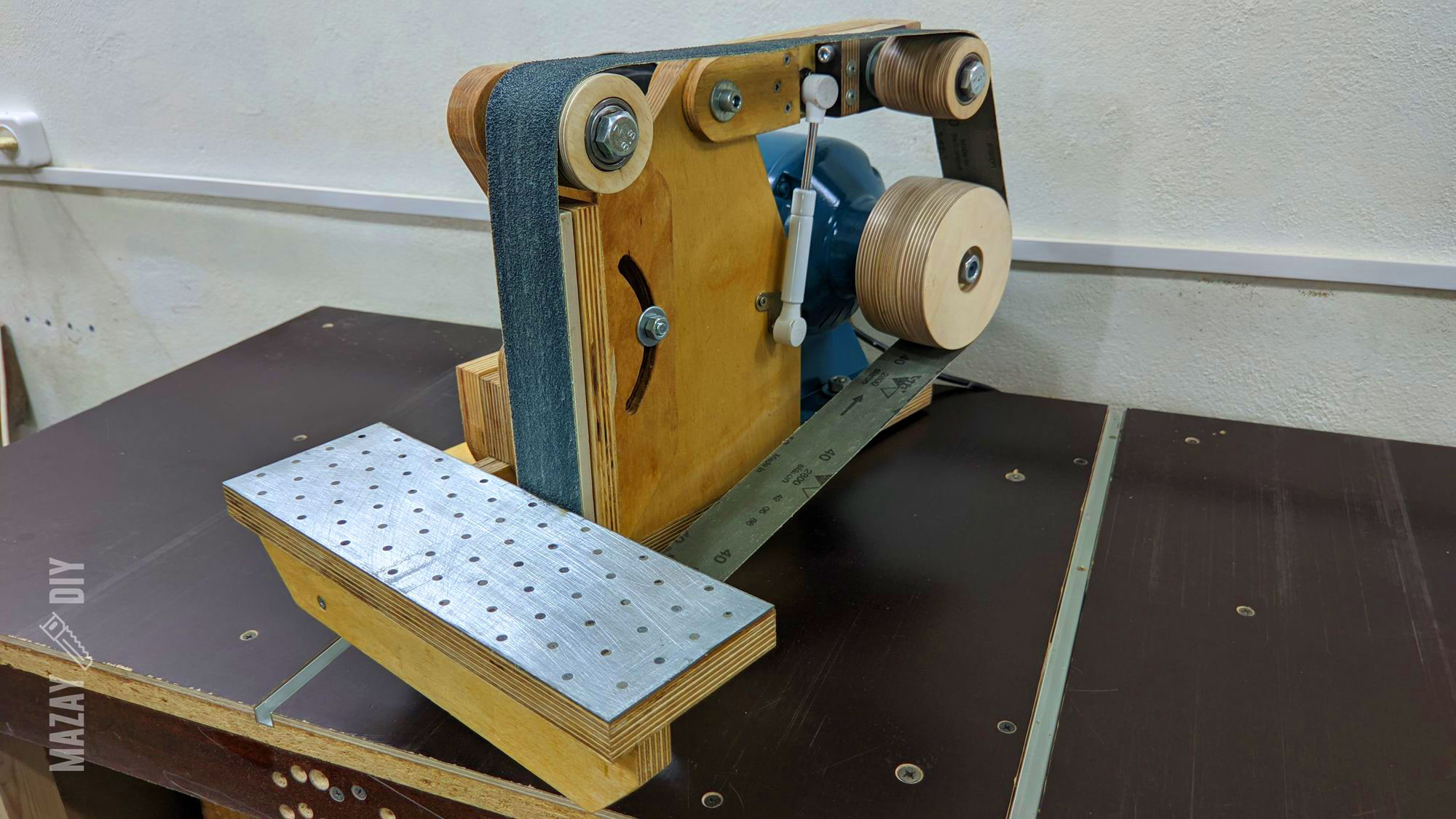

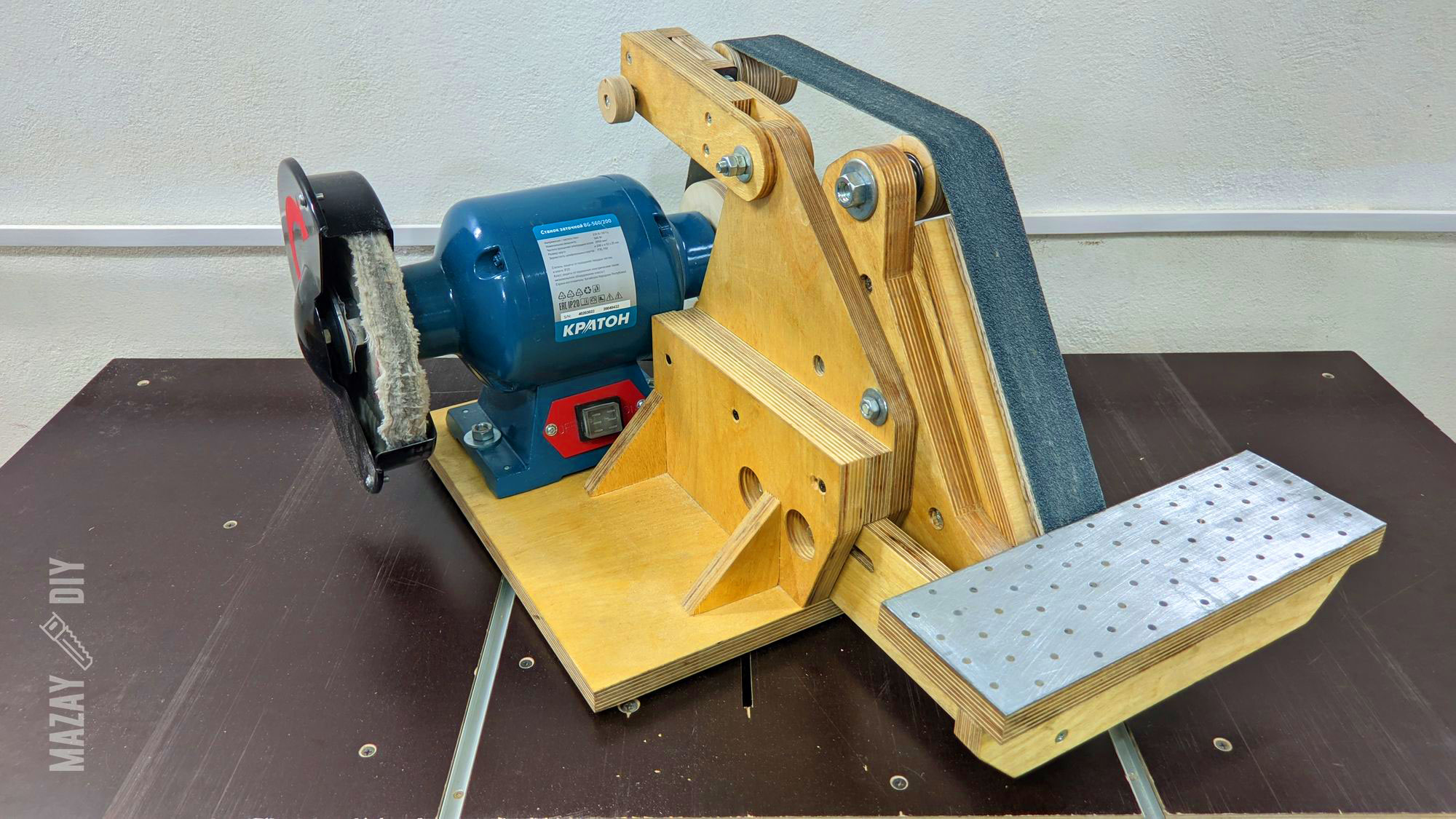

Making 2x48 belt grinder from bench grinder.
https://youtu.be/FlPvAjcIano
Turn your bench grinder to a belt sander!
Attachment 42708 Attachment 42709 Attachment 42710 Attachment 42711
