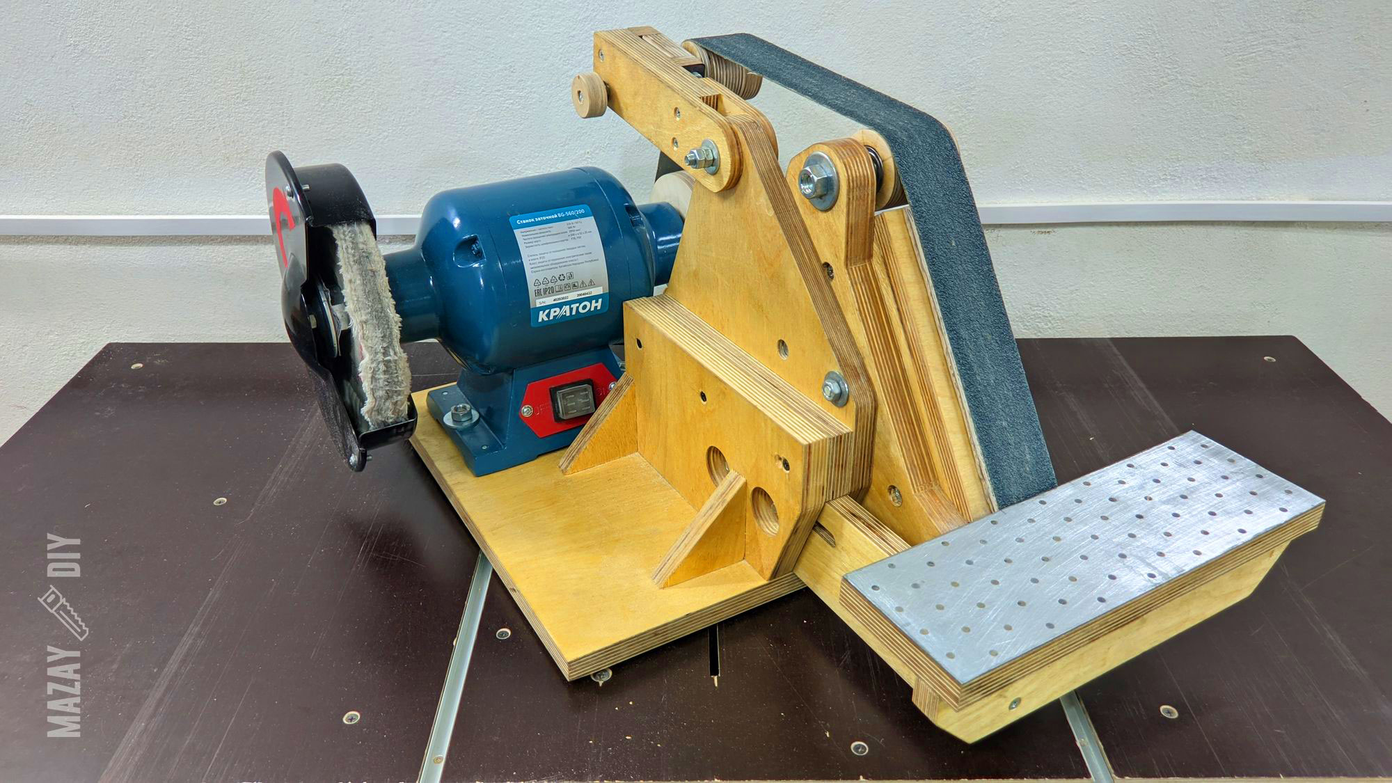

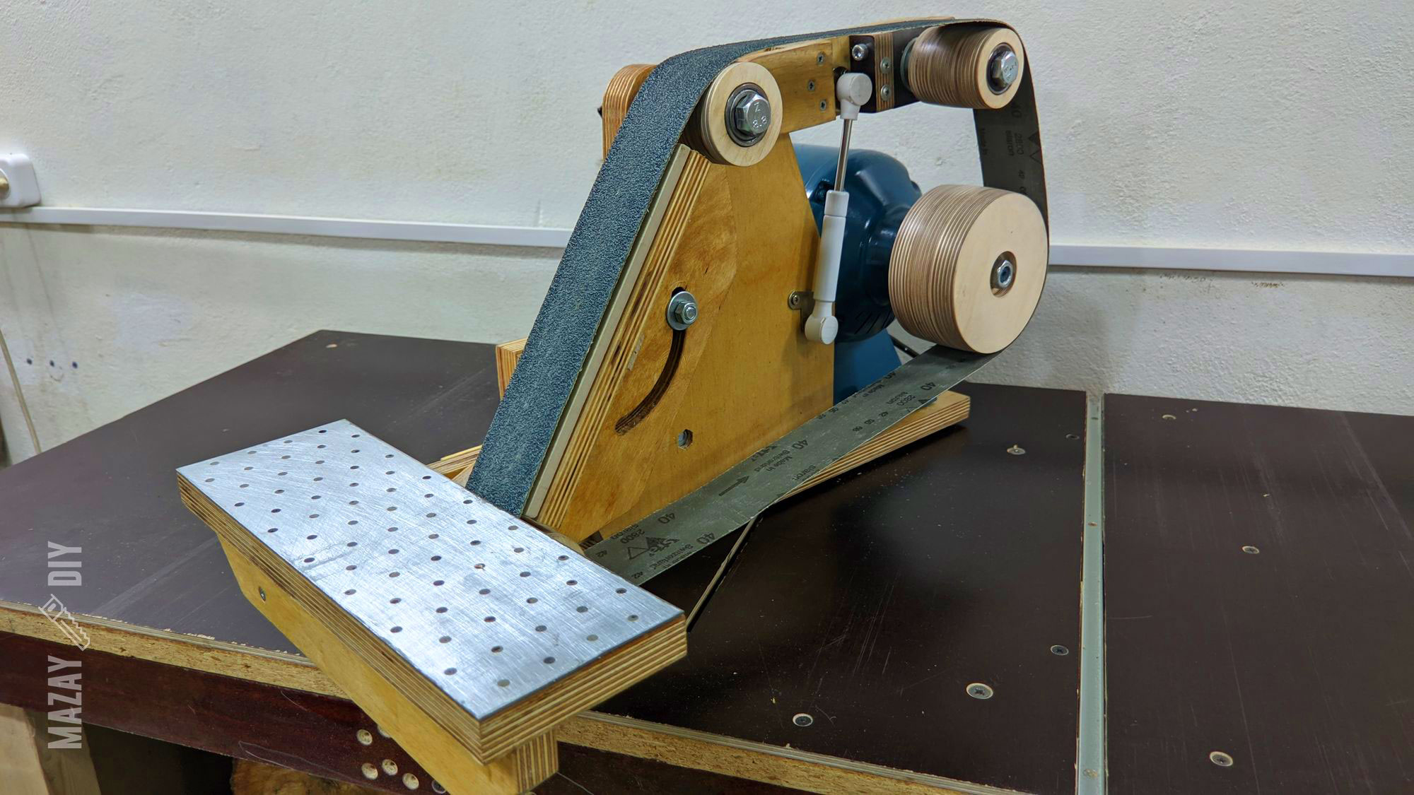

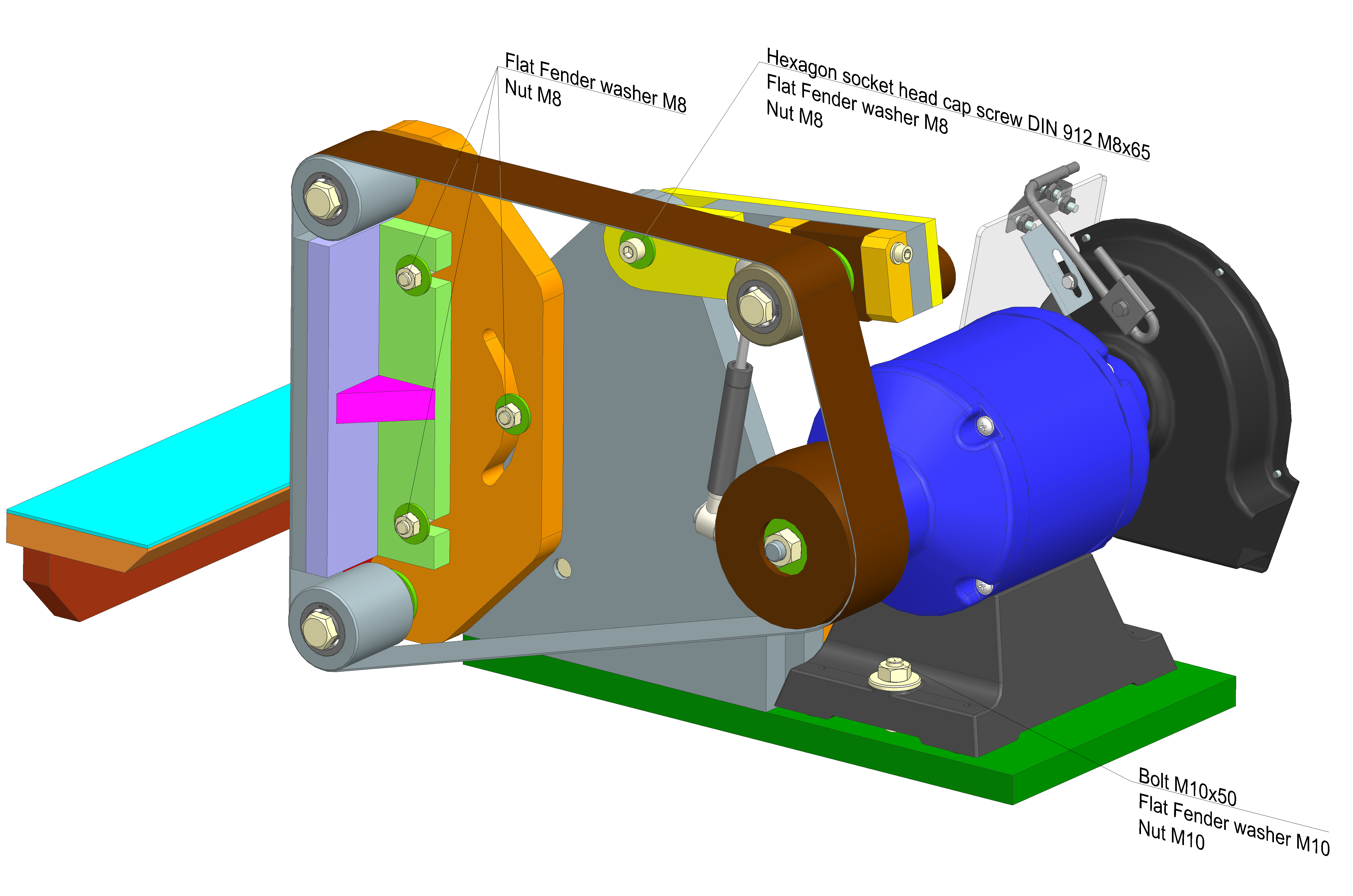

    Making 2x48 belt grinder from bench grinder.
    Turn your bench grinder to a belt sander!
