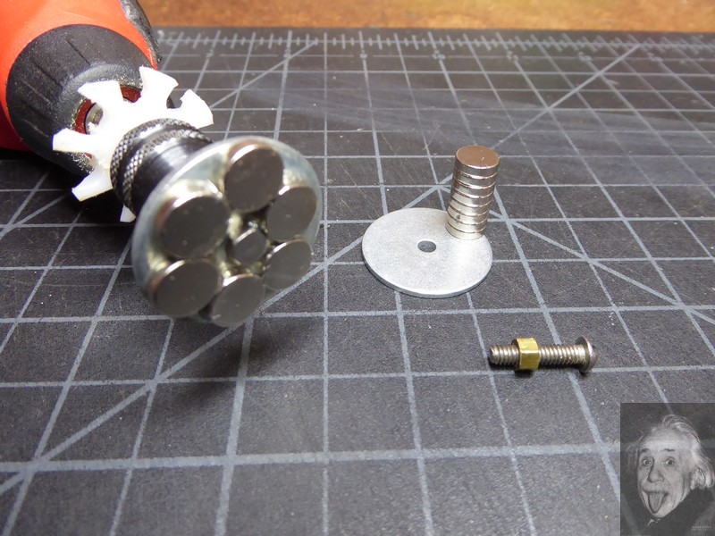

I had to have a miniature version for my in-house small job bench. Beyond its undeniable coolness, it would save me the trip to the garage to retrIeve the soldering gun and could be spun with any of the Dremel/Foredom-like tools lying on the bench.
I was fortunate to have some 1" fender washers with a 1/8" hole that just fits a 5-40 screw to provide a shaft to grasp in the Dremel. Six Harbor Freight 5/16" diameter super magnets were epoxied to the washer in an alternating polarity configuration.
Spun at even a low speed, it does a fine job of demagnetizing small tools.

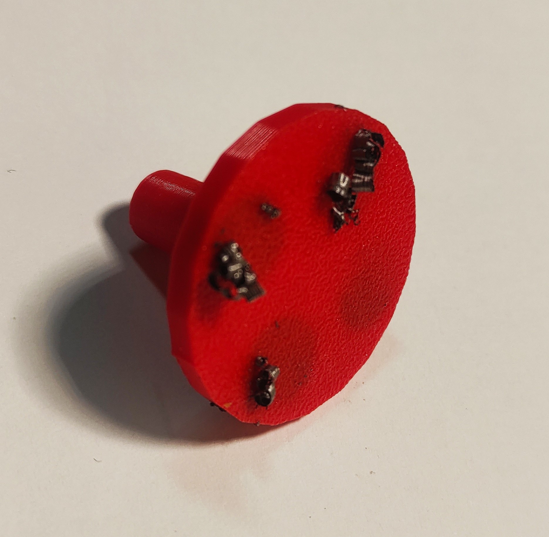

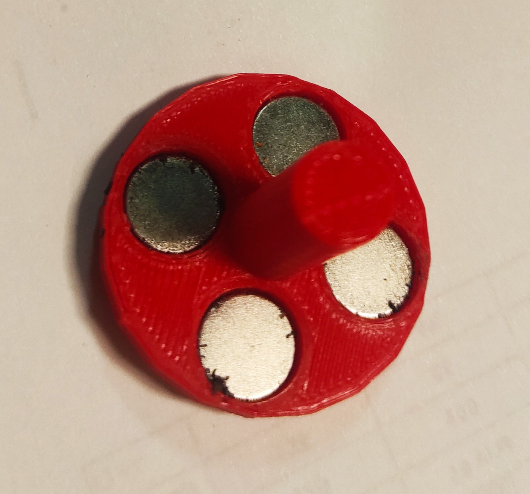

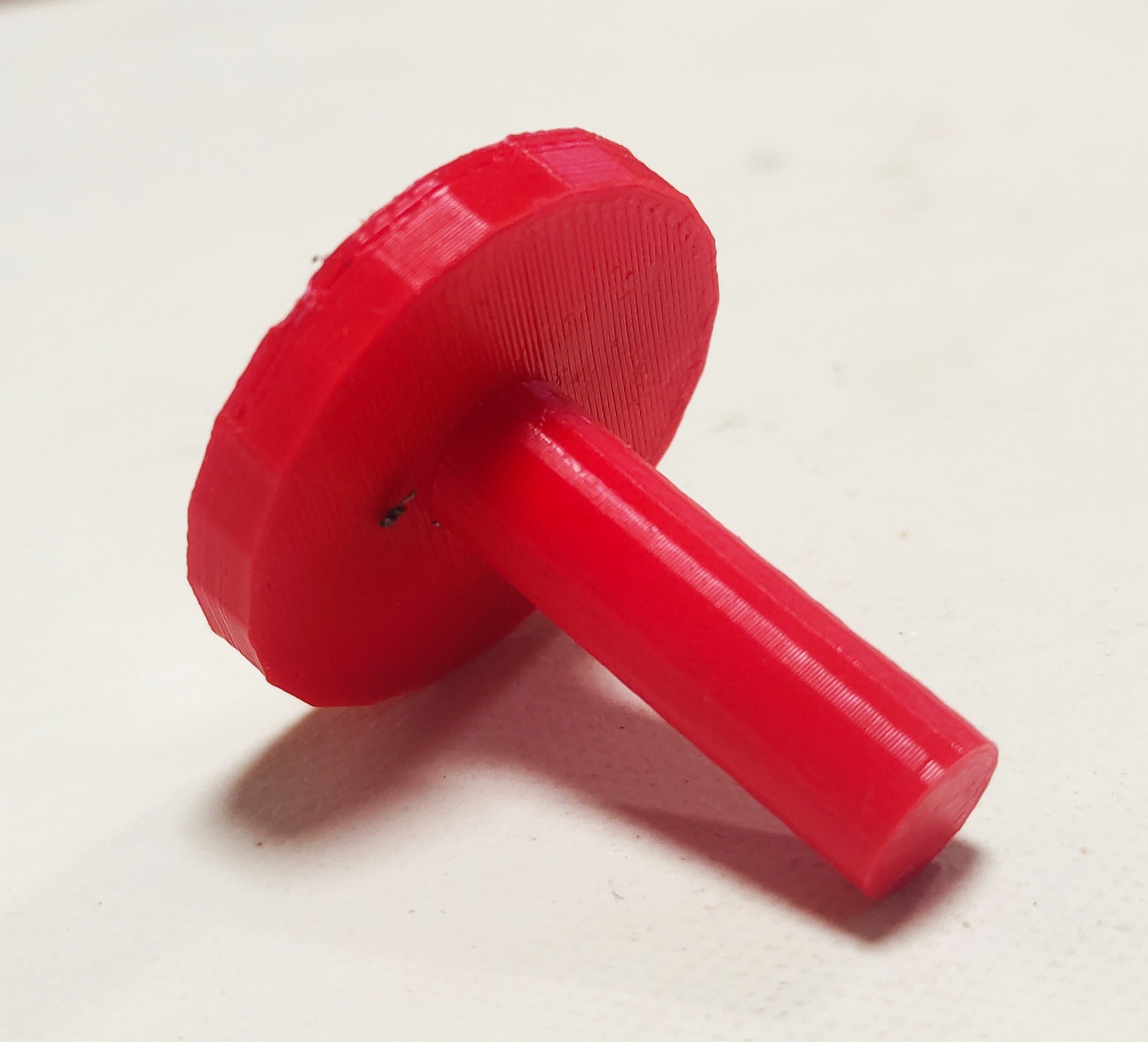

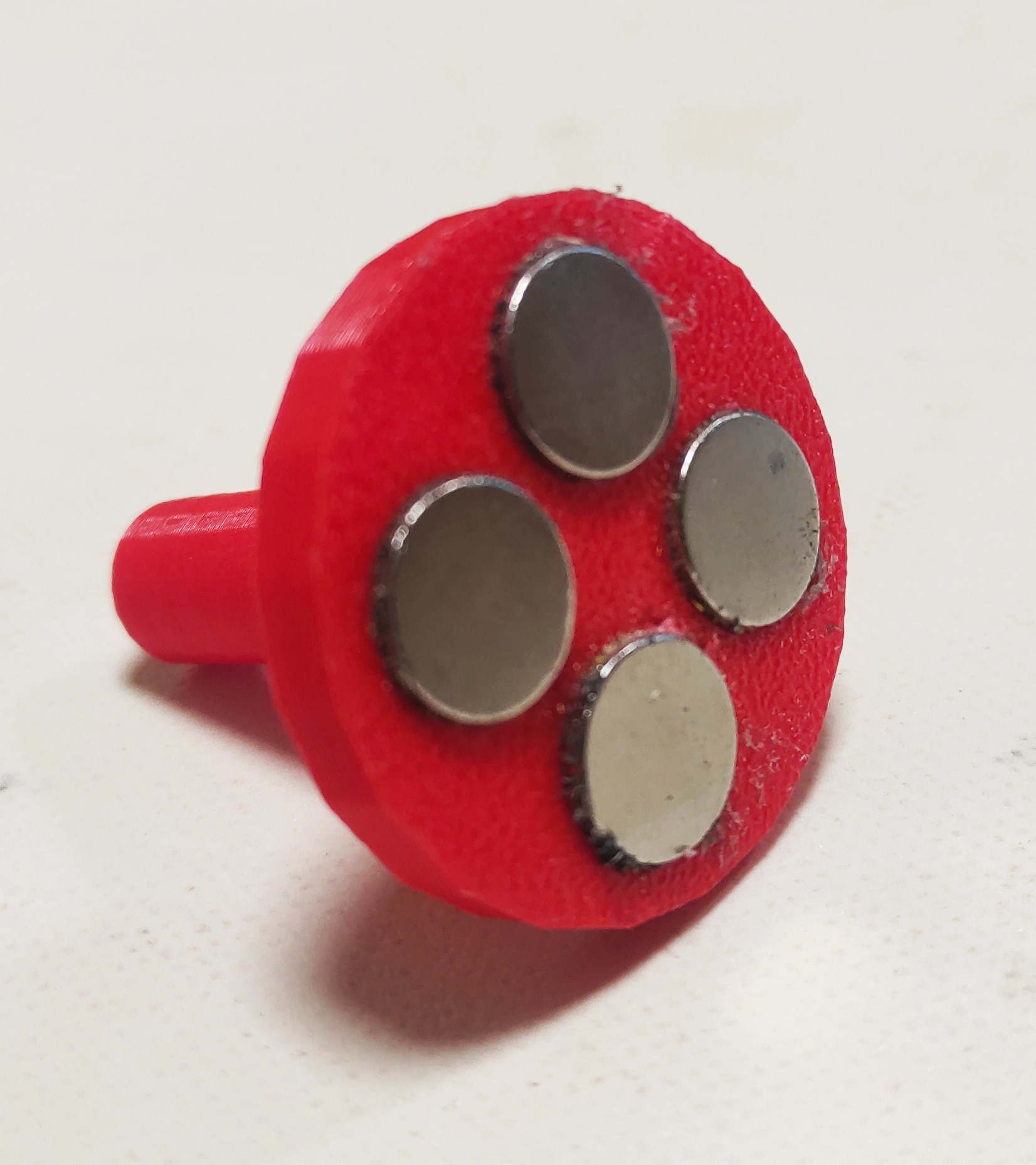

Nice idea! This is my 2024 3D-printed version. Since it is plastic I don't have to worry for the magnetism of the stem.Attachment 47508Attachment 47509
Only after posting my thread did I notice that there was another one, containing a 3D file of this tool. Great minds think alike... :embarrassed: https://www.homemadetools.net/forum/...924#post133690
I happily adopted his concept.Attachment 47522Attachment 47523
