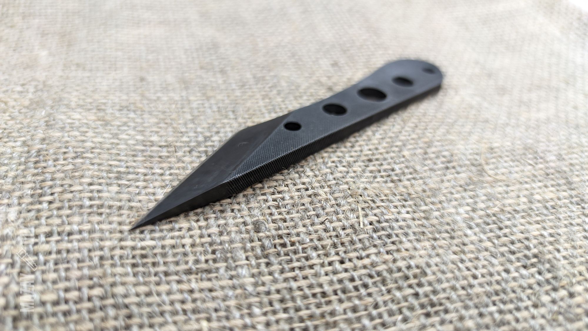

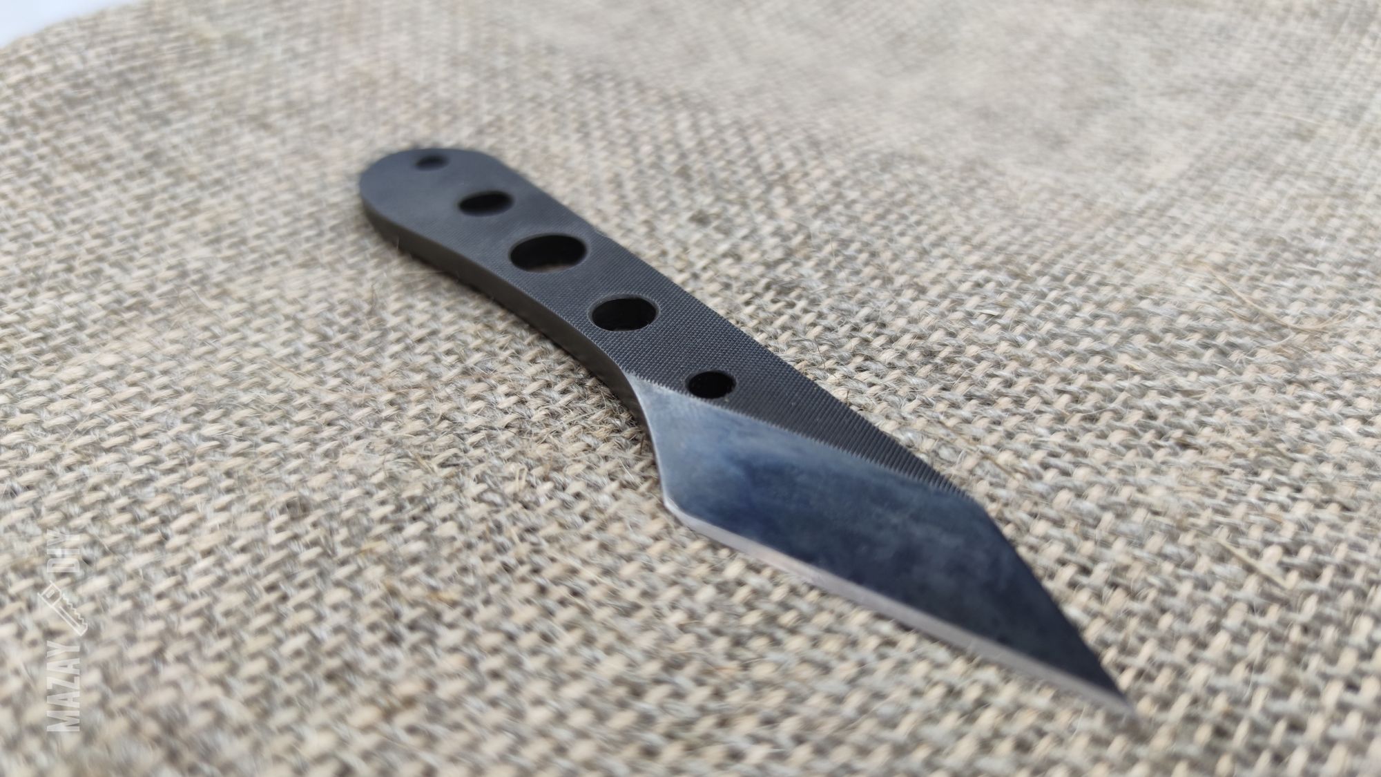

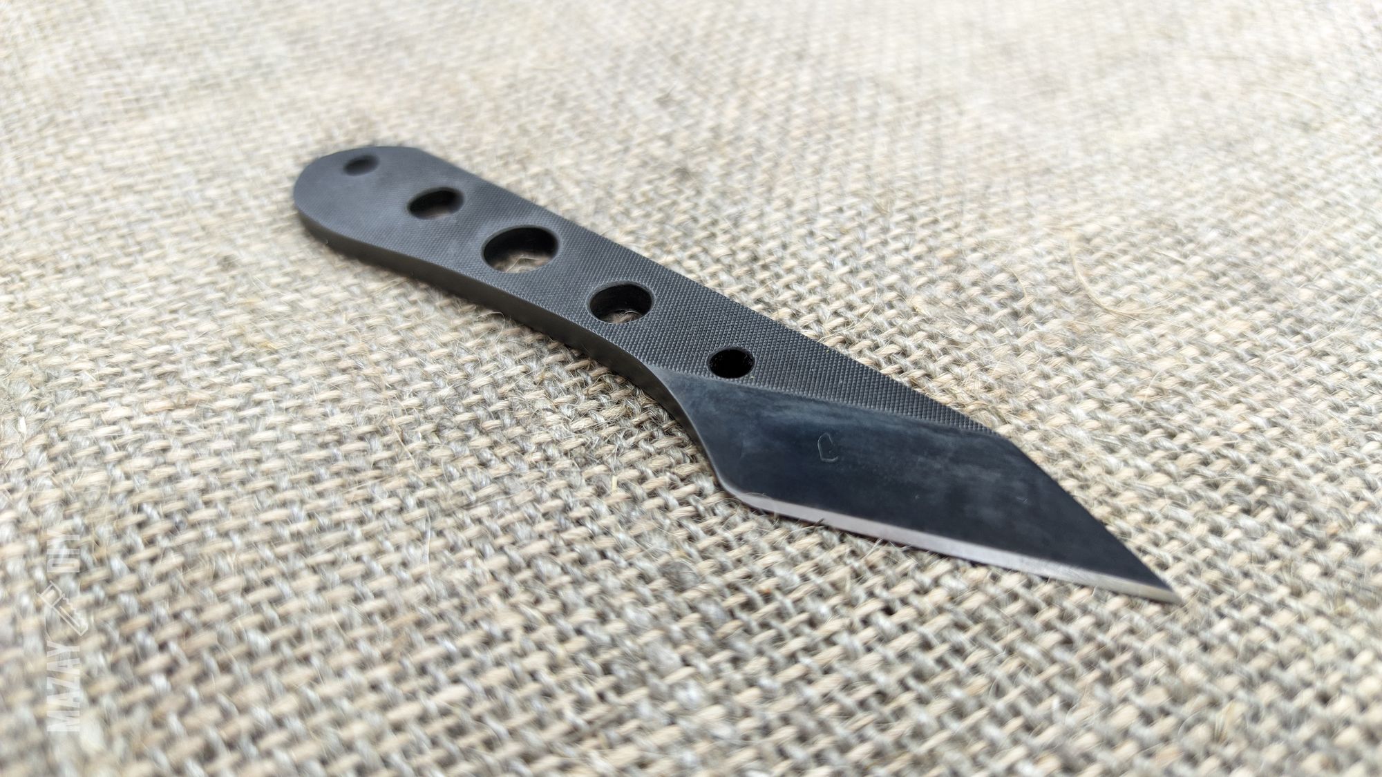

    Lightbulb DIY Japanese Kiridashi Craftsman Knife (free PDF template)
    Making a Japanese Kiridashi Knife from a File

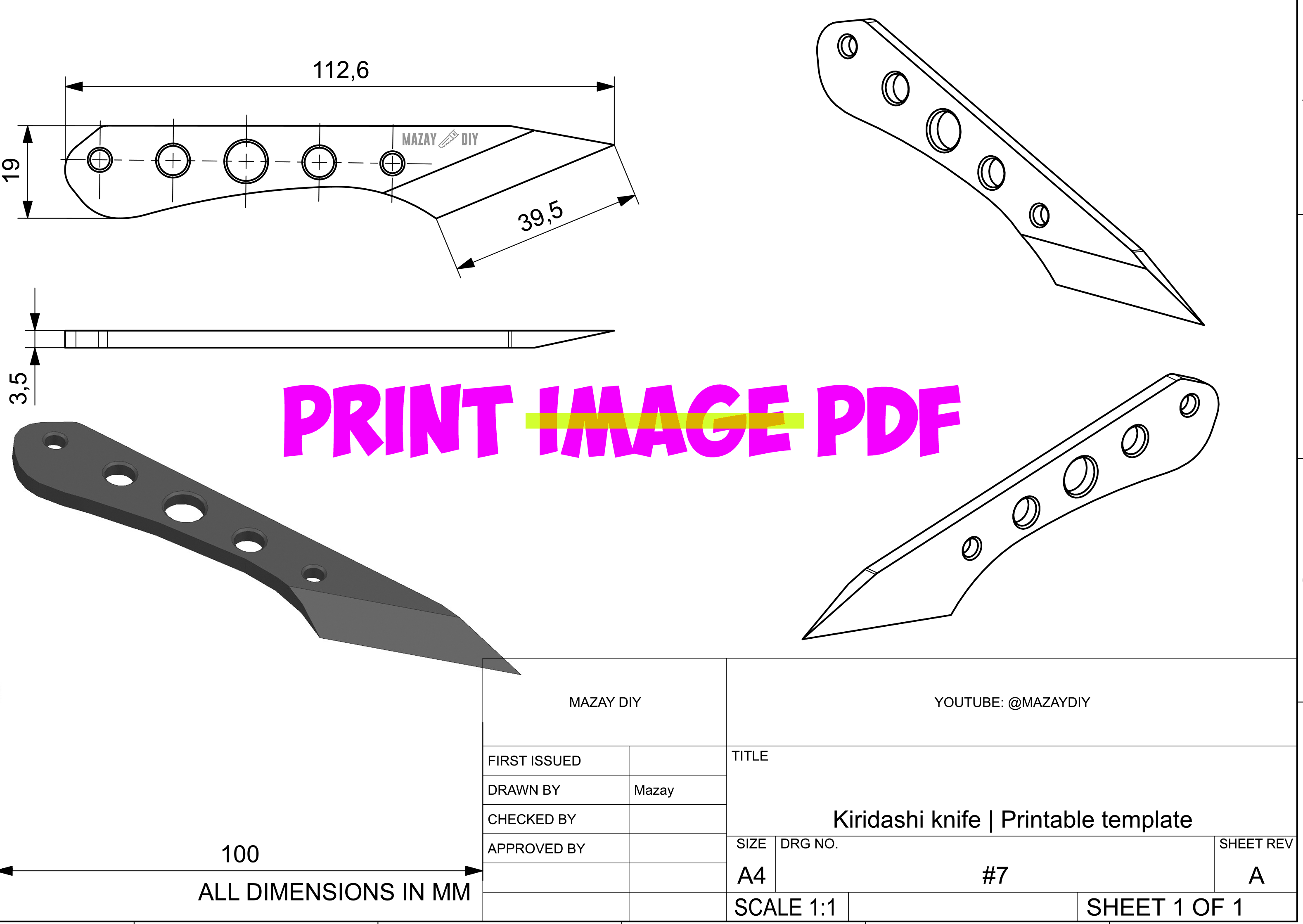

    DIY Japanese Kiridashi Craftsman Knife (free PDF template)-kiirdashi-template.png
    Download Printable PDF template (FREE)

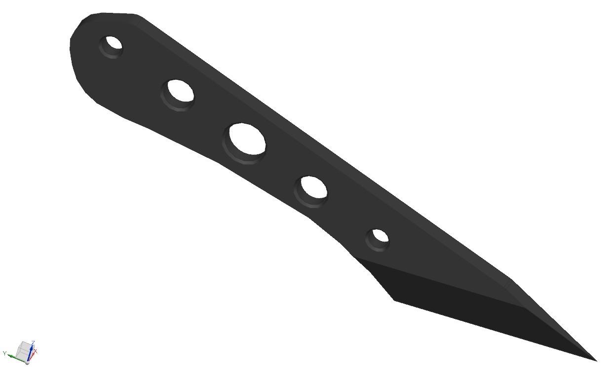

    DIY Japanese Kiridashi Craftsman Knife (free PDF template)-3d-model-kiridashi-knife.jpg
    Download 3D CAD model
    The Kiridashi Craftsman Knife is a traditional Japanese knife lauded for its precision and reliability in crafting applications. Often utilized in woodworking and carving due to its sharp, chisel-like tip and uniquely shaped blade, it allows artisans to make accurate, intricate cuts. This utility tool's robust design makes it a multi-purpose asset, suitable for various crafting, hobby, or DIY projects.
    DIY Japanese Kiridashi Craftsman Knife (free PDF template)-homemade-kiridashi-1.jpg DIY Japanese Kiridashi Craftsman Knife (free PDF template)-homemade-kiridashi-3.jpg DIY Japanese Kiridashi Craftsman Knife (free PDF template)-homemade-kiridashi-2.jpg
