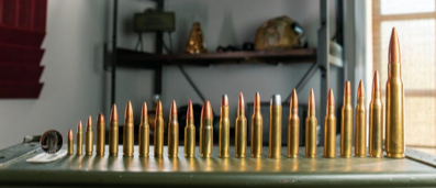

    Quote Originally Posted by tlnixon View Post
    Now someone builds a press...After I have bought 6 Lee presses and one RCBS. LOL!!!! Fantastic-looking work. Great concept to rotate the die plate instead of the shell holder like Lee does. If there is enough room between the die plate and ram, once could load .50 caliber just by building another plate and drilling and tapping it for the larger dies.
    Depending on what specific 50 caliber round you are thinking about, there may not be enough travel for the cartridge length, or enough strength to properly resize that large case.
