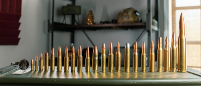

Depending on what specific 50 caliber round you are thinking about, there may not be enough travel for the cartridge length, or enough strength to properly resize that large case.
Attachment 44607
