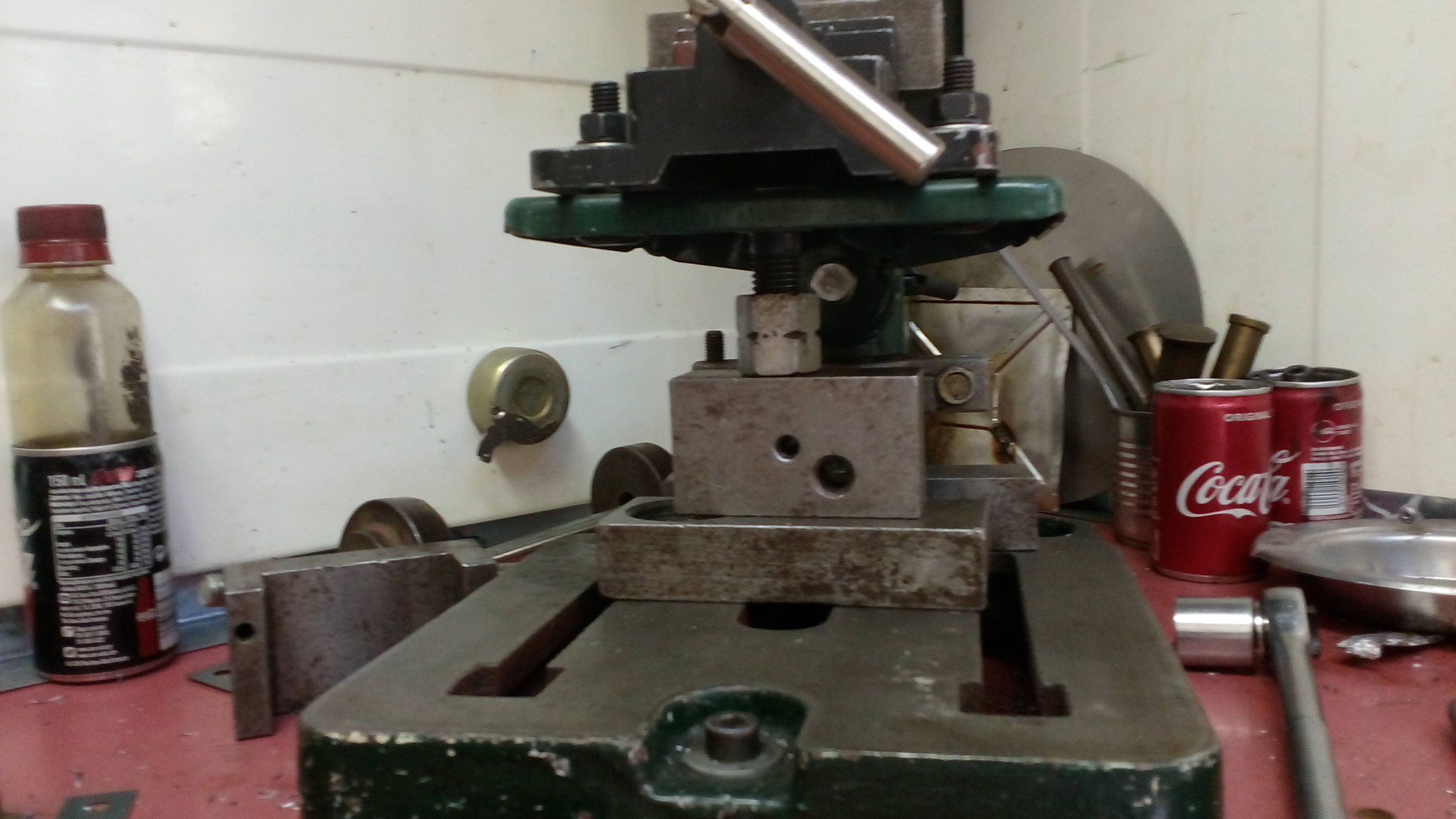

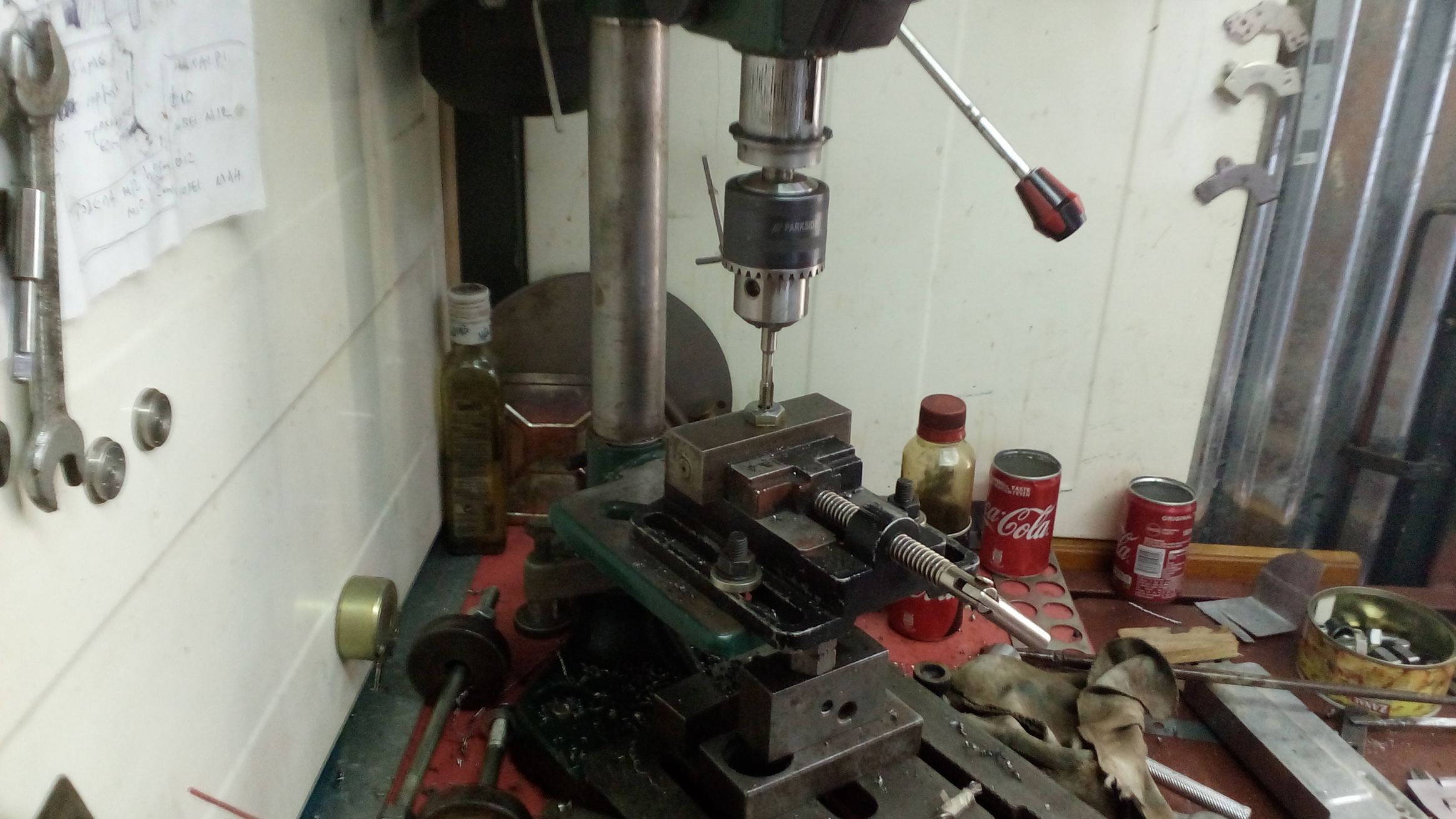

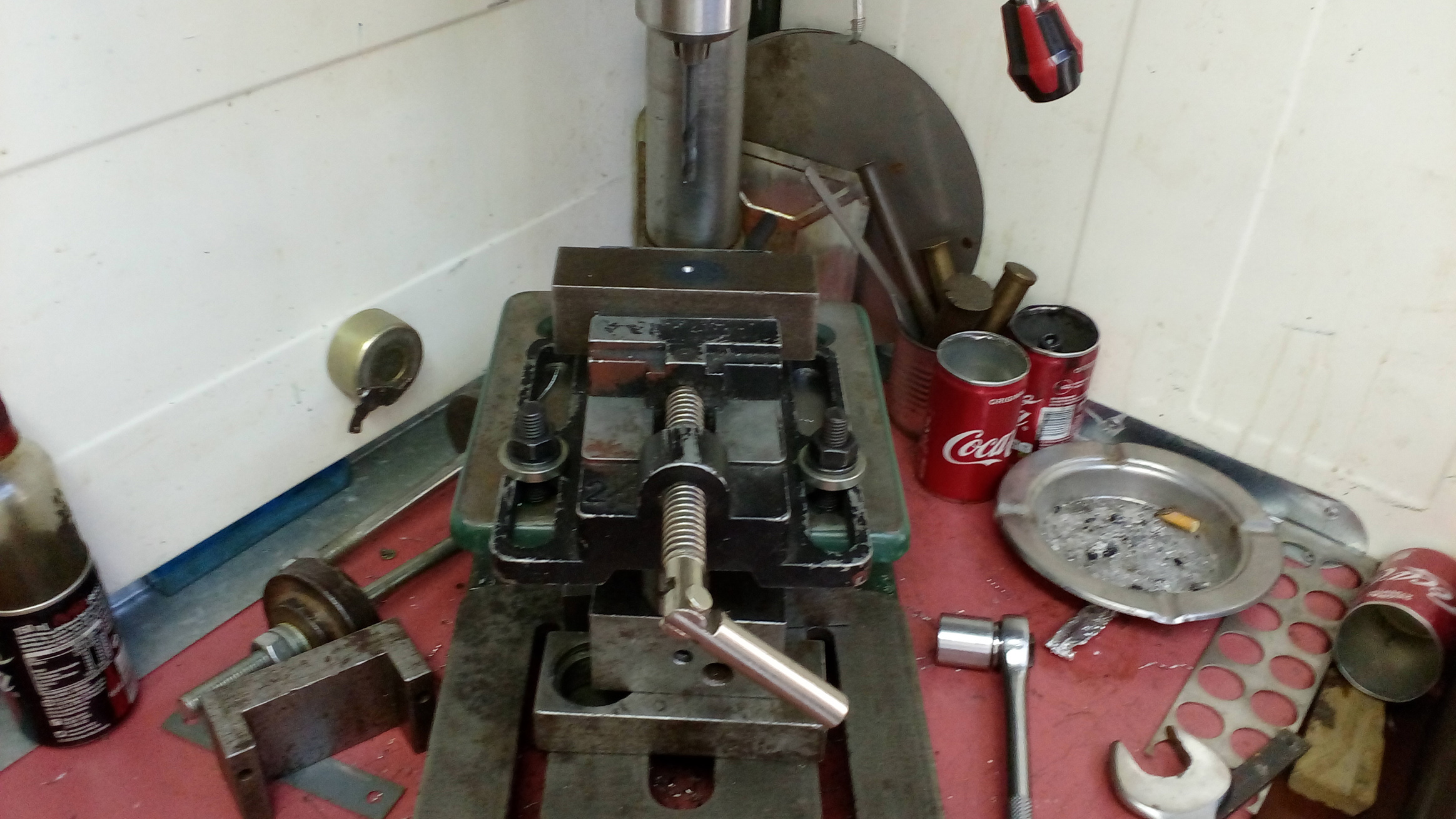

    Riveter for rivet nuts suitable for Num 3,4,5,6,8.
    Materials
    Flat bar 20x3mm
    Bolts/long nuts M12x1.75mm (If I remake it I will use M12x1.25mm)
    Small pieces of left over steel
    I haven’t a lathe so I made the needed fittings using the same way
    that I had made the threaded insert for my angle grinder.
    Place/secure a piece of steel 30x30mm at my drill press
    Make an M12x1.75 threat
    And using the threat makes the needed fittings.
