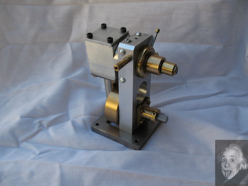

    Very nicely done indeed. You might want to have a look at how Elmer Verburg built his double-acting wobbler; his includes a reversing mechanism...
    http://www.john-tom.com/ElmersEngine...rseWobbler.pdf
    I built his design and it runs very nicely - a compact design suitable for use in an RC boat.

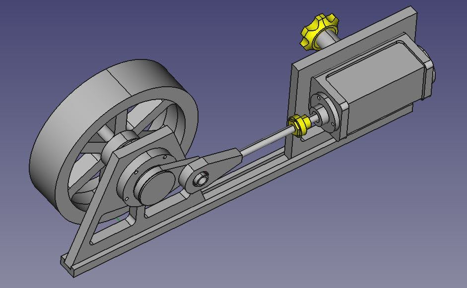

    I finally got round to learning to use FreeCAD and making plans.
    The 3D modelling of parts was actually quite easy using FreeCAD 0.19
    There is quite a steep learning curve with this software and must admit that I found the Part > Body > Sketch logic difficult to get at first.
    But stick with it as it does click, I'm coming at it in middle age and it's taken me ~3days of solid work to get to a point where I can design parts.
    I have found the technical drawings quite tedious, it might just be my very low knowledge of CAD...

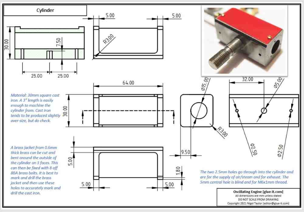

    I have though created plans for this simple oscillating engine, ok, they are not free, but they are low cost.

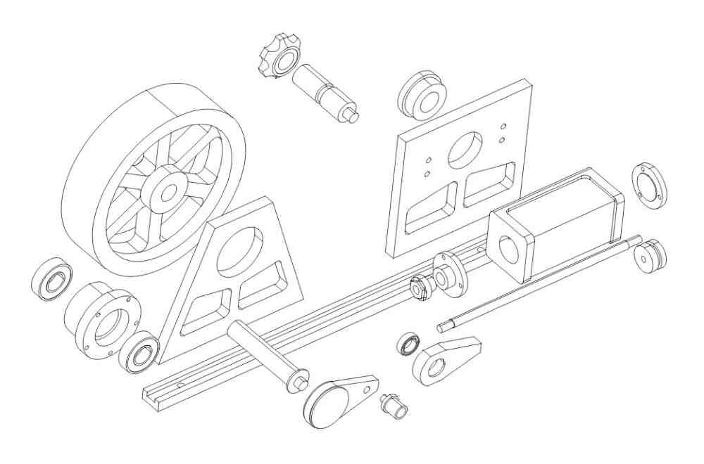

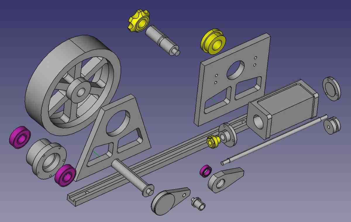

    The exploded assembly view of the engine, hopefully this gives you an idea of what an oscillating steam engine looks like as a bag of bits.
    and as a simple line drawing
    hopefully you can spot the missing bolts, spring and grub screw
