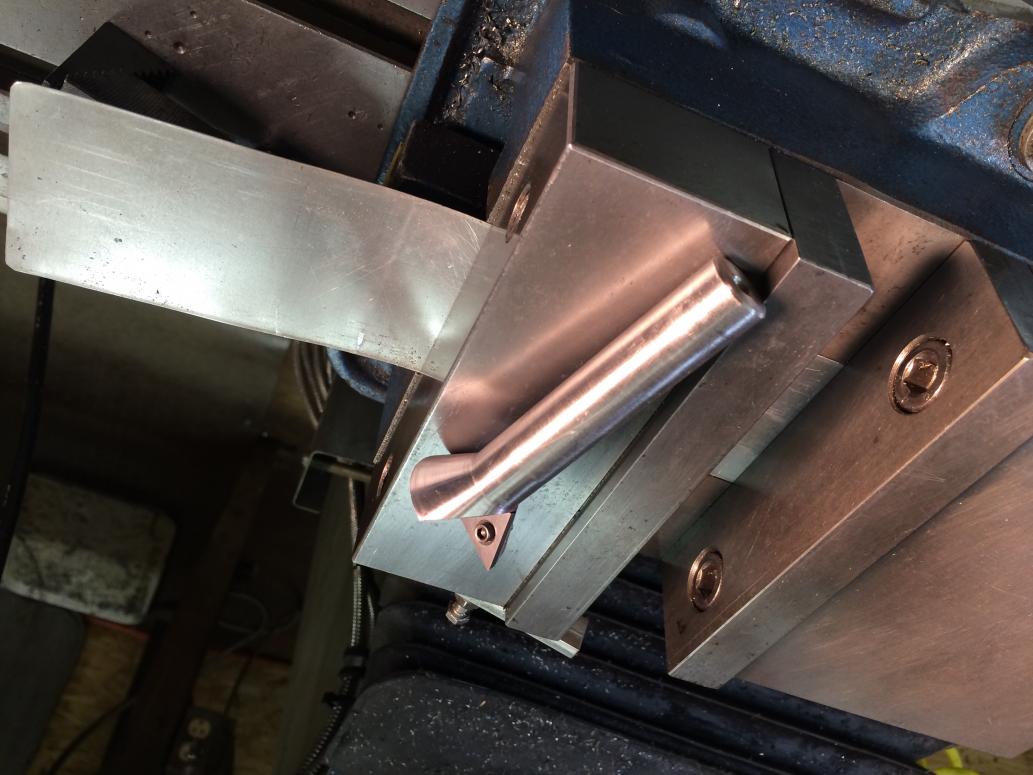

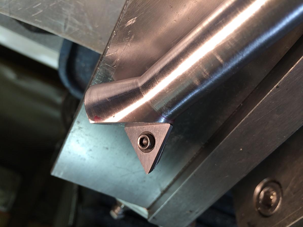

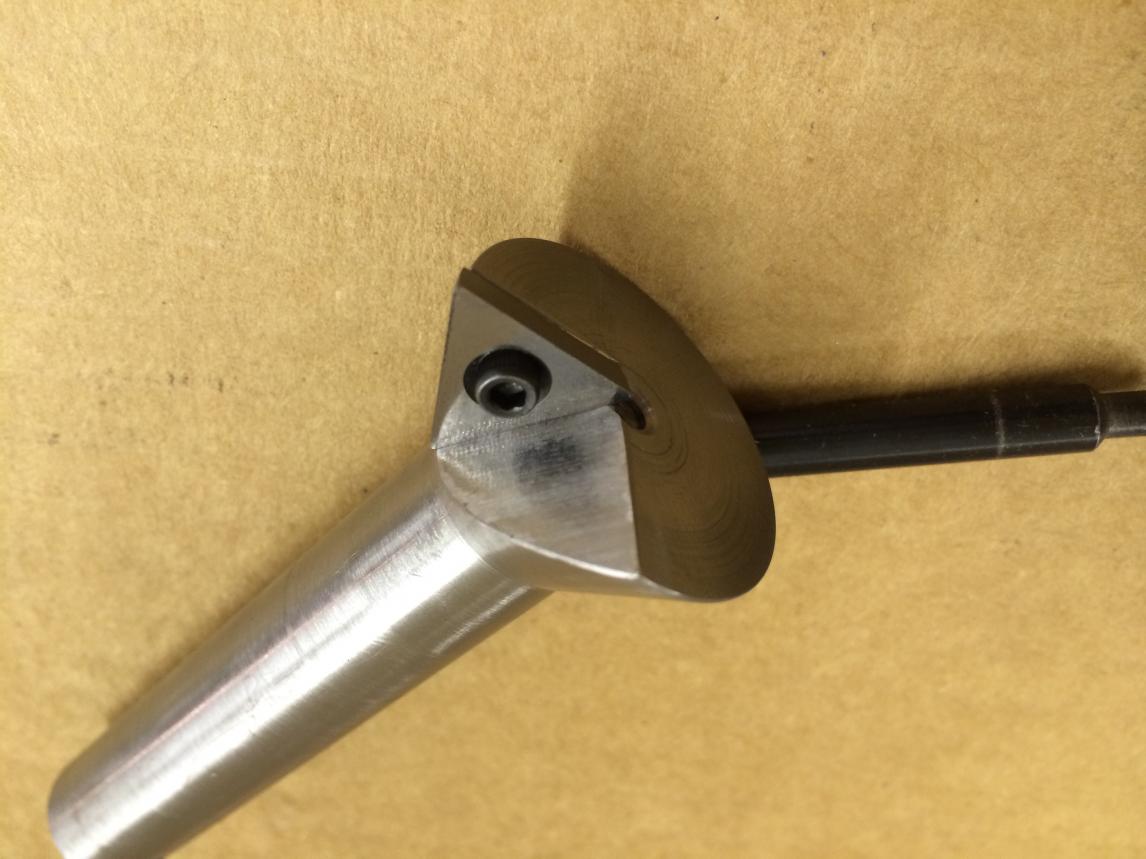

    Dovetail cutter 60deg
    60deg. Dovetail cutter using a TPGB 321 insert. Tool made from a chrome moly alloy, landing gear bolt from an S-64 helicopter. The bolt was a NAS 636A 1" x 3.125". Shank 0.625, Base Dia. 1.227". Click image for larger version.
