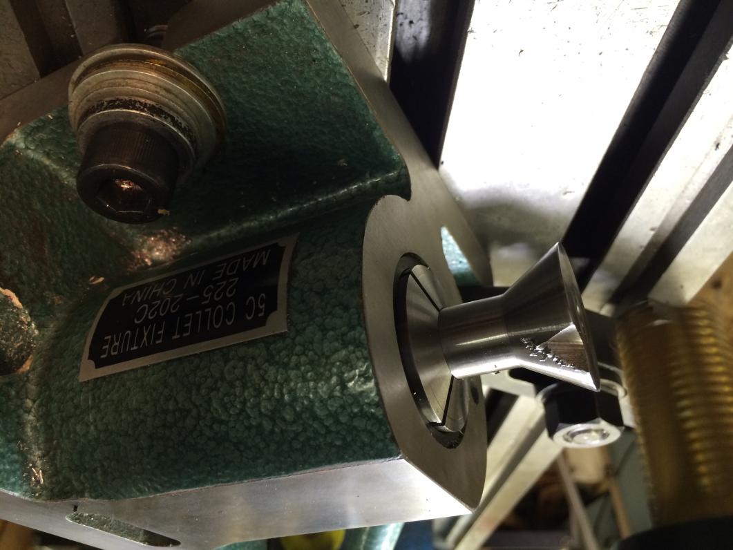

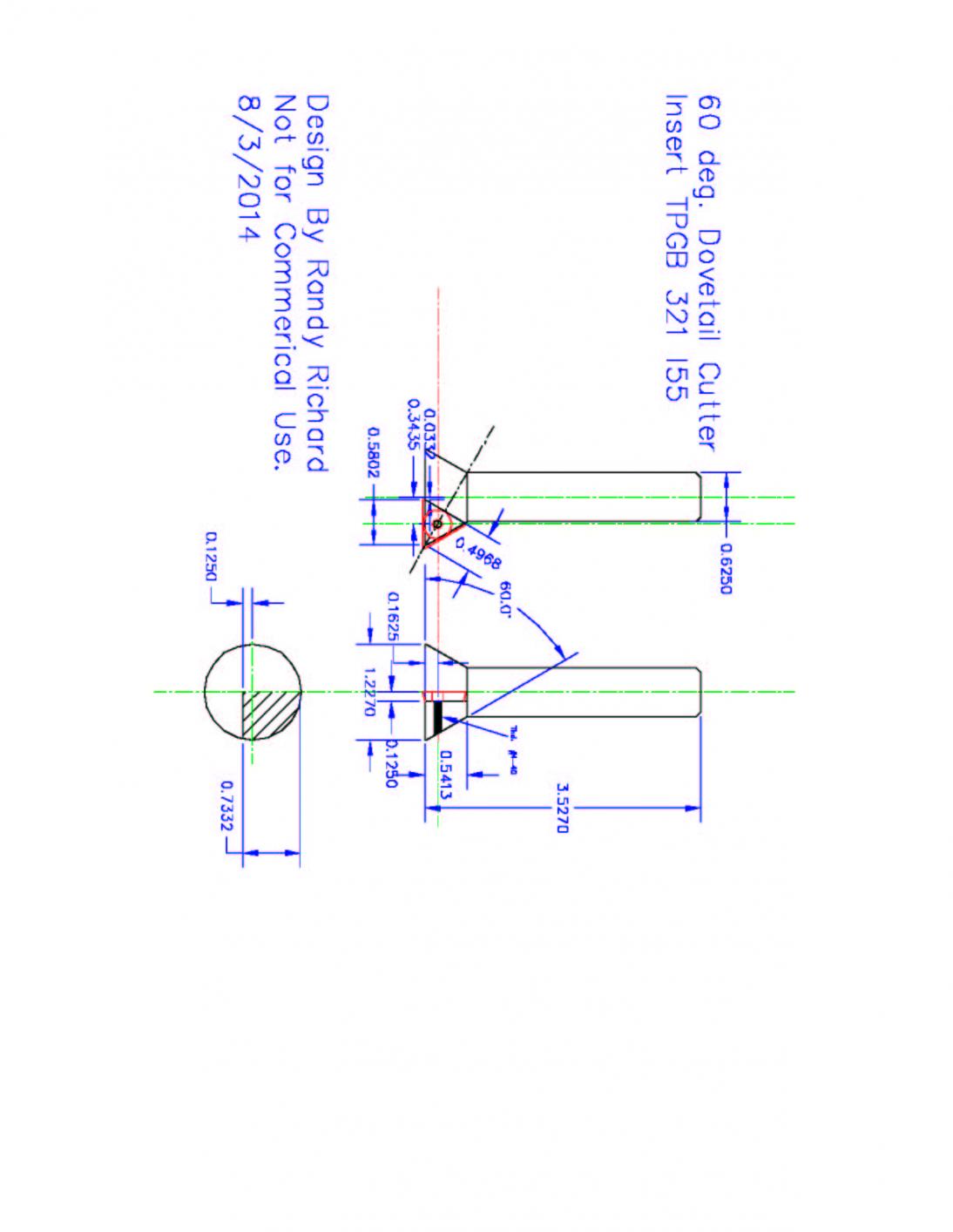

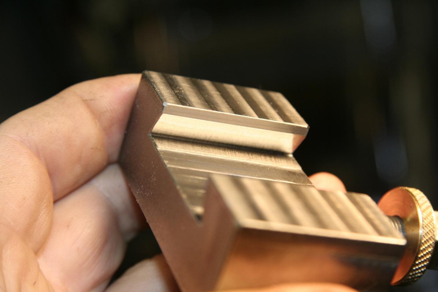

    Dovetail cutter 60deg
    60deg. Dovetail cutter using a TPGB 321 insert. Tool made from a chrome moly alloy, landing gear bolt from an S-64 helicopter. The bolt was a NAS 636A 1" x 3.125". Shank 0.625, Base Dia. 1.227". Dovetail cutter 60deg-image.jpgDovetail cutter 60deg-image.jpgDovetail cutter 60deg-image.jpgDovetail cutter 60deg-image.jpgDovetail cutter 60deg-dovetailcutter60deg.jpgDovetail cutter 60deg-dovetailfinish.jpg
    Last edited by Catfish; Sep 3, 2014 at 01:52 PM. Reason: Drawing and bolt spec. added.
