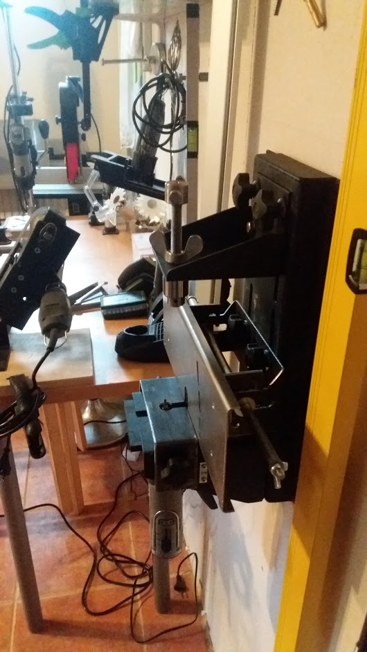

    Update:
    Can be stored and used wall mounted too.
    For trim routing, filing with tungsten carbide cutters, sanding with sanding drums...
    (Image upload failed.. it comes later.)
