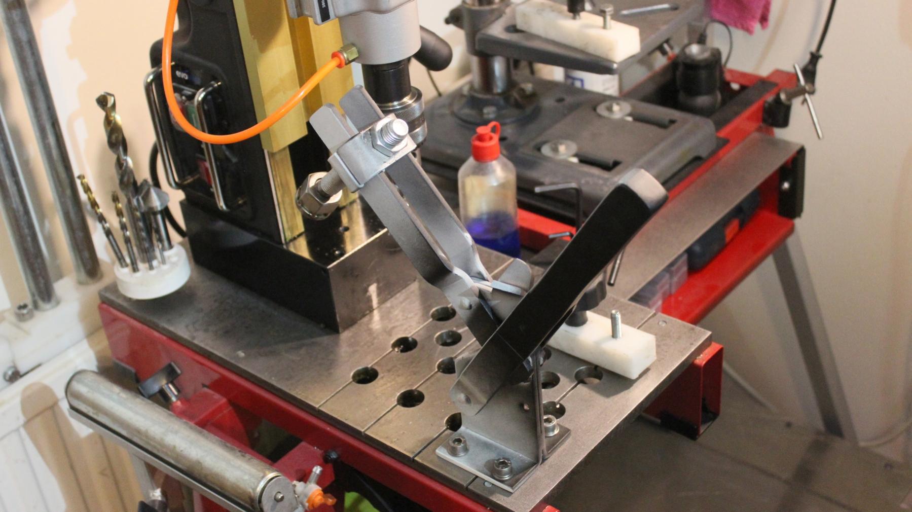

    I made a locking hold down clamp, placed it to my "drilling station".

    My intention is to make a set of these, this was first prototype.
    Tought that these could be usefull when cutting and grinding with angle grinder... etc
    Material is 6mm mild steel, 8mm axle and 8 mm washers.

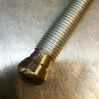

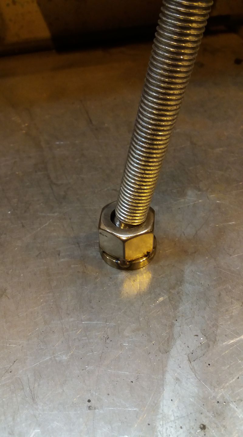

    Swivel is made from M16 bolt, M16 nuts, M24 pipe connection nut and 4mm thick 10/30mm washer.

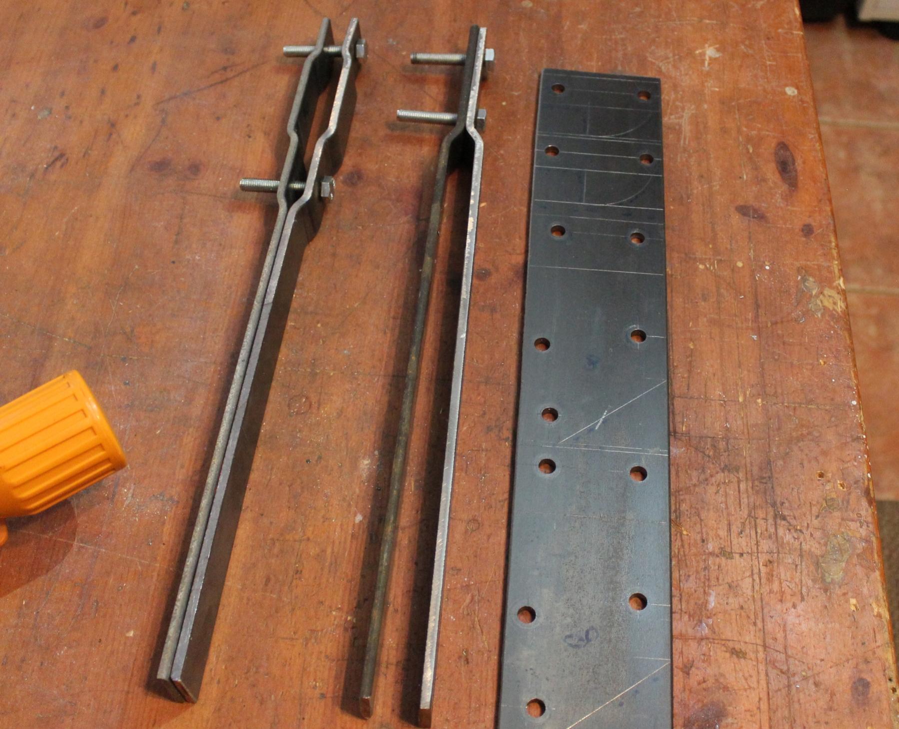

    Cutted 30mm wide piece for arms and handle, then bend them to these shapes.
