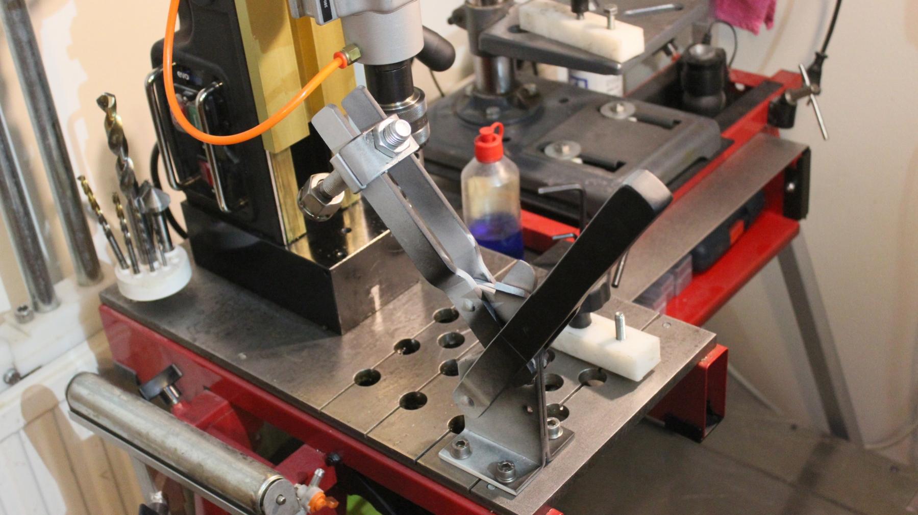

I made a locking hold down clamp, placed it to my "drilling station".

My intention is to make a set of these, this was first prototype.
Tought that these could be usefull when cutting and grinding with angle grinder... etc

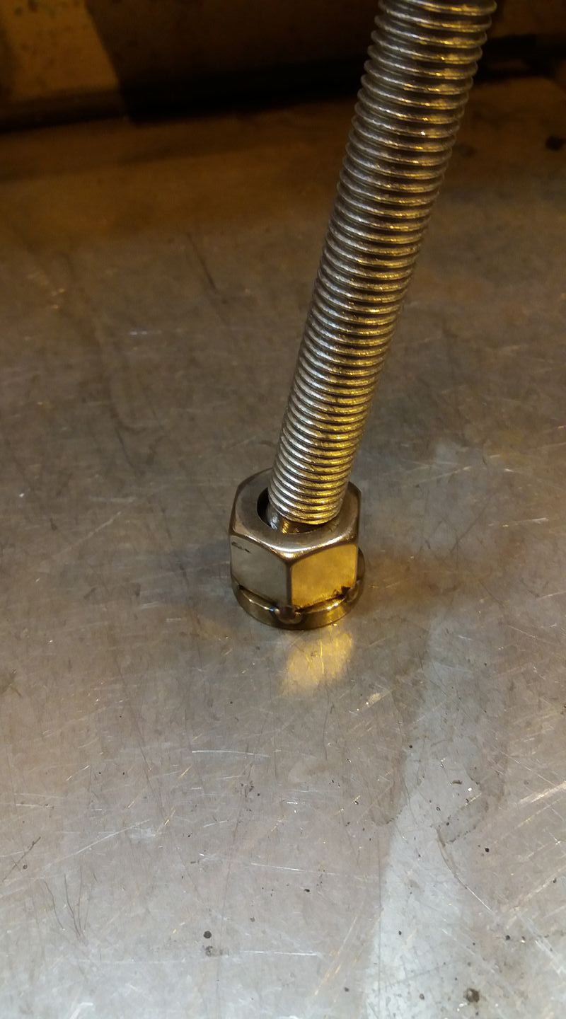

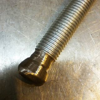

Swivel is made from M16 bolt, M16 nuts, M24 pipe connection nut and 4mm thick 10/30mm washer.

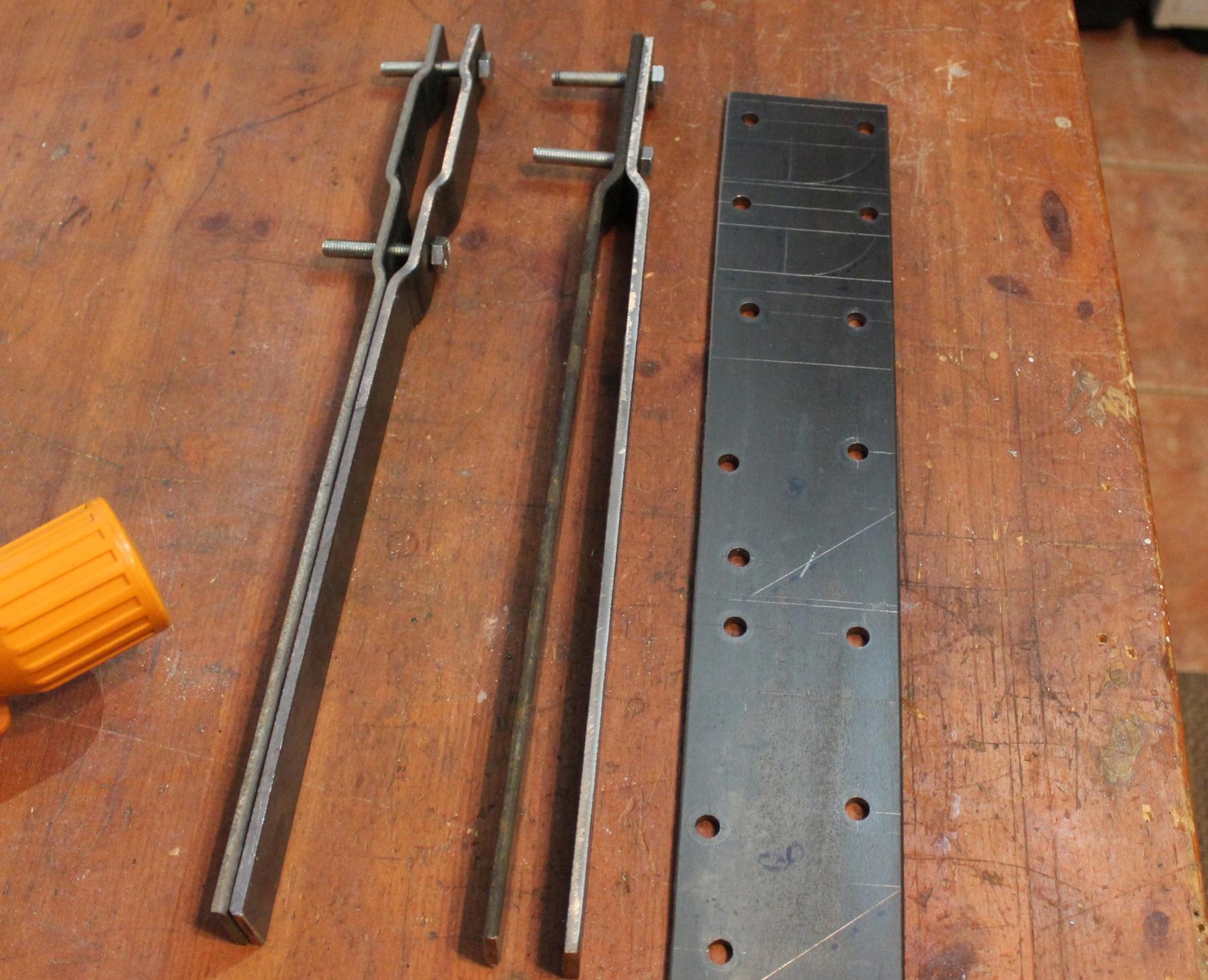

Attachment 21732
Attachment 21766
Cutted 30mm wide piece for arms and handle, then bend them to these shapes.
