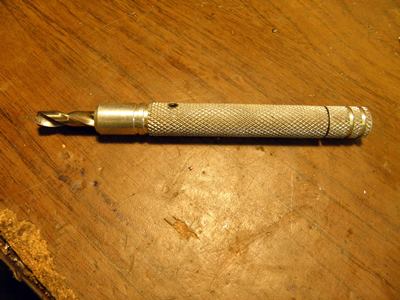

    Drill bit deburing handle.
    Paul Jones (Oct 17, 2014)
    780
    Thanked 1,864 Times in 1,663 Posts
    Nice work, capainleeward! So the bit is held in place by a setscrew?

    Hello DIYer, Yes. then you rotate it in a smaller hole to debur.

    Nice touch on the knurls capainleeward.
