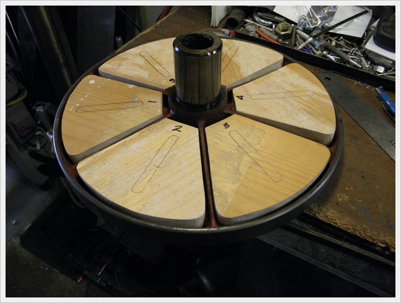

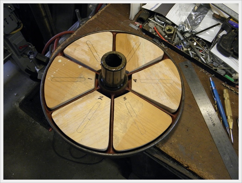

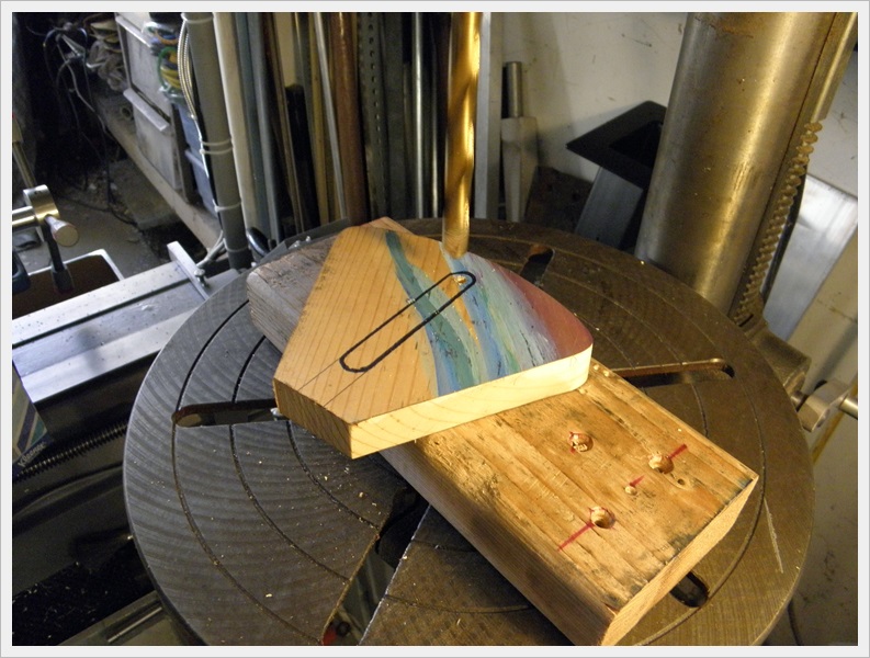

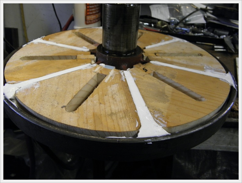

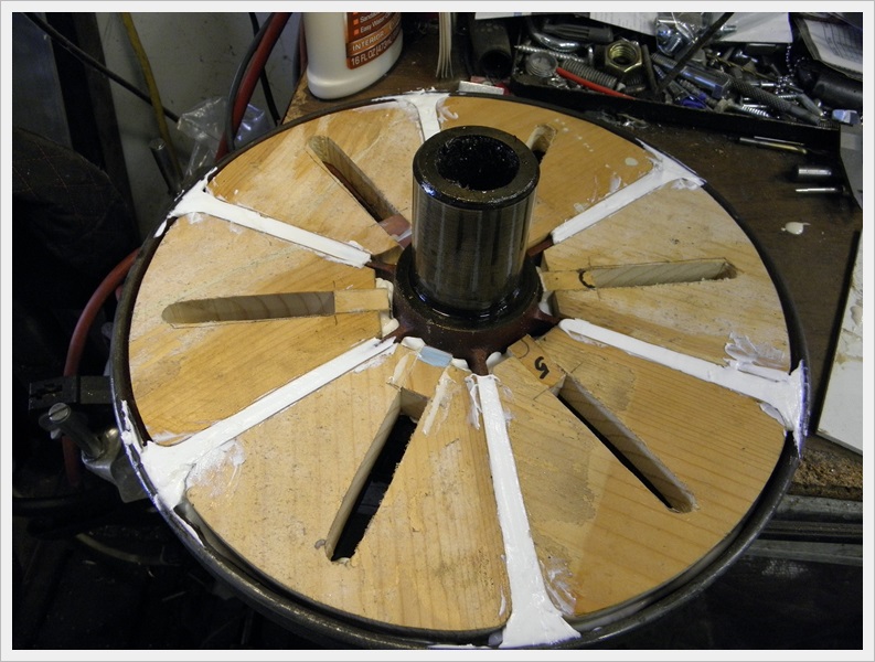

    Drill Press Table Modification. Made from 3/4 inch Doug fur and 5200 calking.
    How many times have we wanted to use clamp on a vise or work piece on the drill press table, only to find those support ribs right in the way.
    So my answer to this is to fill up the space with wood and now I can clamp any where I like as well as use the bolt holes. you can to now.
    enjoy.
    note 5200 marine calking is so strong I have used it to seal thru hull fittings.I had to double shim it on either side of the slot under the wood to get it level,so when I put the clamp on it would not brake the wood. Be sure to fasten all work properly.

    Good idea Capt.

    Brilliant, I love these simple idea's that are sooo useful, I will be copying this one.

    They are called Tee Nuts or, more properly, Tee Slot Nuts:
    https://www.bing.com/search?q=Tee+Nu...ZI&form=MOZLBR
    https://www.mcmaster.com/#tee-nuts/=1aqu7s5
    Not the sheet metal ones that are made for wood. But the ones that are machined from solid steel. They come in many sizes and you need to buy some that fit your table's slots. Then you can locate a stud at any place along the slot. They work with Tee slots that are found on the better tables and also with just plain through slots as found on the less expensive DP tables.
    You can buy complete clamping sets, also in different sizes:
    https://www.mcmaster.com/#t-bolt-clamps/=1aqu8z6
    Or just buy the nuts and studs and use your own clamps.
    Paul A.

    Hello Paul A. Your suggestion to use TeeNuts is a good one. I personally like to use clamps for the set up, much quicker and no oil and swarf on my hands...
    plus the swarf gets in the threads and nuts making them hard to turn, yes, clamps work best for me gosh what a time saver..Merry Christmas to you aswell. an ...Thank you for your suggestions,
