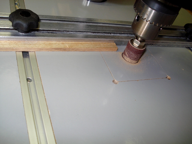

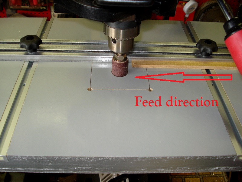

    Sometimes you need to make small pieces with a uniform width or thickness. With a drum sander and a fence you can make a thickness sander at the drill press.
    Note the feeding direction of the workpiece.
