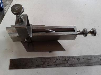

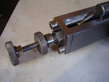

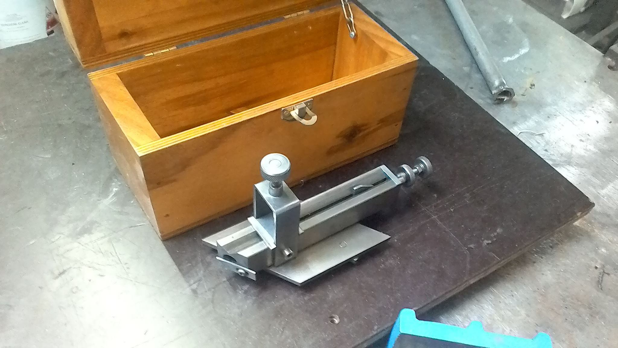

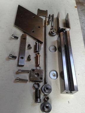

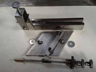

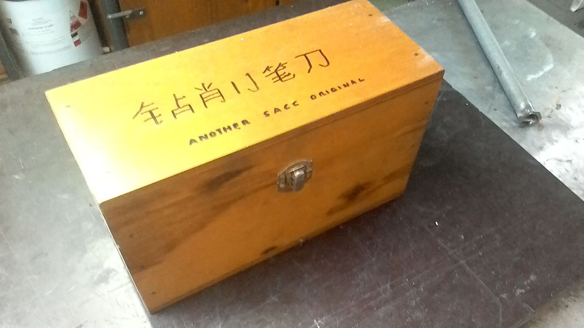

    This is my final drill sharpening jig. Rather than spot bits of angle together, I used a piece of 25mm square bar, linished it, milled a V for the drill, cut a 2mm slot down the centre for 110mm, drilled a stepped hole through: 5mm for 30mm and then 11.5 mm for the remaining 110mm. I had to extend an old 11.5mm drill and grind flat on the end so I could machine the end of the hole flat for a stepped bush to run on. I also drilled a couple of debris drain holes and tapped a few 5mm holes for mounting the slide plate, the end plate and the drill clamp. As you can see from the pics there are quite a few bits inside.
    The 5mm advance rod was turned down to 3.5 on the end and a 5mm bush with collar was shrunk in place for the end bushing. I turned a bit of stock to 7mm, threaded the inside to 5mm x .8, fashioned a single wing and tacked it to the nut. The bush on the advance end was machined to 7mm with a collar, machined down to fit a 9mm spanner, and threaded inside the same as the advance screw. When screwed into place it’s locked off with a locknut. The plate on the end has a backlash adjuster and locknut and also acts as the outer bearing for the advance screw bush. The end plate is fixed by two 5mm allen heads which I had to turn down to accommodate the backlash adjuster locknut. To the rear of that are the thumb lock nut and the thumb adjuster.
    The drill clamp U piece is attached via two 5mm allen heads. I machined a stepped 5mm nut and shrunk it into the top of the U piece. The adjuster screw has a thumb nut attached at the top and the adjuster screw pushes an H shaped plate down onto the drill flutes.

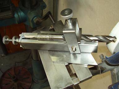

    It will accommodate drills from 25mm down to 2mm, but in reality larger bits are probably better ground using a simple conical grinding jig attached to a linisher. Anything under 4 or 5mm would be difficult to grind accurately on this jig, so next project will probably be a jig with a drill chuck for smaller bits.
    In use: The drill is secured in place by the adjuster and H plate. To advance the drill onto the grindstone, the advance thumbnut is turned and the single winged nut moves along the advance screw, guided by the slot in the bed, and acts on the rear of drill pushing it forward and onto the grindstone...
    It’s quite a bit heavier than the previous jig I made, but also quite a bit shorter at just over 180mm long, it’s not quite as fiddly to use as the first jig and seems to do a better job (see pics of drill point.
    Over complicated? Sure is, but it works well; and, it was an excellent project to design and make.

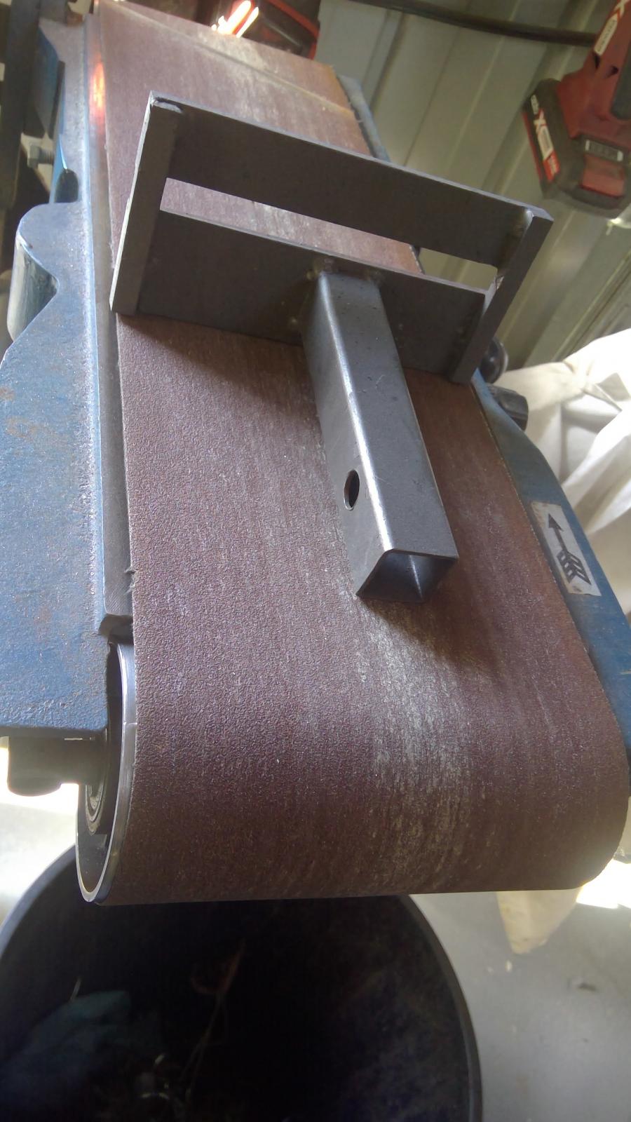

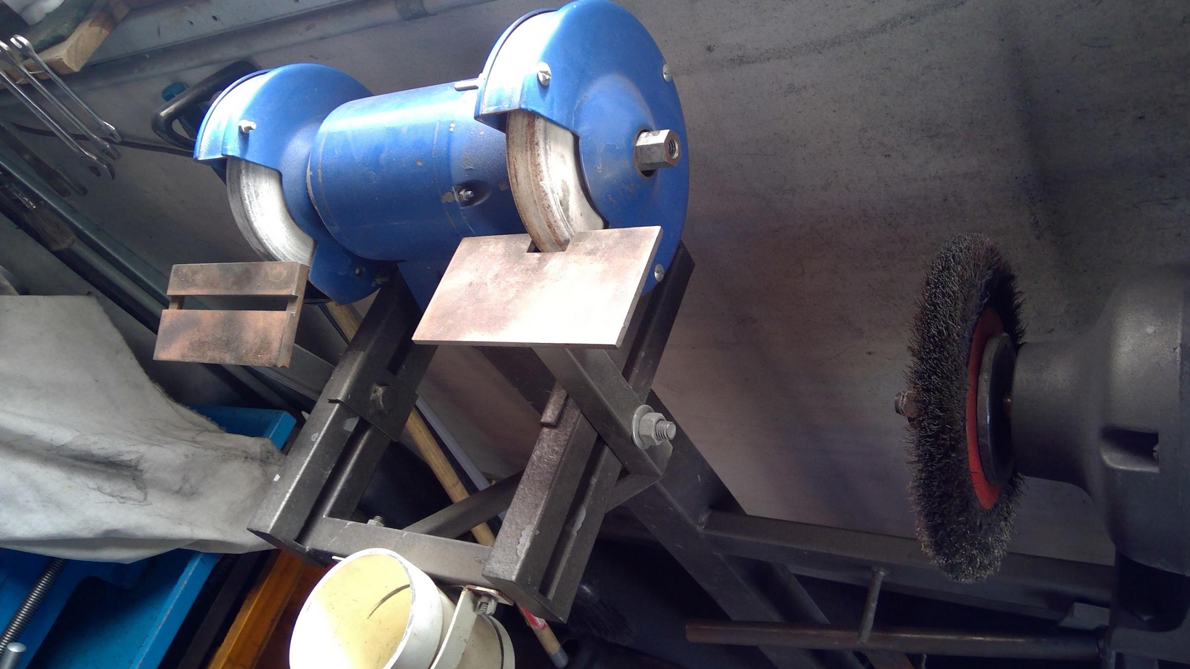

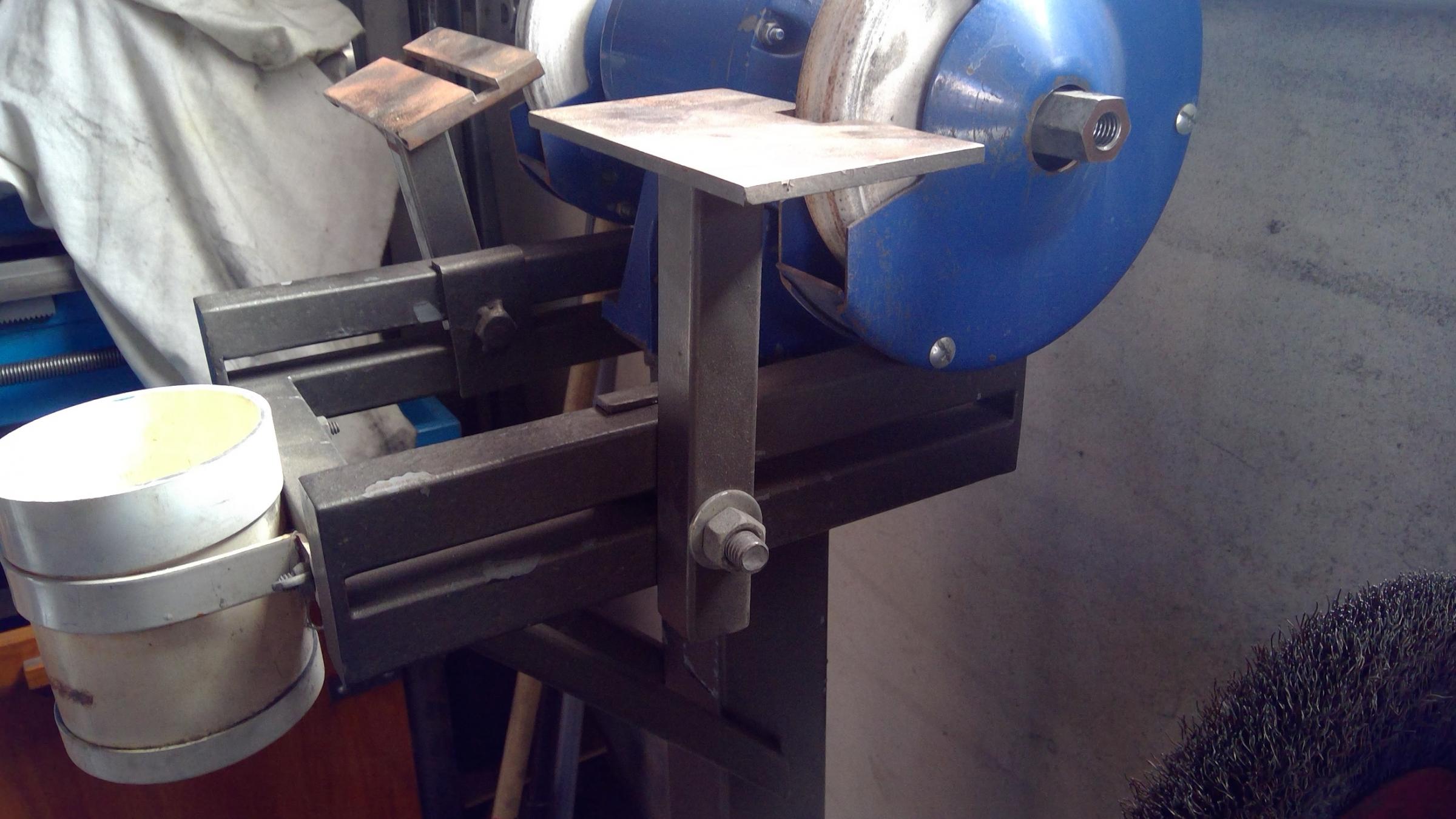

    Th62 - do you have a posting with more detail on the grinder rests you're using there? I can see in photo #3 that the tops are made up using welded fabrication, but what range/style of adjustment are you using for supporting the tops?
    thanks,
    Des

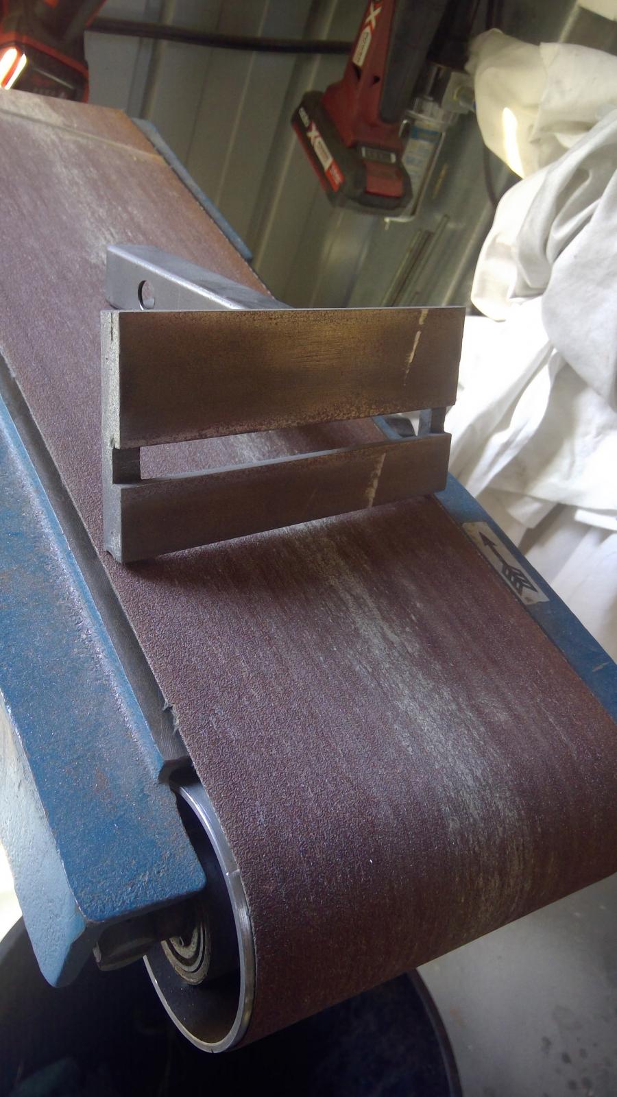

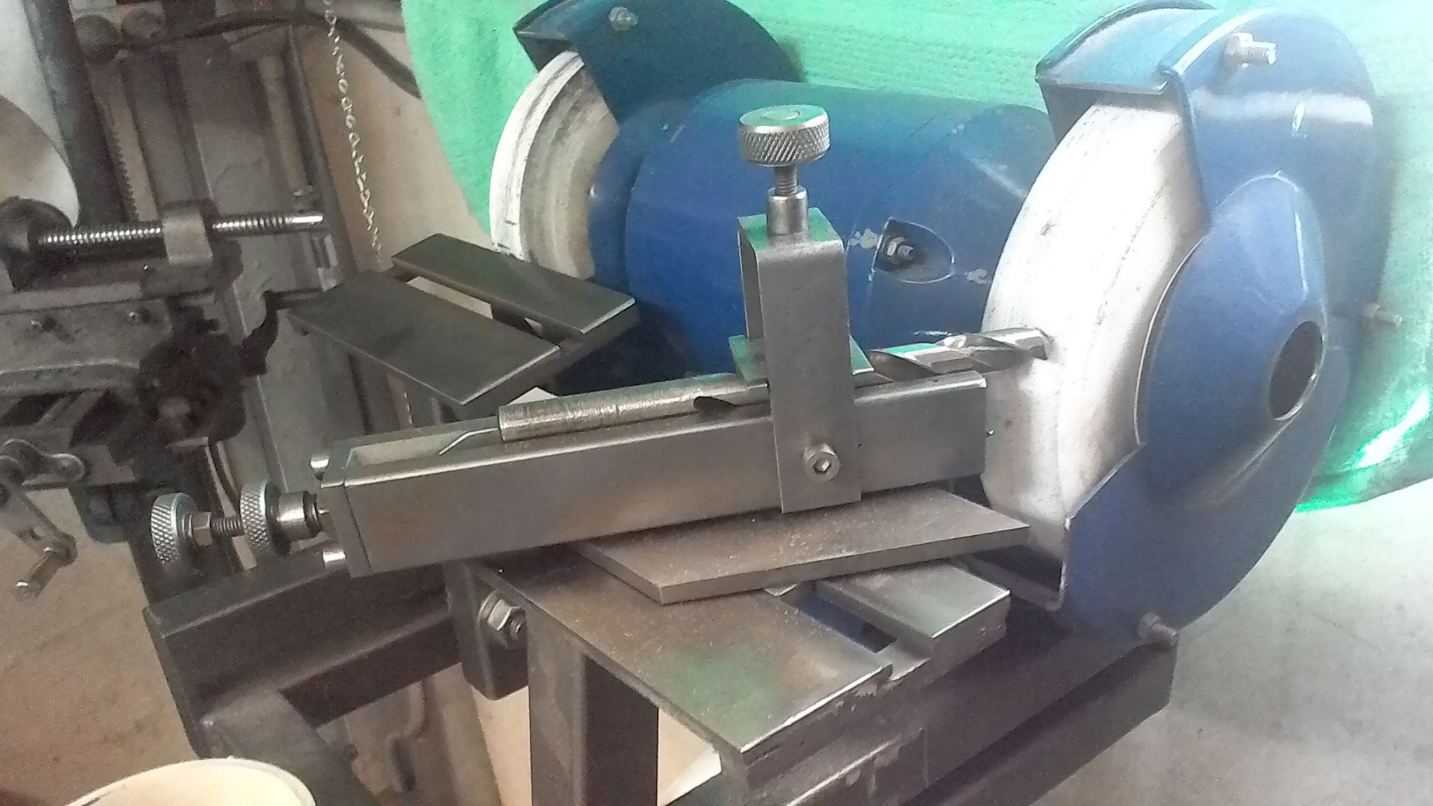

    Grinder tables.

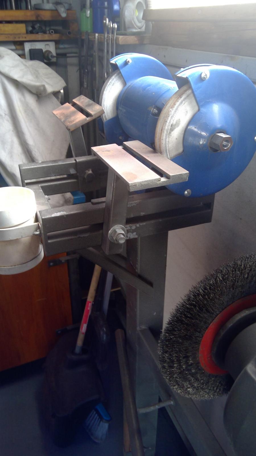

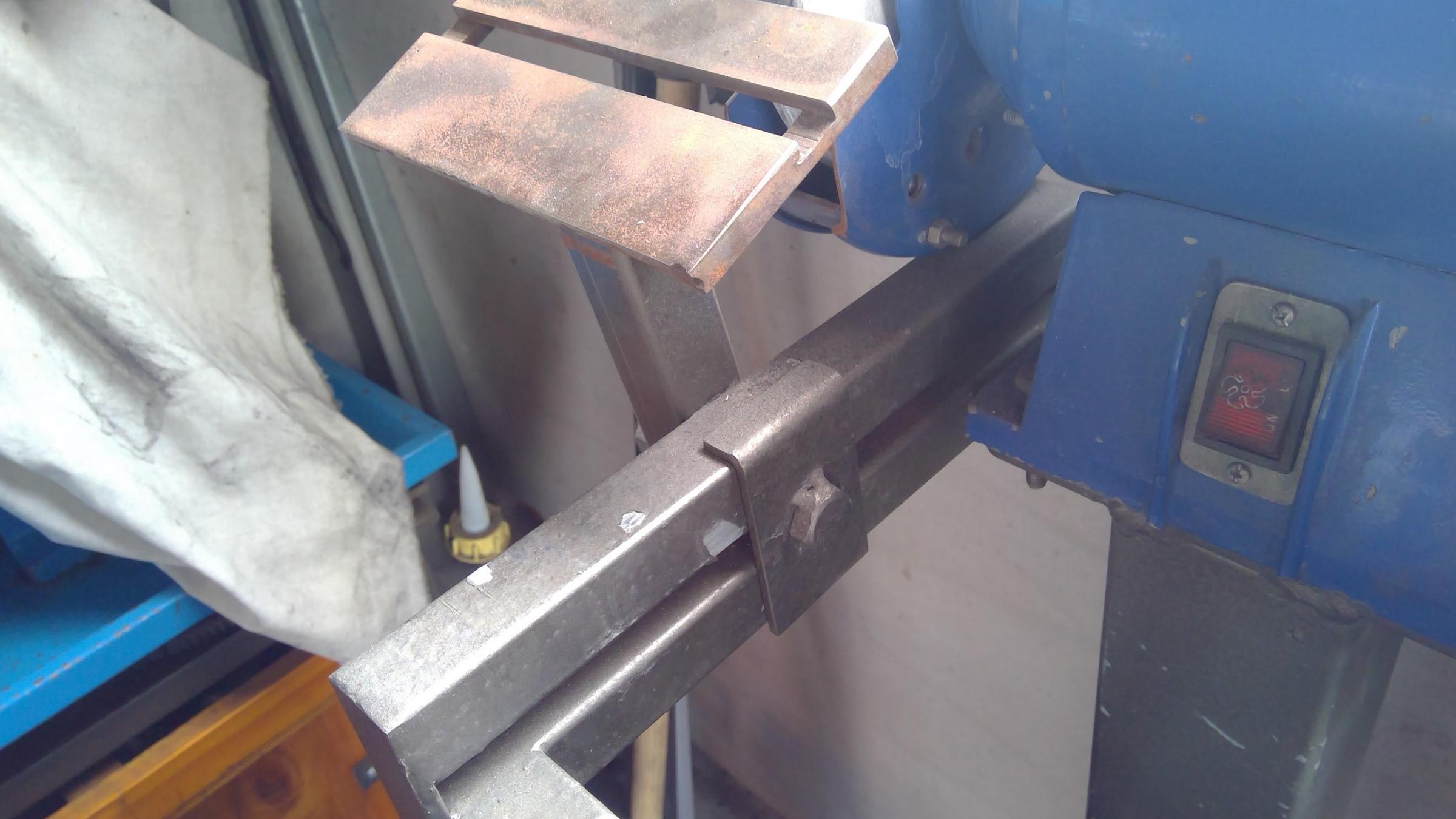

    Yep, here's some pics. I have three tables: One with a basic, flat table with angles scribed on top for freehand grinding sharpening, and another two with slots across them, one for sharpening tangential cutting bits, the other for locating the guide underneath the drill jig. The tables are a one piece design, table angle is achieved by sliding the stem at the base of the table along the the twin rails either side of the grinder. As the base is slid out, it has the effect of changing the table angle. A simple, quick method of changing table angles.

    Thanks Th62!!!! I'm still setting up my shed, so mostly use the small 6" bench grinder and several angle grinders.. but I have a few better bench grinders waiting to come out and be used once I have room for them. once that happens, I will be setting up some with better rests, and various grinding jigs.
