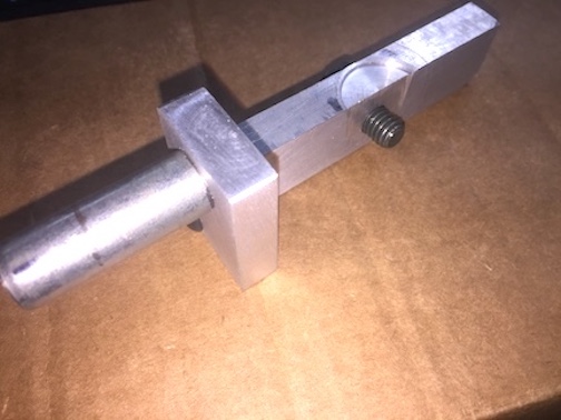

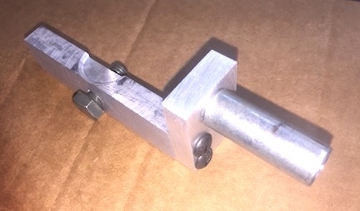

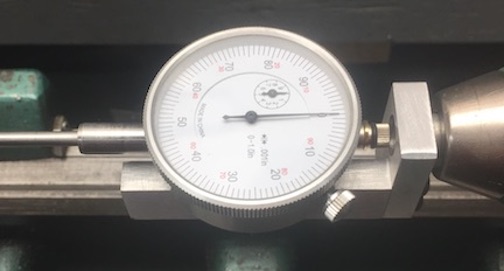

The new adapter is 3 simple parts. It attaches quickly to the DTI with
one bolt and is held in the drill chuck. Fine adjustment is quick and
easy using the quill hand wheel.

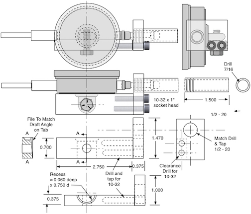

This is the Adapter drawing for my Harbor Freight DTI

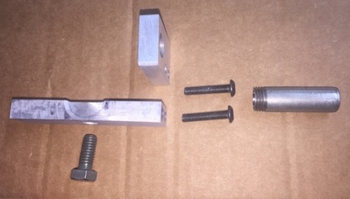

The parts
Attachment 50261
The long bar fits snug against the bottom of the indicator. It
attaches with a single 5/16 bolt. A recess is cut into the top to
fit snug against the bottom of the dial case. The hole in the
indicator lug was correct size to tap for 5/16-18 thread. The
indicator lug has a draft angle from the manufacturing process.
The bar was tapered with a file to match the draft on the gauge
lug so the bar will be square with the indicator case.
The second bar is attached at 90˚ to the first with machine
screws. With this secured In place, and bolted to the case, the
hole for mounting was marked using the plunger of the indicator.
This was done putting tape on the bar. Then pressing the plunger
against that tape. A gentle tap on the plunger with a block of wood
made a good mark in the tape. Then the bar removed, center
punched, drilled and tapped for 1/2-20 thread.
The 3rd piece is a 1/2” x 1 1/2 piece of shank from a bolt. One end
Is threaded 1/2-20. Then drilled through 7/16 to allow the indicator
plunger to pass inside which allows the adapter to be more compact.

The adapter quickly attaches to the tail stock drill chuck.
Attachment 50264

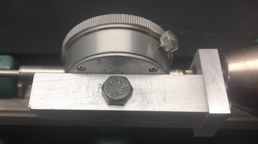

The bottom bar fits snug against the base of the dial which
eliminates the need to adjust anything. One bolt holds it.

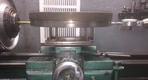

Attachment 50265

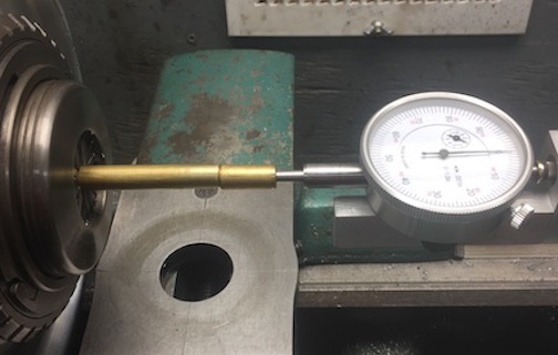

The indicator spindle is aligned with the headstock spindle.
Attachment 50266
This allows easy measurement of items too large for my
available tools.
Attachment 50267
