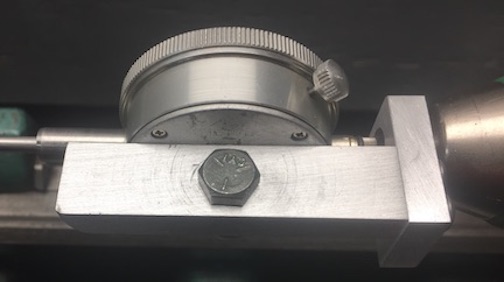

    I really wanted to mount it on the quill with the axis on the center line.
    I initially threw one together from some steel shorts. It worked but it
    was ugly, clunky and required adjustments to work properly. This
    version provided insight to a better design.

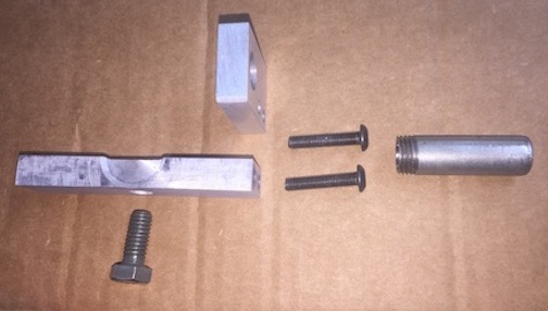

    The new adapter is 3 simple parts. It attaches quickly to the DTI with
    one bolt and is held in the drill chuck. Fine adjustment is quick and
    easy using the quill hand wheel.

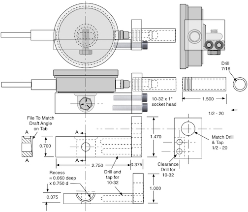

    This is the Adapter drawing for my Harbor Freight DTI
Name:	02 Drawing.jpg

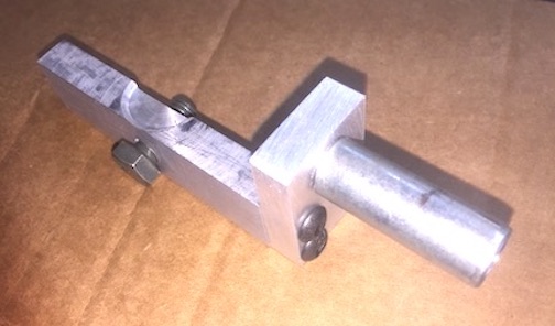

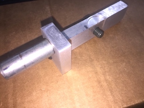

    The parts
Name:	03 Parts.jpg
    The long bar fits snug against the bottom of the indicator. It
    attaches with a single 5/16 bolt. A recess is cut into the top to
    fit snug against the bottom of the dial case. The hole in the
    indicator lug was correct size to tap for 5/16-18 thread. The
    indicator lug has a draft angle from the manufacturing process.
    The bar was tapered with a file to match the draft on the gauge
    lug so the bar will be square with the indicator case.
    The second bar is attached at 90˚ to the first with machine
    screws. With this secured In place, and bolted to the case, the
    hole for mounting was marked using the plunger of the indicator.
    This was done putting tape on the bar. Then pressing the plunger
    against that tape. A gentle tap on the plunger with a block of wood
    made a good mark in the tape. Then the bar removed, center
    punched, drilled and tapped for 1/2-20 thread.
    The 3rd piece is a 1/2” x 1 1/2 piece of shank from a bolt. One end
    Is threaded 1/2-20. Then drilled through 7/16 to allow the indicator
    plunger to pass inside which allows the adapter to be more compact.

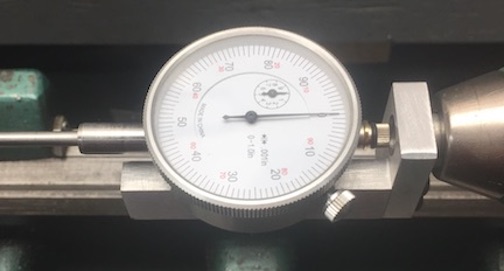

Name:	04 Assembled.jpg
Name:	05 Assembled back.JPG

    The bottom bar fits snug against the base of the dial which
    eliminates the need to adjust anything. One bolt holds it.

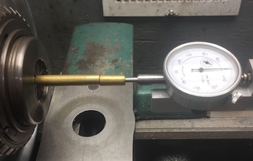

    The indicator spindle is aligned with the headstock spindle.
Name:	08 Lathe Caliper.jpg

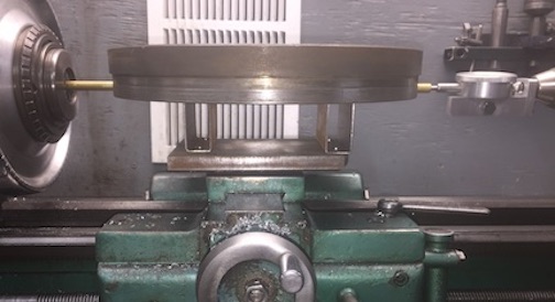

    This allows easy measurement of items too large for my
    available tools.
Name:	09 inuse.jpg
    The adapter in use - > Flywheel and ring gear installation measurement
