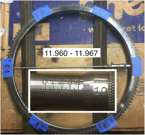

    I have my dad’s Starrett 0-12” inside micrometer set to measure the ID
    of the gear. Those measurements vary between 11.960 and 11.967.
    Twelve measurements at 6 positions averaged to 11.9615”.

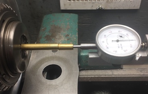

    I have nothing to accurately measure the OD of the12” flywheel.
    After some thought, the lathe could used as a caliper. A brass rod
    was freshly faced in the chuck and a dial indicator mounted in the
    tailstock chuck. For my purposes the actual size is not as critical
    as the difference in size.

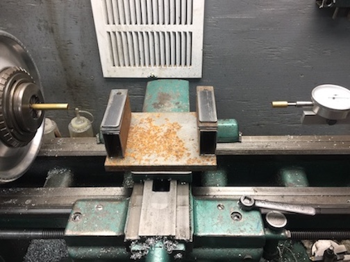

    DTI Tail Stock Chuck Adapter
    By removing the compound slide and stacking shims on the
    cross slide, the flywheel can rest firmly at proper height to
    contact the rod and the indicator. The cross slide easily moves
    the flywheel to center with the indicator.

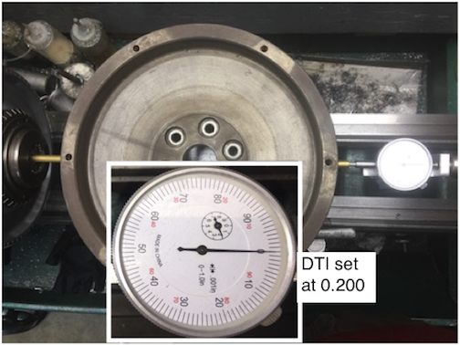

    With the flywheel in place, the tailstock quill was advanced and
    locked with the indicator reading 0.200”. Then back the cross
    slide out, rotate the flywheel 60˚ and slide it back into place.
Name:	04 side view.jpg

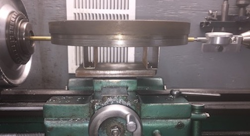

    The clutch bolt holes provided reference for rotating the wheel.
    Working all the way around, 6 measurements were within 0.001”
    off some unknown value.
Name:	05 measure flywheel.jpg

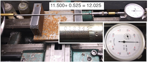

    Removed the flywheel and replaced with the inside micrometer.
    Then adjust the micrometer so the DTI reads 0.200”.
    The flywheel measures 12.025”
    12.025 - 11.960 = 0.065”
