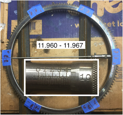

I have my dad’s Starrett 0-12” inside micrometer set to measure the ID
of the gear. Those measurements vary between 11.960 and 11.967.
Twelve measurements at 6 positions averaged to 11.9615”.

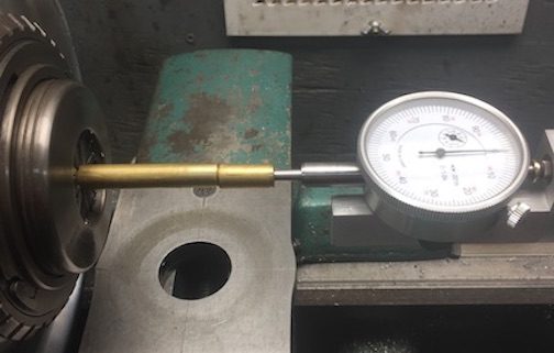

After some thought, the lathe could used as a caliper. A brass rod
was freshly faced in the chuck and a dial indicator mounted in the
tailstock chuck. For my purposes the actual size is not as critical
as the difference in size.

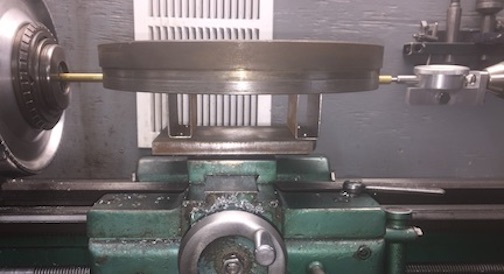

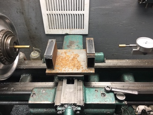

By removing the compound slide and stacking shims on the
cross slide, the flywheel can rest firmly at proper height to
contact the rod and the indicator. The cross slide easily moves
the flywheel to center with the indicator.
Attachment 50270

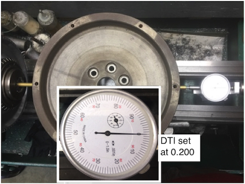

With the flywheel in place, the tailstock quill was advanced and
locked with the indicator reading 0.200”. Then back the cross
slide out, rotate the flywheel 60˚ and slide it back into place.

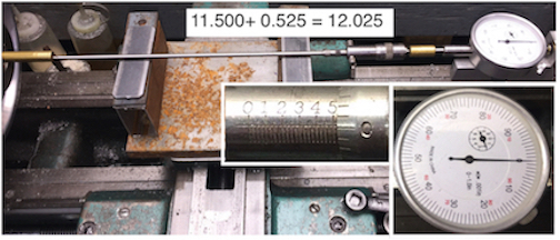

Removed the flywheel and replaced with the inside micrometer.
Then adjust the micrometer so the DTI reads 0.200”.
The flywheel measures 12.025”
Attachment 50273
12.025 - 11.960 = 0.065”
