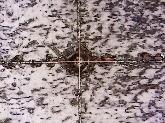

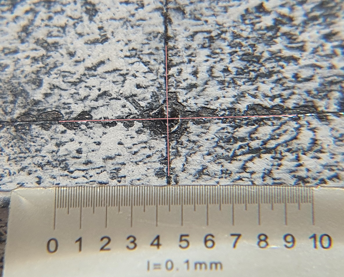

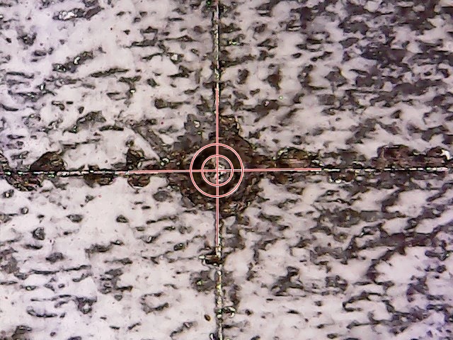

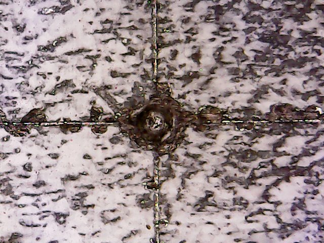

    The punch marl looks slightly to the right not centered.
    Ralph

    It looks like it is off center and also lower, due to the tilt of the camera (perspective illusion), but it is perfectly centered (is the best my old hands can do). Thanks Ralphxyz!

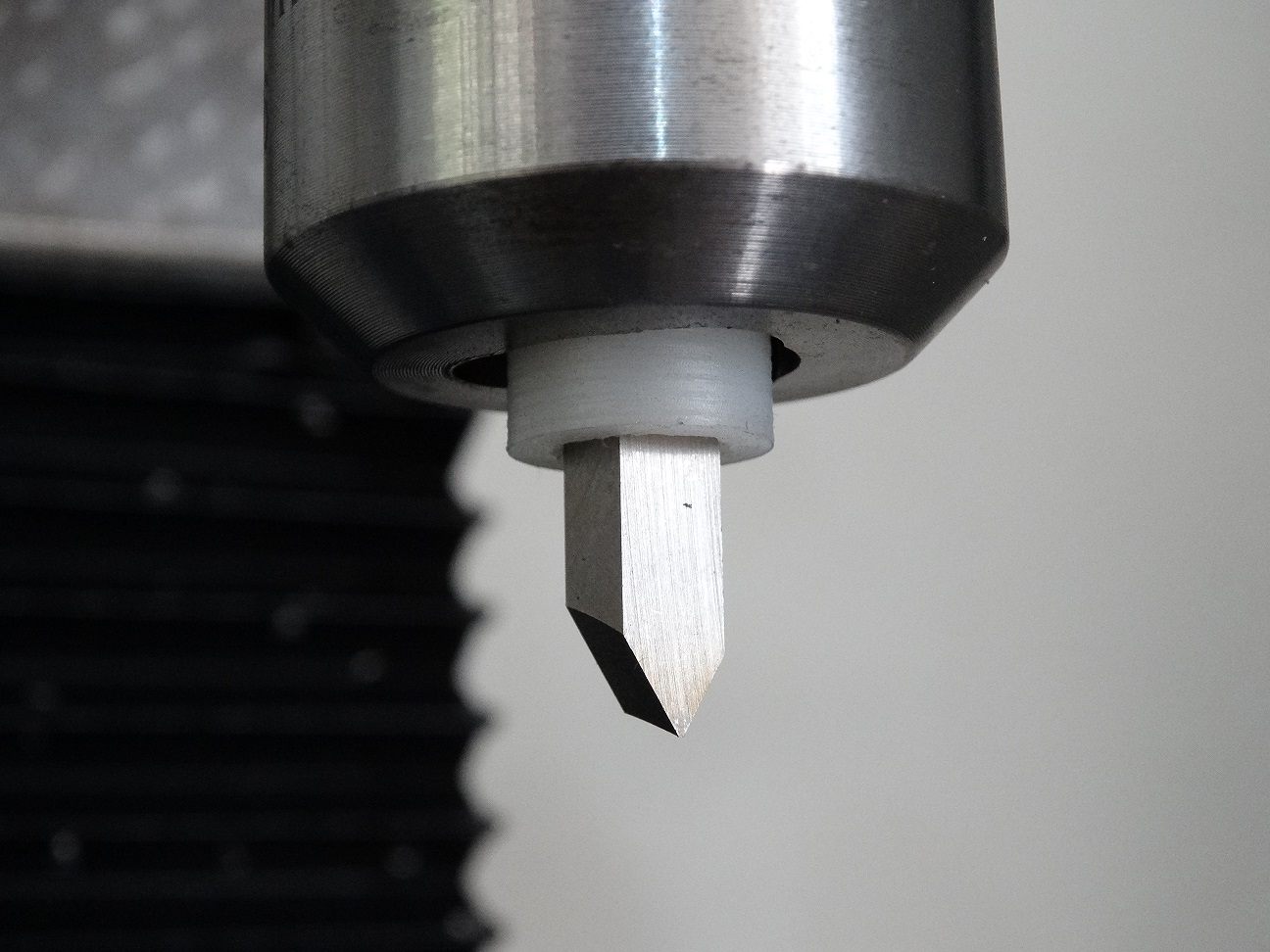

    The tool and method are explained here in another post (Marking GAUGE CALIPER). But there are other options, for example, attach to the chuck lathe and make the divisions using the plate's own fixing nut. You can also use a saw disk as a template (here are some examples) or a dividing head. If you do not have any of these features, then the old tracing method should be used. Thanks again Ralphxyz!

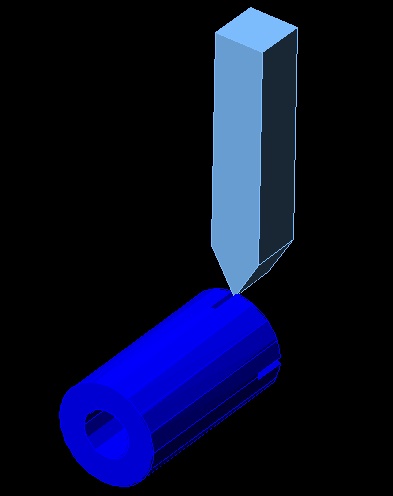

    machining 4 all's Tools
    I made it on the milling machine, with the help of a dividing head (this head I have shown here too). I attached the tool (photo) to the mandrel and moved the X axis by 6.0mm. After the process, I painted with black automotive paint and sanded (mesh 220) on the lathe. It was very easy and fast! But as I said, you can use other methods if you don't have a splitter or a milling machine...
