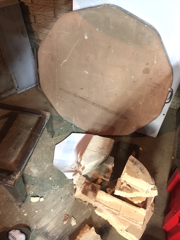

The parts I have are from the art department where I taught.
It had been over fired, declared unsafe for use in the in the
school and discarded. I could not resist taking it home. I was
only able to rescue the top, the bottom, and one section. The
rest was trashed before I got to them.

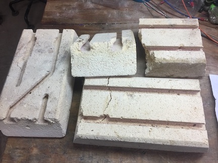

Top, and remnants of the bottom after I cut it
up to make a top and bottom for the furnace.
Attachment 49043
Each section of the original was built from 20 bricks.
Each brick 2 1/2 x 4 1/2 x 9”. Many of the bricks were
broken but I was able to salvage a enough good pieces
to make what I needed and have a few extras left.

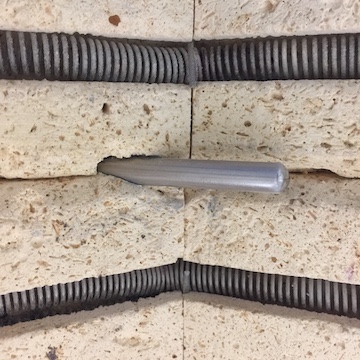

Attachment 49044

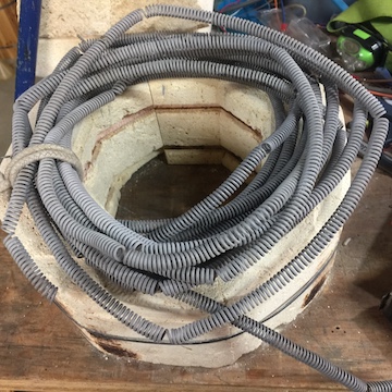

There were 2 - 14 ft heating elements coiled with 14 gauge
Kanthal wire. The coils were too brittle to reshape. Also the
wire is to large a gauge to use in my small furnace. But I will
save it anyway in case I can learn how to anneal it.
Attachment 49045

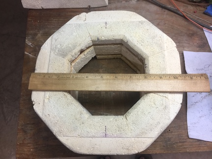

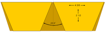

One original brick, 2 1/2 x 4 1/2 x 9 yielded
two 2 1/2 x 4 3/8 x 4 1/2 segments.
Attachment 49046

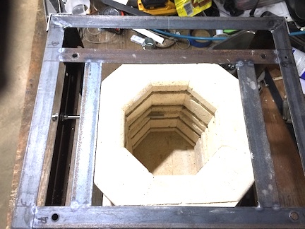

Eight segments were assembled into one octagon
layer. The segments are held together by stainless
steel hose clamps. Two of those octagons provide a
chamber 5 1/2” diameter by 9” high which will
accommodate a piece of 4” schedule 40 steel pipe
for the crucible. (from my “junk” collection)
Attachment 49047
To hold the sections together and attach a lid, 1/16 x 1 x 1 steel
angle was used to build a framework. I collected this material
from the trash behind Tractor Supply. There is 3” of air space
around the heat chamber to provide space for loose pearlite
insulation if necessary.
The top section is held in place by a frame inside a larger
external frame. The top of the brick is relieved so the brick
is flush with the steel.
Attachment 49048

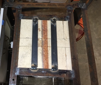

The bricks for the top and bottom where salvaged
from the bottom of the donor kiln. The bottom frame is
similar to the top with reinforcing bars added
to support the fragile brick and weight of the filled crucible.

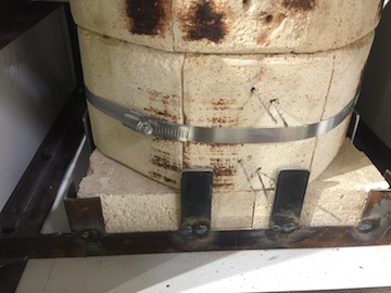

Attachment 49049
The bottom section just sets on the bottom bricks,
it is held in place by tabs welded to the bottom frame.
Also notice the element ends through holes in the brick.

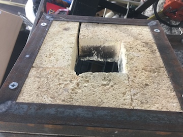

The lid has a hole to vent fumes when necessary,
allow adding material, adding flux and skimming
the melted metal. The top half of the lid frame is
extended to provide a hinge point for the lid. The
screws that hold the lid “sandwich” together also
hold eye bolts for handles.

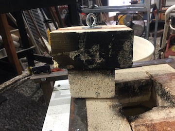

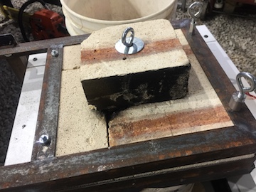

Attachment 49051
The lid plug is two pieces of brick held together
with an eye bolt. The black is soot from the burning
of paint from the aluminum cans I melted during
the first test firing.

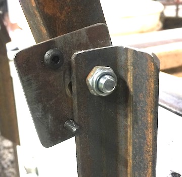

Attachment 49054

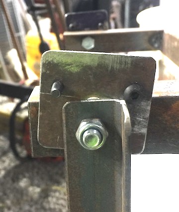

When the lid is open, a plate on each side with 2 machine
screws for pins hold the lid up and prevent it from falling
backward when open.

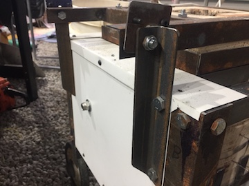

Attachment 49055
The backside of the furnace is reinforced with a
crossbar that supports uprights for the hinges
and the thermocouple probe.

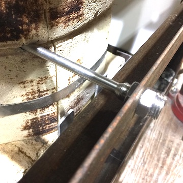

Attachment 49056
The probe slides through a groove between the
two layers of firebrick. I am not certain this is
the optimum place, but there are not many options.
Time will tell.

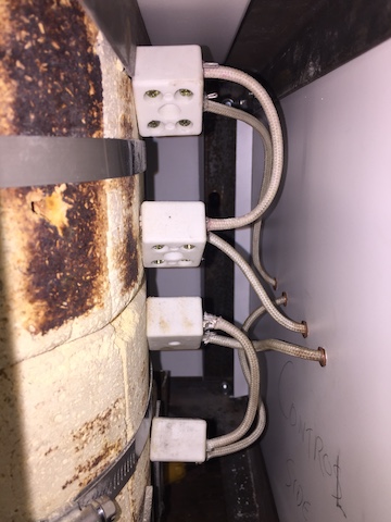

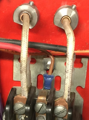

The high temperature connections are made
with ceramic junction blocks. The 4 individual elements
are wired in 2 pairs of 2. (This turned out to not be a good idea.)
The high temperature wire passes through the sheet metal panel
in a smooth flared copper tube.
Attachment 49059
The copper tubes are secured inside the control box with
sleeves and set screws. The fiberglass insulation
is tough but frays easily when stripping for connections.
A drop of super glue massaged into the insulation
before cutting and stripping solves that issue.
USE GLOVES for that.

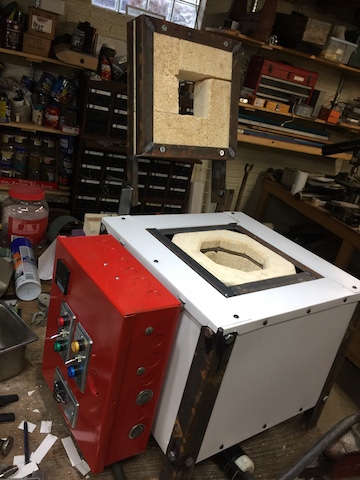

Attachment 49060
The completed furnace ready for testing. Plans were
to have the control box separate, out of the way of hot
processes. When attached to the furnace, the controller
is too low for my old eyes to get a good view and
to access the buttons for adjustment. But I did not have
the components to make it remote, so I mounted it on the furnace
to allow testing things.

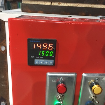

Attachment 49061

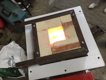

Initial testing went ok. Everything worked. It took
me a little time to figure out the programming on
the InkBird ITC-106VH PID controller. But after my
fat fingers learned with each button was for things
went smoothly.
Attachment 49062
It soon became apparent that I had pushed the
limits of the heating elements too far. While the
furnace heated up quickly the elements were
getting too hot. You can tell by the color that the
elements are much hotter than indicated on the
controller. The sensor is not able keep up with the
temperature of the element itself.

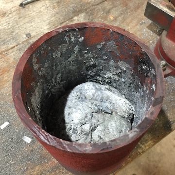

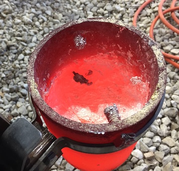

Attachment 49063
I was able to melt some pop cans on the low setting
which is 1440 watts. This kept the elements cooler but
was VERY SLOW reaching temperature and recovering
when adding more metal to the crucible.

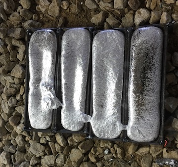

Attachment 49064
And cast some ingots
Attachment 49065
