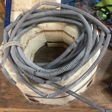

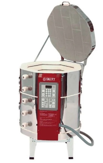

    Design was influenced considerably by items that I have been collecting over the years with
    an eventual foundry in mind. The most influential component was the fire brick from an old
    ceramic kiln. Similar to this one. The one shown is an octagon.
    The kiln I got parts from was a decagon.
Name:	01 skutt kiln.jpg

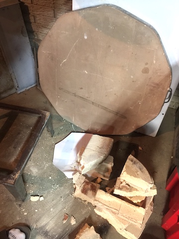

    The parts I have are from the art department where I taught.
    It had been over fired, declared unsafe for use in the in the
    school and discarded. I could not resist taking it home. I was
    only able to rescue the top, the bottom, and one section. The
    rest was trashed before I got to them.
    Top, and remnants of the bottom after I cut it
    up to make a top and bottom for the furnace.
Name:	02 top and bottom.jpg

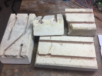

    Each section of the original was built from 20 bricks.
    Each brick 2 1/2 x 4 1/2 x 9”. Many of the bricks were
    broken but I was able to salvage a enough good pieces
    to make what I needed and have a few extras left.
Name:	03 Fire Brick.jpeg

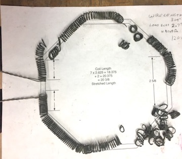

    There were 2 - 14 ft heating elements coiled with 14 gauge
    Kanthal wire. The coils were too brittle to reshape. Also the
    wire is to large a gauge to use in my small furnace. But I will
    save it anyway in case I can learn how to anneal it.

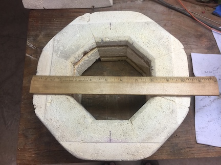

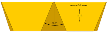

    One original brick, 2 1/2 x 4 1/2 x 9 yielded
    two 2 1/2 x 4 3/8 x 4 1/2 segments.
Name:	05 segments.jpg

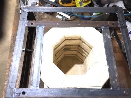

    Eight segments were assembled into one octagon
    layer. The segments are held together by stainless
    steel hose clamps. Two of those octagons provide a
    chamber 5 1/2” diameter by 9” high which will
    accommodate a piece of 4” schedule 40 steel pipe
    for the crucible. (from my “junk” collection)
Name:	06 octagon Layer.jpeg

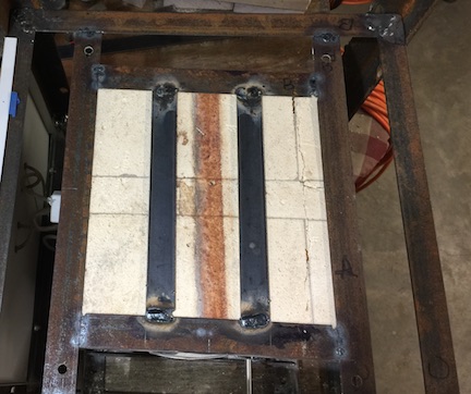

    The bricks for the top and bottom where salvaged
    from the bottom of the donor kiln. The bottom frame is
    similar to the top with reinforcing bars added
    to support the fragile brick and weight of the filled crucible.
Name:	08 Bottom.jpg

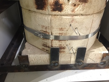

    The bottom section just sets on the bottom bricks,
    it is held in place by tabs welded to the bottom frame.
    Also notice the element ends through holes in the brick.

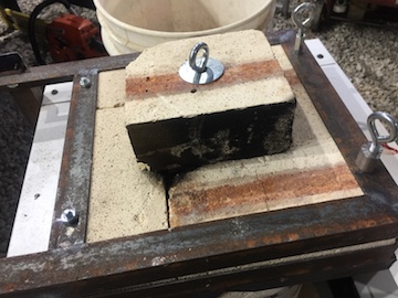

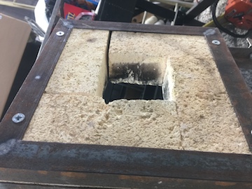

    The lid has a hole to vent fumes when necessary,
    allow adding material, adding flux and skimming
    the melted metal. The top half of the lid frame is
    extended to provide a hinge point for the lid. The
    screws that hold the lid “sandwich” together also
    hold eye bolts for handles.

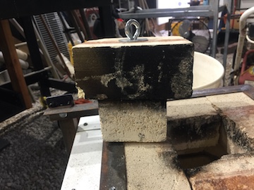

    The lid plug is two pieces of brick held together
    with an eye bolt. The black is soot from the burning
    of paint from the aluminum cans I melted during
    the first test firing.

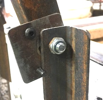

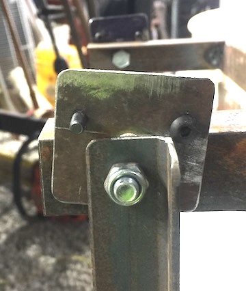

    When the lid is open, a plate on each side with 2 machine
    screws for pins hold the lid up and prevent it from falling
    backward when open.
Name:	14 Hinge open.jpg

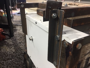

    The backside of the furnace is reinforced with a
    crossbar that supports uprights for the hinges
    and the thermocouple probe.
Name:	15 probe.jpg

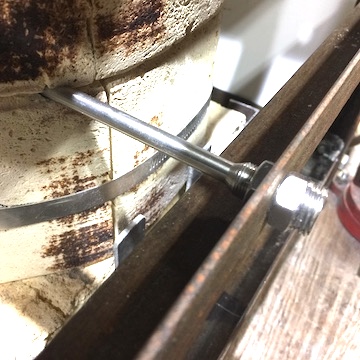

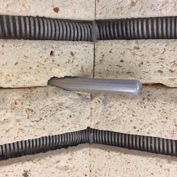

    The probe slides through a groove between the
    two layers of firebrick. I am not certain this is
    the optimum place, but there are not many options.
    Time will tell.
Name:	16 probe inside.JPG

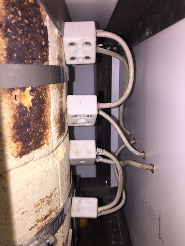

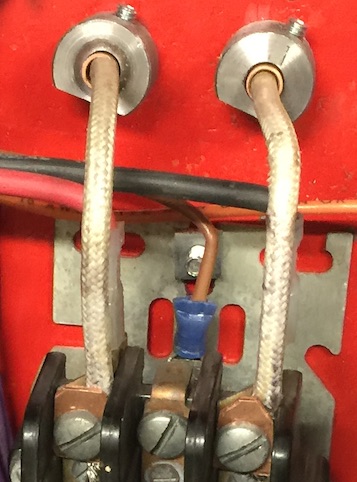

    The high temperature connections are made
    with ceramic junction blocks. The 4 individual elements
    are wired in 2 pairs of 2. (This turned out to not be a good idea.)
    The high temperature wire passes through the sheet metal panel
    in a smooth flared copper tube.
Name:	18 connections.jpg
    The copper tubes are secured inside the control box with
    sleeves and set screws. The fiberglass insulation
    is tough but frays easily when stripping for connections.
    A drop of super glue massaged into the insulation
    before cutting and stripping solves that issue.
    USE GLOVES for that.
Name:	19 wire connections.jpg

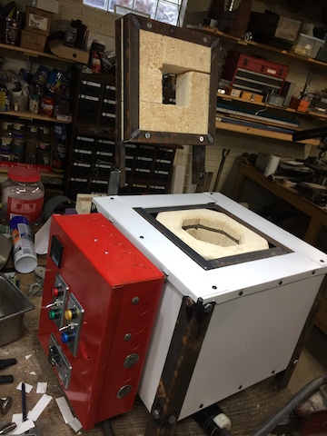

    The completed furnace ready for testing. Plans were
    to have the control box separate, out of the way of hot
    processes. When attached to the furnace, the controller
    is too low for my old eyes to get a good view and
    to access the buttons for adjustment. But I did not have
    the components to make it remote, so I mounted it on the furnace
    to allow testing things.

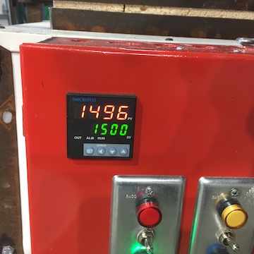

    Initial testing went ok. Everything worked. It took
    me a little time to figure out the programming on
    the InkBird ITC-106VH PID controller. But after my
    fat fingers learned with each button was for things
    went smoothly.

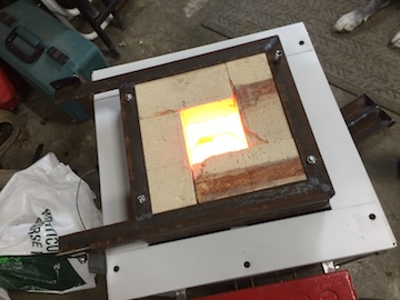

    It soon became apparent that I had pushed the
    limits of the heating elements too far. While the
    furnace heated up quickly the elements were
    getting too hot. You can tell by the color that the
    elements are much hotter than indicated on the
    controller. The sensor is not able keep up with the
    temperature of the element itself.

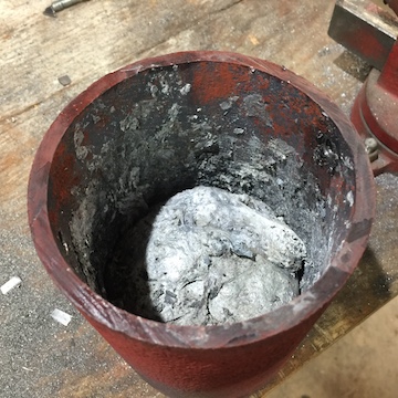

    I was able to melt some pop cans on the low setting
    which is 1440 watts. This kept the elements cooler but
    was VERY SLOW reaching temperature and recovering
    when adding more metal to the crucible.
Name:	23 crucible.jpg

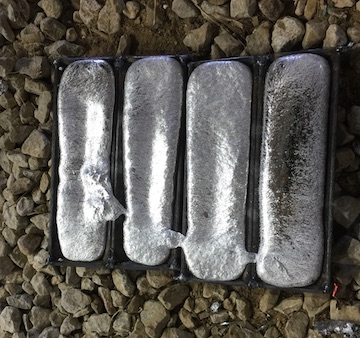

    And cast some ingots
Name:	24 ingots.jpg

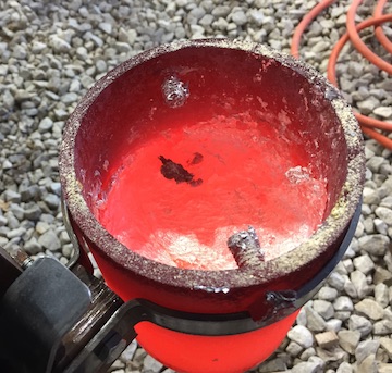

    After the first melt, knowing I was going to have to
    remake the elements anyway I started another melt
    on the high setting, 5760 watts. This worked very well
    for a while. But soon the elements began to burn out.
    Leaving me with this.
Name:	25 crucible.jpg
    And this.
Name:	26 damaged element.JPG
