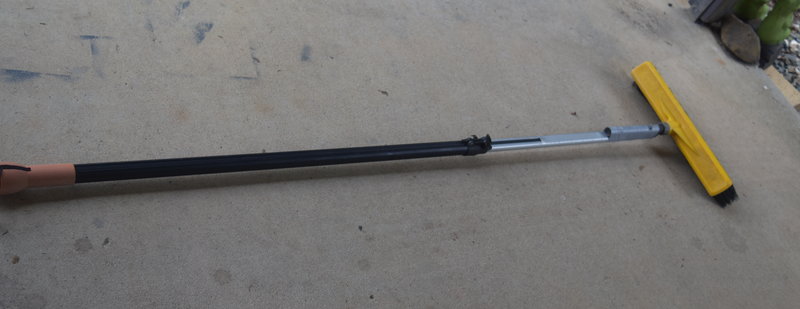

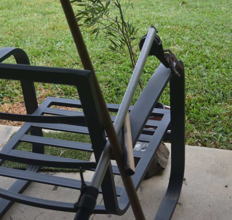

The result is an extending broom. I had a broken extending pruner (as everyone has) and cut off the broken head. I didn't want to cut a perfectly good broom handle so made a V jig and removed a section of a large dowel I had lying around (as you do).I taped it to the flat part of the original pruner top & fixed with hex (wood) screws. Easy Peasy!:rocker:
Attachment 28053
There you have it.
Attachment 28054
I can remove the head for the normal yard broom.
