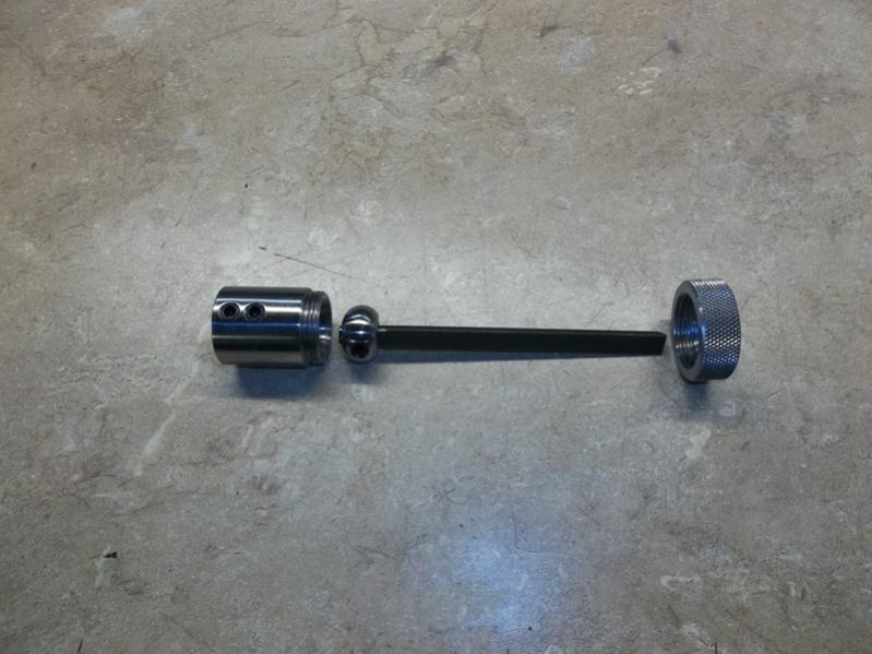

Attachment 2131

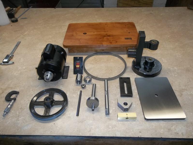

Above shows all the machined and finished pieces before assembly

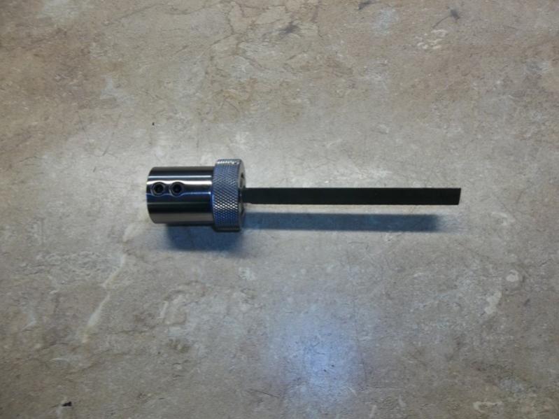

Attachment 2132
Above shows the ball with a file in it, the socket is to the left of the file, the knurled nut is to the right of the file, all made from 4140 then heat treated and polished
Attachment 2133
Above shows the file inserted into the ball and socket with a knurled retaining nut, the socket and nut both have the same radius machined into them as the ball

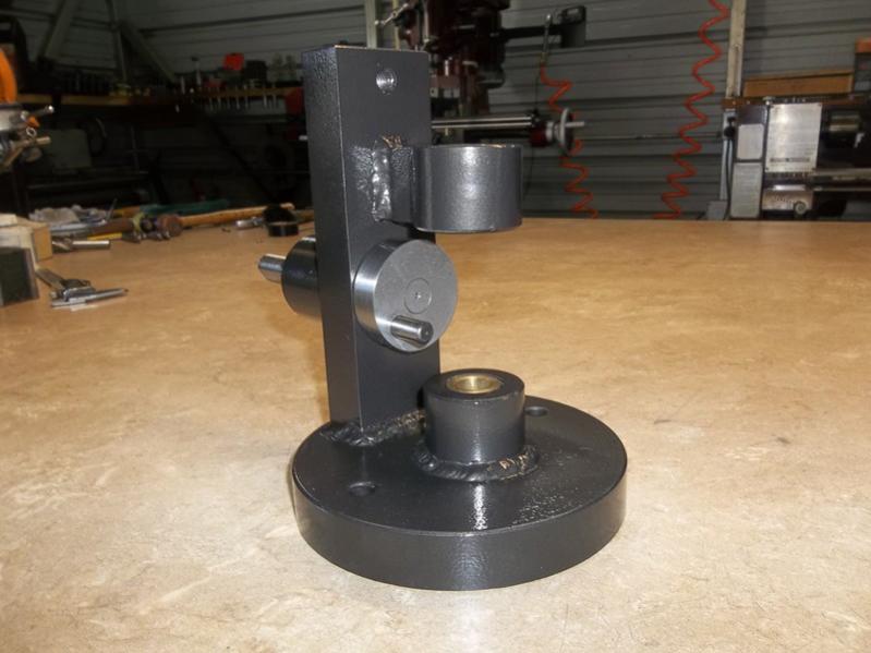

Above shows the machine housing, fabricated from 1018 CRS, painted Rust-Oleum black hammered finish, the file assembly is just sitting on top

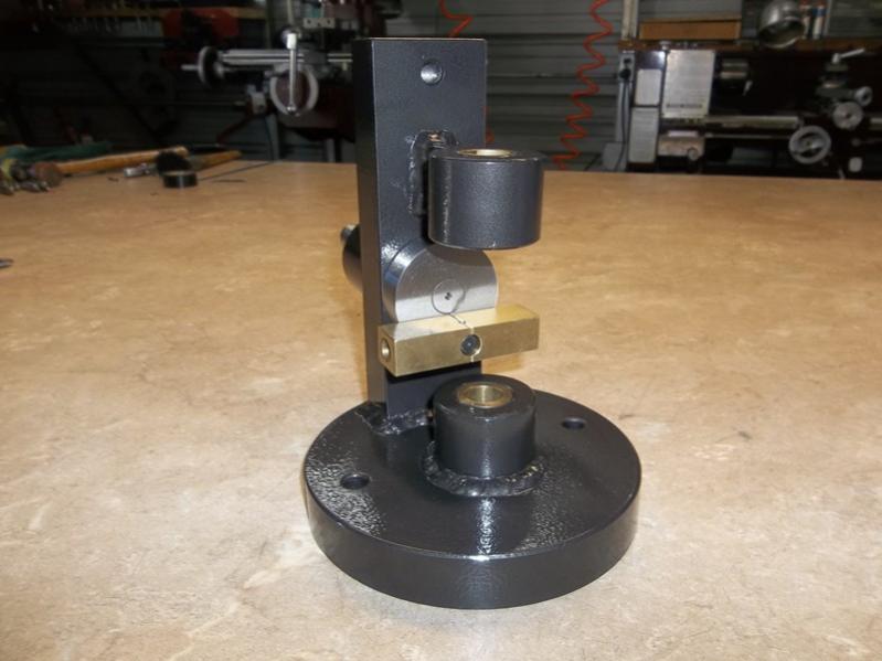

Attachment 2136

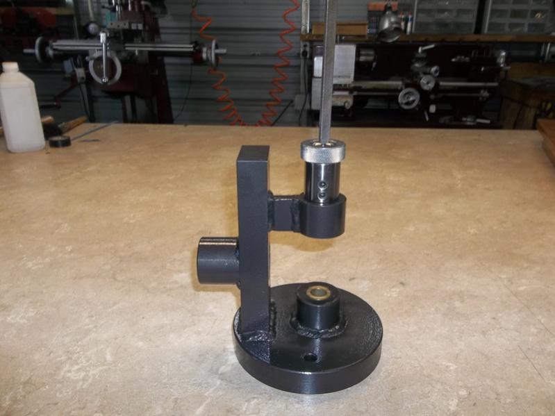

Above shows the housing with the crankshaft and bronze linear bearing fitted over the crank pin, the crankshaft was made from 2" round pre-heat treated 4140, the crank pin is a hardened 3/8" dowel

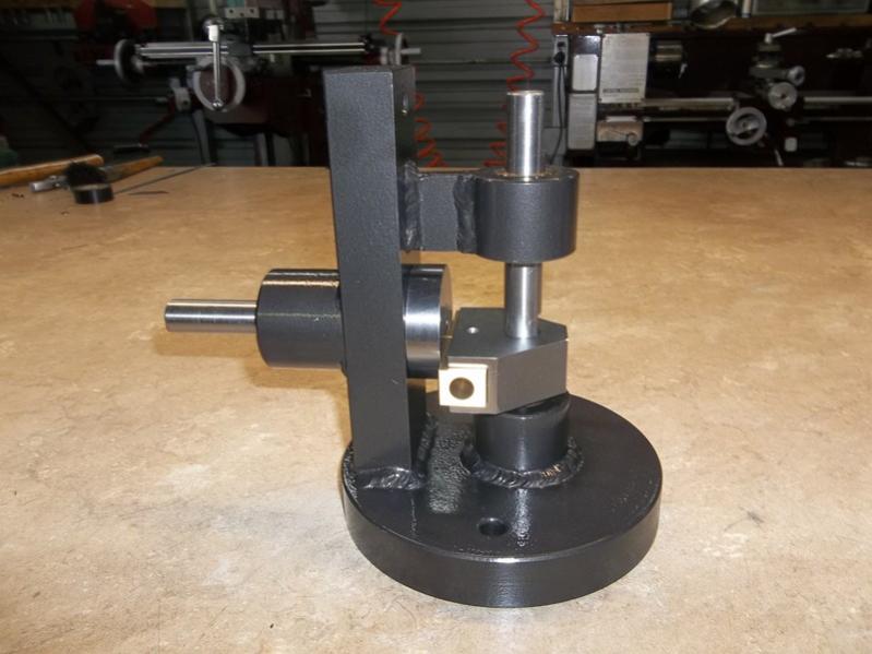

Attachment 2137

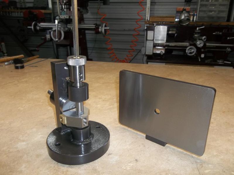

Above shows the linear bearing housing which is 4140 heat treated steel, slipped over the bronze bearing with the vertical shaft locked into the bearing housing by two 5/16" set screws

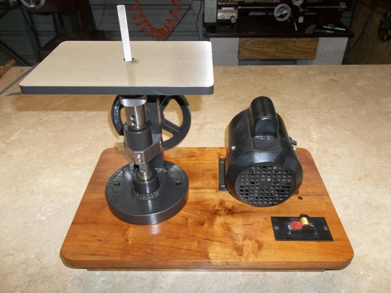

Attachment 2138
Above shows the housing with the file holder installed on the vertical shaft, the precision ground table is ready for installation, the table was made from .500" X 6" X 10" 1018 CRS

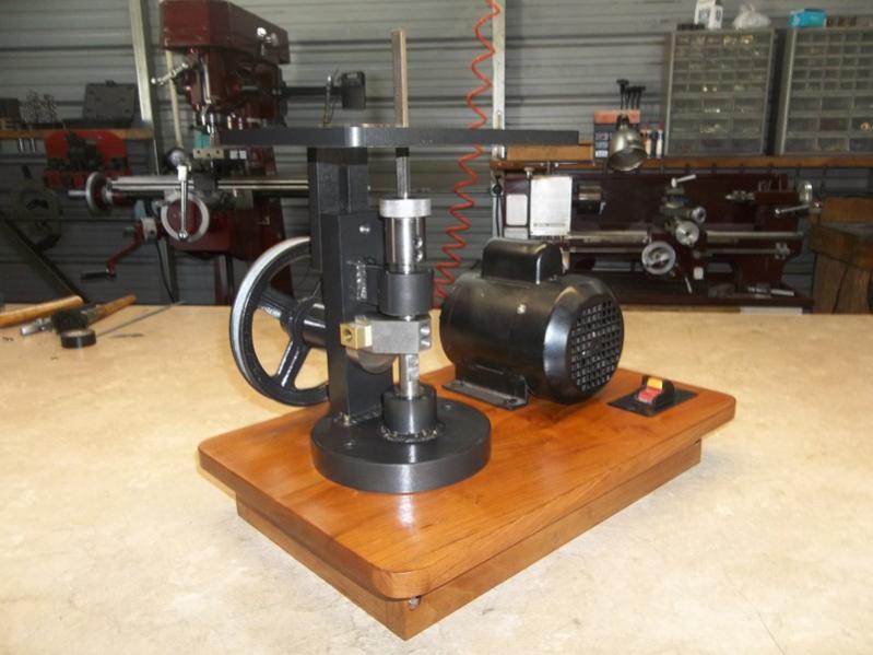

Attachment 2139
Above shows the machine completely assembled with it's motor and switch sitting on a cherry wood base
Attachment 2140
Above shows another view of completed machine
