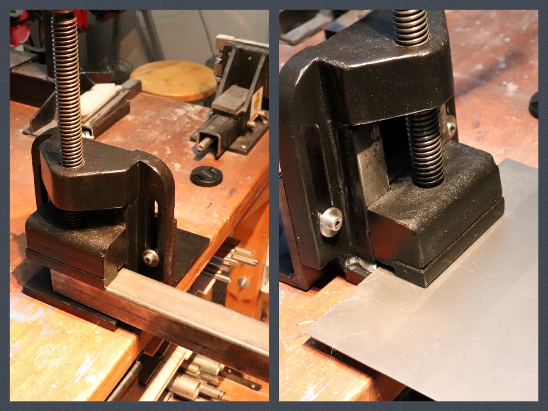

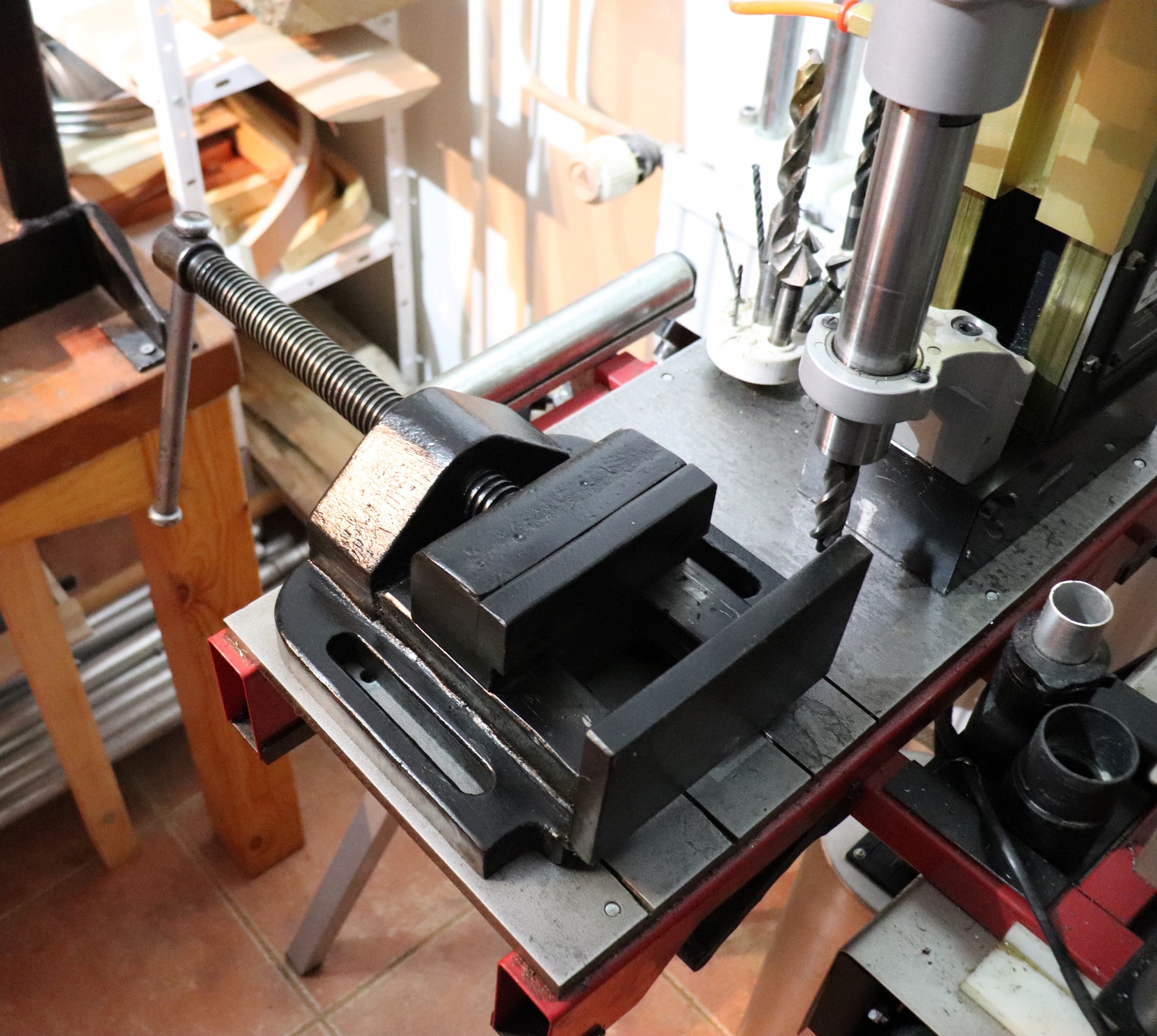

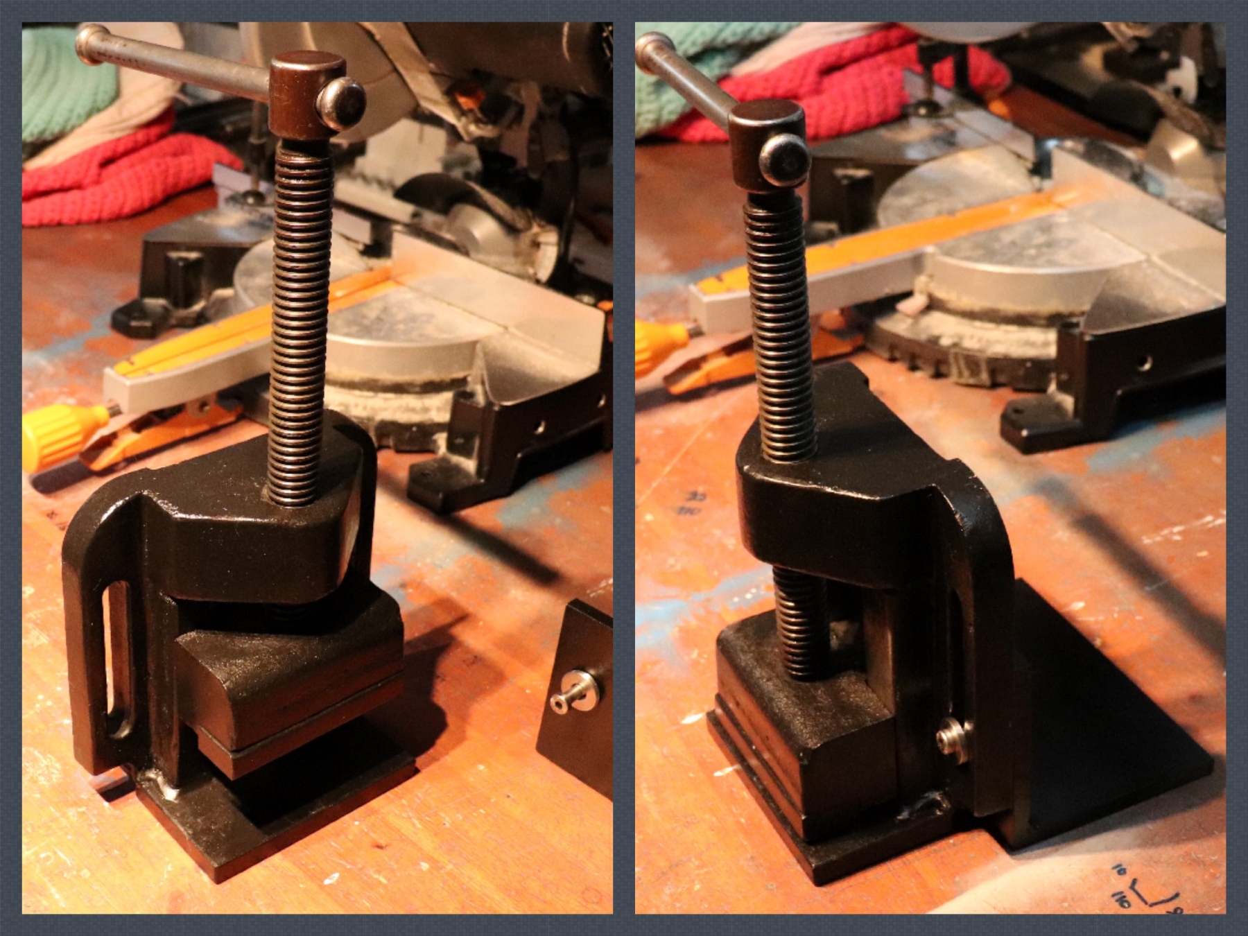

    Found a broken drill press vise.
    After years of use, it finally was drilled full of dimples and it was cracked. End piece was missing, but it tought it can still be usefull.
    Fixed it by:
    Straightening the end with angle grinder.
    Then, filled dimples with my Telwin stick welder.
    Finally made new end to it by welding 15mm plate to it.
    Weld edges are chamfered, weld size is about A5.
    Before welding i preheated it to 150 deg of celsius.
    Welds are made using Esab OK 78.16 welding rod, 4mm and 144A.
    Then i stretched the welds by hammering.
    Finally wrapped it to insulantion wool, to cool it down slowly.
    Also made removable support to it.
    Now i can use it vertical or horizontal position.
    Great for holding objects when cutting or grinding with angle grinder, specially plates!
    But, works as a drill press vise too, or as a small press..

    In this case. Preheating is necessary because mild steel cools down and also shrinks faster than cast steel. Heating, hammering and slowing cooling prevents joint to crack.
    I used tempilstik: Tempilstik® | Tempil
    To check the temperature before welding.
    Removed threaded rod and "slide", then heated the part in gas grill. Clamped the mild steel plate on its place and welded.
    I placed tack welds to the bottom, then welds to the top, removed clamps and welded sides. Finally bottom welds.
    Hammered all the welds and wrapped to insulation wool.
    When it was cooled down i cleaned the welds and removed splatters.

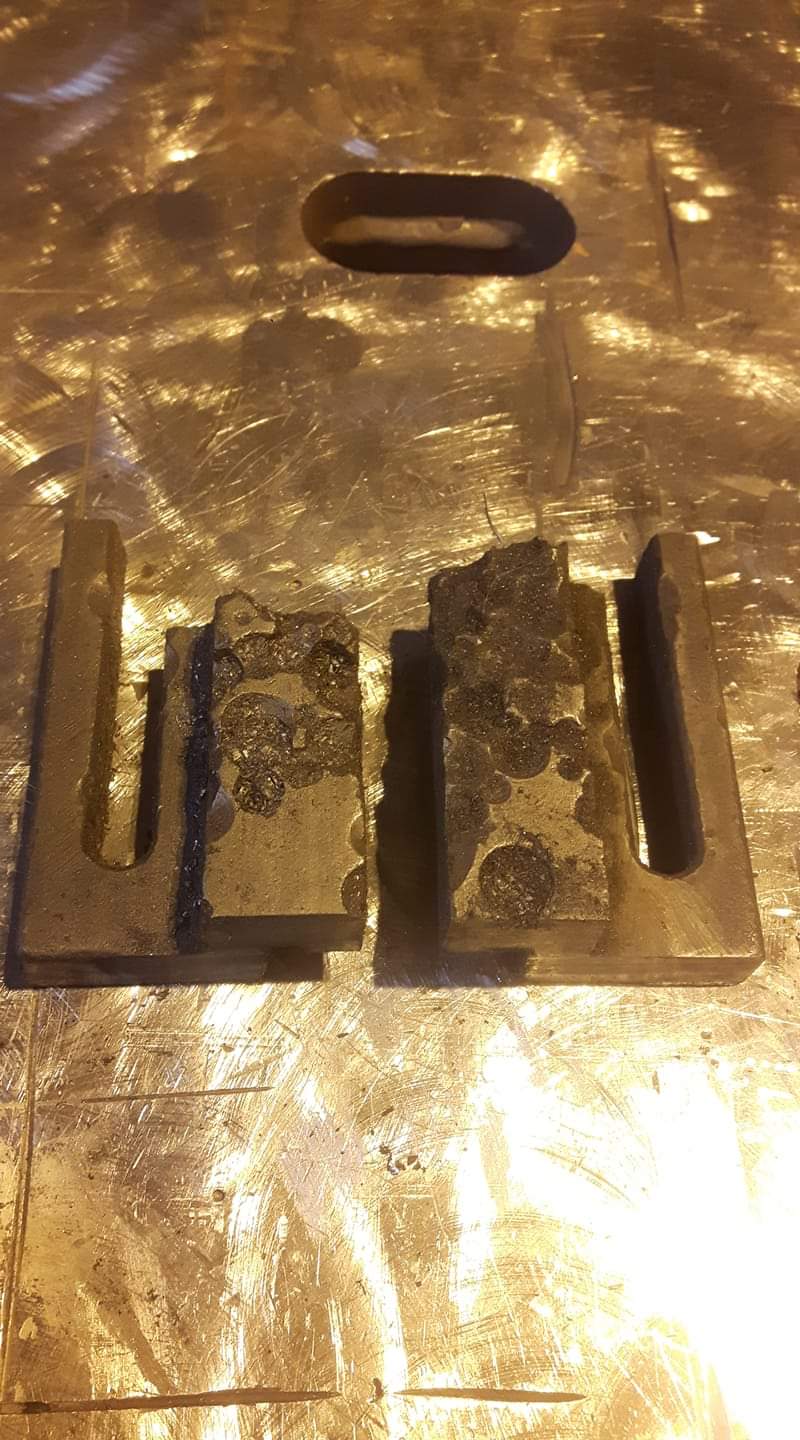

    Quote Originally Posted by NeiljohnUK View Post
    Nice job, I wonder if the end was originally removed for direct clamping larger objects?
    It was drilled cut. Straight edge is where i shortened it by myself.
    I filled some holes with welds, but those sections we're too bad condition, that i decided to shorten it.
