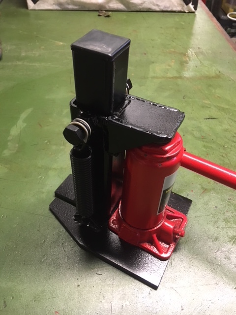

    Hi All

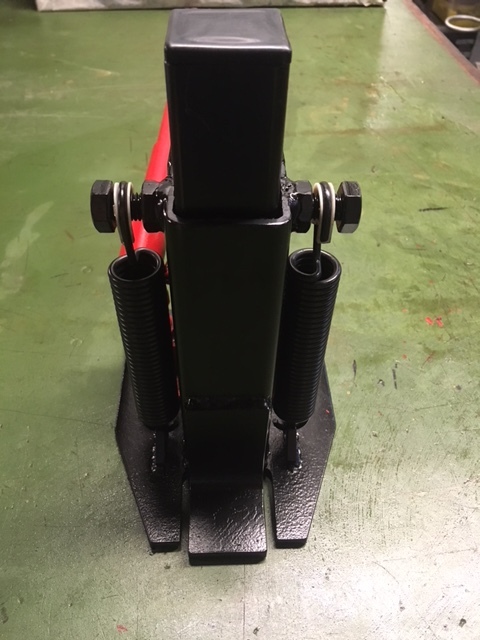

    I am always rearranging my workshop to house new equipment or trying to make more space. I normally use prybars and blocks to lift the machines, to put them on rollers to move them. This is not the safest way for the machine or myself. I am also not getting any younger so decided to make a Toe Lift Jack.

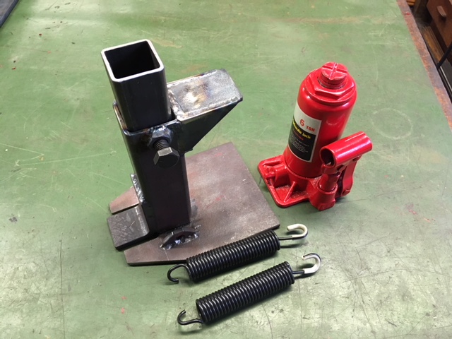

    There are many articles on toe jacks and designs. I have seen many that I have liked and decided to base mine on a box section design. There are three factors that lead me to this decision: Firstly I had the material to hand and secondly it seemed there was little machining required to fabricate the Toe Lift, and thirdly Fabricating meant I can keep my hand in at welding.
    Thank you to all who have posted their designs and ideas for this very useful workshop tool/lifting aid.
    Welded toe jack ready for painting.

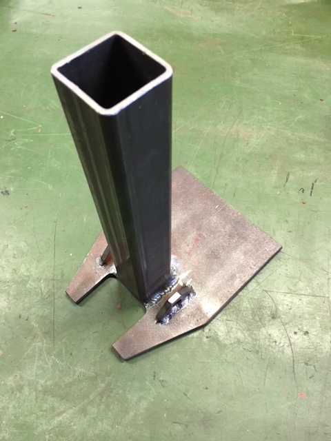

    Base plate and internal lift support.

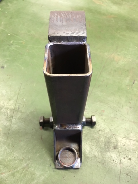

    Fabricated toe lift (photo showing toe lift upside down so the jack location ring which fits the hydraulic jack can be seen)

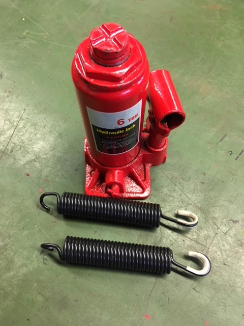

    Commercially purchased 6ton hydraulic jack and salvaged tension springs from an old washing machine.

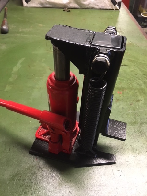

    Completed toe jack
    Thank you for viewing
    The Home Engineer

    What size tube and plate did you use please?

    Quote Originally Posted by bruedney View Post
    Hi
    Regards
    Bruce
    Hi
    The box was 50mm x 5mm and 40mm x 5mm so it would fit inside. The plate was 6mm for the base and 3mm for the top and some 6mm angle. The ring was made from a piece of tube to fit the top of the jack. To finish the jack I used cheap poundshop spray paint and a 40mm plastic tube end cap. The return springs are from a washing machine. It was all off cuts and bits I had around the workshop. I had to buy the Jack which was a cheap Ebay purchase about £10 (I think)
    Hope this helps
    The Home Engineer

    sorry i made it up as i went along out of scrap bits of material around the shop. The square tube is 50mm x 5mm wall and 40mm x 4mm so it slides in side the larger box. Other than that it was made to suit the jack. hope this helps
    The home engineer
