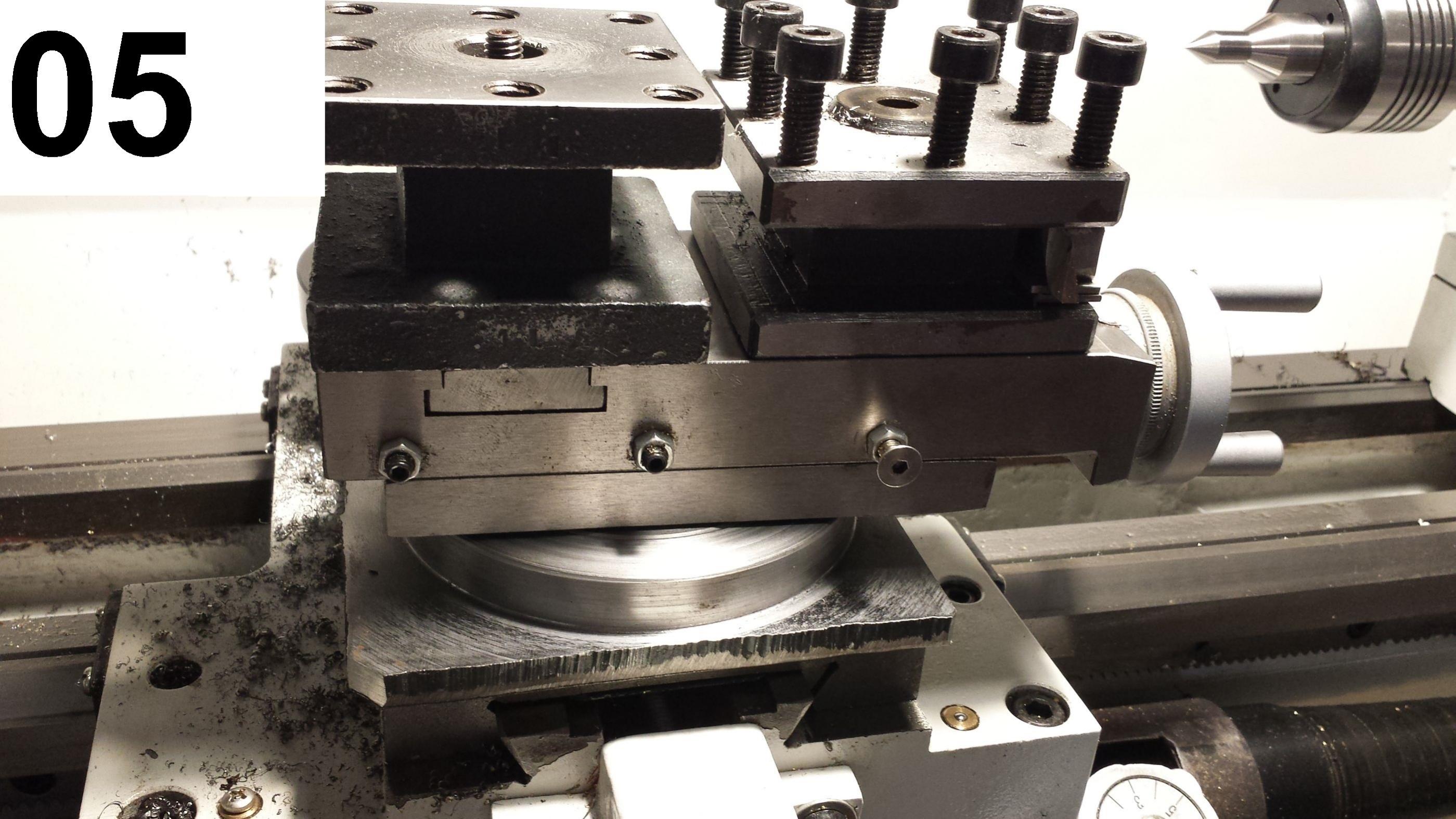

    Both; compound clamp and new pivoting base were made from 25 mm high tensile AH36 (shipbuilding) steel plate. In order to make it more rigid,
    I made new pivoting base which is bigger and which has recess for compound slide pivoting base. Compound clamp is bolted down with four M8 x 30 bolts.

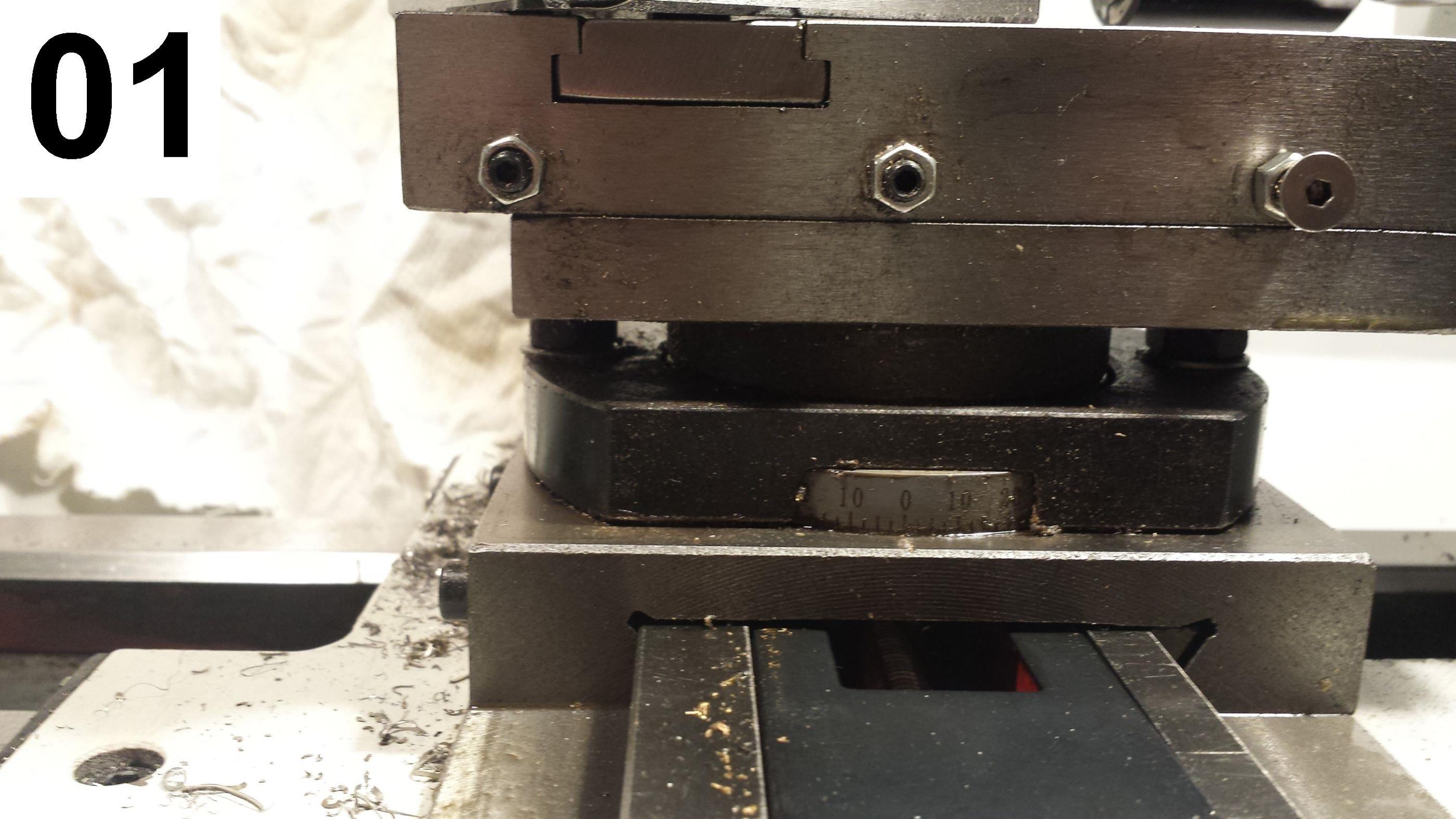

    Picture 01
    Original (very bad) design is 2 bolts compound clamp with bolts at wrong places. There is a lot of flexing, vibrations and chatter.

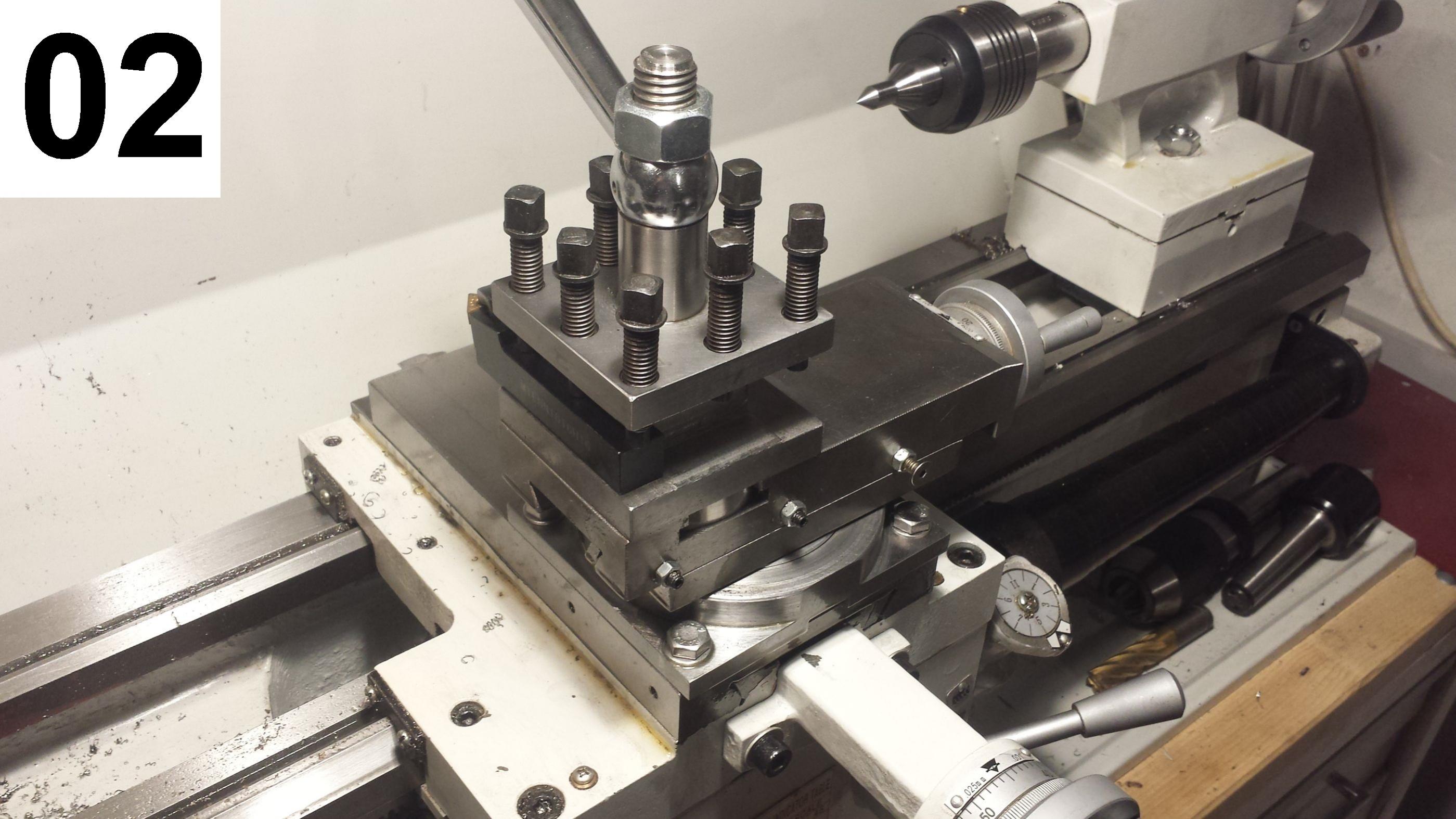

    Picture 02
    New 4 bolts compound clamp and new beefier 4-way tool post.
    I have no intention of installing QCTP, as for the last 30 years or so I was working on various heavy duty lathes with 4-way tool post. Shimming is not a problem at all, especially if the same size tools are used. For this tool post and 16 x 16 mm tools I need 2 mm shim. For 16 x 16 mm boring bar holder I need 9 mm high shimming.

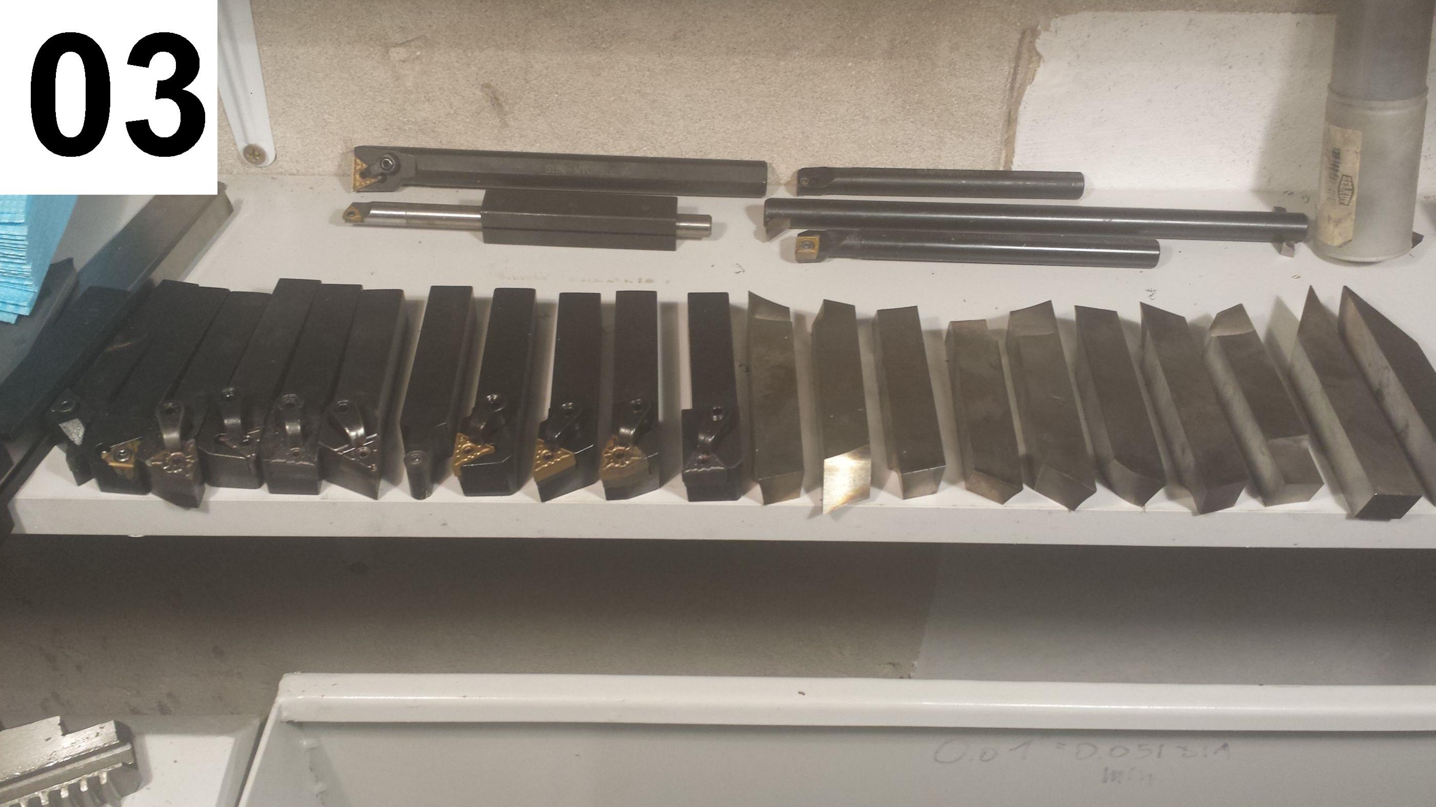

    Picture 03
    My complement of 16 x 16 cutting tools. I think I am done with buying turning tools. Only inserts from time to time.

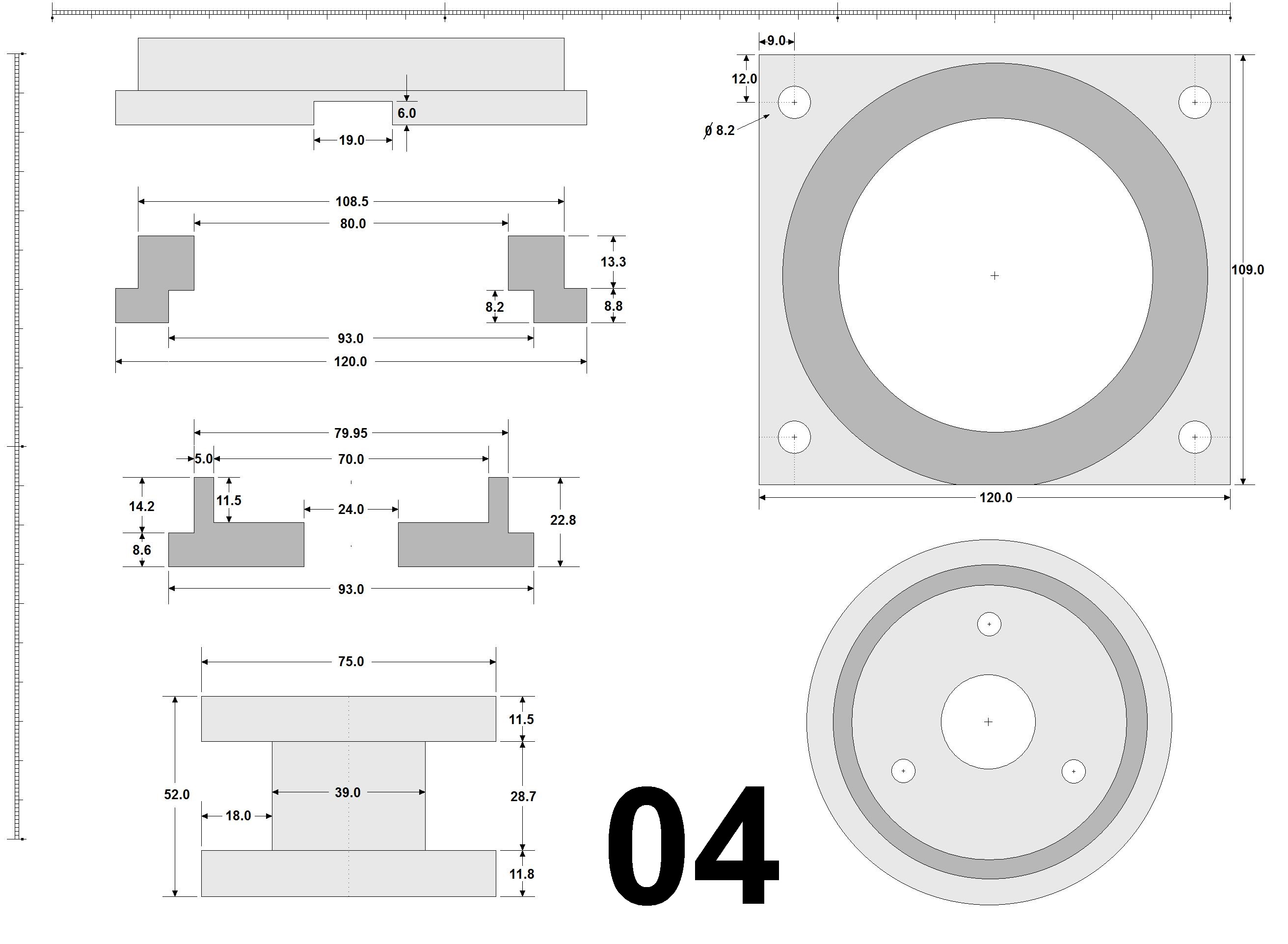

    Picture 04
    Drawing / clamp + 4-way tool post
    Pictures 05 and 06
    New beefy 4-way tool post compared with old low one. Observe that new tool post is unfinished rough product. This 75 x 75 mm tool post was purchased via Taobao in China for 12.50 USD. It is not completed product. Made of extra hard material and took me long time to square and polish it.

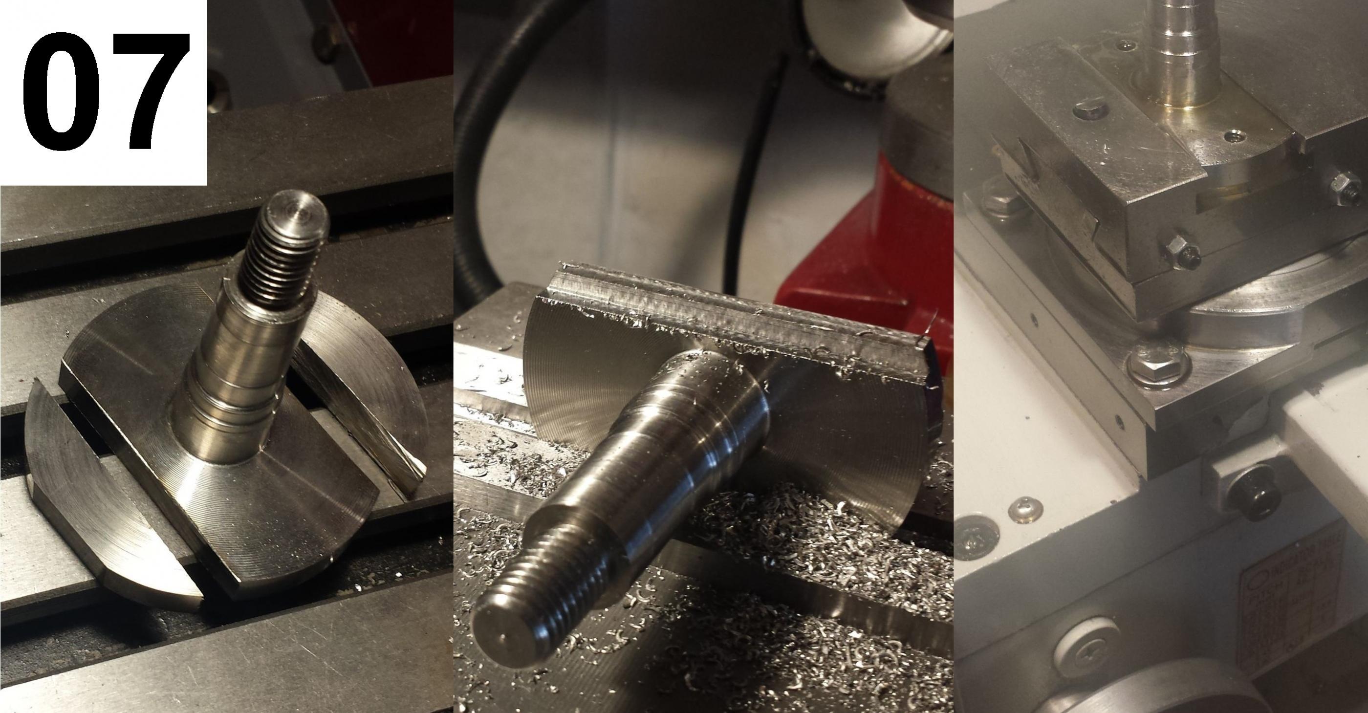

    Picture 07
    T-Bolt for tool post was made from one piece of 316 stainless steel round bar, diameter 70 mm.

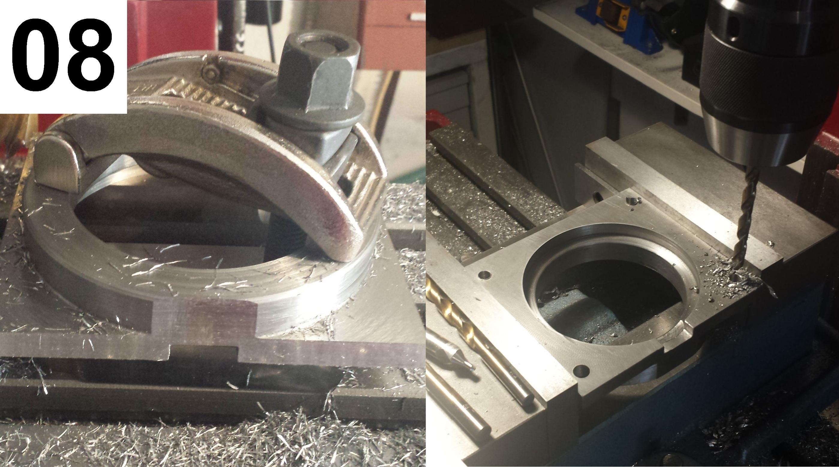

    Picture 08
    Squaring and drilling of compound clamp.

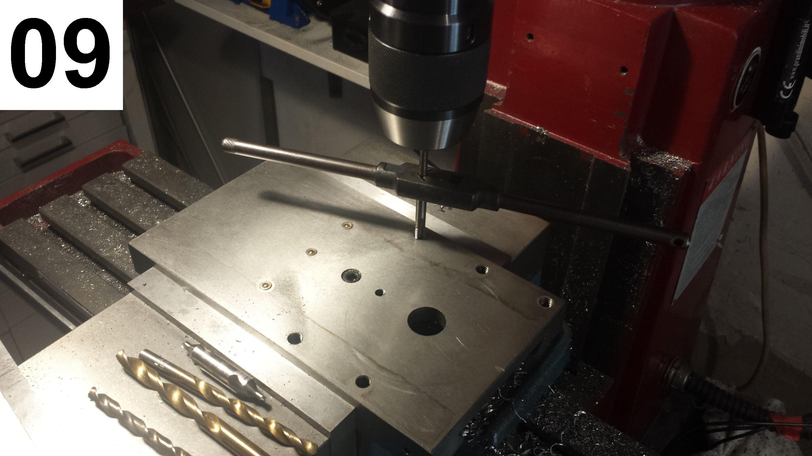

    Picture 09
    Drilling and threading of cross slide. (M8 thread)

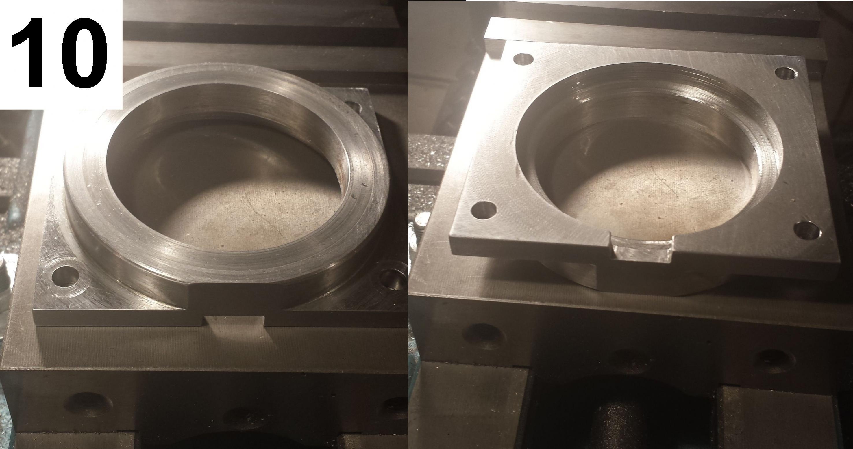

    Picture 10
    Compound clamp; top view and bottom view

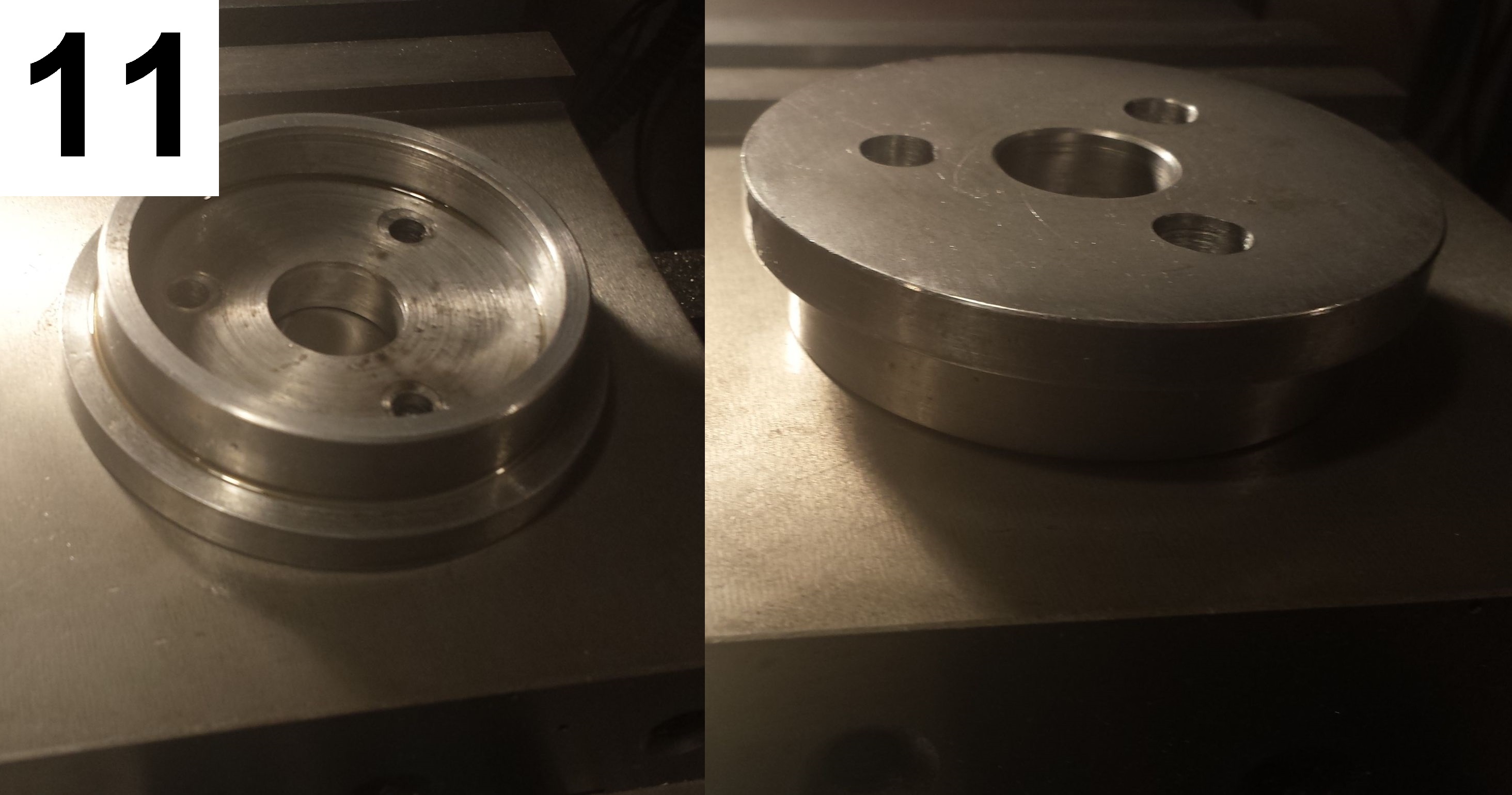

    Picture 11
    Pivoting base; top view and bottom view

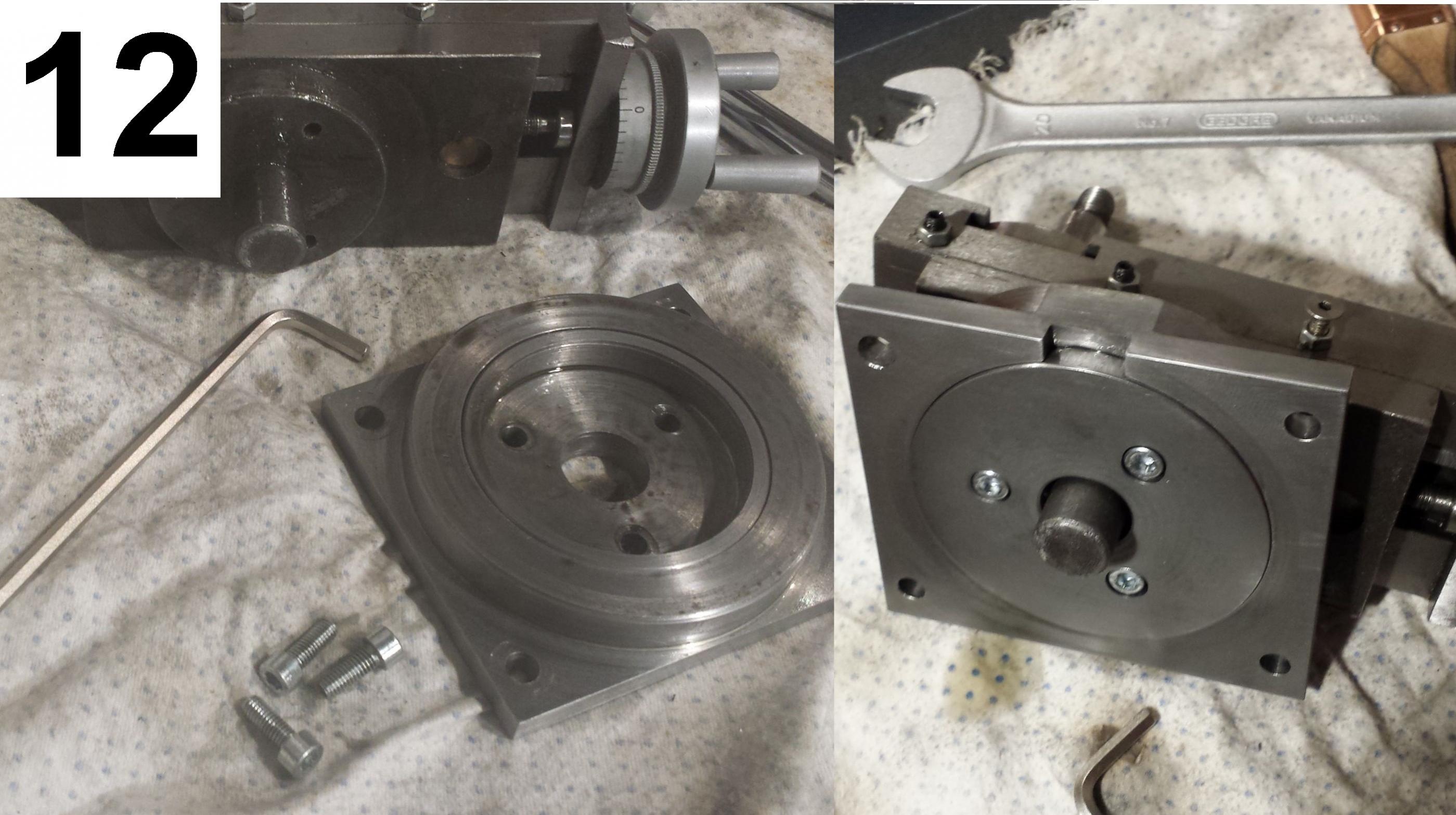

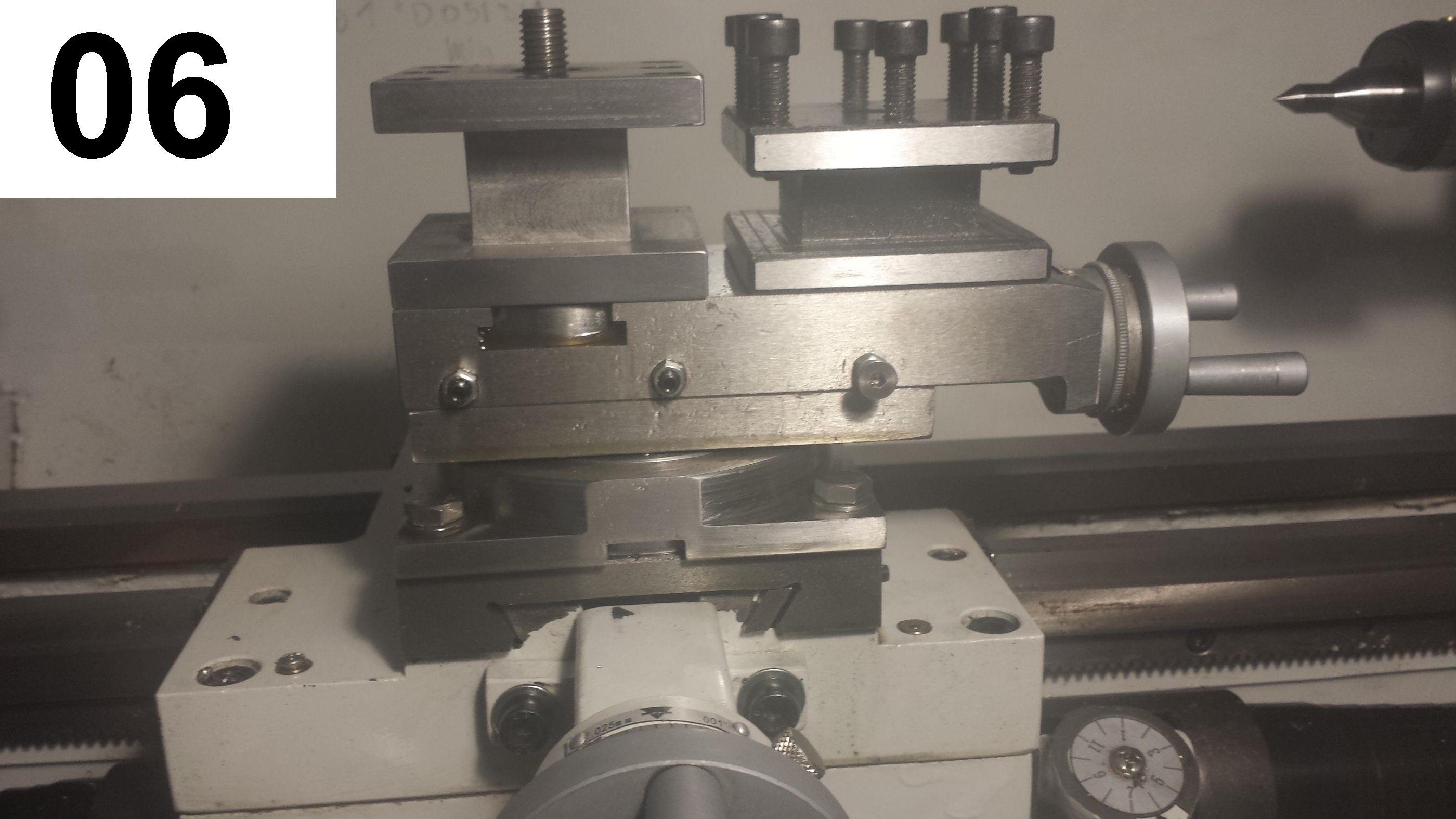

    Picture 12
    Compound slide and compound clamp parts and assembled

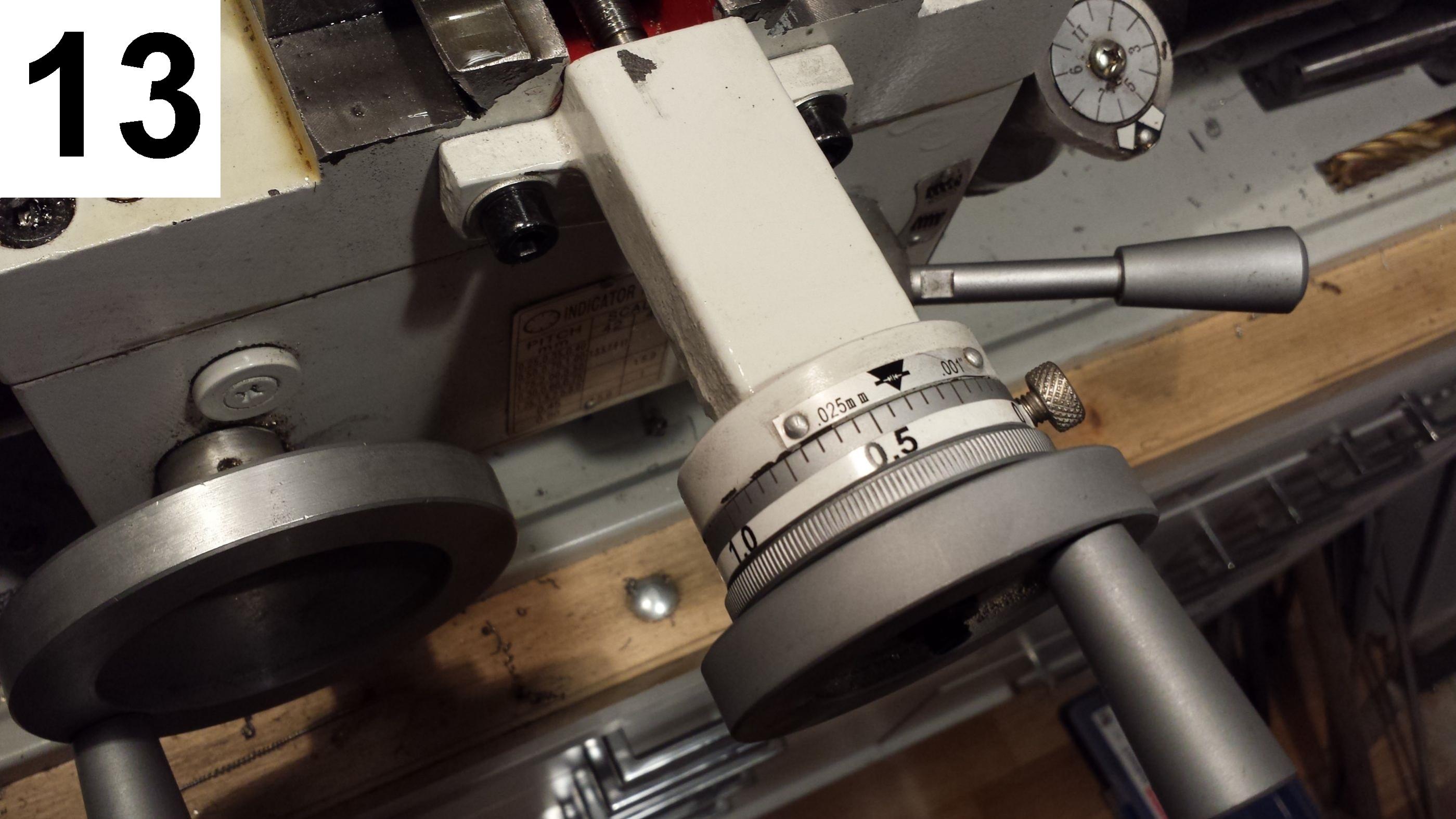

    Picture 13
    Dial ring and set screw. As the pitch of lead screw is metric (1.5 mm)
    and numbers on dial ring are in thousands of inch, I used dymo tape and
    print numbers in mm. 0 – 3 mm for diameter reading. Also installed set screw as original design with some weak leaf spring inside was disaster. Dial ring was rotating freely.

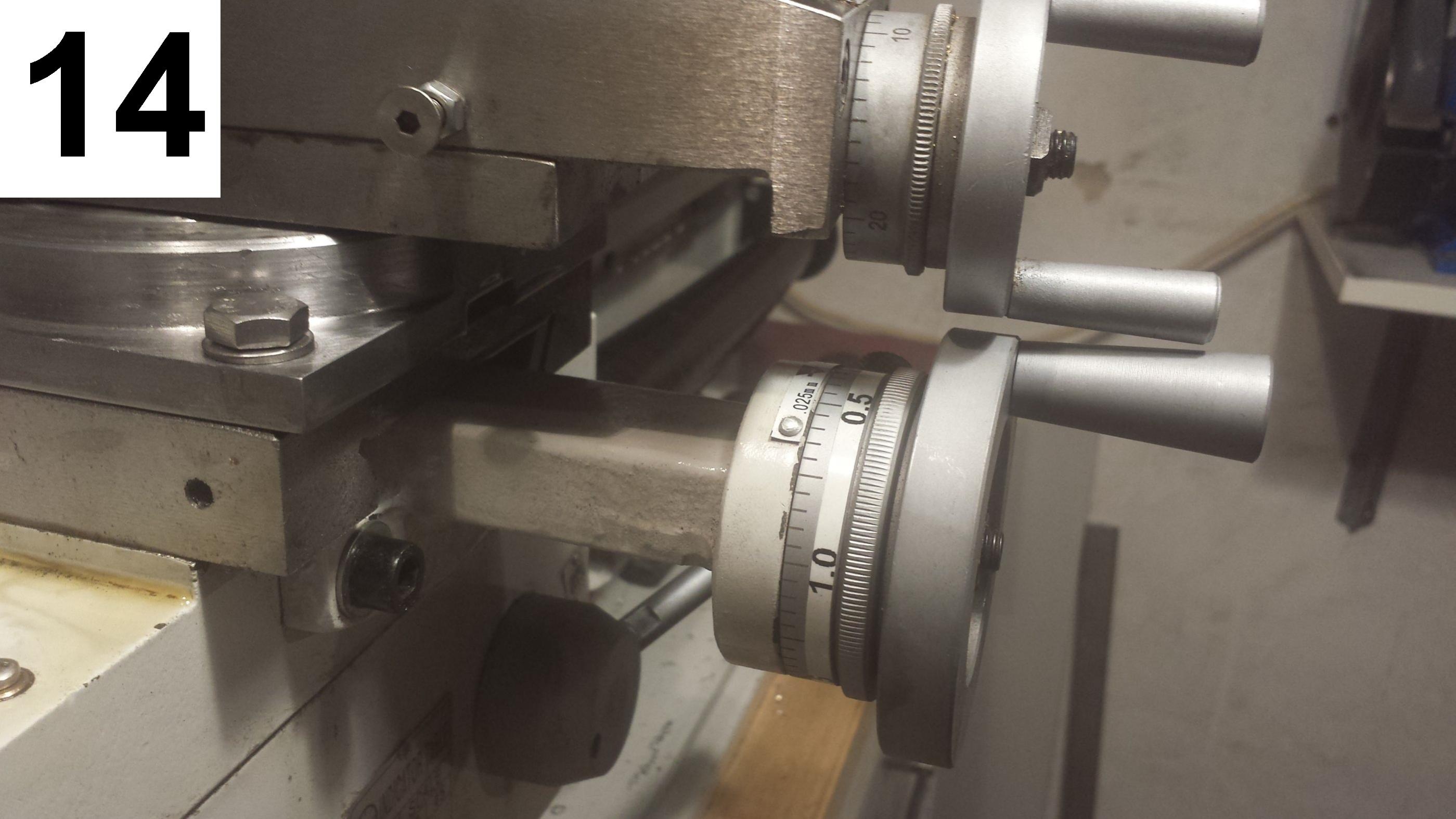

    Picture 14
    Clearance between handles. Top slide could not be lowered any more.

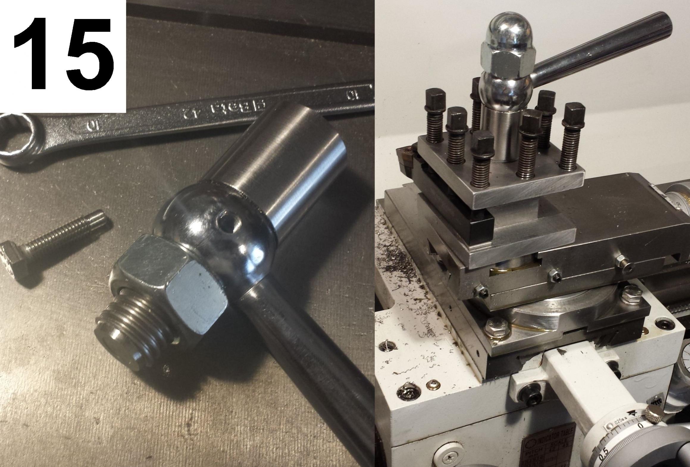

    Picture 15
    Tool post handle; made of stainless steel and Chinese chrome plated handle and M18 closed end cup nut on top of handle will avoid hand injuries.

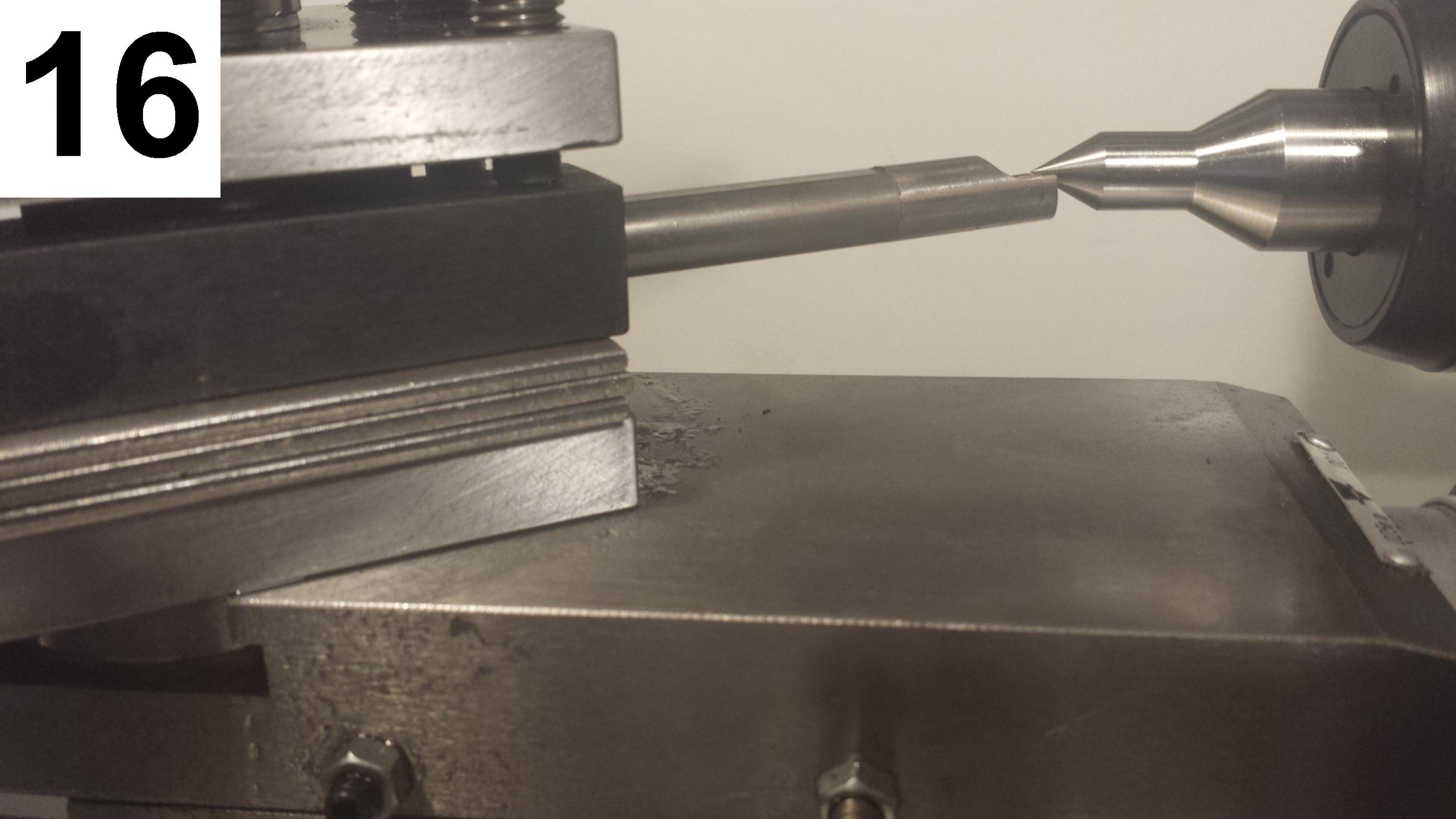

    Picture 16
    Three 3 mm shims are required for 16 x 16 mm boring bar holder.
    It is impossible to use this boring bar holder or bigger boring bars in old turret tool post or any size QCTP (AXA, BXA, 100, 200 etc) which are suitable for this size lathe. Also this cheap and extra hard 4-way turret tool post is (in my opinion) much better choice than any Aloris, Dorian, Phase II or cheaper Chinese wedge or piston type quick change tool posts. They are simply overrated.
