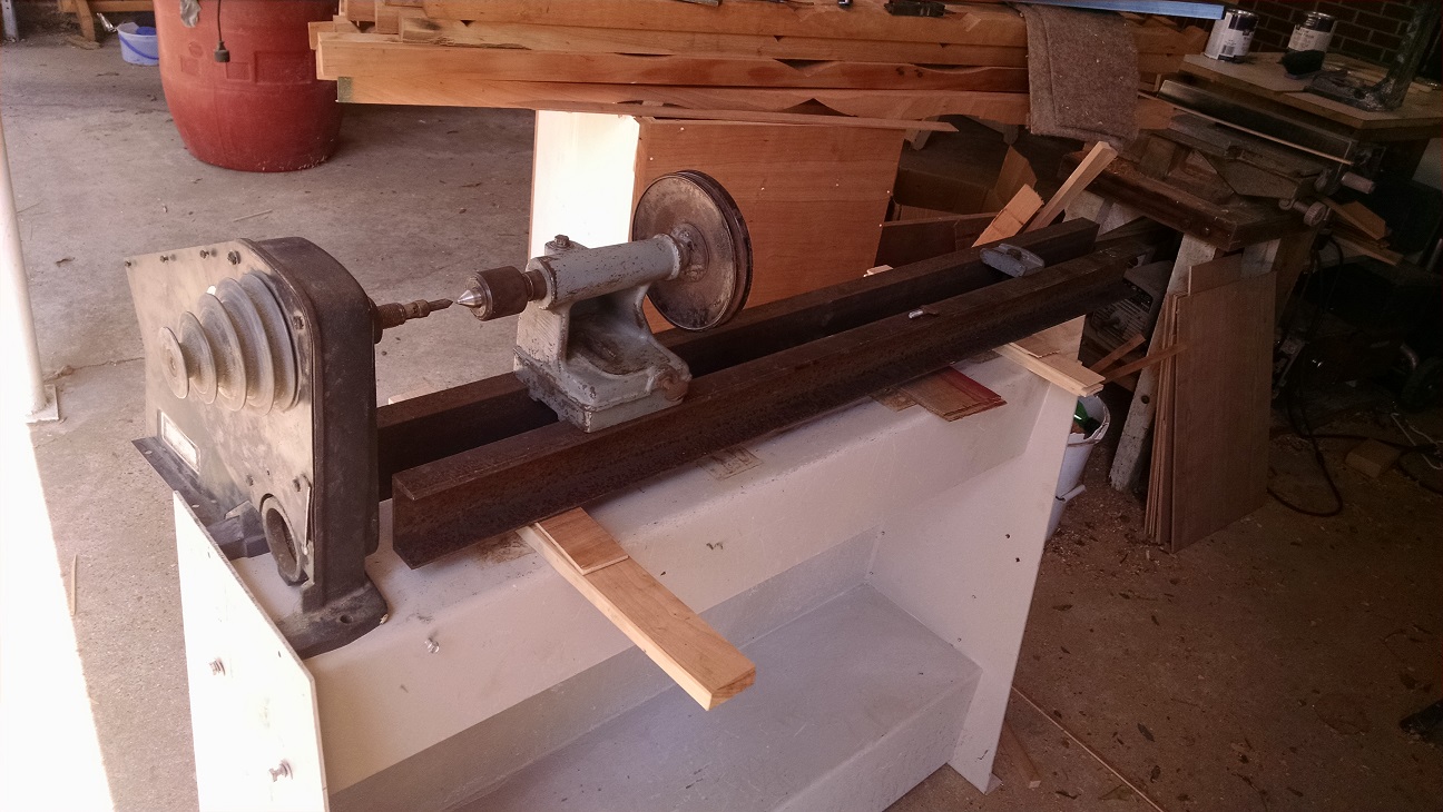

    I've always wanted my own lathe. My first experience was on an amazing old direct-drive Blount monster. I think you could spin half of a tree-trunk on it and wouldn't feel a wobble. So going with the idea that heavier is generally better, and not having $300 to dedicate to a "beginners level" wood lathe I'm making my own, and I feel like I may have found the right bunch to talk to about it.

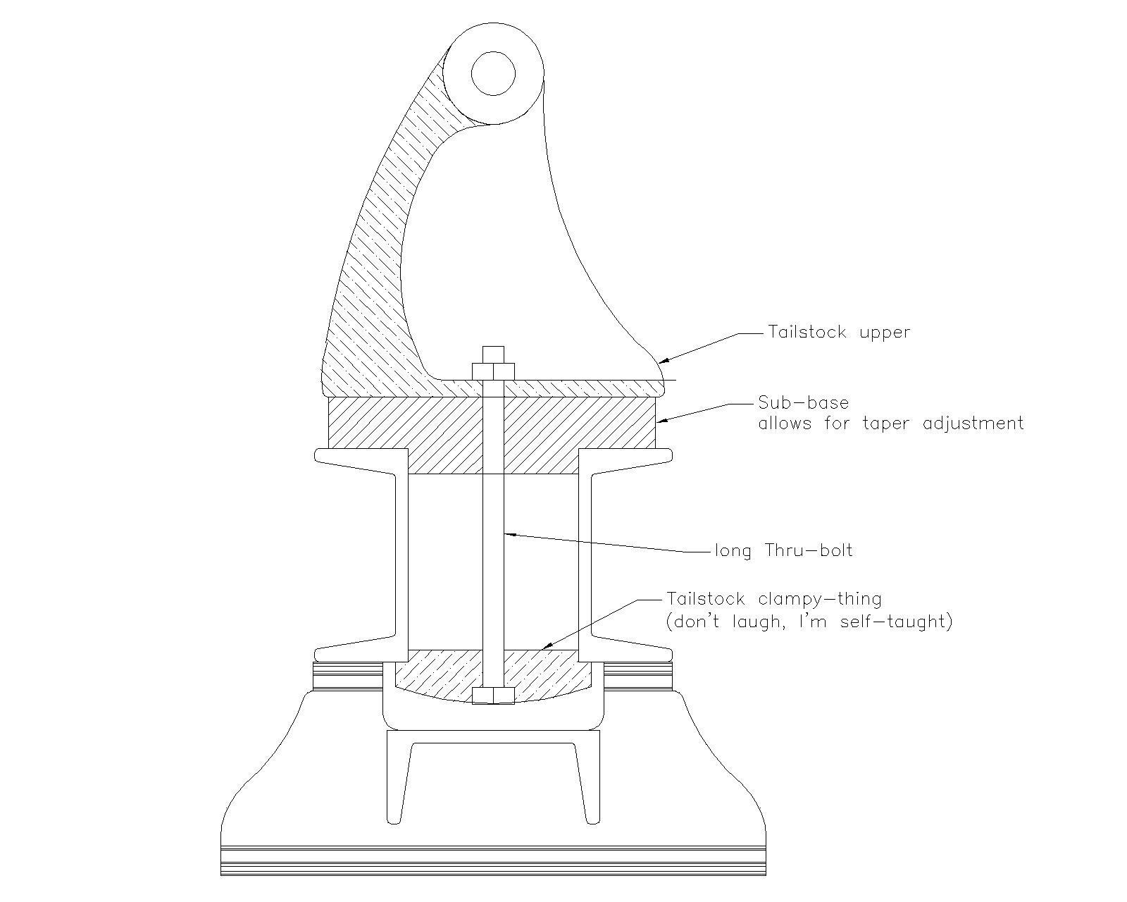

    The plan is to turn the c-channels sort of back-to-back, and get a longer bolt for the tailstock clamping bit with the idea being that thicker material will be closer to the point of impact when it comes to clamping, and more of the mass will be engaged if it comes to soaking up vibrations. Here is a 2d drawing of what I've got in mind:
    This is about what it'll end up looking like, a bit taller, a bit less... rusty, but pretty much it.
    Craftsman headstock is a dumpster dive find (we'll see how that turns out... no pun intended!)

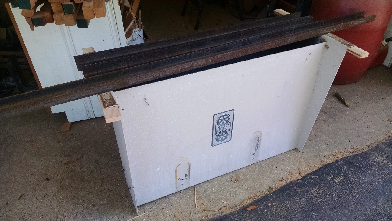

    Crouch industrial edge sander base was a cast-off from my employer (with lots of huge cast iron braces pictured below also

    Base w/c-channel:

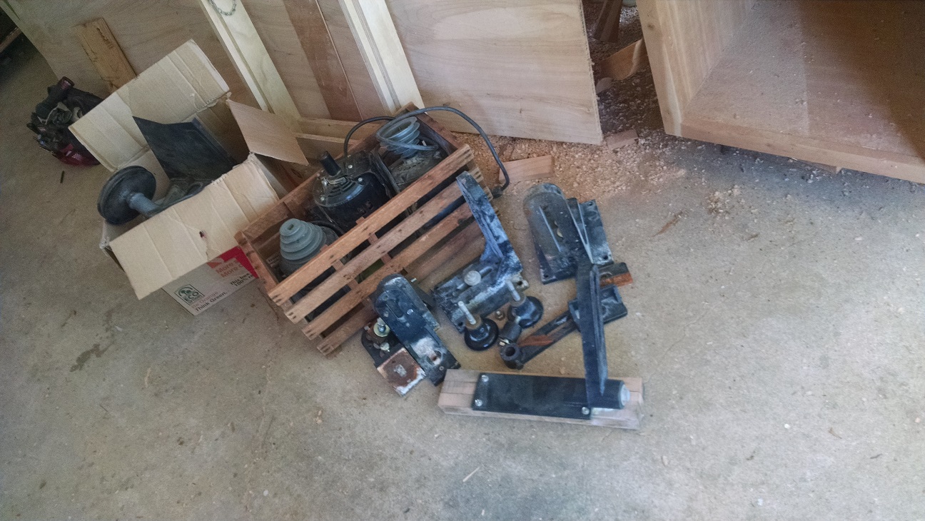

    Bits & Bobs that were attached to the base, and three 1/2 horse motors from the dumpster dive

    All the components are well suited to your lathe project. I'd warrant most suggestions (one immeasurable benefit of posting on HMT.net, besides we don't charge $.00!) might be;
    1. The Crouch base is a great foundation. Put 4 isolation/ leveling pads at the very corners [or extended somewhat lowering center of gravity] vs the C-channel, motor, and drive train. Base looks tapered, might become unstable at speed.
    2. Add a pillow block with longer shaft outboard the Craftsman headstock. That will generate better balance and rigidity at speed, and room for a jackshaft for a greatly expanded RPM range. Will allow lowering the motor for weight advantage, adjustment, and conventional length belts.
    3. 'We' will want to see what the spindle end accommodates in chucks, faceplates, and drive spurs. If there aren't any threads, the Shopsmith's use a .625 (5/8") diameter and setscrew flat - easily duplicated. In reality, threaded spindles are do-able too, but will take a little engineering; once again, duplicate a commercial design for desired tooling.
    4. The only dimensional challenge I see has two facets. That will be centerlines of tailstock and headstock coincide in two axis, especially in heights above the bed. Parallel [in reference to the bed length] can be 'swiveled' at the headstock or shimmed at the tailstock. One will influence method chosen to get the heights registered.
    5. Building your own allows planning additional features, to incorporate at convenient intervals.

    #1 since it appears you will be using "C" channel for the frame or ways as they would be known on a metal lathe you did not mention the size you are planning to use nor the length you want to make the lathe or if you did I missed reading it.
    I will throw out a couple of very rough ideas as if I were the builder. first off I would calculate my desired center to center from face plate to live center, personally I would want to go with longer than I thought I would ever need or at least 4 ft at a minimum At that length though I would want at least 4" heavy "C" channel preferably 6" I would place them between 2 1/2 to 4" apart also I would mount my tail-stock a little unconventionally by clamping to the flanges from both sides and not use a center through bolt for this reason. This would allow me to place center bars made of 2" sq tubing between the channels in 2 or 3 places to insure they remained parallel and gain rigidity in case I ever wanted to turn it into a metal lathe.
    Similarly I would make a sliding carriage plate 1 1/2 times in width as the outside width of my flanges for much the same reasons,
    Now to turn the channel bed or frame into true ways I might use a ground and polished round on top of the flange nearest the work side of the lathe with a square bar on the opposite flange and 2 square bare on the underside My reason for this would be I could cut a "V" grove in my slide plate and I could shim clamp the underside plus the off side making it become a carriage. A gear rack could be added for traverse movement plus a lead screw could also be added which now entails making an apron to hang off the carriage plate but I am getting ahead of myself here
    As a wood lathe the carriage plate would only need a way of clamping in in place with a hole drilled in the center of it to mount the slotted tool post mount.

    By the way you mentioned having 3 1/2 hp motors if they are all of the same size IE frame size RPM running amps and so forth you can parallel 2 or more together to give you more turning power as long as you use the same size pulleys on them to tie them together for instance if you mount 1 motor with a 4 grove pulley on it and find you need more power add a 2nd motor with exactly the same size pulley as one of the groves on the main motor make sure it is wired to run in the same direction and you will gain that amount of power based on the efficiency rating IE 85%

    So I've got the 3" channel, and the tailstock needs a 2 1/2" gap. I've turned the C-s like these brackets ][ back to back. I'll be having the tops of them ground flat at a local tool & die shop, and where the flanges are the widest, I'll have them machined down to a designated width (v-edged or rounded or what have you to work with a hopefully existing carriage plate eventually if needed)

    Thanks for the insight on the motors, I was hoping to be able to do something to boost the power for bigger jobs. Do you think they'd work in place of reduction pulleys on a jack shaft? I know metal is turned at much slower speeds, and that's one of the ways I'd thought to do it.

    How you couple the motors doesn't matter as long as the pulleys are the same diameter on the motors leading to 2 pulleys which must be paired in size as well this may be 1 of a jack shaft with you step pulleys on the other end you could set the motors up in a triangle use a single belt to connect the motors to a single pulley on the jack shaft not my favorite arrangement but do-able You can also couple the motors shaft to shaft using a flex coupling with a pulley on one of them this would mean that 1 motor would need to be clockwise and the other anti clockwise if 1 of the motors has a double ended output shaft the other may be coupled to that with the pulley on the other end. You can pair 2 or motors together by just about any means available. I've worked on industrial applications where there might be 2 to 6 motors all driving a common article such as a long conveyor belt where they would be placed all along the length. and on oil drill rigs where up to 4 or 6 sometimes as many as 10 motors might be used compounded together by a huge gear box having several 1000 HP output
