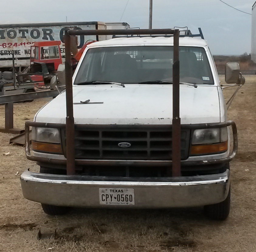

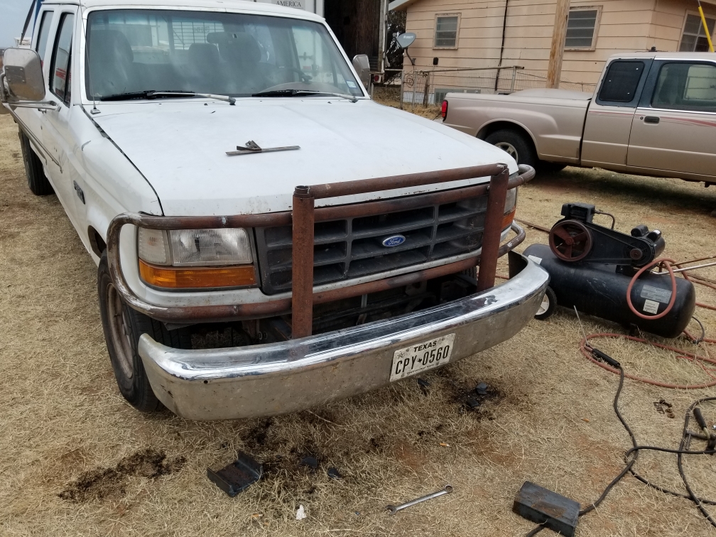

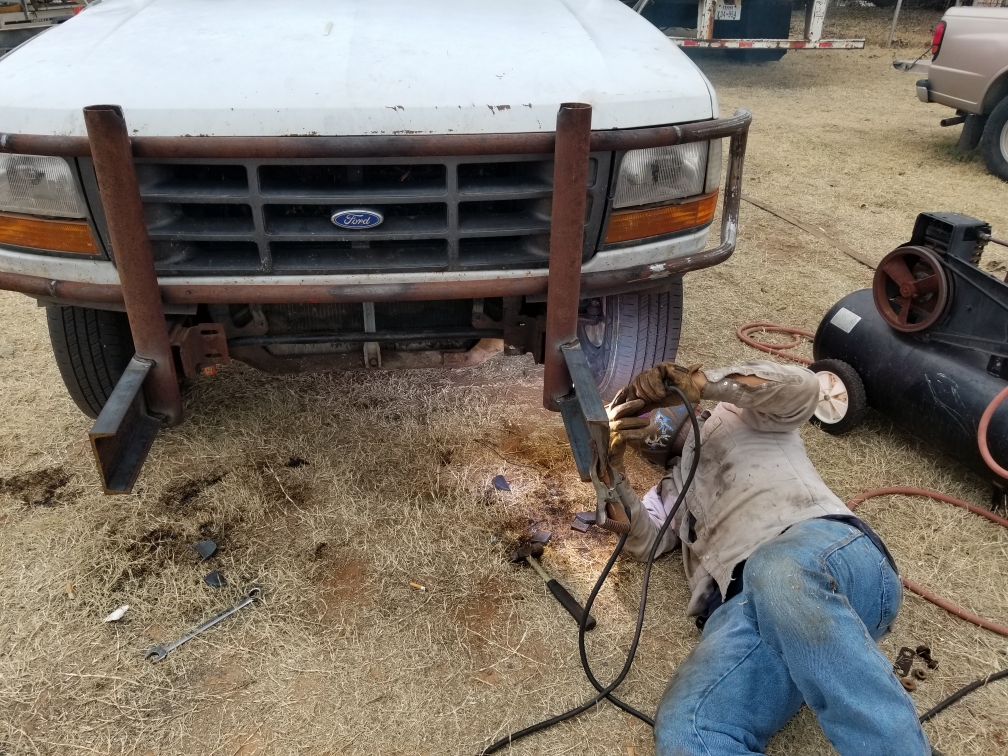

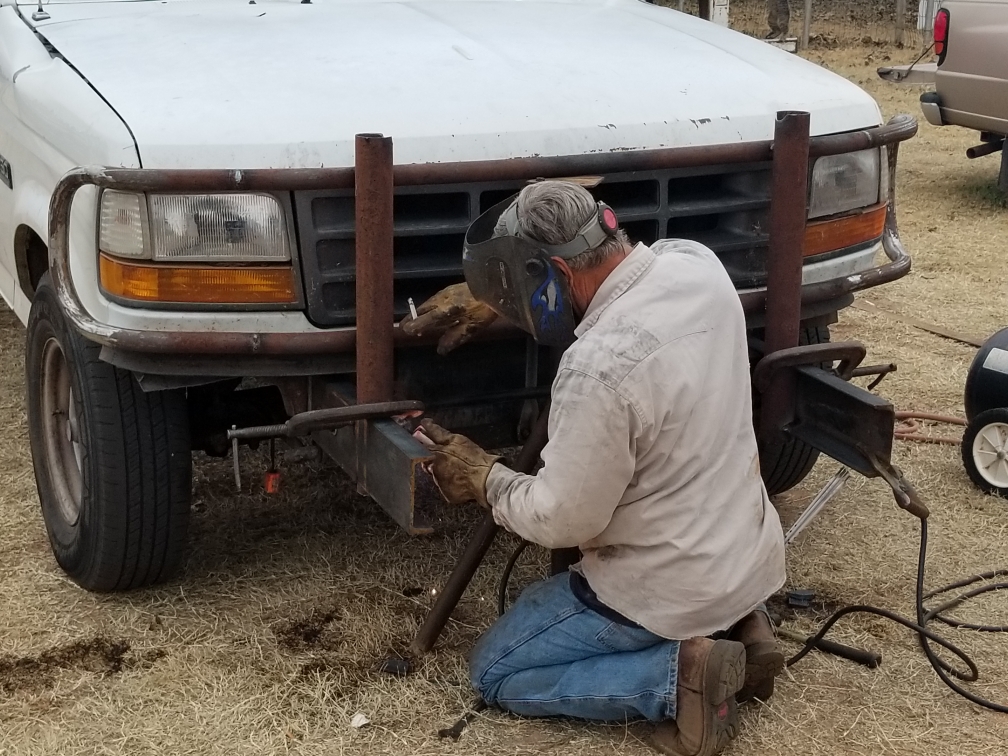

I wasn't going to publish this until I had time to finish it but today the opportunity came up to make a trip to the steel supply making the grill gard/ haul rack an official tool in use I'll go ahead and publish.
the grill guard is made of 1 1/4" sch 40 pipe with 2 1/2" vertical supports.
later it will have some bars and more smaller pipes added to finish the guard portion
the haul rack telescopes to above the top of the cab it is made out of 2" pipe and 1 1/2" pipe
the temporarily the front bumper was welded in place
Attachment 32018

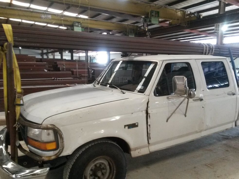

a load of purlin to begin the roof of my shop
