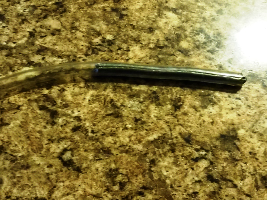

Tubing and tool before forming.
Attachment 27591

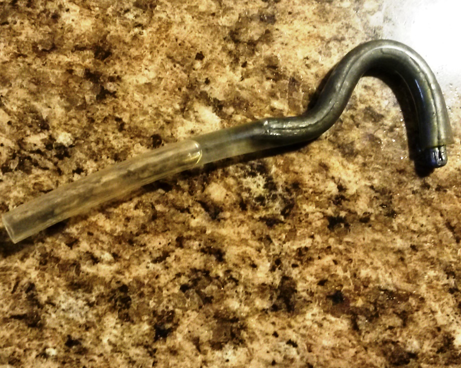

lead tool inserted in tubing
Attachment 27592

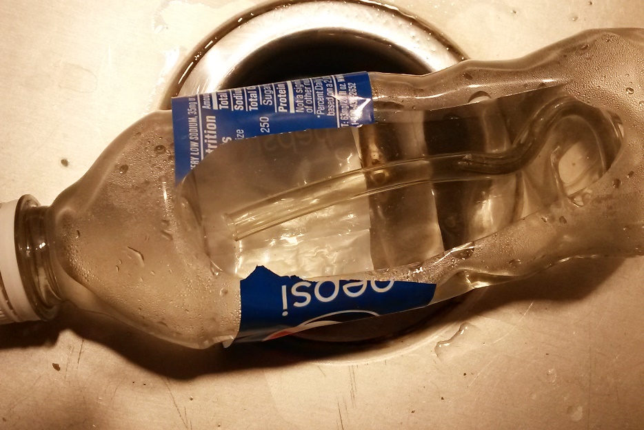

Formed and in boiling water note the drink bottle deforming
Attachment 27593

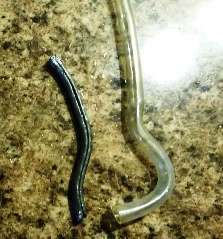

tubing now formed and cooled
Attachment 27594

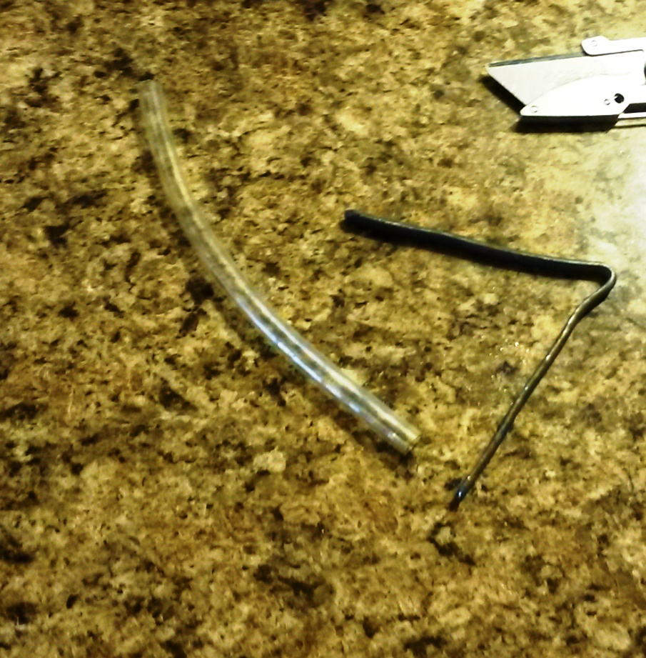

Lead now removed note tubing retains the formed shape
Attachment 27595

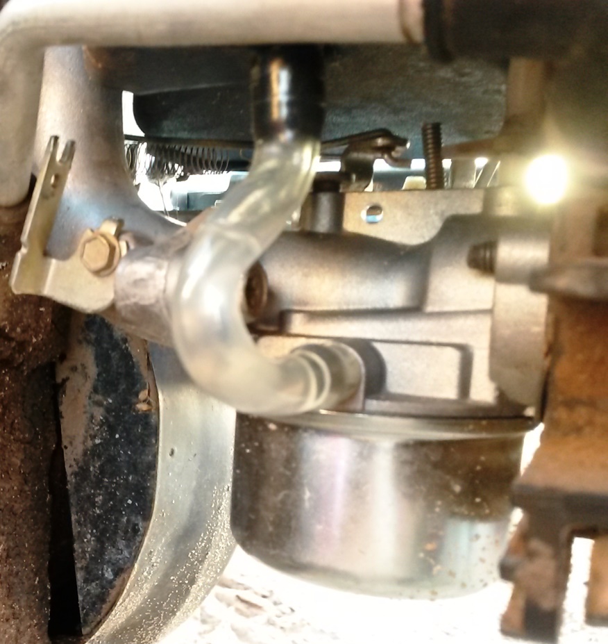

Installed on the engine
Attachment 27596
