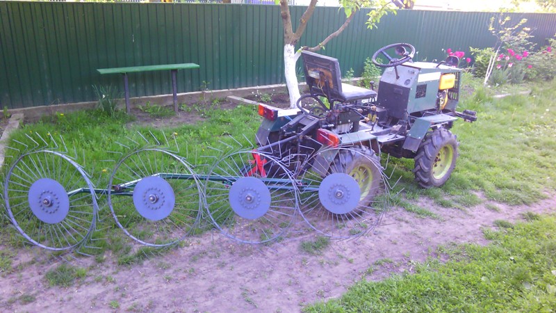

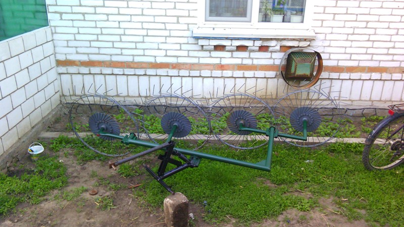

    I also have to rake for grass
    Garden  mini tractor 4x4-img_20150519_190631.jpg Garden  mini tractor 4x4-img_20150519_201126.jpg

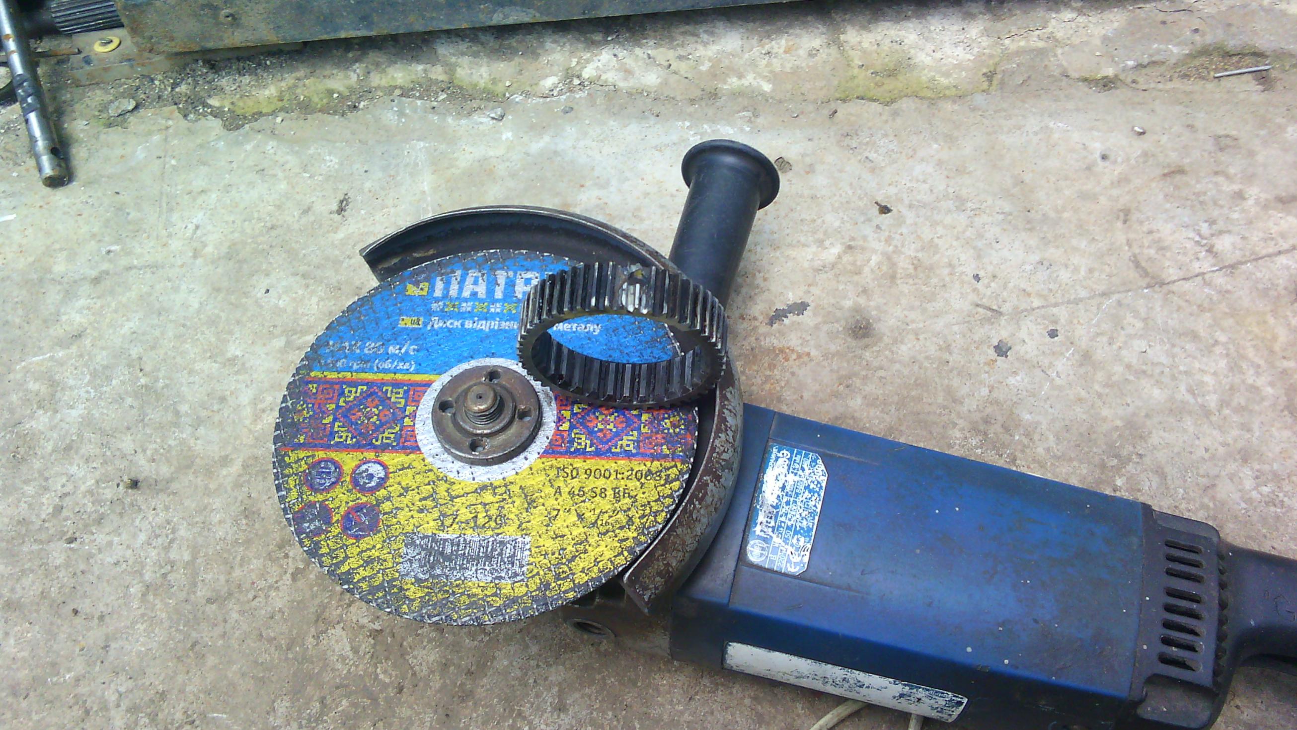

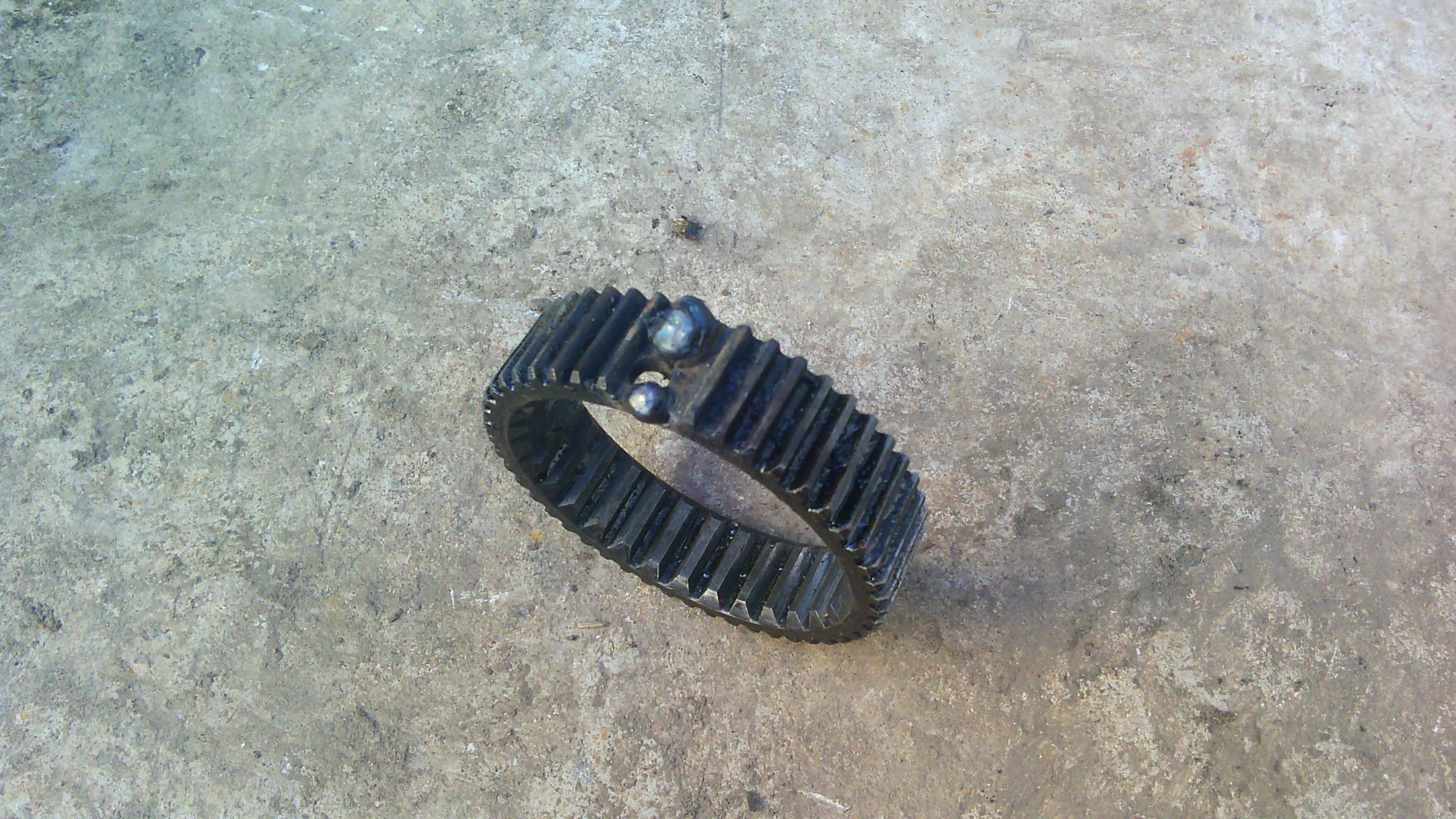

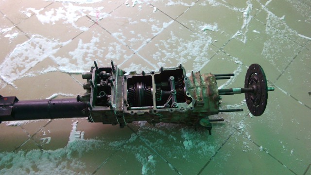

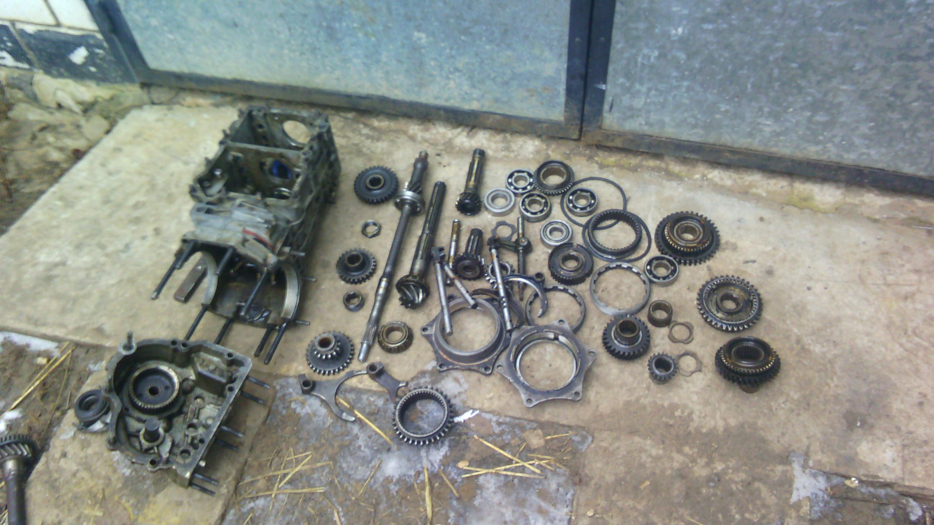

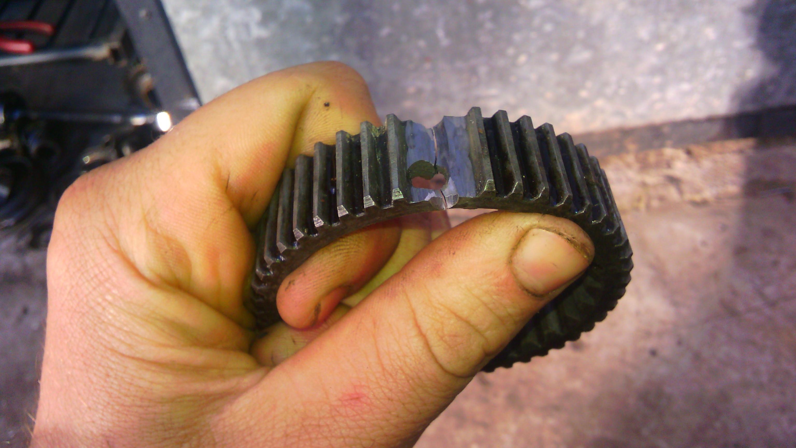

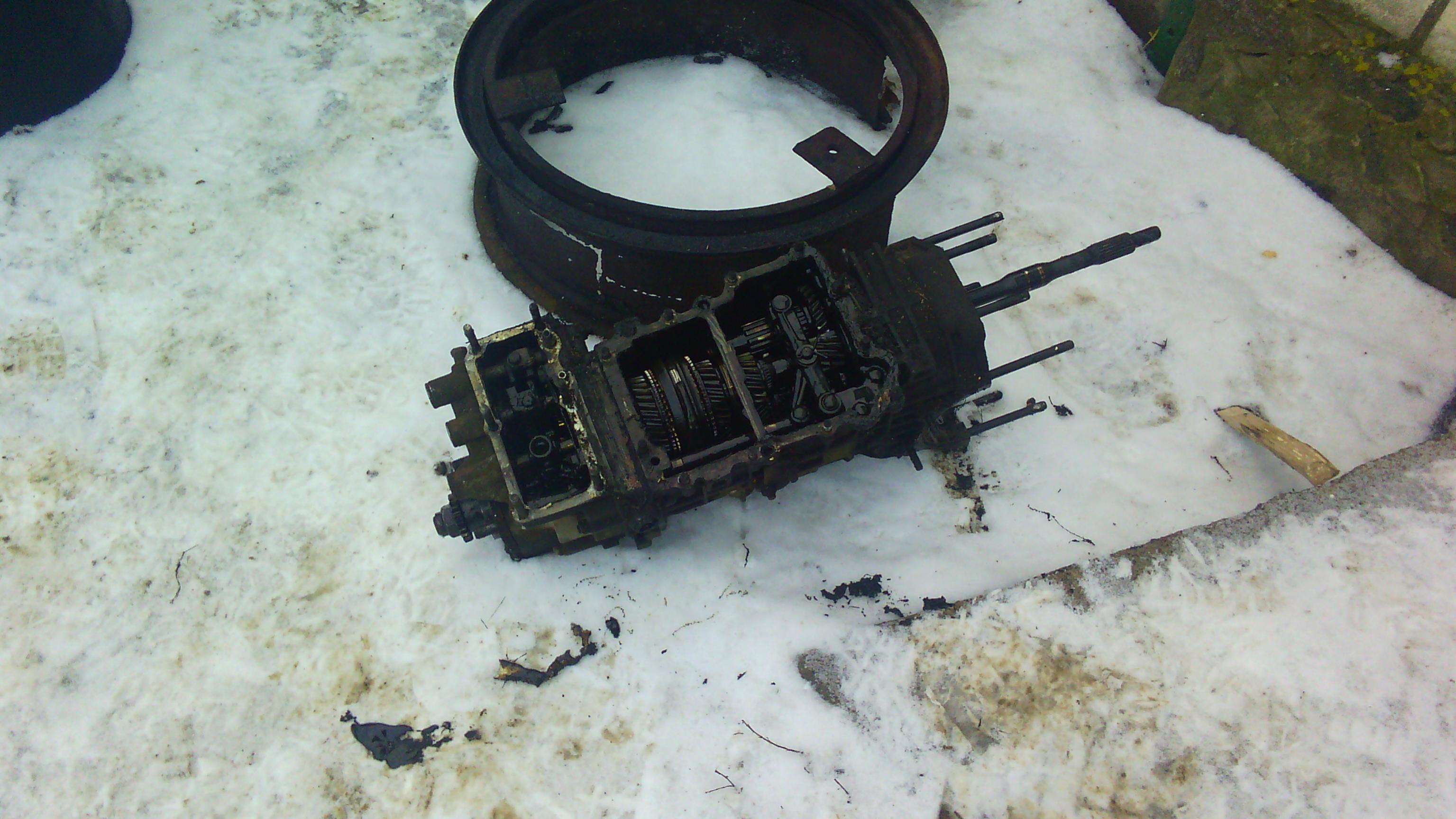

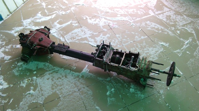

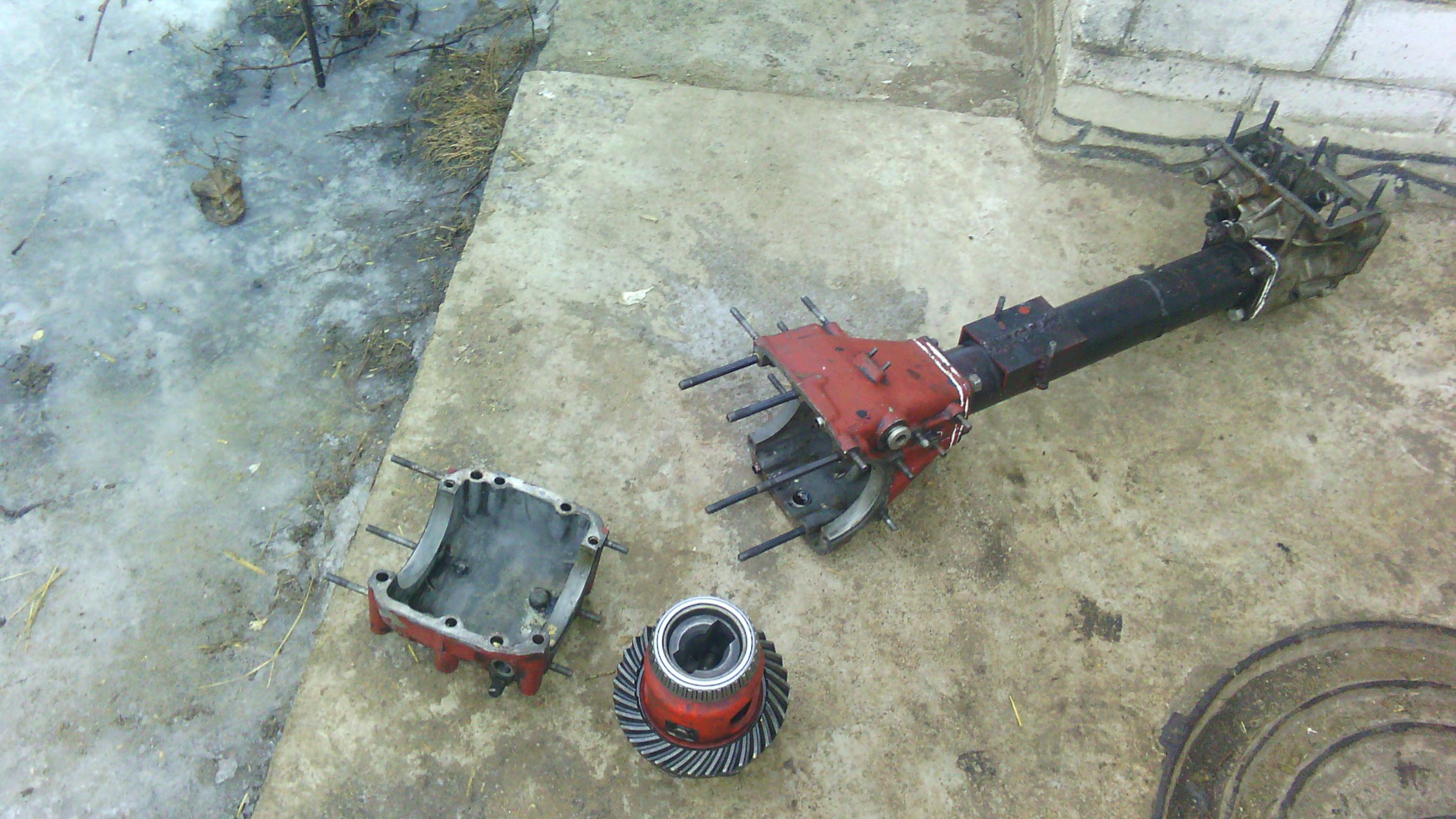

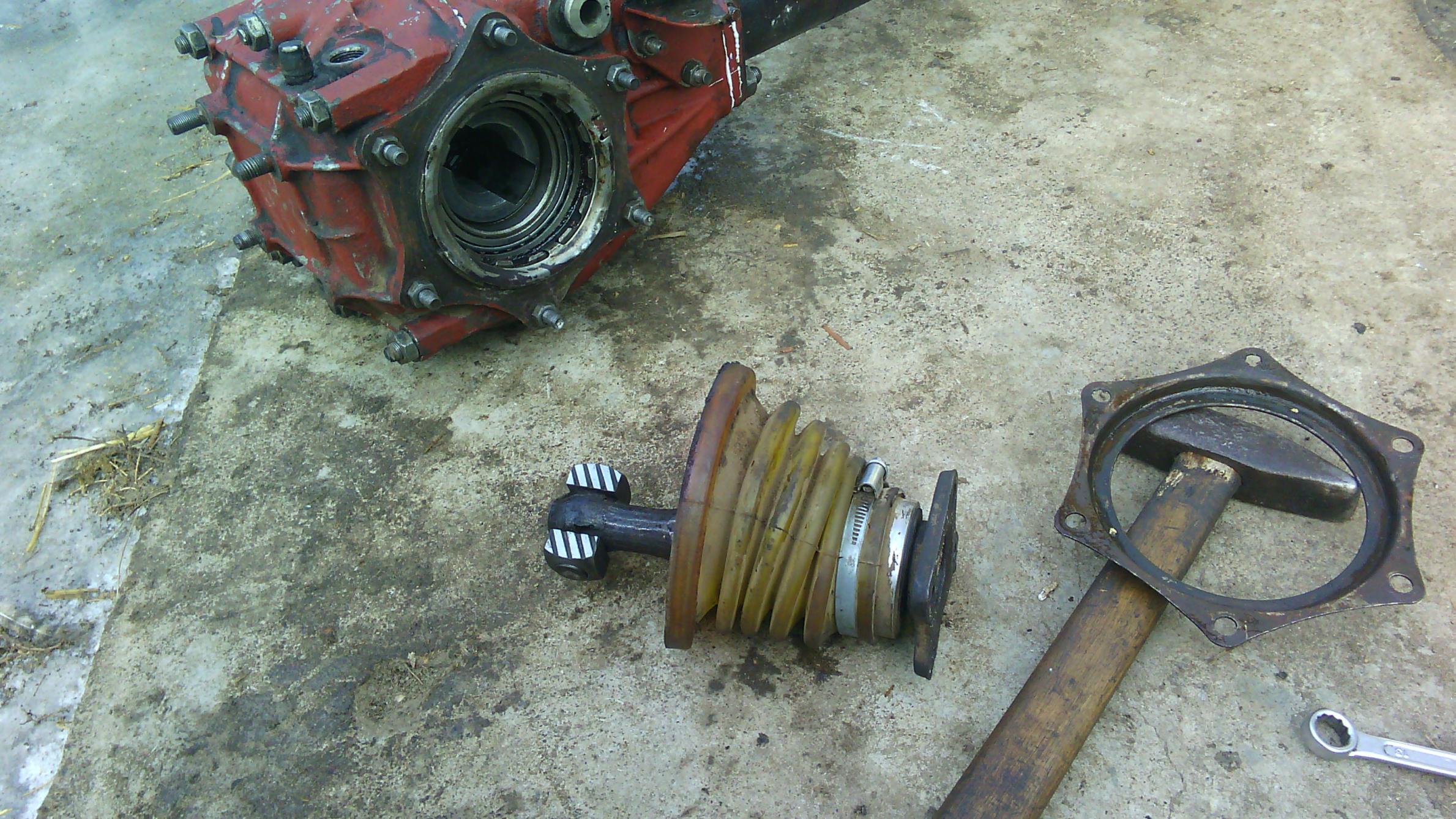

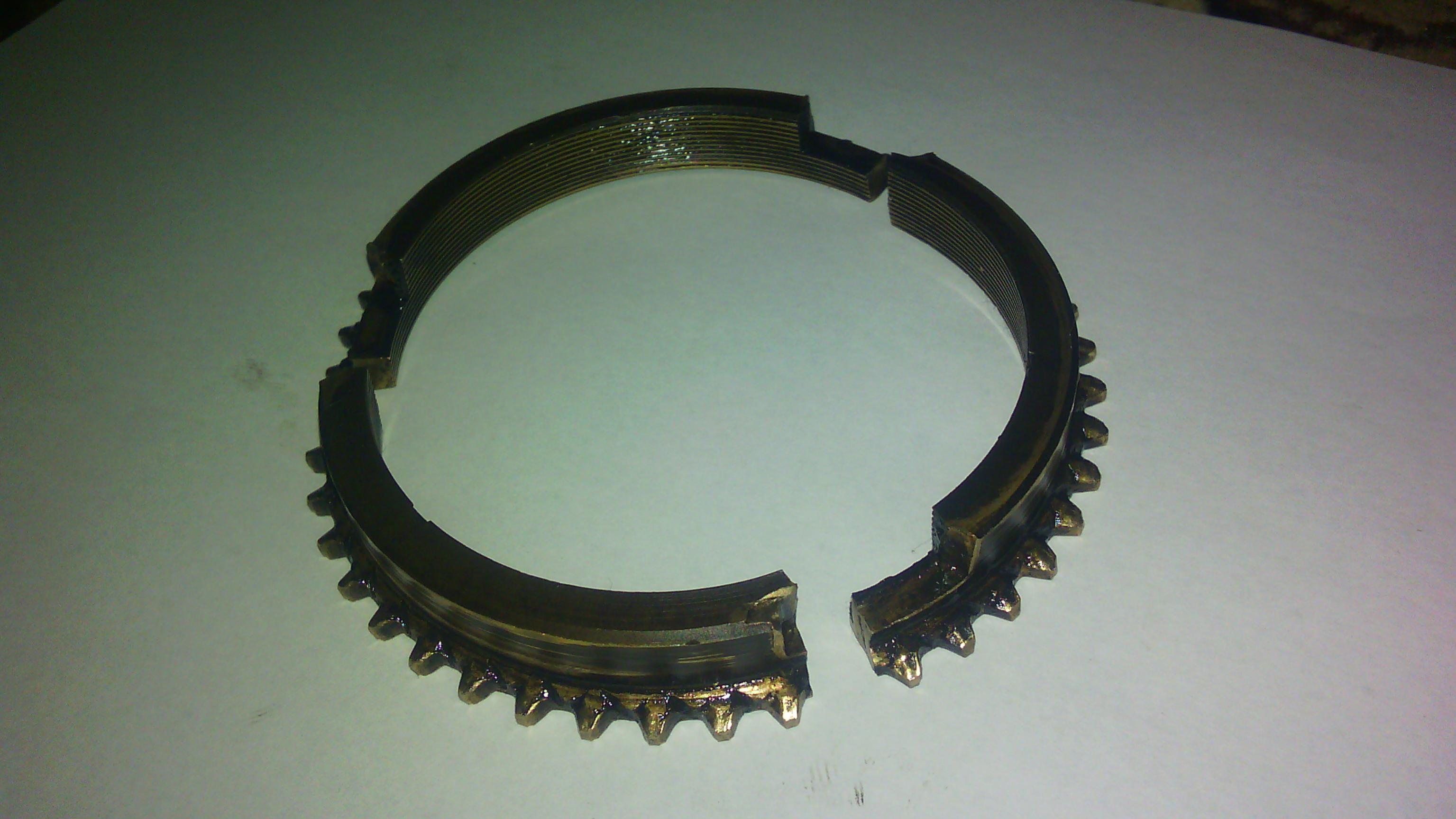

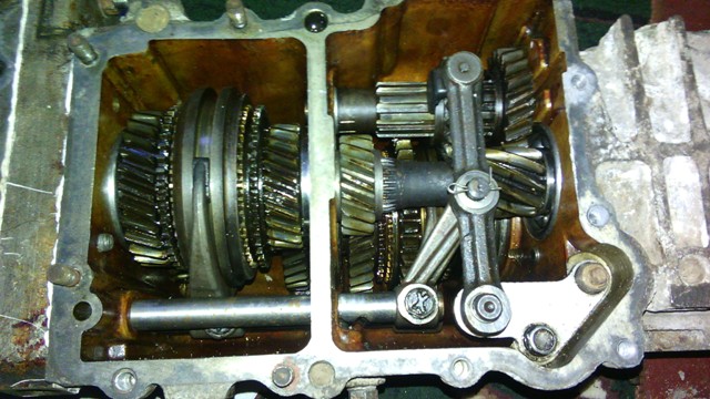

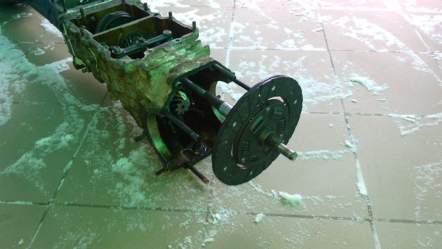

    Broken gearbox. Broke two rings of synchronizers (1-2 speed), and worn bearings. So when the gearbox is disassembled, it will at the same time upgrading. I want to make a PTO driven by the primary shaft. In the future PTO drive will twist tillers
    Garden  mini tractor 4x4-img_20161226_084436.jpg Garden  mini tractor 4x4-img_20161226_211103.jpg Garden  mini tractor 4x4-img_20170101_102424.jpg

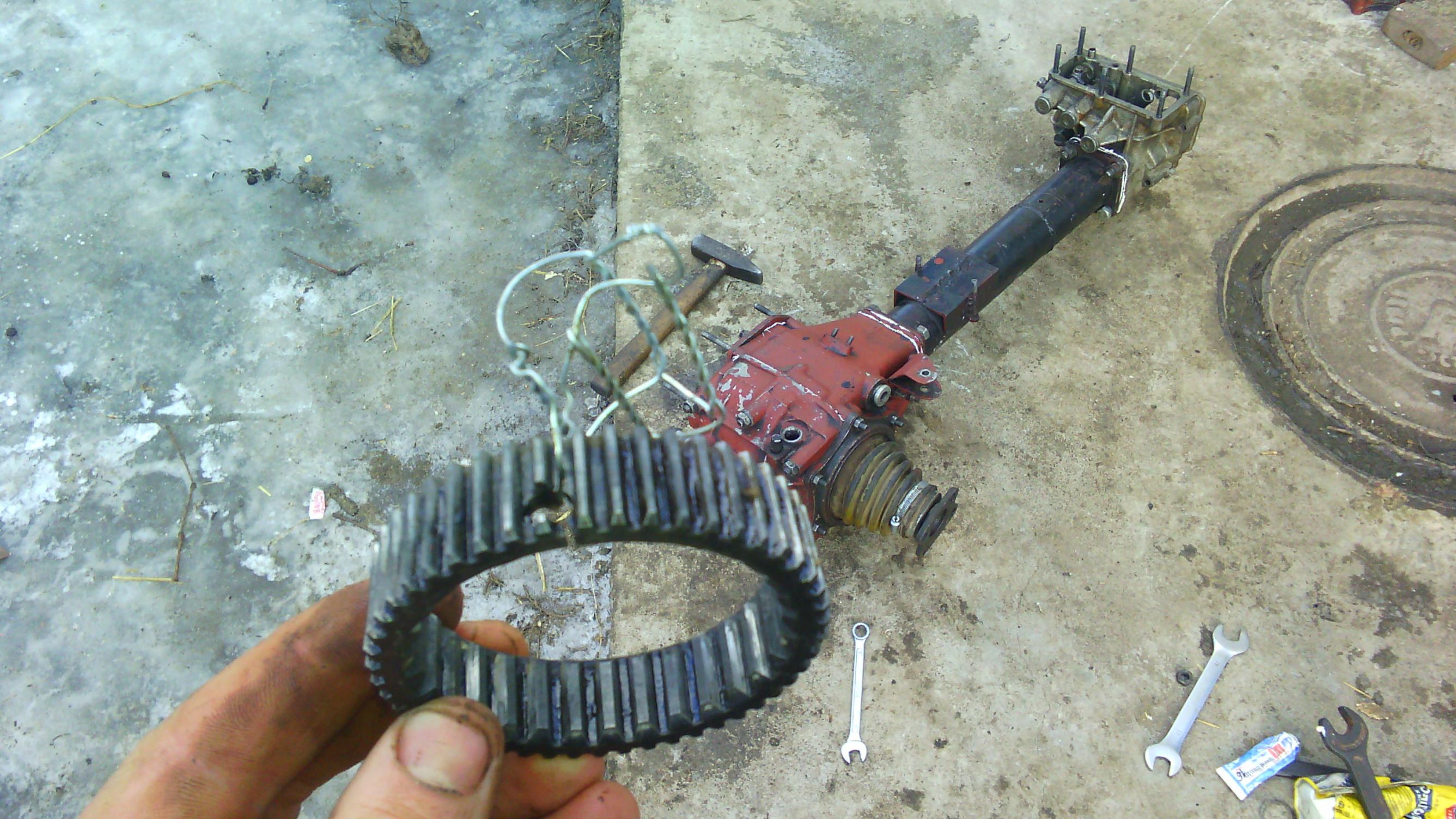

    Transmission repair continues
    Garden  mini tractor 4x4-img_20170102_105636.jpg Garden  mini tractor 4x4-img_20170103_084251.jpg Garden  mini tractor 4x4-img_20170103_113943.jpg

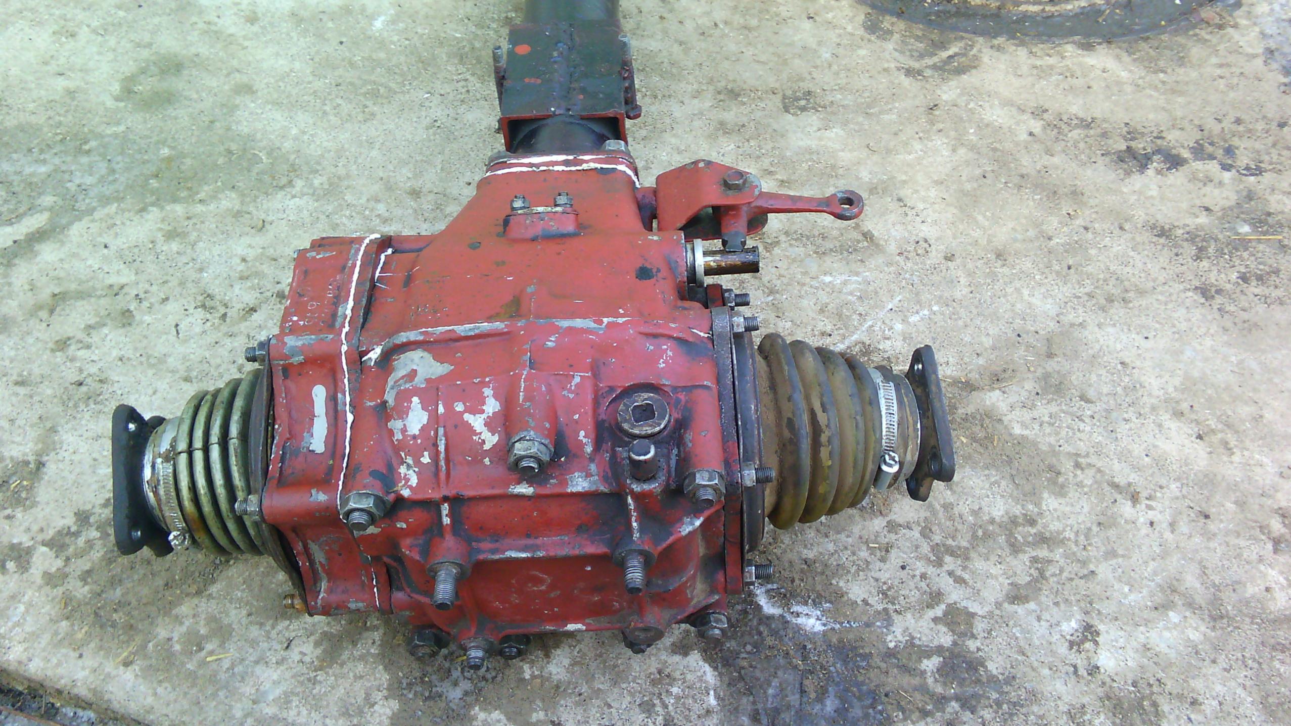

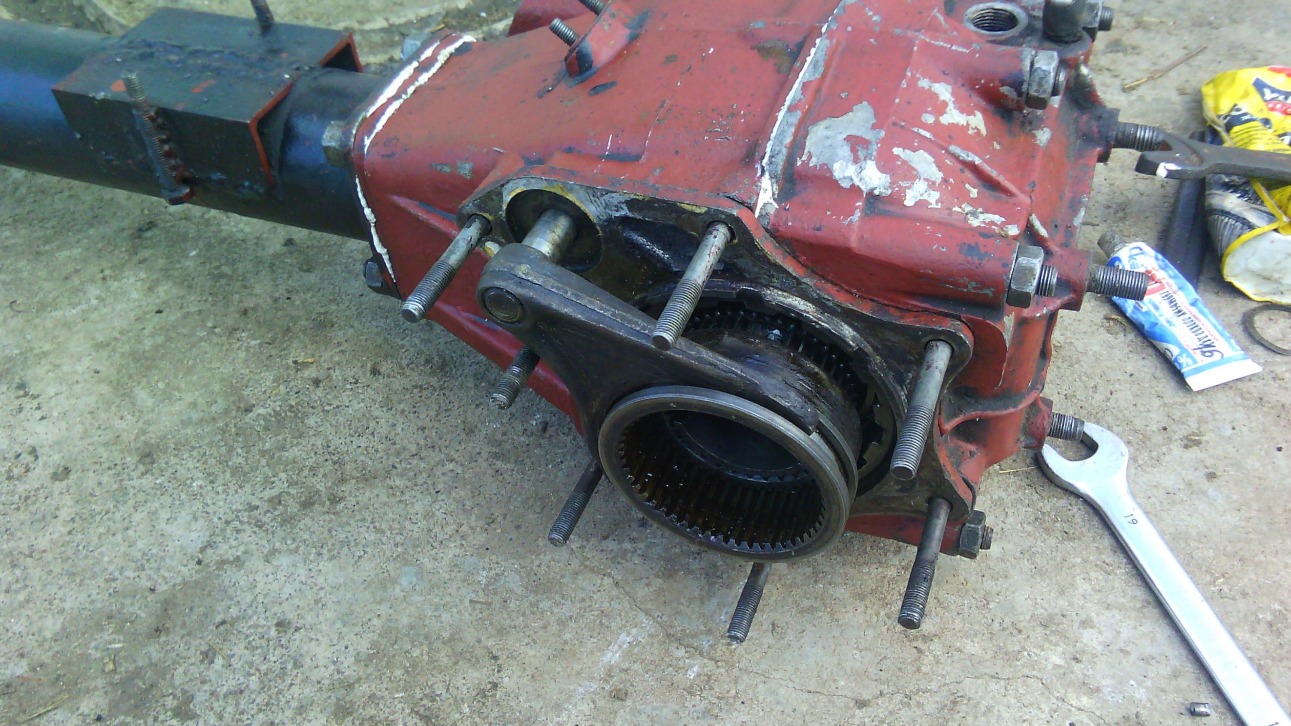

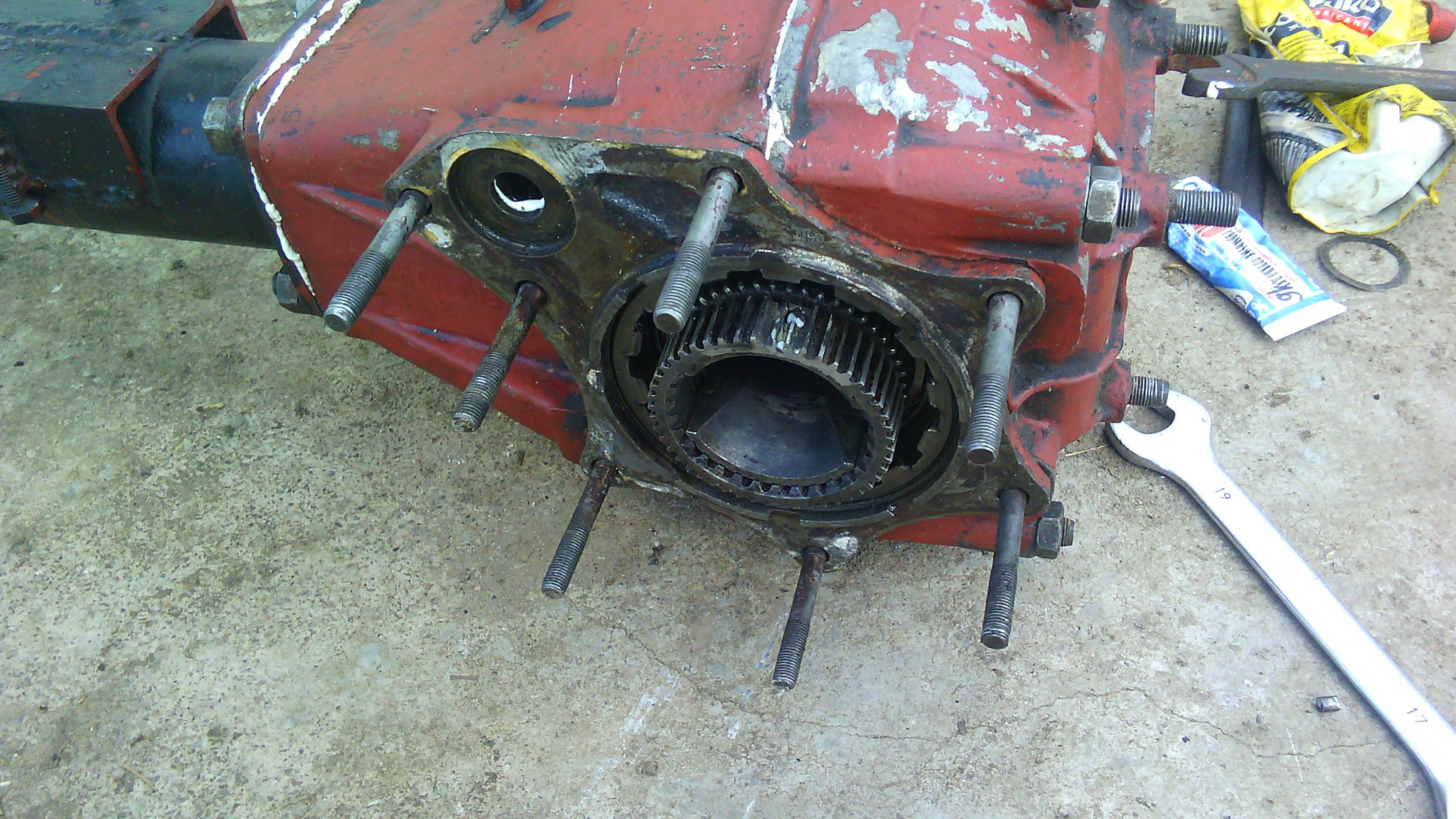

    Broken-down gear, it includes differential lock. Repair successful

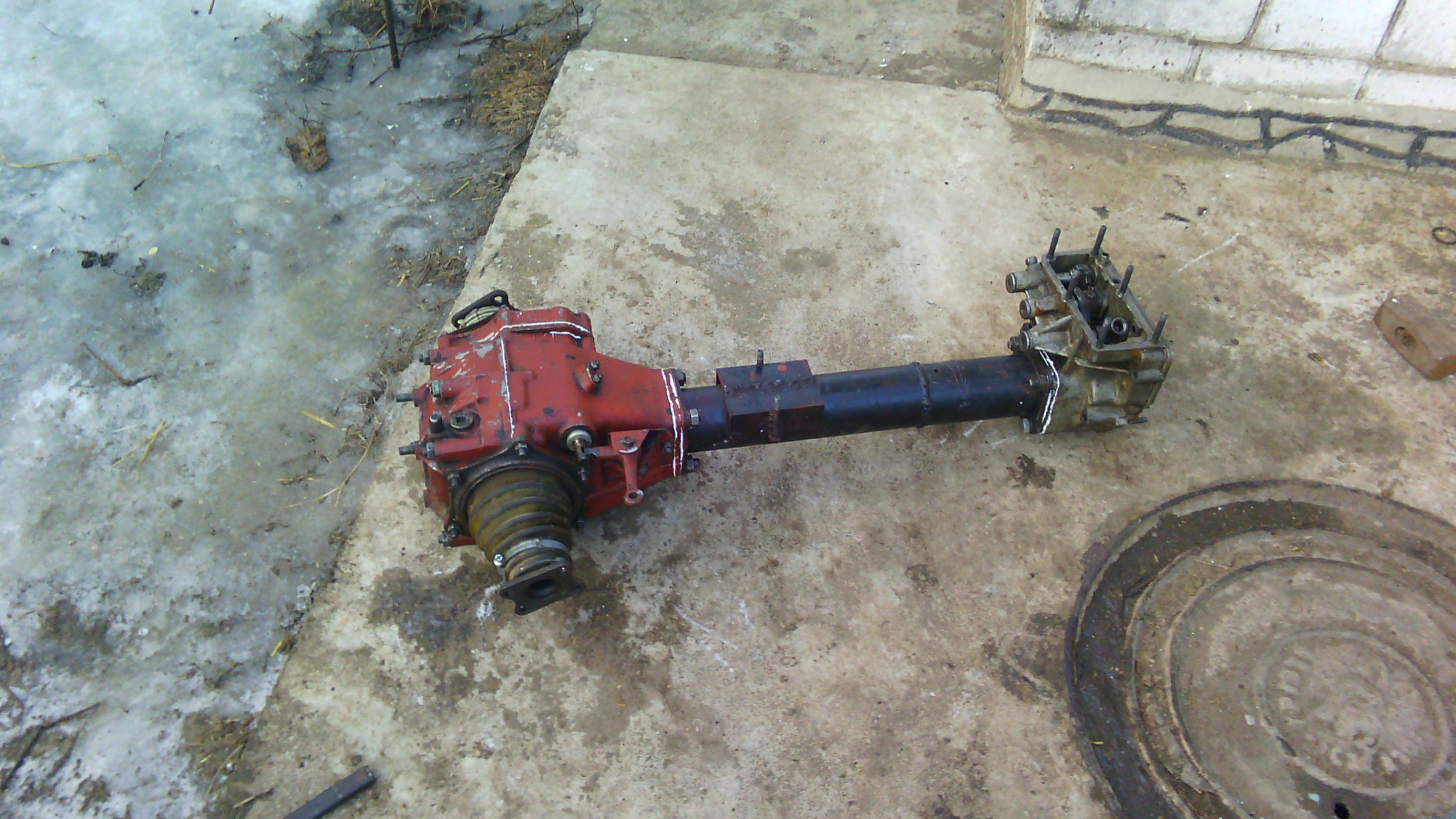

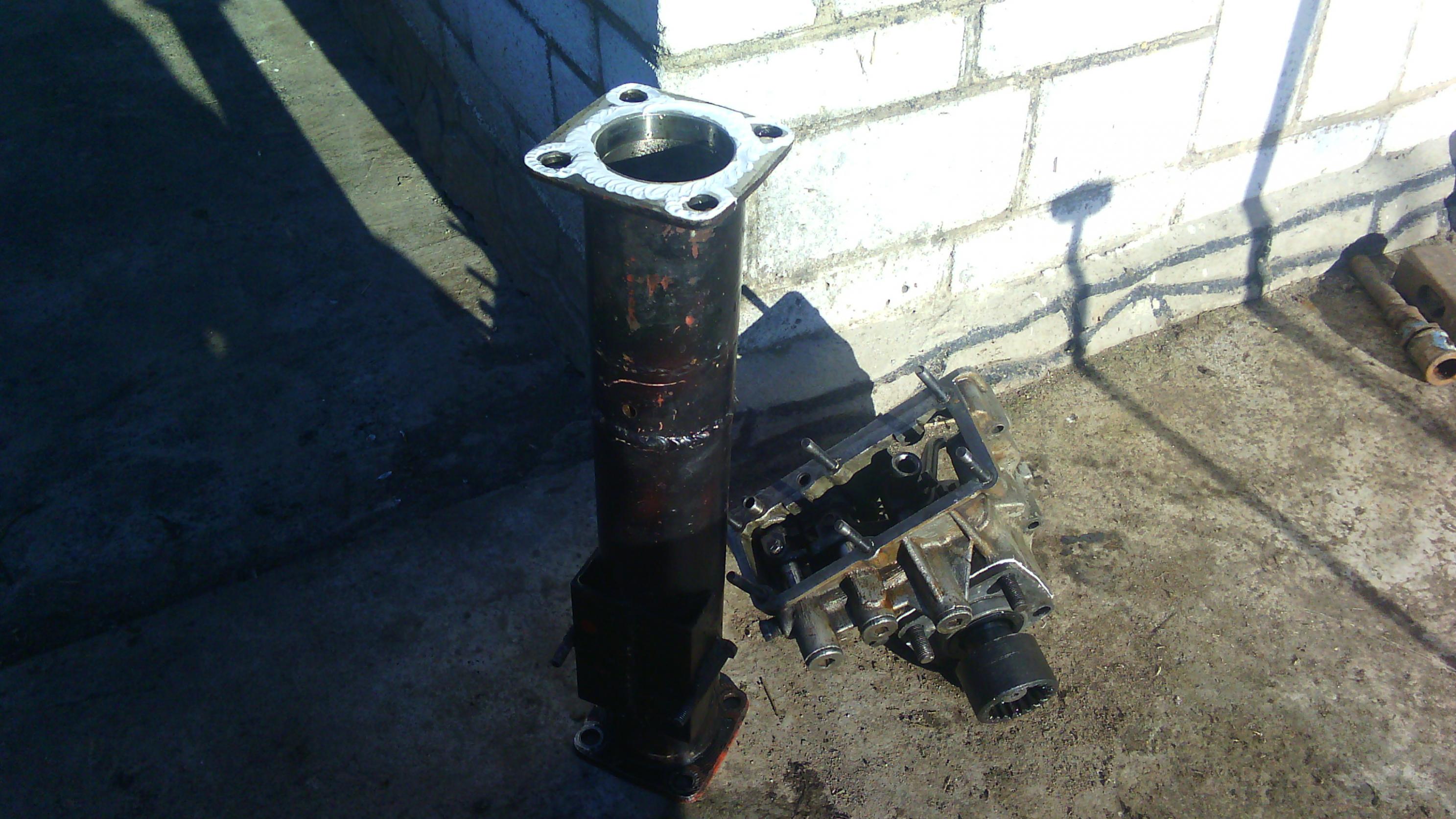

    Handouts box and rear axle restored. Waiting for parts for gearboxes.
    Garden  mini tractor 4x4-img_20170103_144706.jpg Garden  mini tractor 4x4-img_20170103_145022.jpg Garden  mini tractor 4x4-img_20170103_154105.jpg Garden  mini tractor 4x4-img_20170103_154116.jpg

    Transmission repaired
