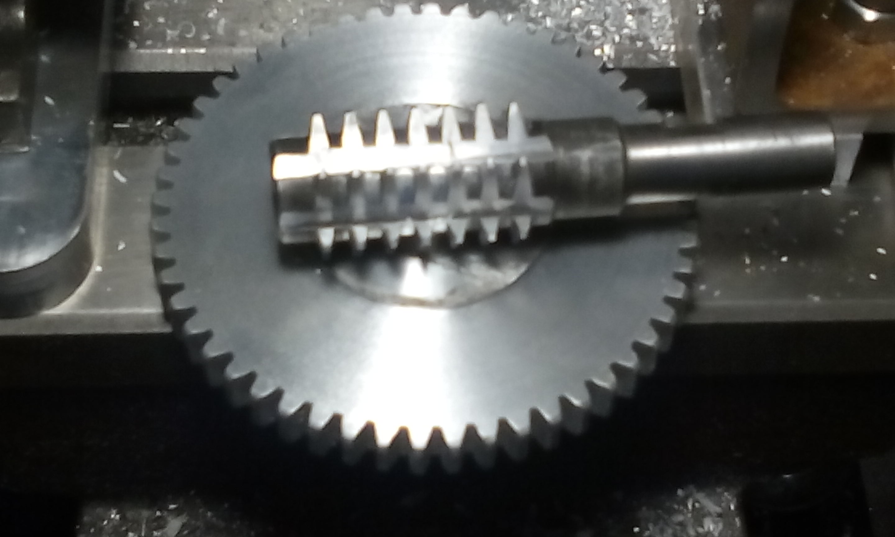

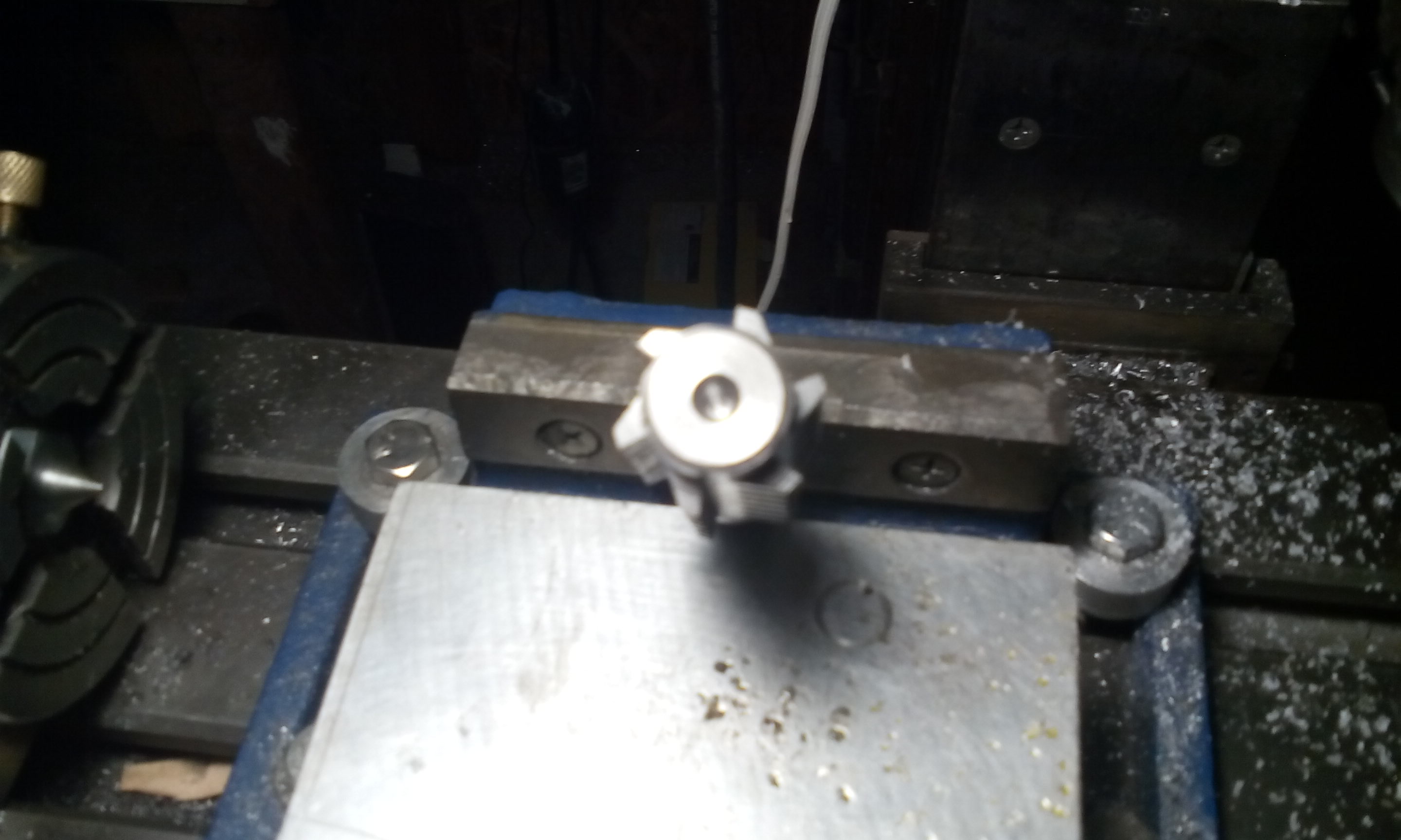

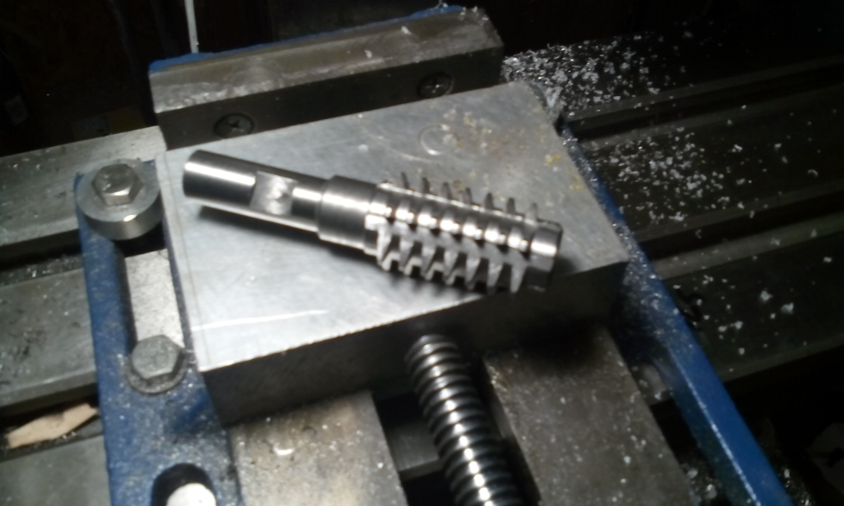

Here is my approximate involute gear cutter, turned down from some un-known steel from the calculations from this siteInvolute Gears
Attachment 4226
It was then pack hardened for 2 Hrs. at 1800* F And the teeth honed on a diamond lap.

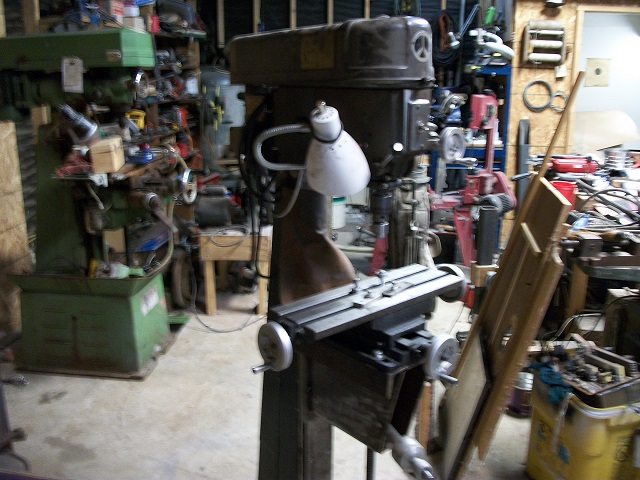

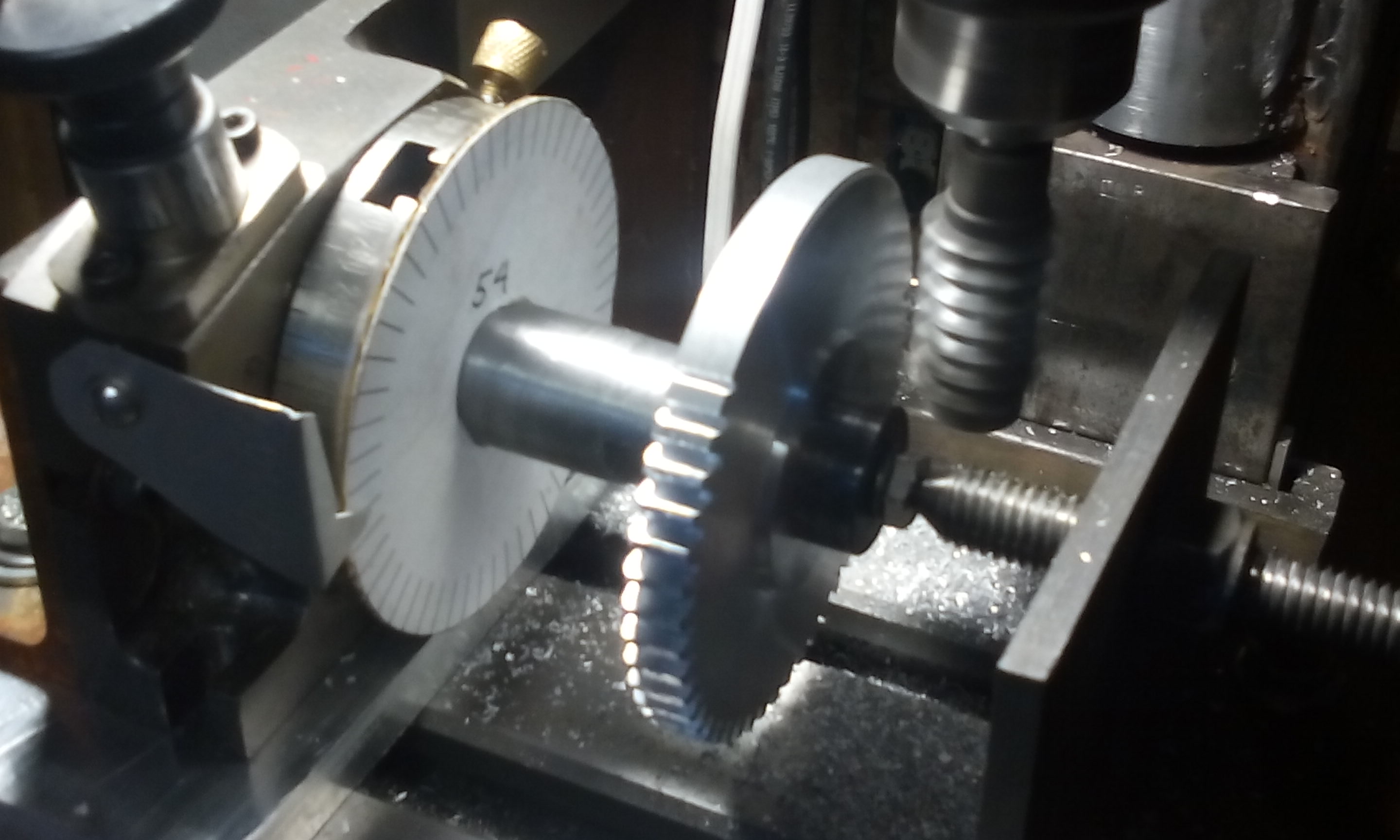

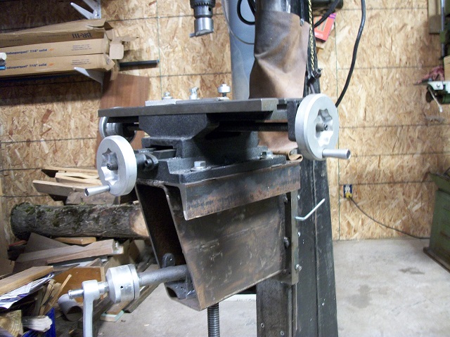

Set up in my homemade knee mill (Witch will be another post as soon as I get a few more pics.)
Attachment 4228
And the final gear.
Attachment 4229
Although I believe I forgot to add the extra for whole depth plus clearance it does run on the lathe, but a little noisier than the other change gears.
