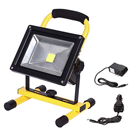

    Total diy respirator could be made from:
    Rechargeable work light:

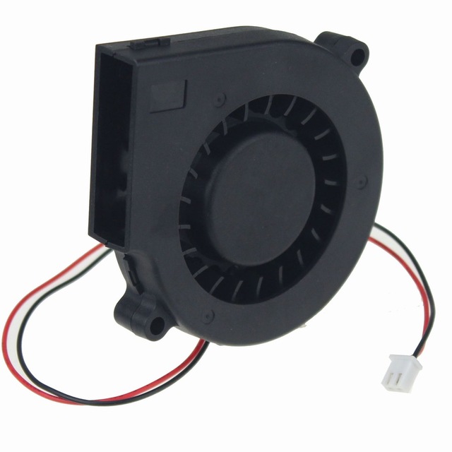

    Radial computer fan:
    Guys, we need a challenge - welding respirator-2pcs-75mm-turbo-blower-centrifugal-fan-75x15mm-7515-2pin-24v-dc-computer-cooling-fans.jpg_640x64.jpg

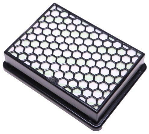

    And vacuum cleaner hepa filter:
    Easy to find.
    I have two Rechargeable work lights.
    One of them is with three 3.7v batteries.
    It would work nicely with 10.5v batteries from a drill that i have.
    Electronics taken from the lamp would monitor that lithium battery
    Wouldn't go totally empty. ( what would ruin the battery )
    Costs for the new parts about 50-60$

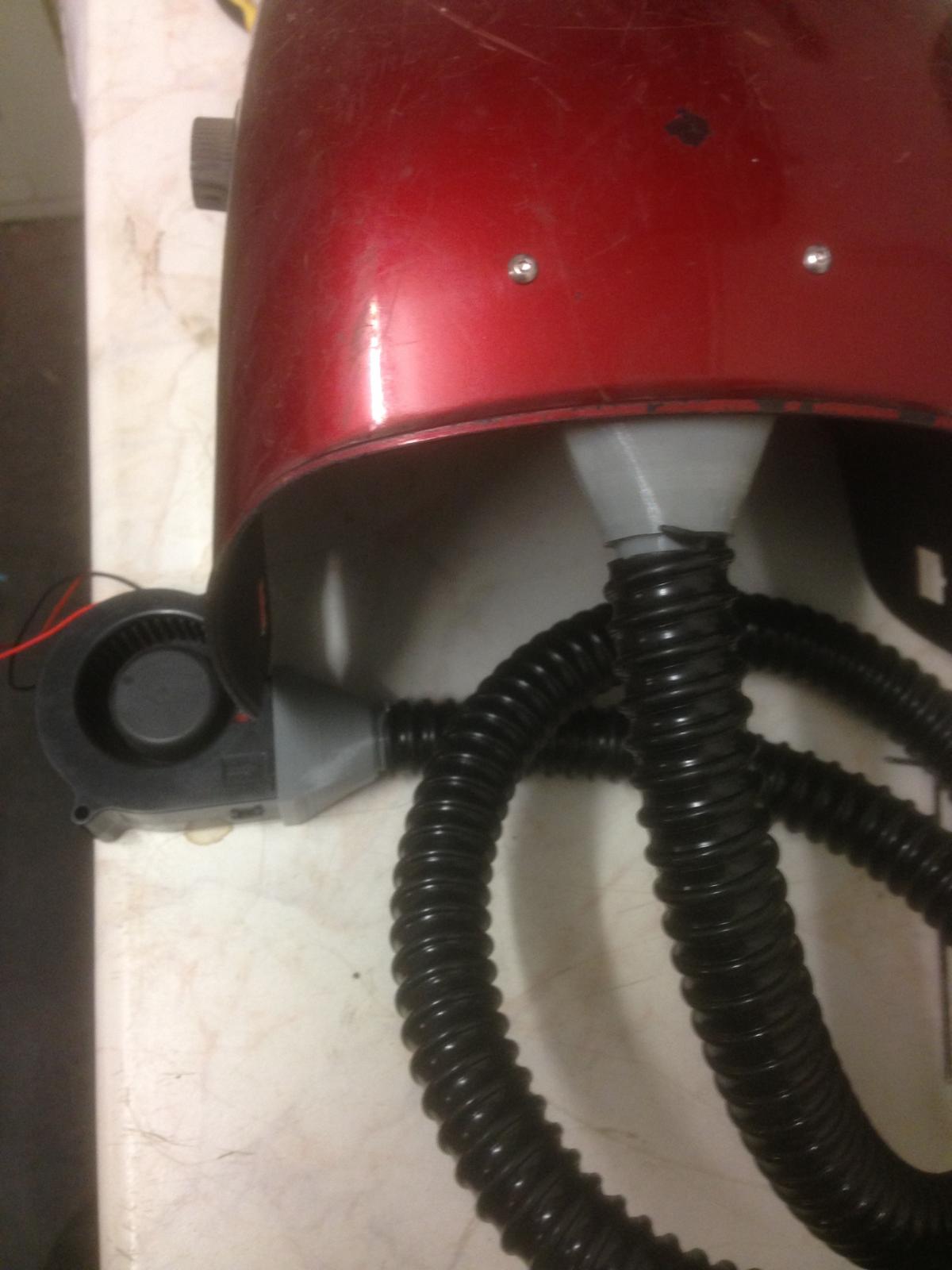

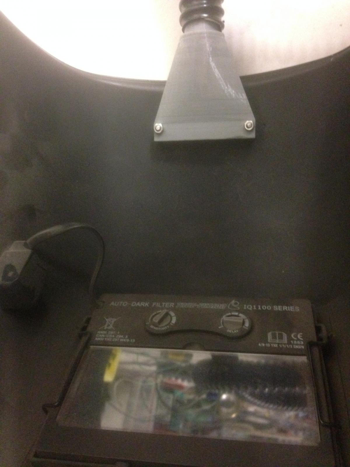

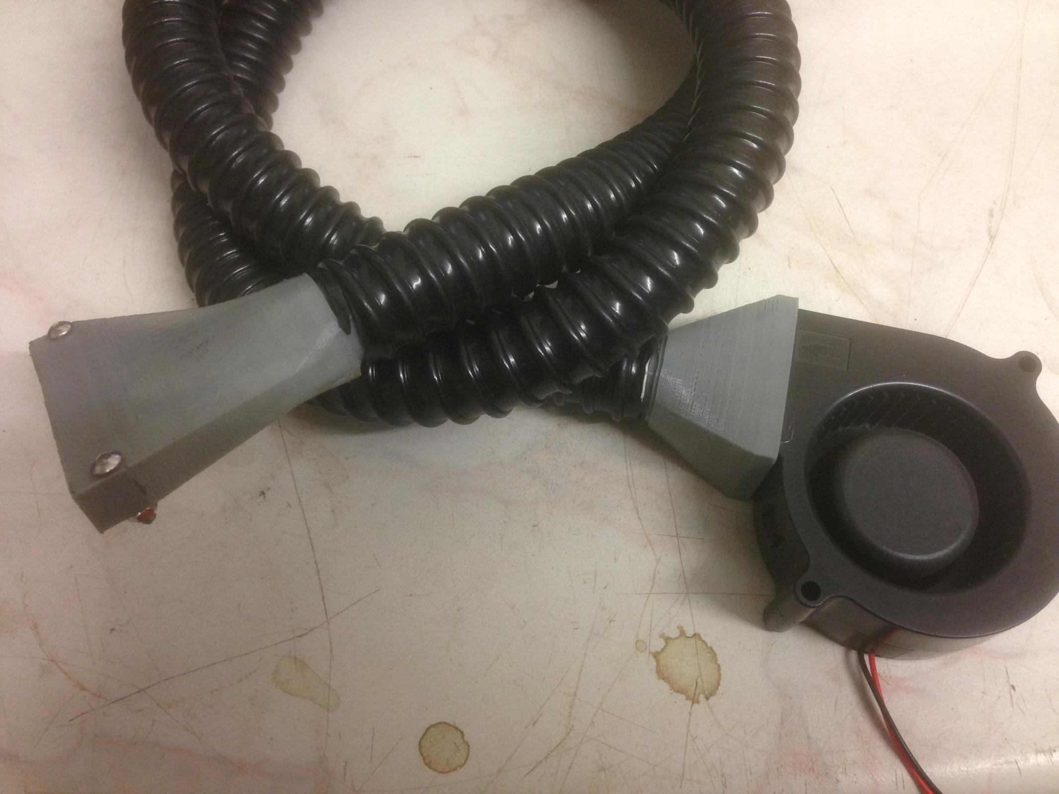

    Update:
    I have made new 3D printed parts to suit a more flexible hose the 1 1/4" hose was too rigid
    Guys, we need a challenge - welding respirator-img_1915.jpg Guys, we need a challenge - welding respirator-img_1917.jpg Guys, we need a challenge - welding respirator-img_1919.jpg
    I have attached the 2 STL printed part files
    STL Parts
    Fan air connection.stl Hood air connection.stl
    Like the suggestion from Tuomas to use a rechargeable flood light for the belt pack - so that's my next step.
