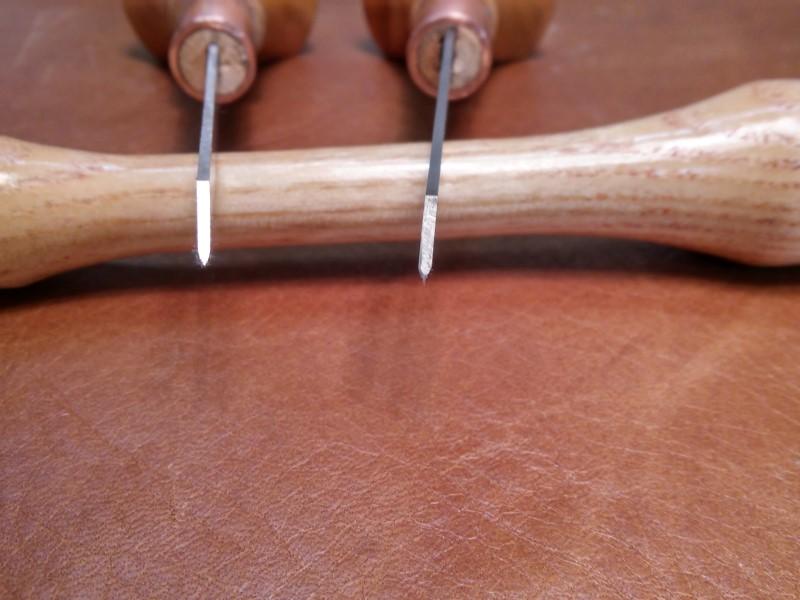

I made them out of Cherry for the handle, and HSS jig saw blades reground.
http://www.labellenote.fr/file/Metal...Echopes_01.jpg

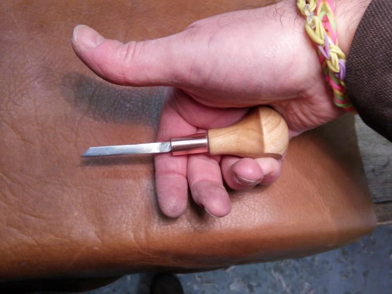

Notice the flat part on the handle, it prevents the tool from rolling on the table, but also serves as an index while the tool is hold in the hand :

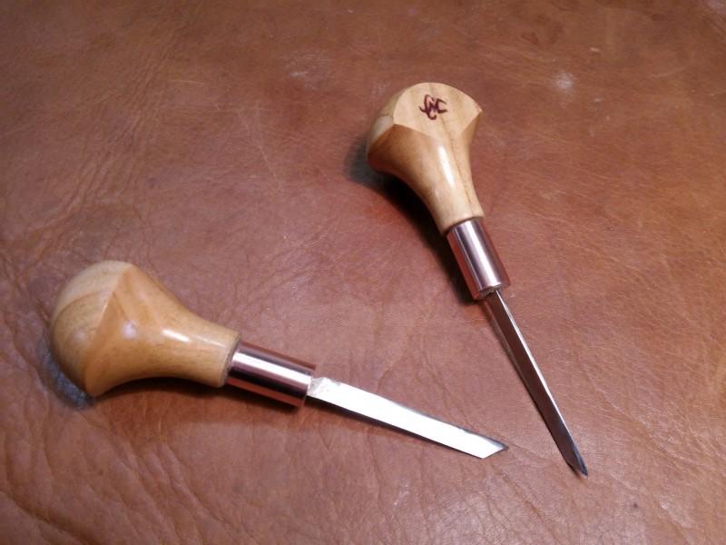

Two different shapening, one on the left has a "fingernail" shape and the other has a V shape.

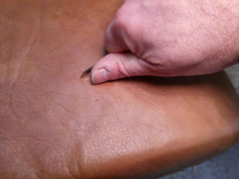

Here is how it should be used, the thumb is always used towards the workpiece to provide control and avoid any big scratch across the surface :flame:
http://www.labellenote.fr/file/Metal...Echopes_04.jpg
Of course, this is theory, and I am far from being skilled enough to provide any advice about how to use it, I just read a lot about engraving :rolleyes:
