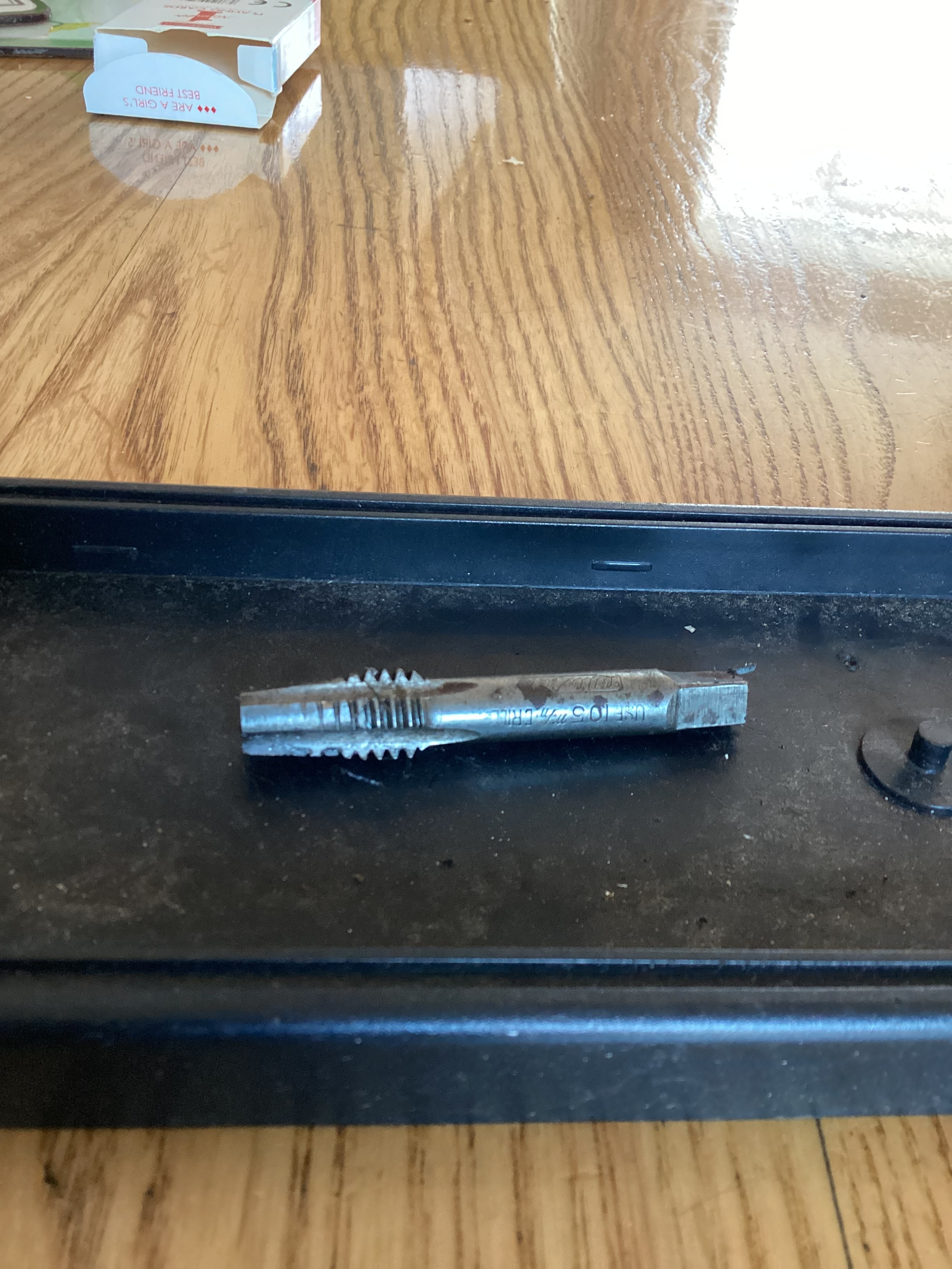

    Surely you wouldn’t want this done to your taps?

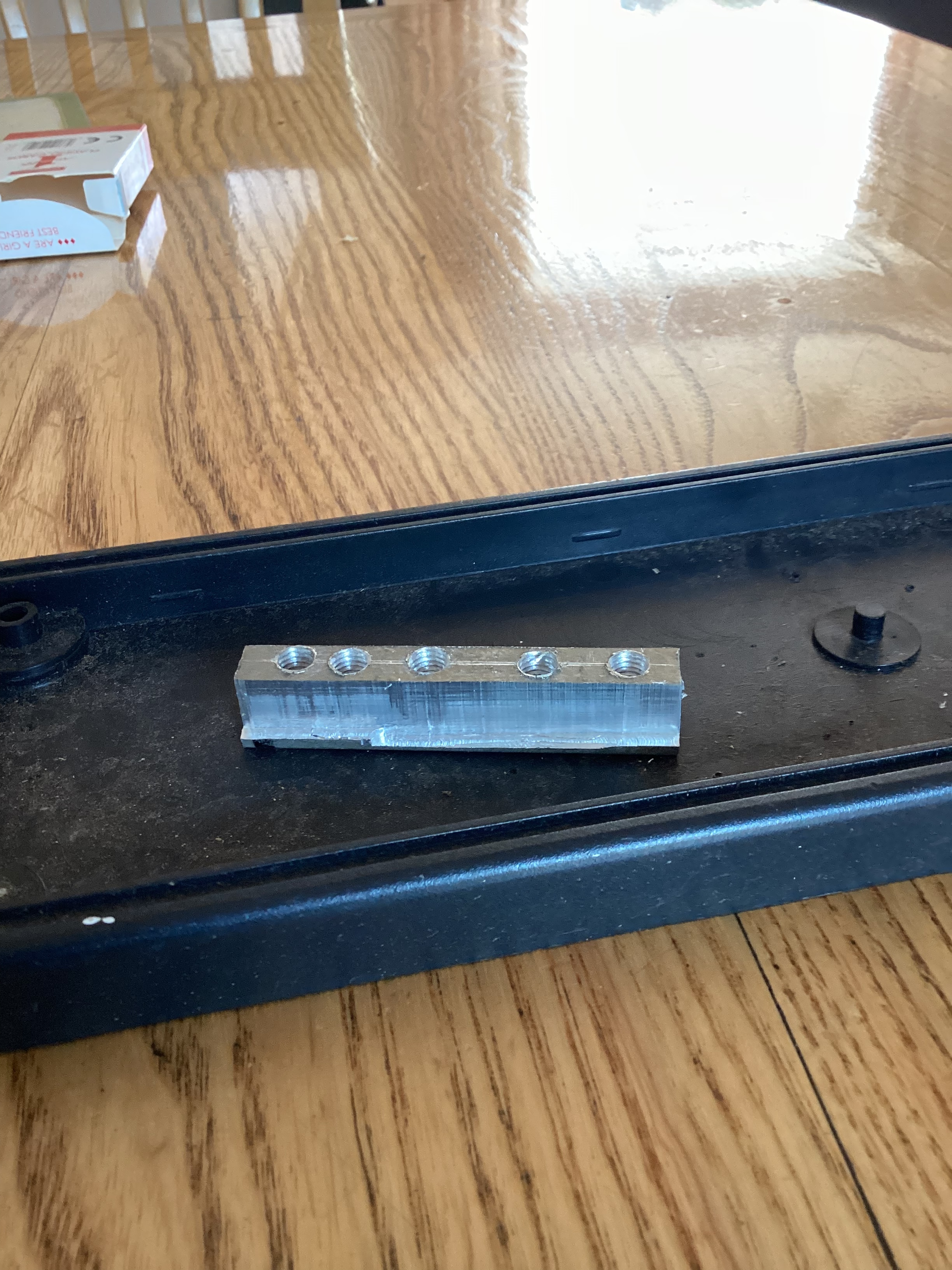

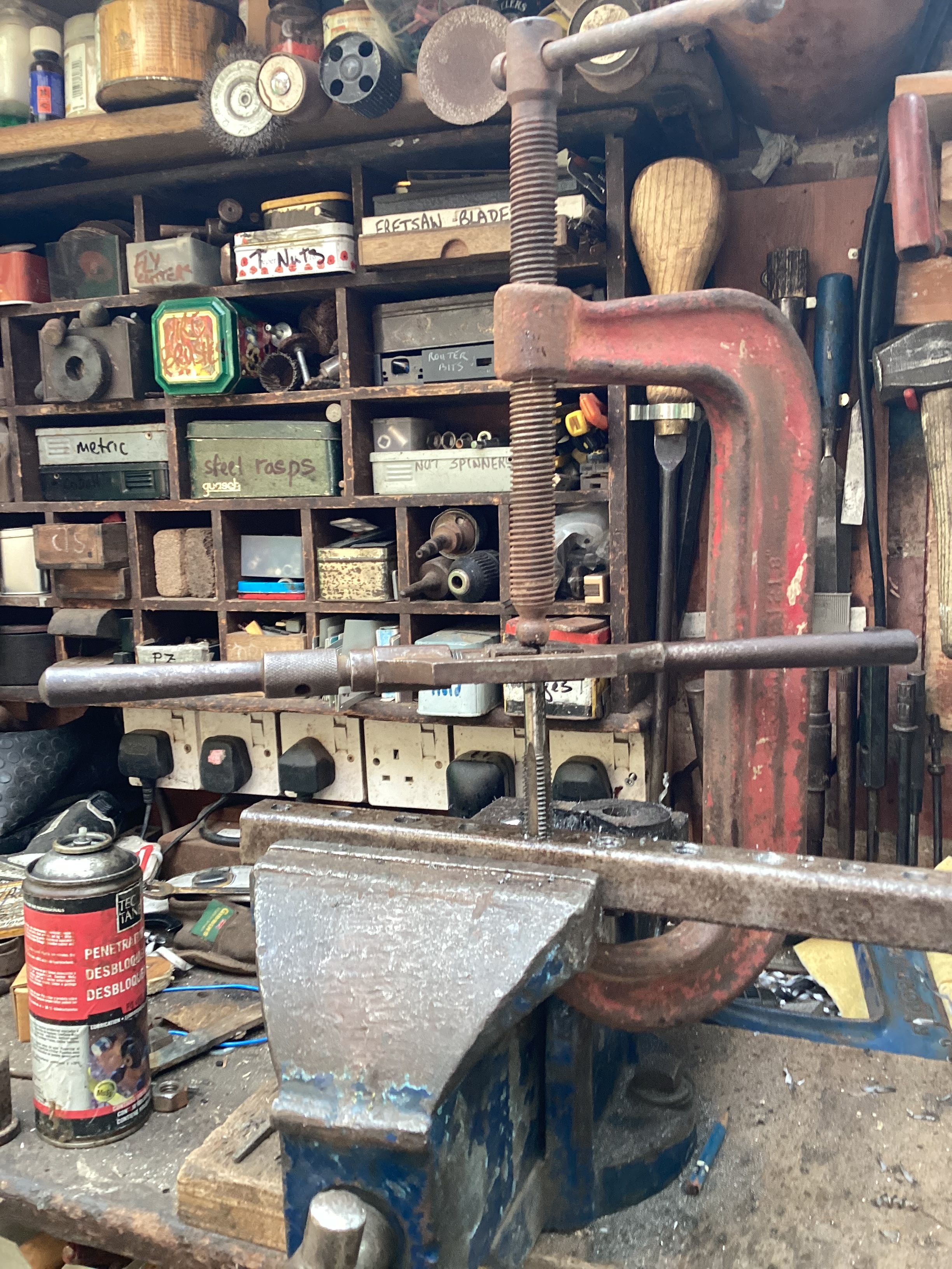

    The fact is that I’m unable to exert enough downward pressure to start the thread in these 10mm holes for 1/2” BSW (& the hole, says the tables, is supposed to be 10.5mm) Then I used a taper reamer, no.7, which might suit, though haven’t looked it up.
    Still only a half-turn can be done, before moving the clamp, and I cam check each time that it’s square to the material. After 4 goes, the thread has started and little more downward force is needed. Otherwise, blood pressure shoots up!
    These are first steps in metal machining, and very totters steps they are, indeed, beginning with T-nuts.
    What you see here is a rehearsal in aluminium, and of course the cutter slipped down. Tapping aluminium alloy was hard enough.
    You may see that I have got a second tap in the holder. That is because the starting tap has chips in it. Hand-tapping-7412dc5c-86b9-41be-af22-fe8dc5fb1967.jpeg
    Do you think that this is salvageable?

    I have found charts that say 10.5mm holes for tapping 1/2"-12 BSW, but I don't think that is correct. The minor diameter is barely 10mm for the minor diameter minimum (minor diameter maximum is 10.57mm) and the pitch diameter is 11.35mm. Even 10.5mm seems way too small. Even tapping a 10.5mm hole would imply potentially 100% thread engagement. That is too high for steel. Normally for steel 50% is workable (75% max for aluminum).
    I found another chart that says 65% thread engagement is a 10.9mm hole. https://journeymans-workshop.uk/whitworth.php
    Measure the OD of the tap at starting thread and then at full thread and compare it to the minor diameter. That whould help pointing you in the right direction. Remember, the Tap shouldn't be milling the hole way before the first thread.
    Interestingly, I found another chart with various tap sizes and it lists both imperial and metric drill sizes and if you check the conversion, for all but 1/2", the drill converts correctly, but for 1/2" is says 0.4465" and 10.5mm but
    0.4465"= 11.34mm (which is the pitch diameter)
    10.5mm= 0.4134"
    So, I would go with the 10.9mm (and maybe a little more)...
