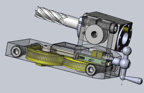

Spiral end mills the diameter you would need to regrind into a button would need to be at least a 6 fluted mill an odd numbered flute would be better for centering in the bore but I've never seen a 7 fluted end mill that small which would also have a very tight spiral of around 1 in 1.5 to 1 in 2 far too tight to be reground into a button. but if very careful attention was paid to the regrind of a .250" end mill there might be enough material in the cross section of the fluted to yield the features of the button when the grinding was completed.
I suppose you could do this with a 2 fluted mill but it would be very difficult if not nearly impossible to hold it perfectly centered as it finished forming the groves additionally you would still need a fixture such as one I started designing for my Clarkston tool grinder which I no longer have
this 5 axis tooling fixture that I hope to one day build and perfect would probably be what would be needed to make a proper button
Name:	tooling holder rotary slide profile1.JPG
