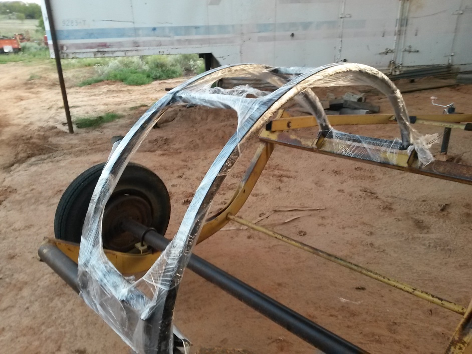

Someone took the hook off of my neighbor's hay dolly. so I cut up one of the hose reels I had then reduced the diameter in my hydraulic roll to match the size of the dolly.
Attachment 36711

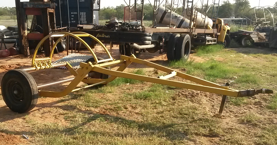

Attachment 36712

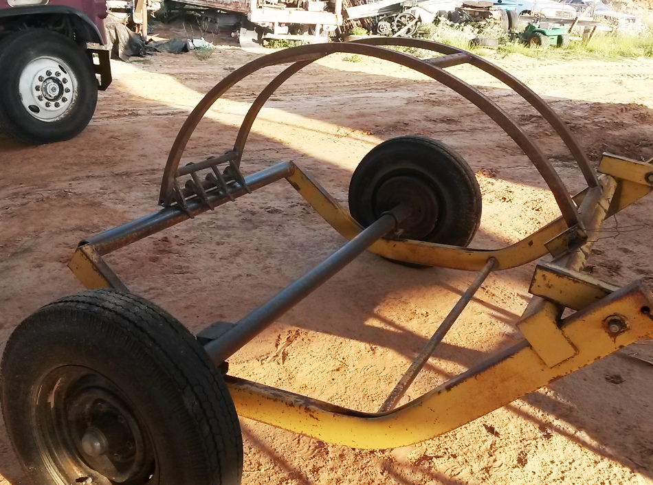

then I sprayed the rust blast on it and wrapped it in plastic to slow the evaporation
Attachment 36713

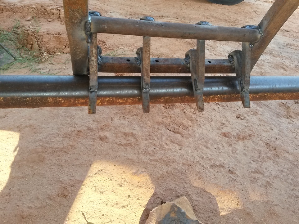

this morning I removed the plastic rubbed off the loose material then painted it with old equipment yellow by KBS
Attachment 36714
