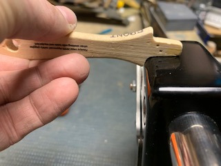

    I made some tools for this build. The handle from a chip brush became a radius gauge for the body corners. I measured all three of the Rail basses that I had and they were all different (Matsumoku was the first to use CNC for guitar bodies, but they were all hand made otherwise), so I made the template an average of them all. One profile for the front and one for the rear.

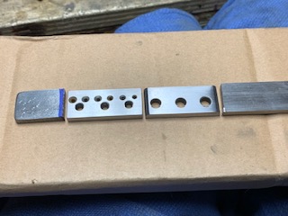

    I cut the string clamp from a piece of mystery steel that was close to the desired thickness, so it was easy to trim to size.

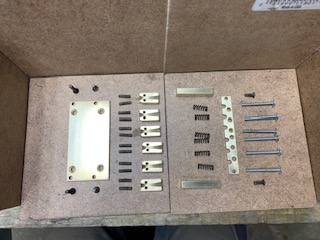

    The bridge unit in exploded form before final sanding and polishing.

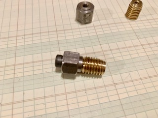

    Another part and another tool. The part is a threaded insert for the knob that holds the sliding pickup block in place, and the tool is the installer. The insert sits just shy of the surface. The tool is held to the insert with a bolt. Keep this between us, but the outside is Imperial thread, but the inside is metric. This is because I don't have a course metric threading die. Shhh.

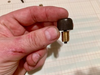

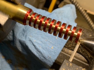

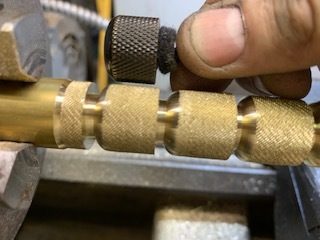

    I made the knobs in bulk, and I made extras. One for practice, three for this guitar, and two spares in case I stuffed any. One is on the red Rail bass now. I don't yet have a knurling tool that is course enough to replicate the Westone "Speed Demon" knobs, but they work.

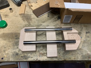

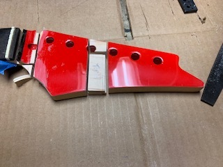

    The body segments are held to the rails by standard 4mm wood screws, but have very thick brass washers to distribute the load. They work very well.

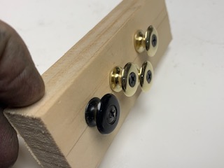

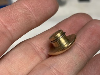

    The strap buttons on the Westone headless basses are bespoke, and no one makes replicas (too bad, since they are superior to the common Gibson and Fender type, so I made my own. I got surprisingly close considering my lathe is ancient and worn. I cut a contoured tool to make the inside radius and step. A few weeks ago I made another tool to automatically cut the slight angle on top, but still need to trim it to cut the radius around the edge, too. I hope to produce them in batches to sell to Westone headless bass collectors (all 3 of us). The black one is an original.
