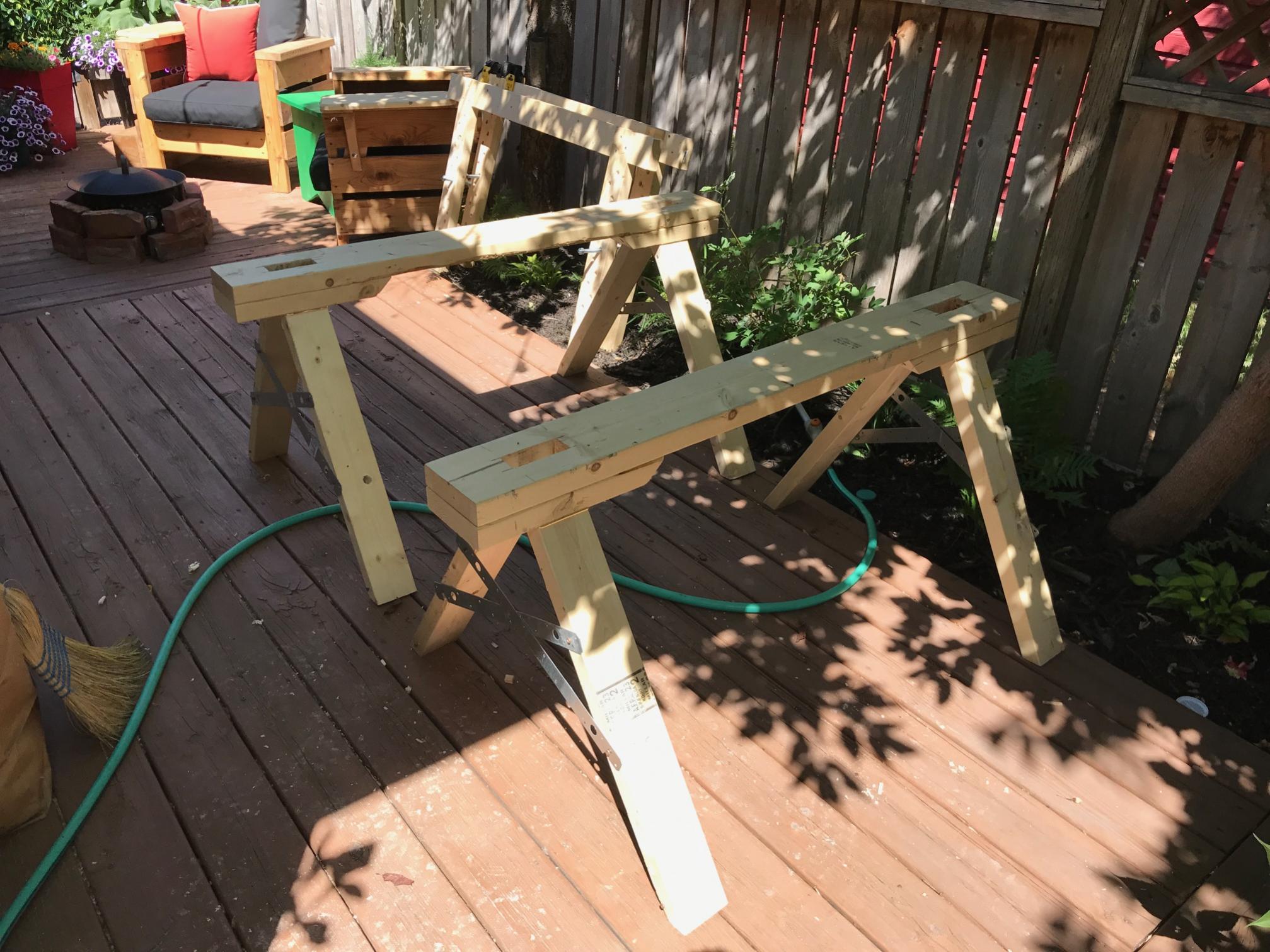

    Heavy Duty Adjustable Height Saw Horse

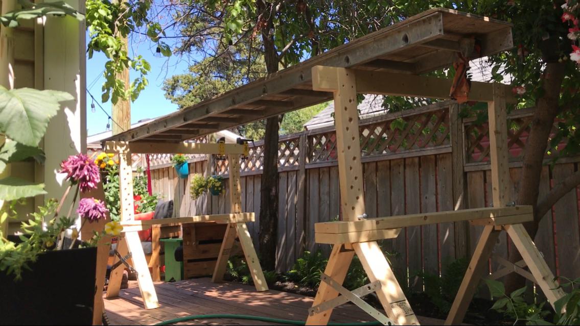

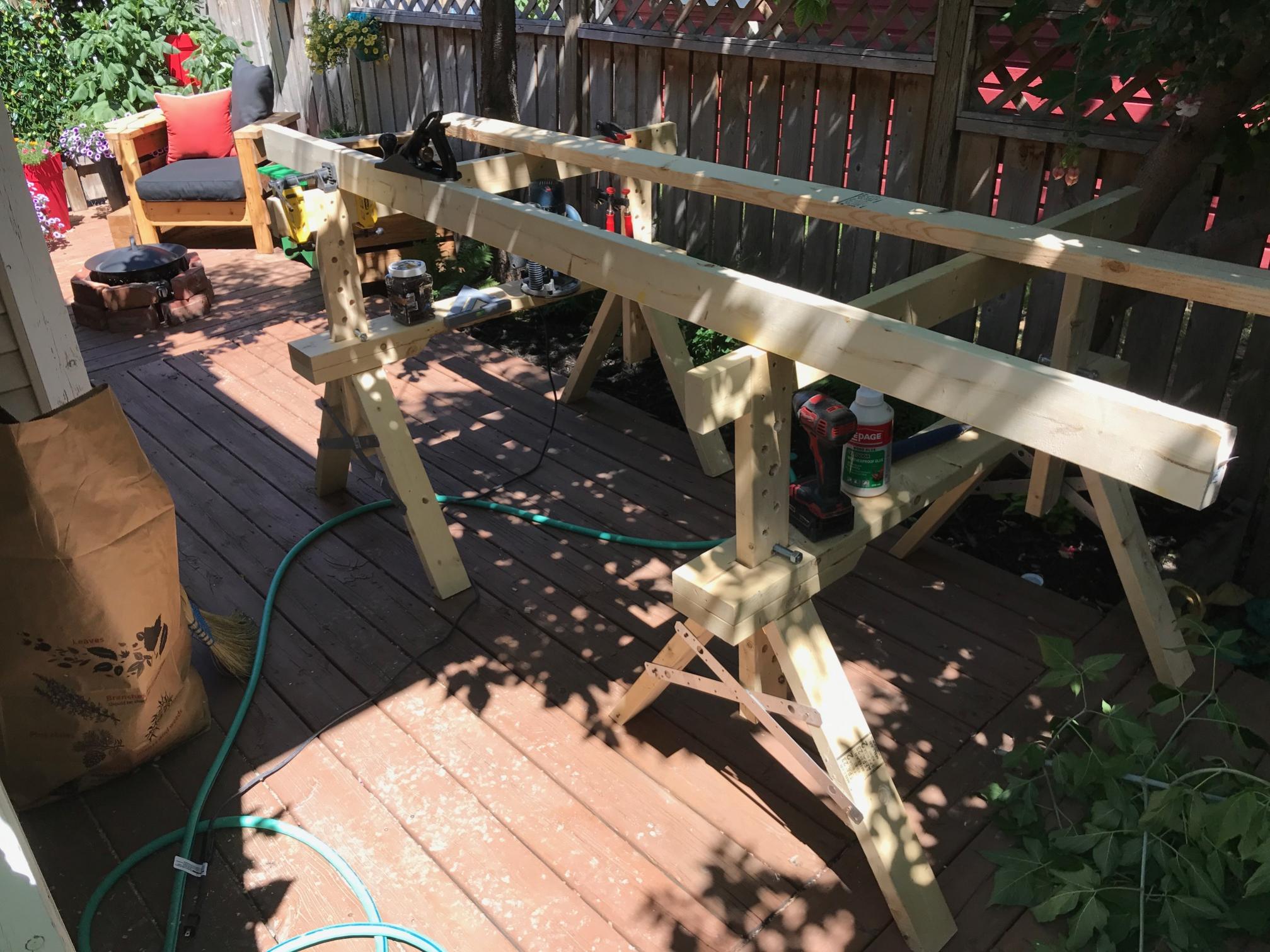

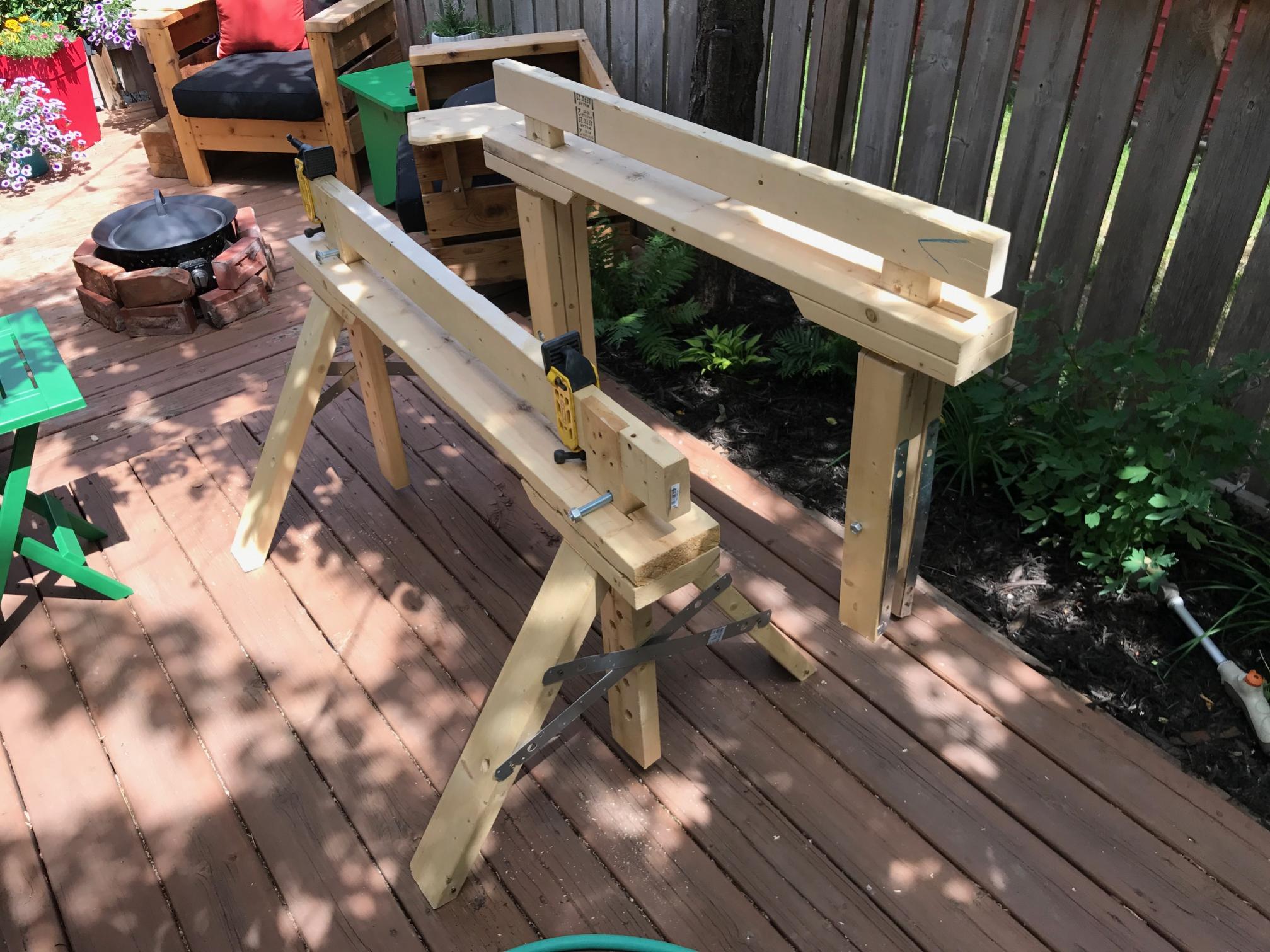

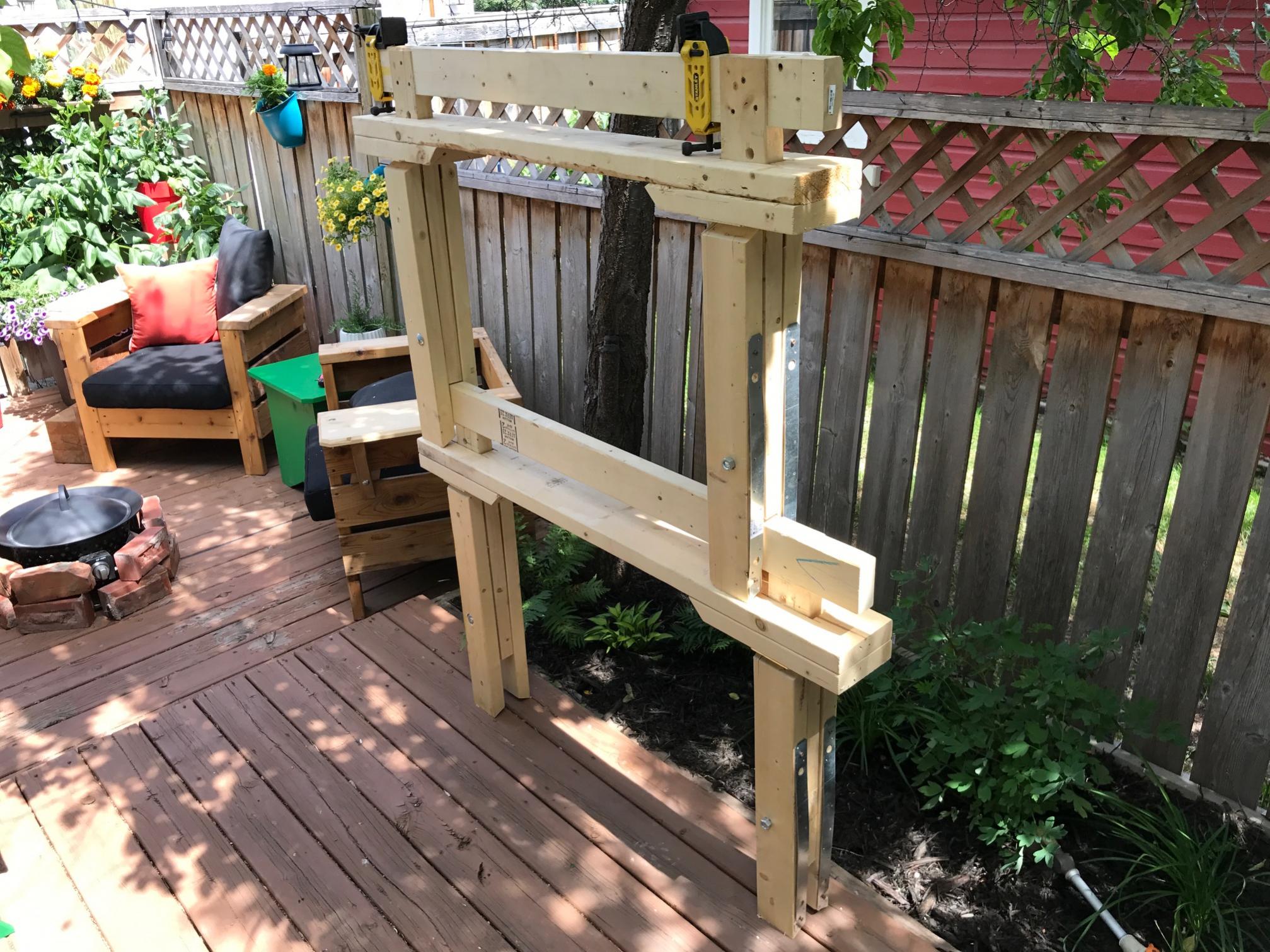

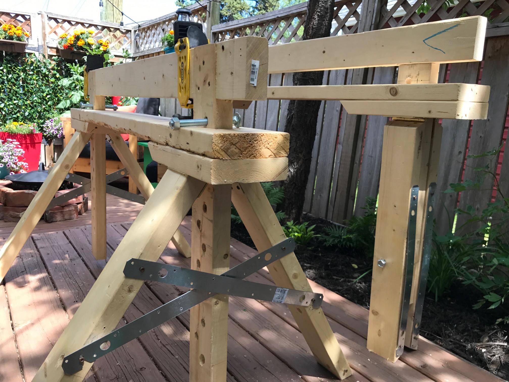

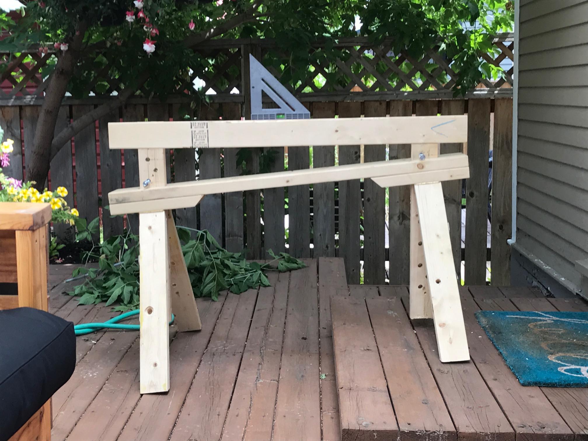

    These folding saw horses are adjustable from 2' to 4'. The legs have a wide stance (25 degrees) for stability at full height and they are each hinged on a heavy duty 3 1/2" door hinge. The legs are cross braced by Simpson Strong Tie straps that hook into screw heads.
    The adjustable upper frame is joined with half-lap joints and is tightly fitted in two mortises in the base and are held in position with carriage bolts in offset holes every 1 1/2".
    These bolts also secure the legs in the stowed position.
    The upper frame can be set on an angle to adjust for uneven terrain.
    Made from dimensional 2x4 and 2x6 lumber and weighs 30lbs each.

    A very clever design, indeed. I especially like the fact that the working height of the support is adjustable. Most saw horses I've used are just too low to permit working comfortably.

    Have to Agree with Marv the adjustable height is a plus being able to use them on a step or with 1 side raised is another nice addition.
    I would feel a little uncomfortable using them in the full elevated position as a scaffolding but as always the user must exercise care and caution when working on any elevated platform.

    Very nice indeed!! These are something I could use on the my ranch in Texas. Do you have any plans drawn up them?

    Glad you like them. I don't have any plans, sorry.

    Very nice sawhorses; vastly superior to my ancient '2x4 + wobbly sheetmetal sawhorse brackets' pair. What is that yellow and black clamp set I see in pics 2 and 3? I think I shall look into my supply of lumber and build a paor of these to replace 'em.

    bruce.desertrat asked about a yellow and black item on the elevating 2x4. Aren't those clamping devices, more or less like a pipe clamp but fit lumber? That's another outstanding feature of your horses. I avoid the molded horses for one reason; useless for clamping to the top. Use of hinges, tie-bar strut, leveling feature...what an array! I'm thinking these didn't just happen overnight
