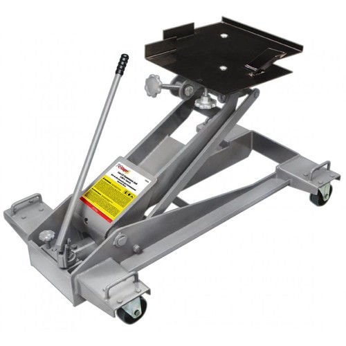

    Here is a picture that of a jack like the one I used to have
    It was an OTC 2000 cap Jack which was a good jack but it had things about it that I found more or less useless for a jack of its size.
    the adjustable tilt to the table was next to impossible to change positions on once the weight was on it also the table plate was too small for the larger 15 & 18sp transmissions of the time it did have a lower collapsed height than the one I built by 1 1/2". BIG DEAL I'm not crawling under a truck that is on the ground anyway I have a pair of 20 ton aluminum ramps 8 ft long by 20 inches wide that I will use to back the tandems up on to a pad of 8x8 blocks then I'll use my 15 ton air jack to lift the steer axle up till the oil pan on the engine is level and set that on a pair of my heavy duty jack stands and blocks under the steer tires as well

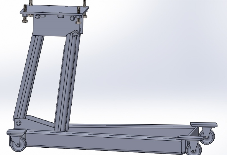

    My jack will go down to 8 1/4" and raise to 38" the parallel link bars are 10" apart to give it tone more stability than any factory jack made plus they are wider and thicker in stature having a full 1 3/4" long pivot where as a factory jack is only 3/4" on little 1/2 by 2" bars By welding 2 pipes together this gives them more resistance to twist or side sway. Also I used a long ram 8 ton engine hoist jack this puts the lifting force applied directly to the plate which allows for a better lift transition angle over those of factory design which are really little more than elongated floor jacks
    here is a picture of the cad drawing of the jack I built the 4 adjusting bolts will be added once I have a look at the bottom of his transmission then a lock down strap will be added as well to secure the transmission to the jack plate

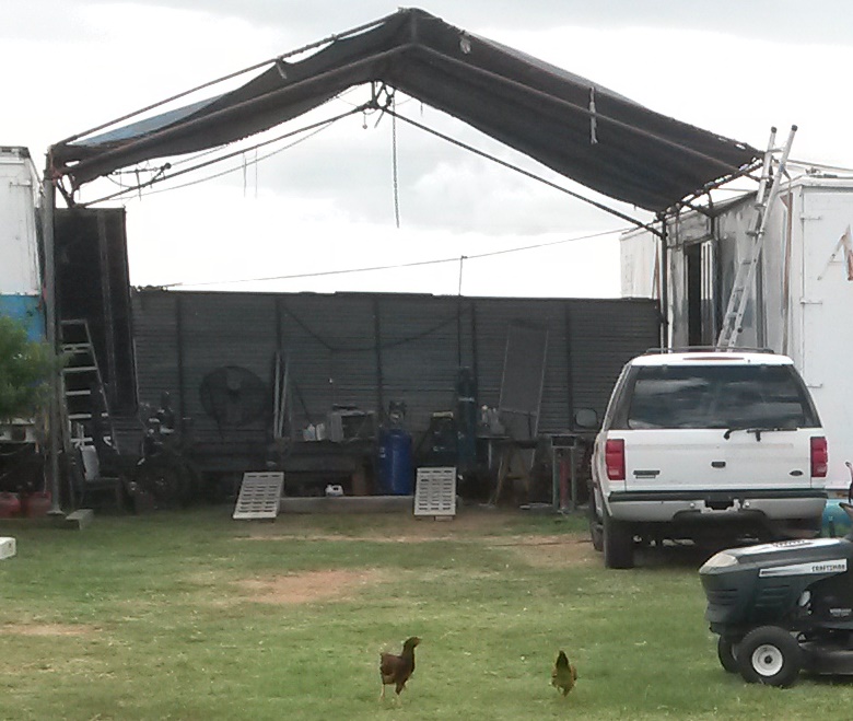

    the first thing I did set up my ramps to back the truck on.

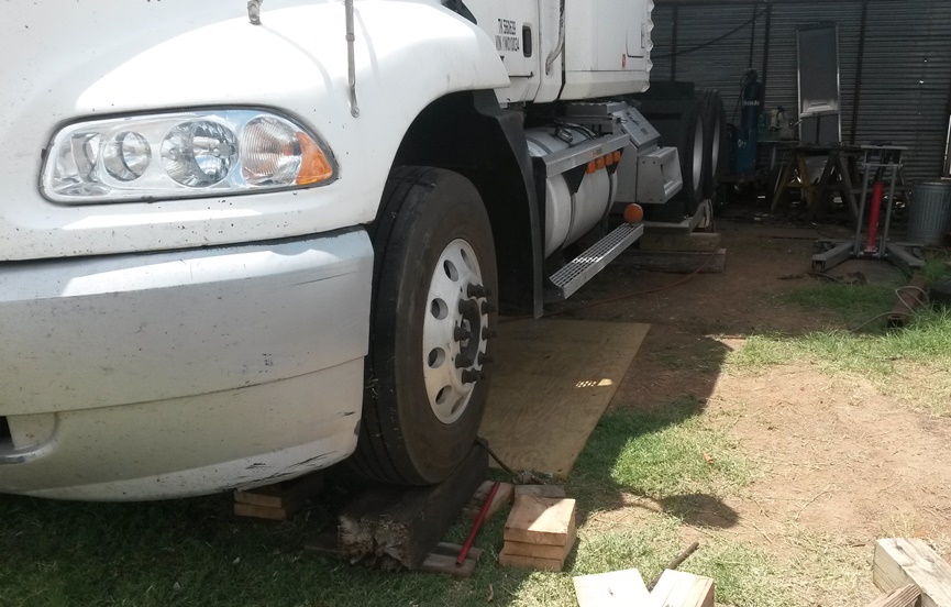

    A lot of guys pulling transmissions out of trucks will just raise the front end so they can have some room to work This is problematic as the engine and transmissions are mounted at a down slope angle if the front is higher than the rear the angle increases When pulling a transmission that weighs over 1000 lbs or any transmission for that matter the closer to having the engine and transmission parallel to the floor the better this makes for ease of removal and reassembly. since the jack only has to roll and not be adjusted for height as you are doing the job
    It helps to have a lot of heavy duty large wood blocks
    I have more if needed LOL
    Back the truck up the ramps
    Secure in place
    Font is 10" off the ground and the rear is 18" the work floor under the truck is 2 4x8 sheets of 3/4 treated plywood

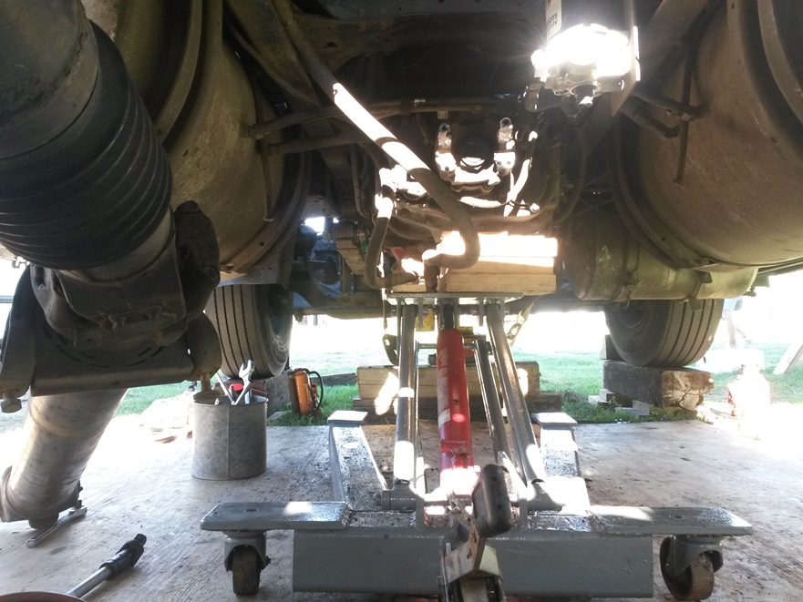

    Transmission out on the jack. It works like a charm was able to raise the transmission and the rear of the engine with it to lift above the rear mounts and add a support under the engine to hold it in place was probably having to lift at least 4000 lbs
    Due to there being a PTO mounted on the bottom of the transmission adjusting bolts were out of the question So I used my next favorite way of supporting things. Solid oak blocks then the transmission was strapped to the jack so it couldn't move
