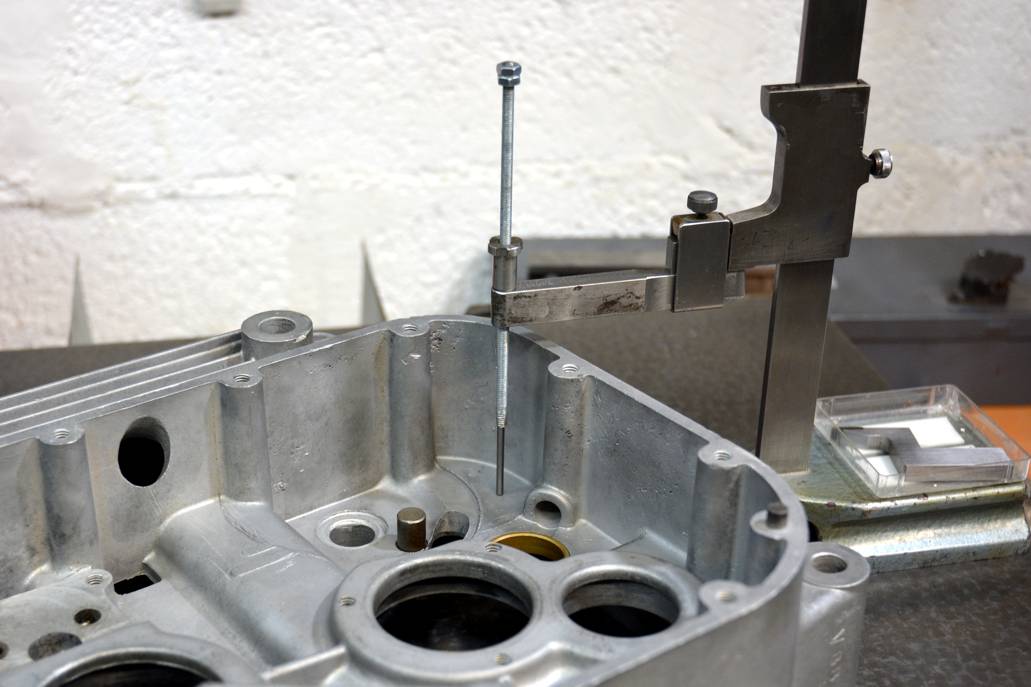

i started this topic with just a single modification to a measuring device, namely a vernier height gauge to help with reverse engineering a set of motorcycle crankcases. I had to make or modify a number of other tools as well. Here are some of them. Cheap calipers came in for some surgery to adapt them to specific tasks.
Attachment 26362 Attachment 26363 Click thumbnails for full size images

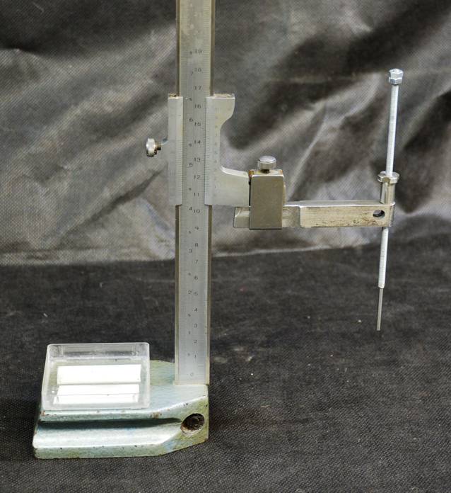

This my version of commercially available depth gauge addition. I used a 4 mm threaded rod with a lock nut above the holding beam which is threaded. At the bottom I fixed a carbide "probe". Firstly I set the vernier to a convenient nearest 10 mm setting and then I adjust the probe and lock it to a reference which may be zero at the base surface or it could be a reference surface on the part to be measured.
Attachment 26364 Attachment 26365

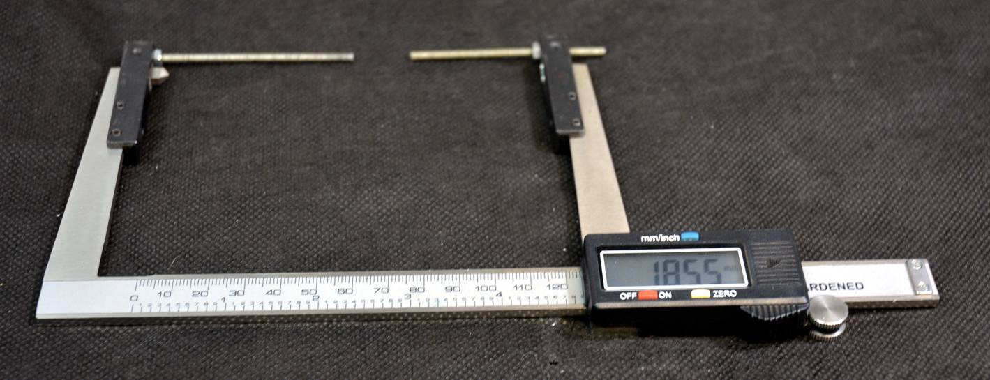

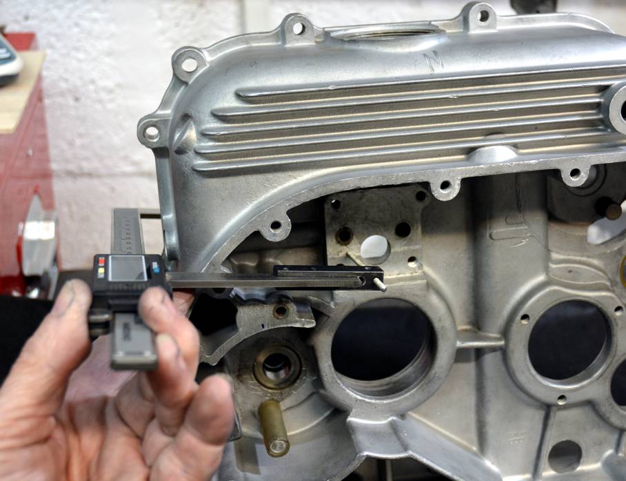

A while back a local Lidl store had brake disc calipers on offer. Due to its long jaws it has been very useful for various purposes. here you can see how I added to its utility by adding clamps to hold some threaded rod. This allows me to get very quick thickness measurements in awkward places. I could get the same results in most, but not all, areas by using the depth gauge modification above from both sides, but using the caliper is much faster. the RH pic. shows how it is used.
Attachment 26366

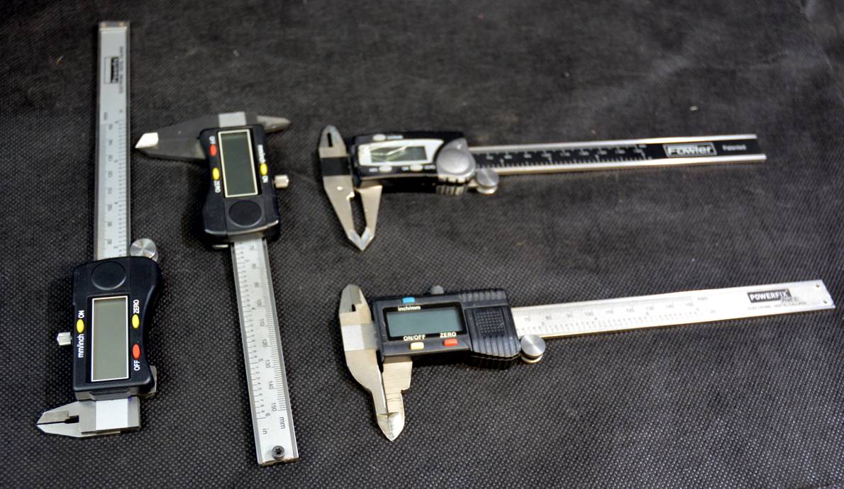

Here are some modified calipers. On the left I have cut off the OD measuring jaws, which allows it to fit some bores to measure grooves or spacing directly. The second one has been shortened to allow it to fit into smaller spaces, the usual depth gauge rod has been cut off also. A small bolt has been added at the end to act as a stop. The stub of the cutoff depth rod will bear against the bolt so the plastic case is protected.
The other two have just had the jaws modified to allow them to be used where there would otherwise be some interference.
All of the modifications here have been done to satisfy a practical requirement, none have been done on a basis of "it might be useful one rainy day".
