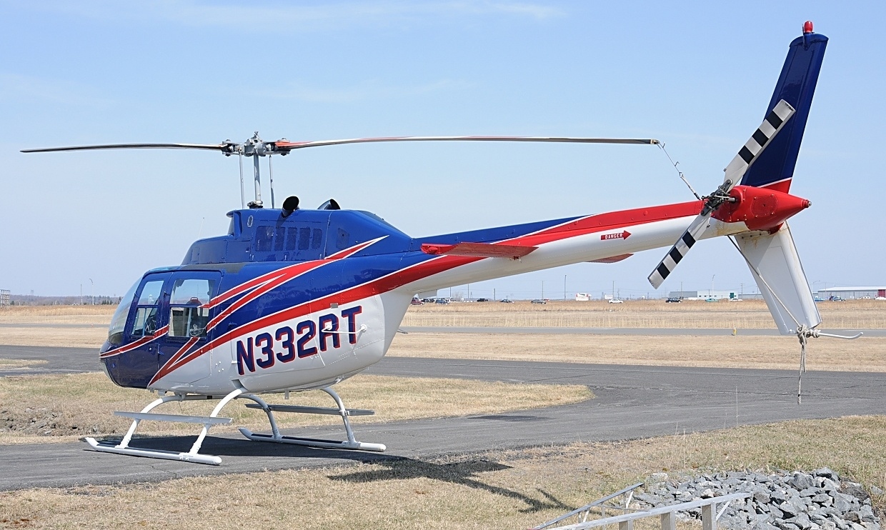

    Quote Originally Posted by Hans Pearson View Post
    I don't see a tail rotor on the aircraft in the video?
    It is (was) a Bell 206 or variant.
    The tail prop can be hard to see if it is painted a solid color and filmed in somewhat low resolution and frame rate, as Floradawg mentioned above. It also doesn't extend past the lower vertical stabilizer, which is why the tail strikes didn't turn this into a much bigger accident.

    The tail rotor is spinning too fast to see it. Hence why they are so dangerous on the ground and why more people are killed by the tail rotor than the main rotor.
