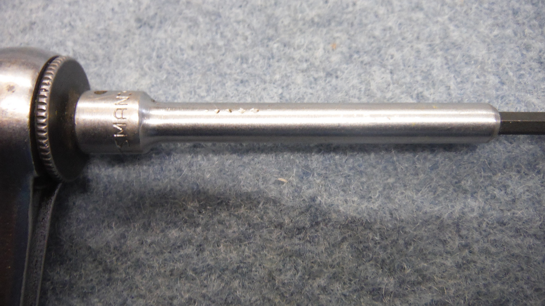

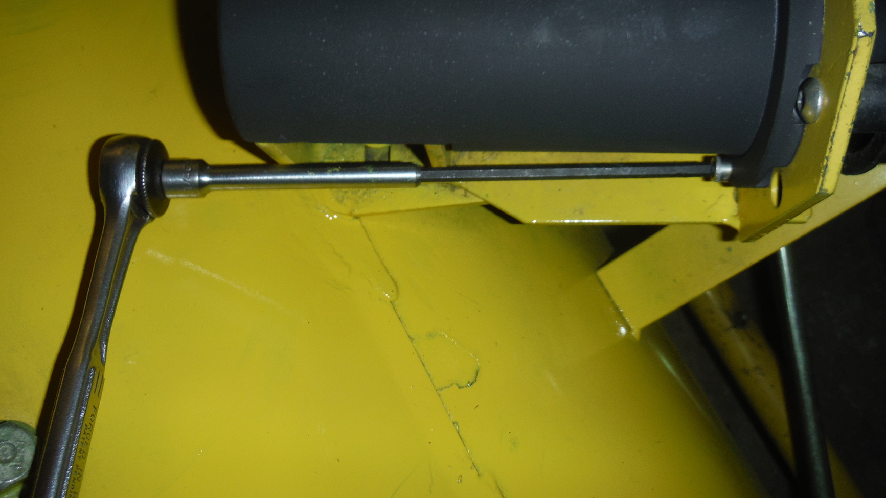

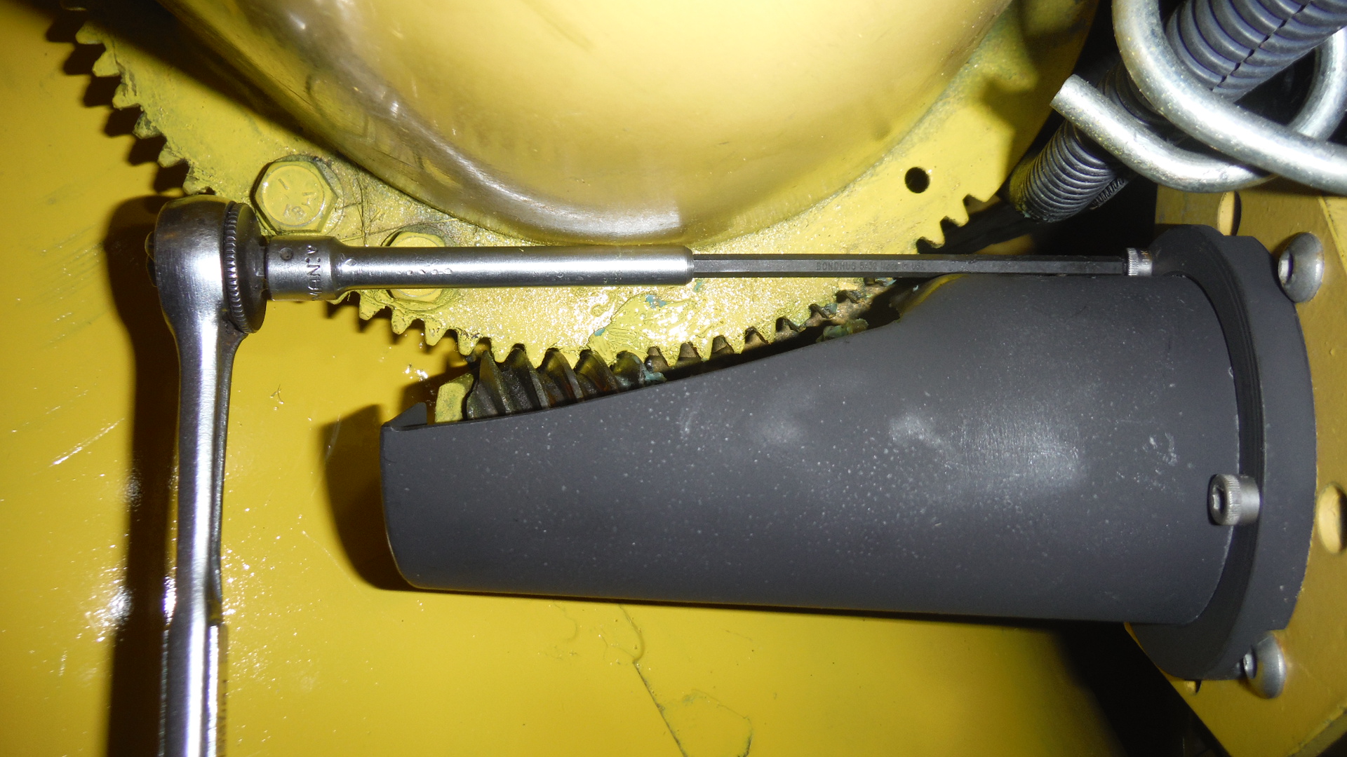

    There are 3) 10-32 SHCS holding the cover on and one of them is a bugger to get at. (foresight was a little short)

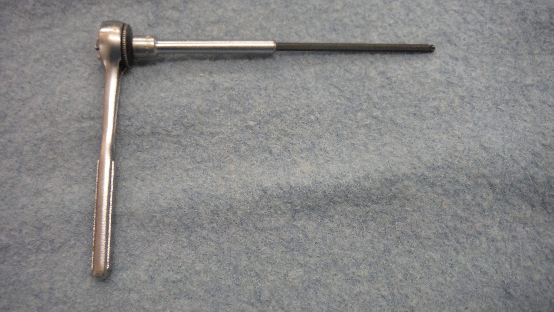

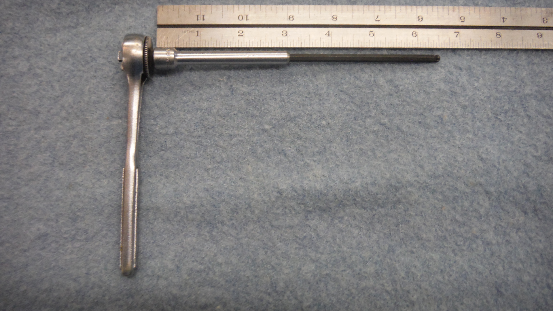

    I had this remaining part of a Craftsman 1/4" extension that lay in the tool box for years; never throw anything like that away!
    And a ball-end 5/32 Allen wrench was the size needed for the 10-32 cap screws.
    Cut off the bent end of the 5/32 hex wrench, and kinda smoothed it to a taper on the end that was cut.
    Drilling a hole in the end of the Craftsman extension was easier than I thought it would be. I made the hole about .010 less than the dimension across points of the hex. For good measure, I put some Loctite 609 in before joining the parts.
    A few good smacks with a hammer and it went together .
    Not earth-shaking, but fit the bill for getting at the hard to reach cap screw.
