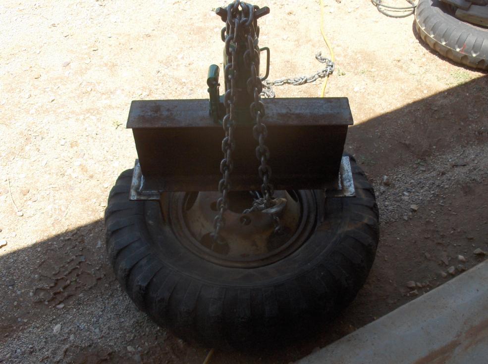

So to start, allow me to show you a recent one. A bead break for the split rims on my '41 Dodge truck project. It's a short piece of I beam with some heavy angle welded on. I supposed I could have bolted the angle on and used a series of bolt holes to allow for different size rims, but I can always cut it off and correct this rushed oversight if I ever need to.
On the top of the jack is a piece of pipe with a 'V' saddle welded to the top (one end?) that fits over the tip of the jack and cradles the chain just enough to keep it from slipping off. Pretty basic stuff, but the desired results were all I cared about and it worked as well as could be hoped for.
Attachment 821
