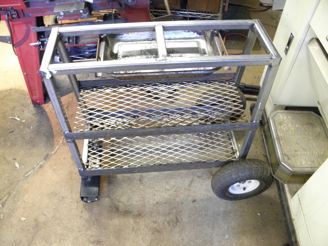

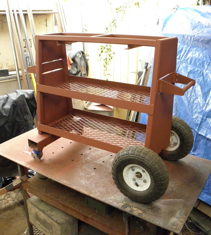

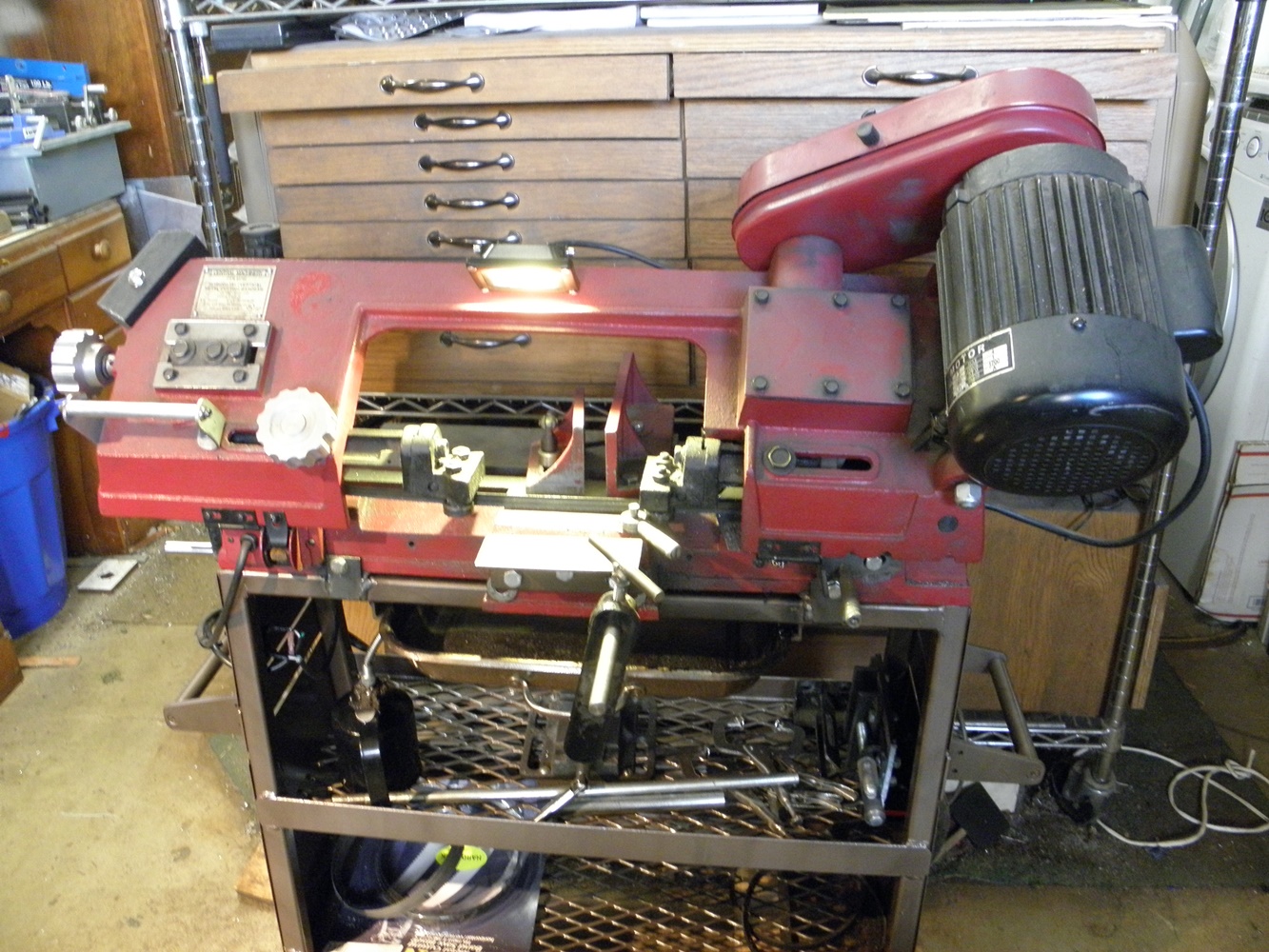

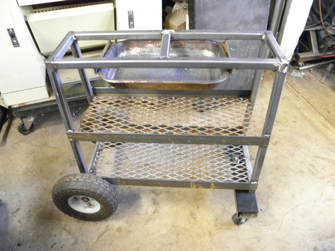

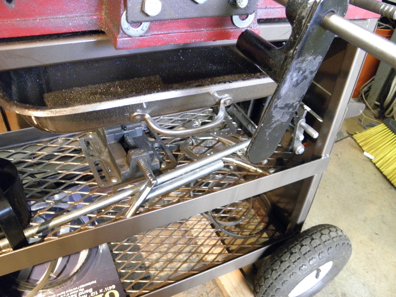

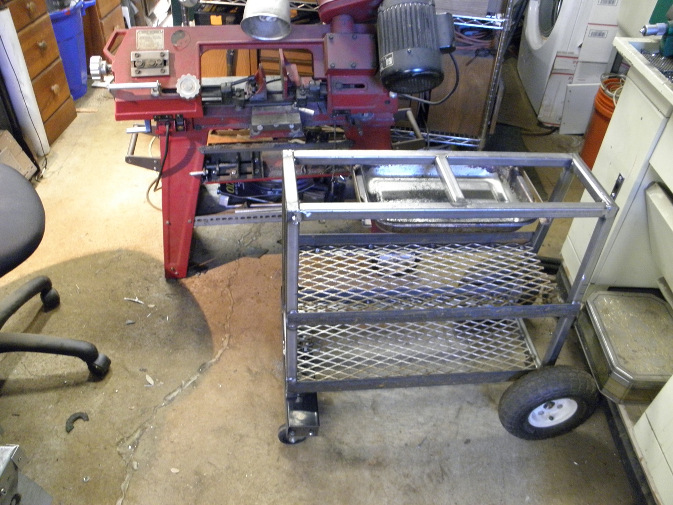

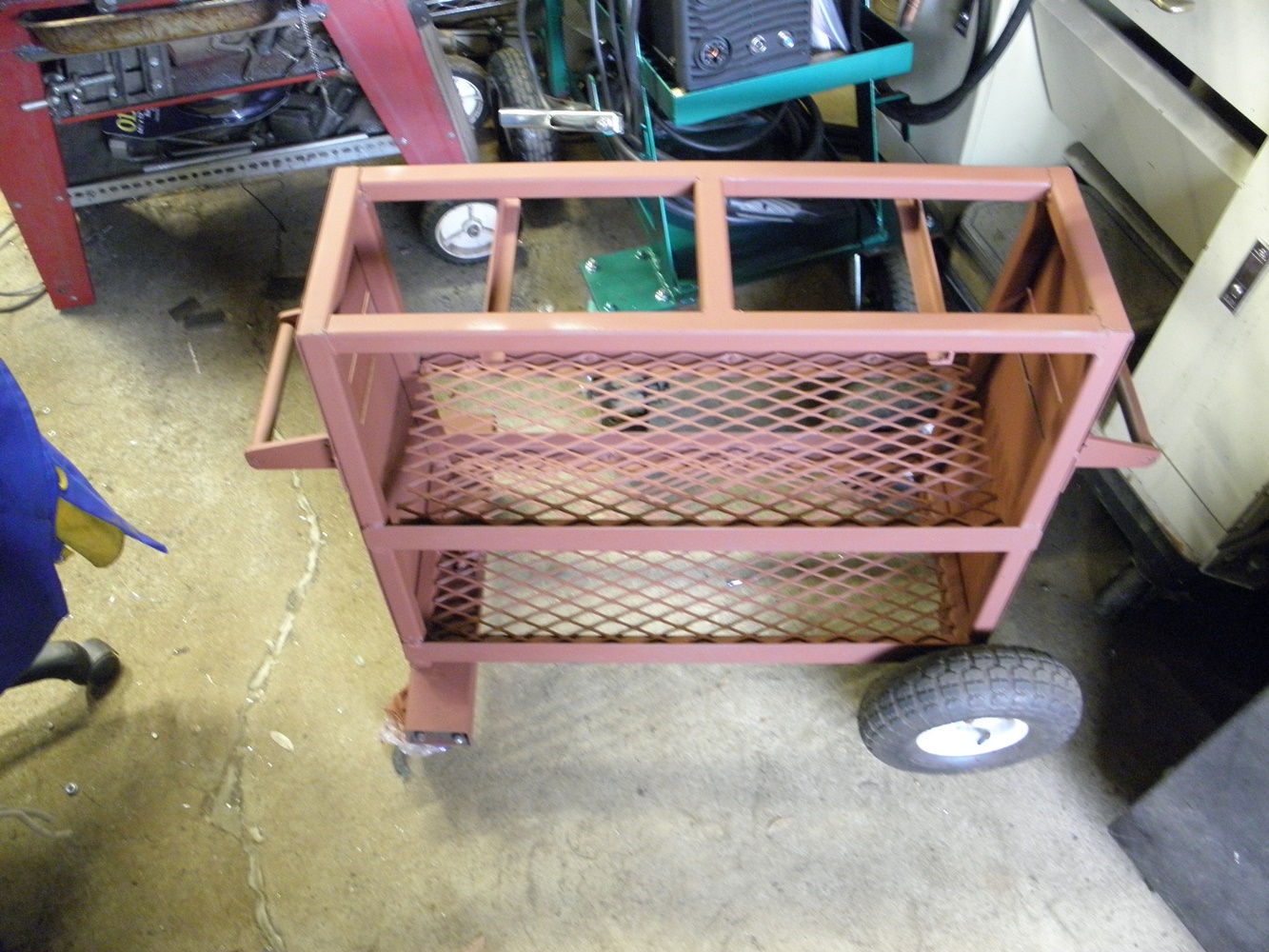

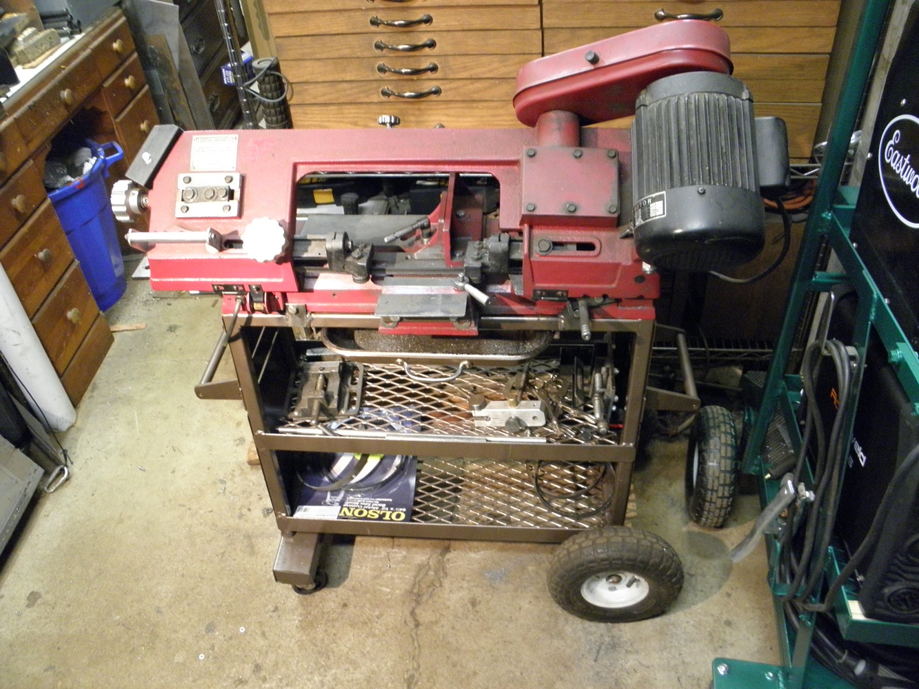

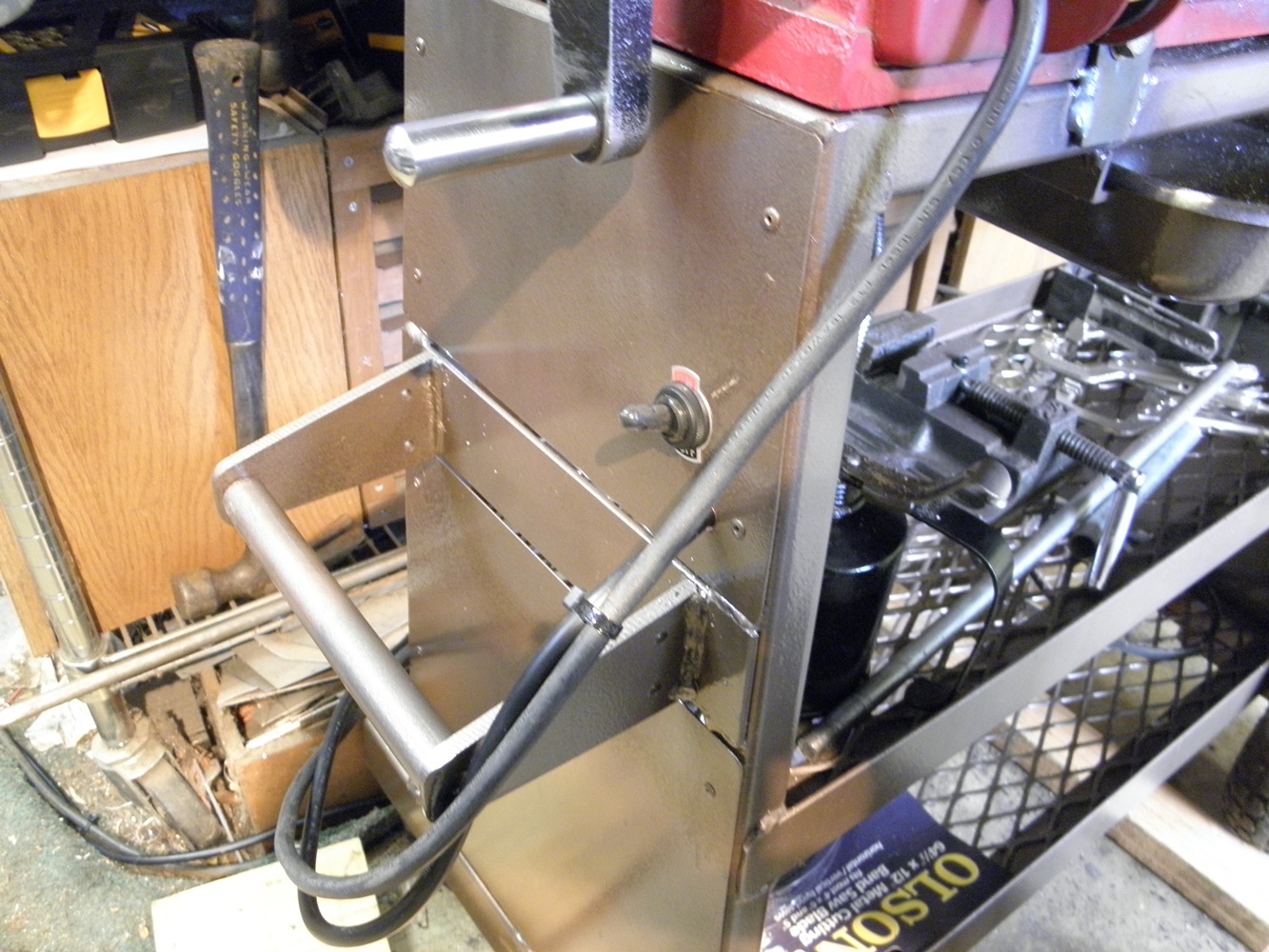

    HF Band saw DIY Rolling base with sworf tray. Made from 1" steel tubing, 1 1/2" angle iron, axle rod 5/8", 1/4 " steel plate and expanded metal shelf's.
