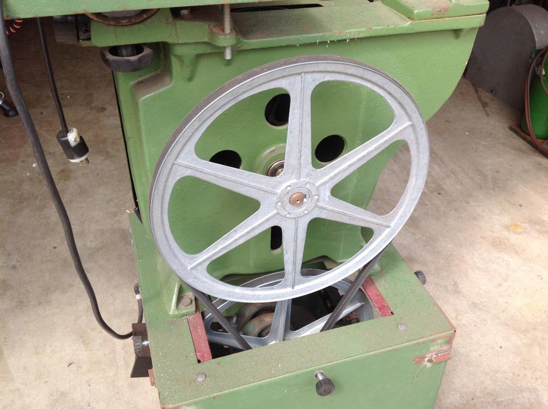

HFT 14" bandsaw mod
I'd been needing a good metal cutting bandsaw because I was using my small HFT horizontal bandsaw in vertical mode to do stuff. Most times it was small and odd shaped and it felt way to unsafe on the horizontal. I kept seeing these 14" Delta/Rackwell wood bandsaws on CL. but even when they say they are two speed they are still way to fast for steel. I did some digging around on YouTube and there was some vids that hinted at slowing the blade speed down but they were not specific. On the Practical machinist forum there was a long discussion of blade speeds and everybody concurred you were looking for from 110 to 190 fpm. The bandsaw stock is 3,000 fpm.
I found a HFT 14" knockoff saw for $75. I could tell the guy was feeling weird about selling it to me but when I explained I was going to do an overhaul of it he relaxed. The guy he got it from had never been able to get it to track and he'd never been able to get it to keep a blade on it either.

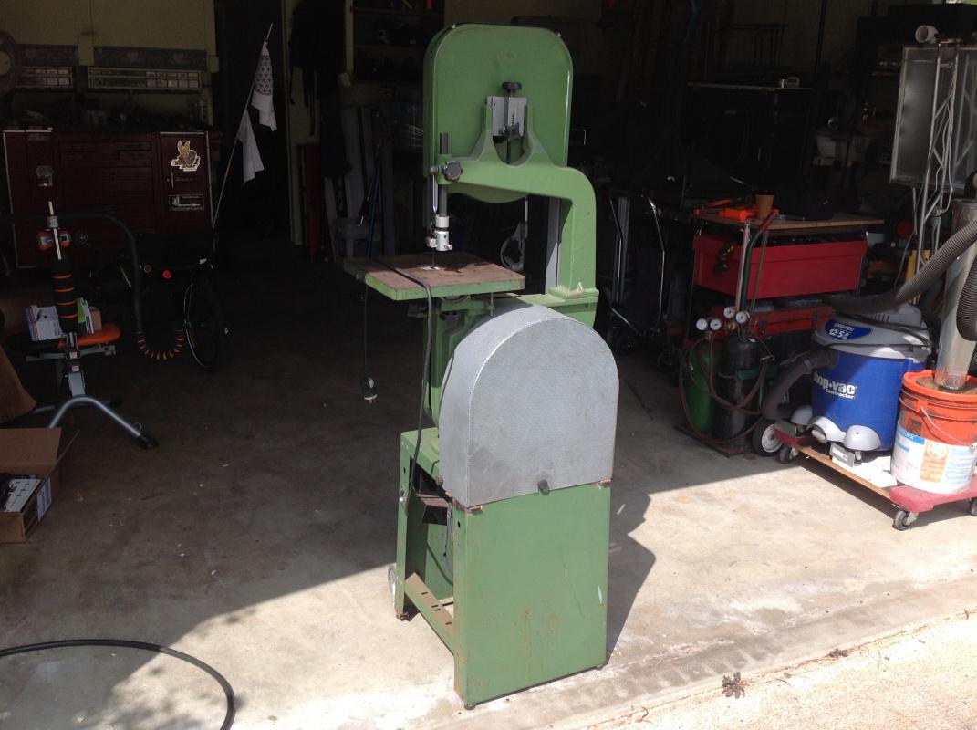

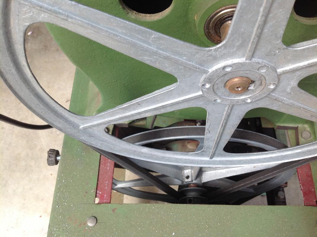

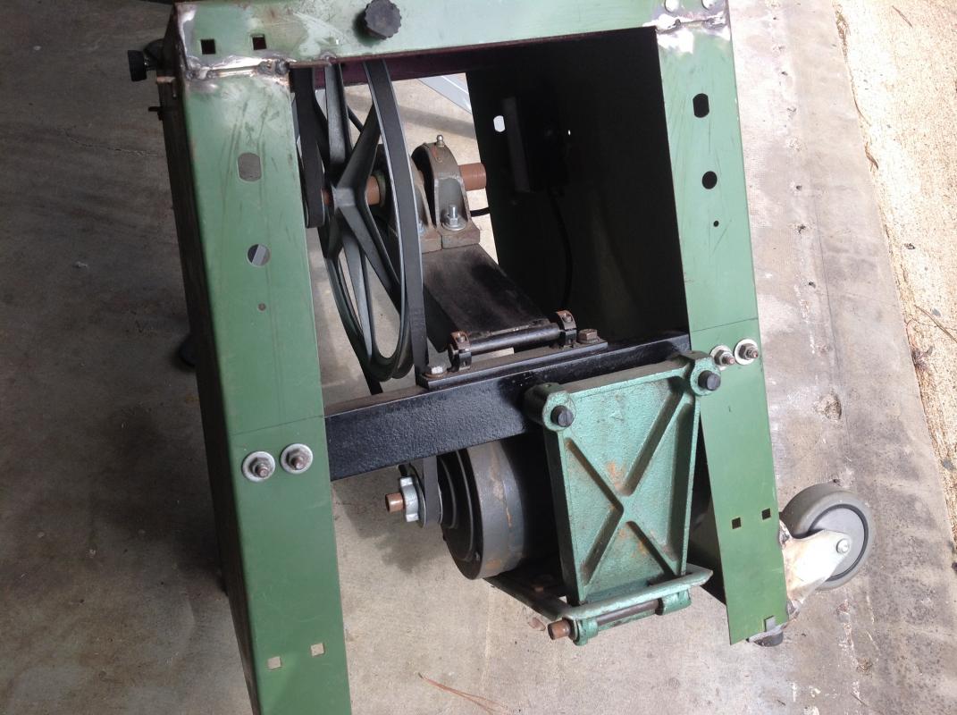

I looked on one of the websites that you can plug in your pulley sizes and it turned out I needed to do a double reduction. It already had 1 3/4" on the motor and a 14" on the saw bottom pulley so going by the chart I'd be in the ballpark if I got another 1 3/4" and 14" and make a jack shaft/double reduction. This program even told me by my belt sizes. I also had some 3"x3" angle iron, 1" shaft and two 1" pillowblocks. I also had an old motor mount from a grizzly table saw that I got off of CL ended up being junk. The original motor mount is one of those nightmare things that stupid to tighten and get straight. So it was the first to go. Stripped all that out and made new mounts for the hanging old table saw motor mount. The idea was everything would hang off the saw drive pulley tensioning the belts. The jack shaft and motor. And you just lift up on the end of the angle iron jack shaft mount and pull off the upper belt then lower the motor to the floor and pull of the motor to jack shaft belt. Works slick :) unfortunately it's been all together now for several years but I tried my best to tilt it over to show some details. Here it is together with a belt guard I made out of some perforated aluminum I got from a artist who was moving. Sorry about the paint, I never seem to get to that.
Attachment 9970
Guard off, looking down at the jack shaft.Attachment 9971Attachment 9972

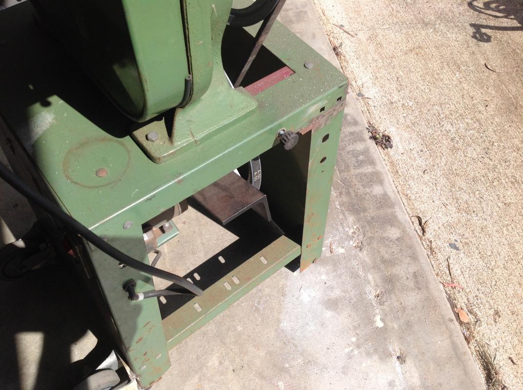

Note the red angle irons on the sides of the cutout hole under the feet of the saw body. That got pretty weak when I cut out that hole so I bolted those braces in there and stiffened up.Attachment 9973
Here's the opposite side.

This is a shot from the same side as the last pic but I wasn't sure you could see the angle sticking out that the jack shaft is mounted to. This end just floats, the pivot being right above the motor. So this is what you grab and lift to loosen the top belt, and let down to rest the motor on the floor to change the bottom belt.

The photos definitely help explain your modifications. The weight of the motor provides the belt tension. Buying the blade guide gets you running right away and probably one of the most important parts.
Thanks for posting the photos. Lots of great ideas.

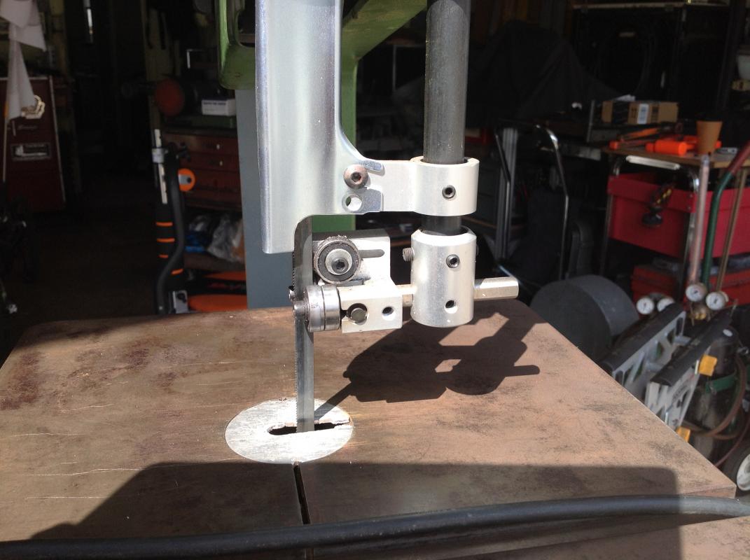

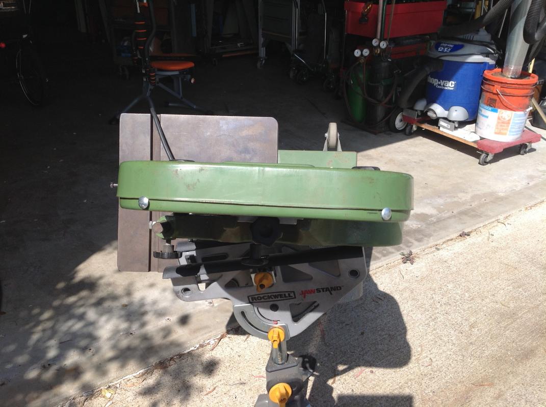

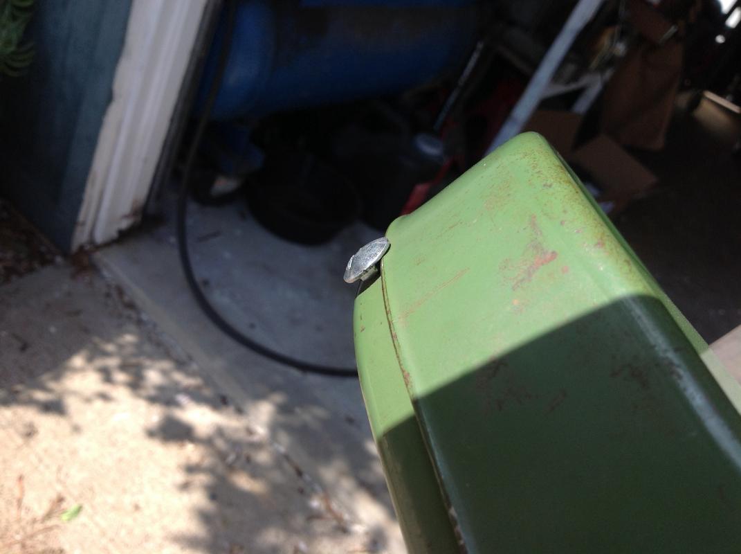

6 Attachment(s)

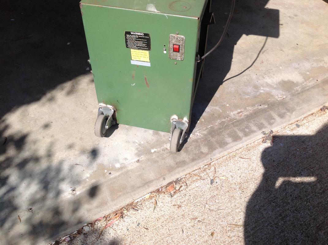

I'll try to finish up and see if the server will let me upload these last pix. As all my machines this one has wheels so I can tilt it and move it wherever I'm needing. Because I work out of my garage I have to push all the unused machinery out of the way when not use and then redeploy when needed. And in order to grab the top of the saw where the upper wheel guard is and not collapse the guard and rub on the blade wheel I put 1/4" carriage bolts as stops.
Attachment 9981Attachment 9980Attachment 9982

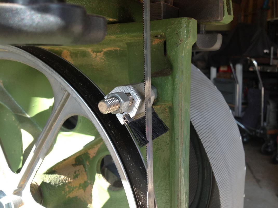

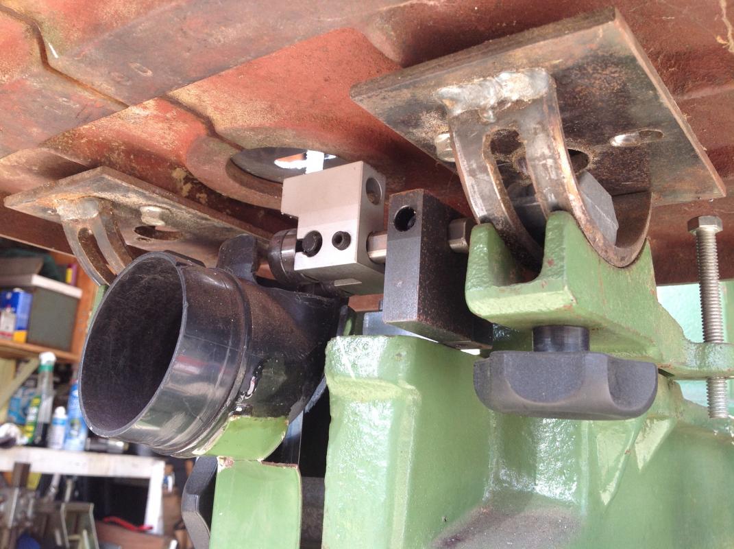

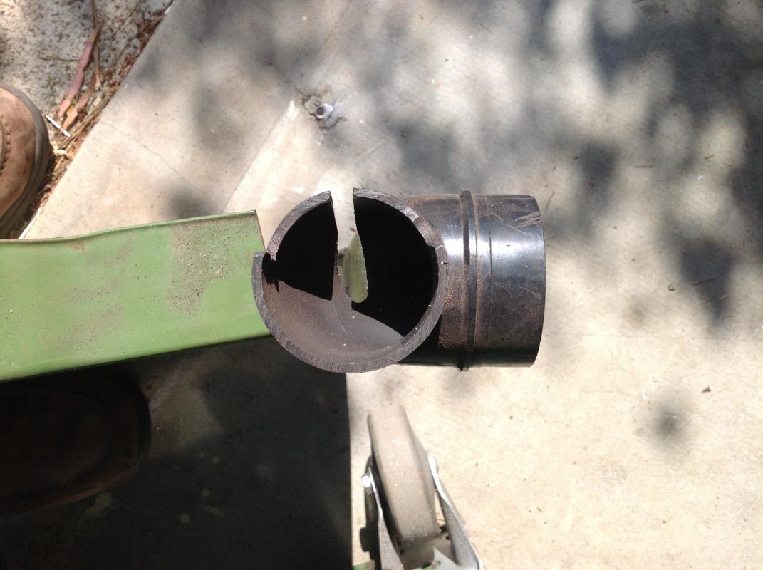

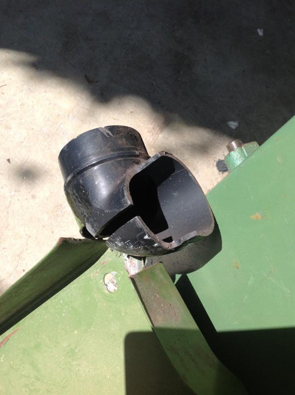

The other key to tracking and tire longevity is keeping schmootz off the tire so the metal cuttings don't embed themselves into it and cause the tire to deform. I had an old brush laying around from some fruit packing machinery so I incorporated it into the lower guard mount.Attachment 9983along with a modified vac elbow mounted to the bottom guard.Attachment 9984Attachment 9985
Real Nice, C-Bag! Nice pictures that show the details well with the write up. That jack shaft system seems to fit in there real good and still leave easy access. Liked your "schmootz brush" too with a handy mounting on the casting. The tip casters and carriage bolts are a nice touch, leaving solid contact to the ground when in position. Curious if you ever swap back to wood SFM and what it takes to get there?
Those guides are pricey beauties, but well worth your overall costs for what you got out of the deal! A great reconstitution of a meager machine on a cheap and cheerful budget!! Before I forget...what blades are you using? Thanks for sharing it with us.

Thanks Wiz. I do virtually no wood work. But I have done several projects with UHMW and for those I swapped the wood blade back in but can't change the speed. I guess I could but the motor and the upper pulley don't line up anymore so it would be a hassle. It worked great, slow, but great. That's also what the vac hook up was for. That UHMW goes everywhere and I guess it gets a static charge and gets all over the tires and everything else even with the schmootz duster.
