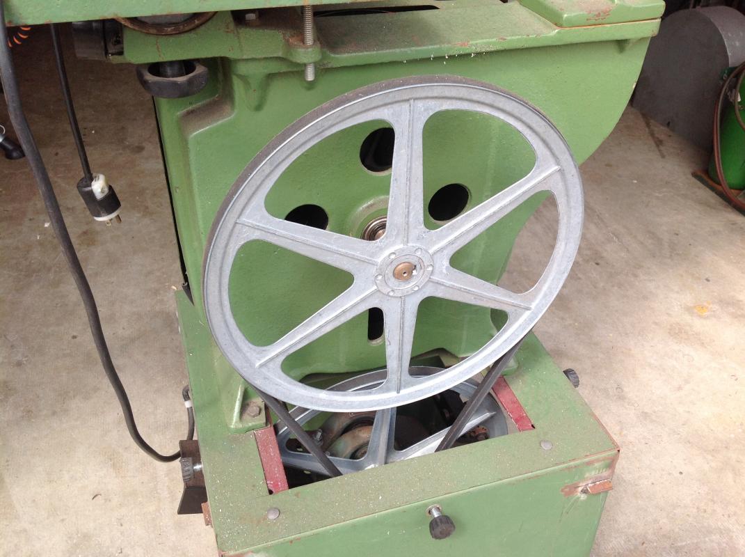

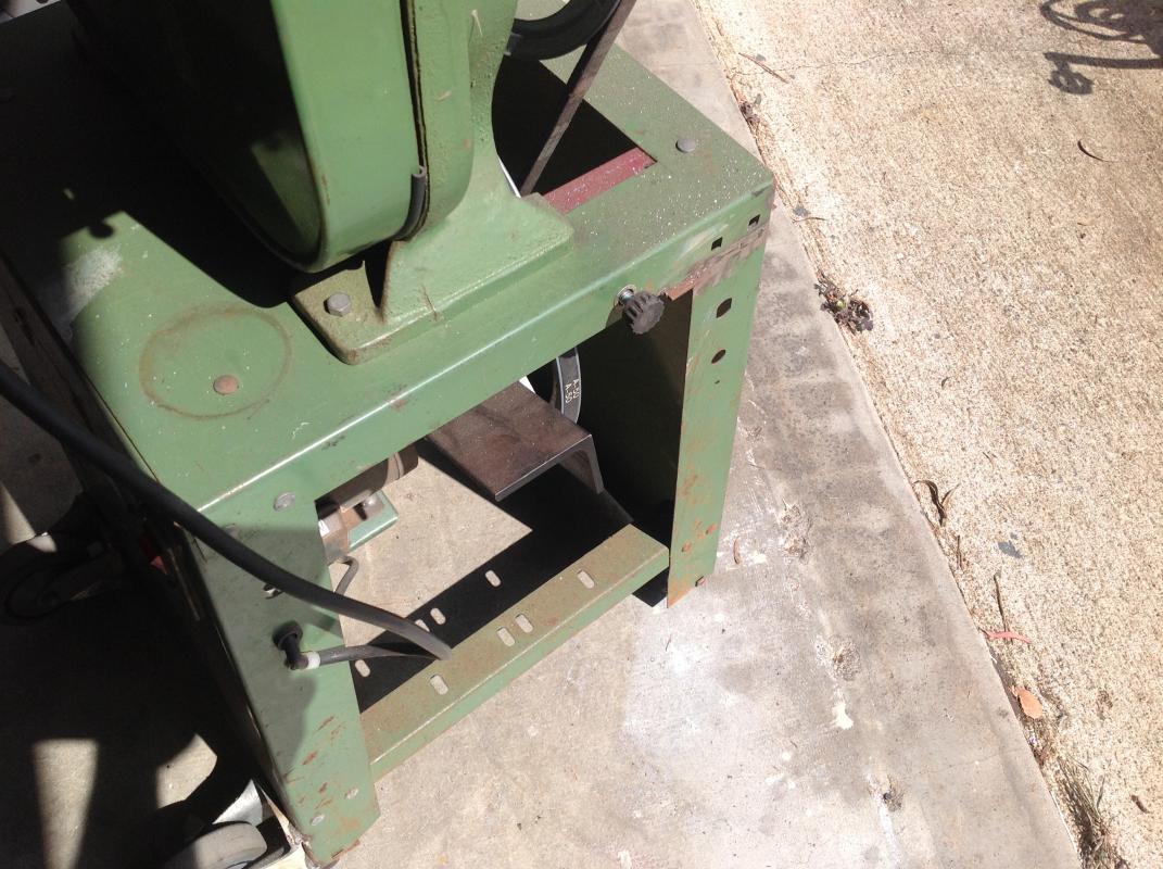

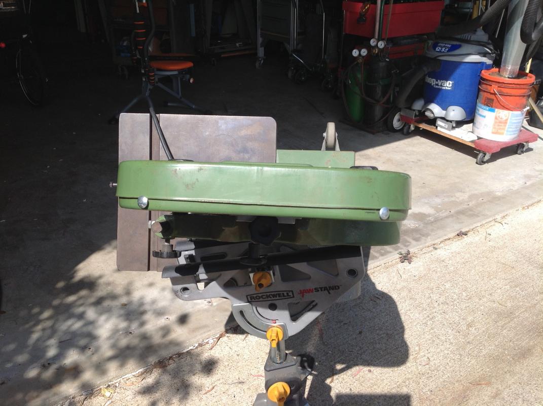

    I'd been needing a good metal cutting bandsaw because I was using my small HFT horizontal bandsaw in vertical mode to do stuff. Most times it was small and odd shaped and it felt way to unsafe on the horizontal. I kept seeing these 14" Delta/Rackwell wood bandsaws on CL. but even when they say they are two speed they are still way to fast for steel. I did some digging around on YouTube and there was some vids that hinted at slowing the blade speed down but they were not specific. On the Practical machinist forum there was a long discussion of blade speeds and everybody concurred you were looking for from 110 to 190 fpm. The bandsaw stock is 3,000 fpm.
    I found a HFT 14" knockoff saw for $75. I could tell the guy was feeling weird about selling it to me but when I explained I was going to do an overhaul of it he relaxed. The guy he got it from had never been able to get it to track and he'd never been able to get it to keep a blade on it either.

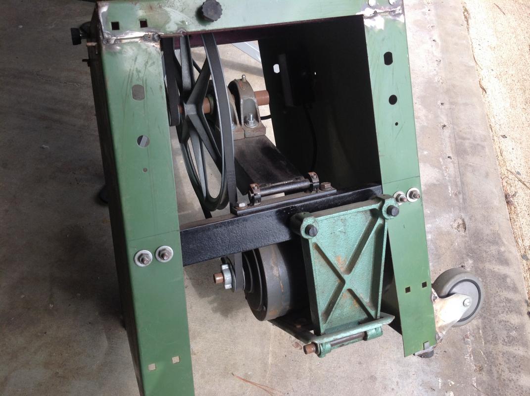

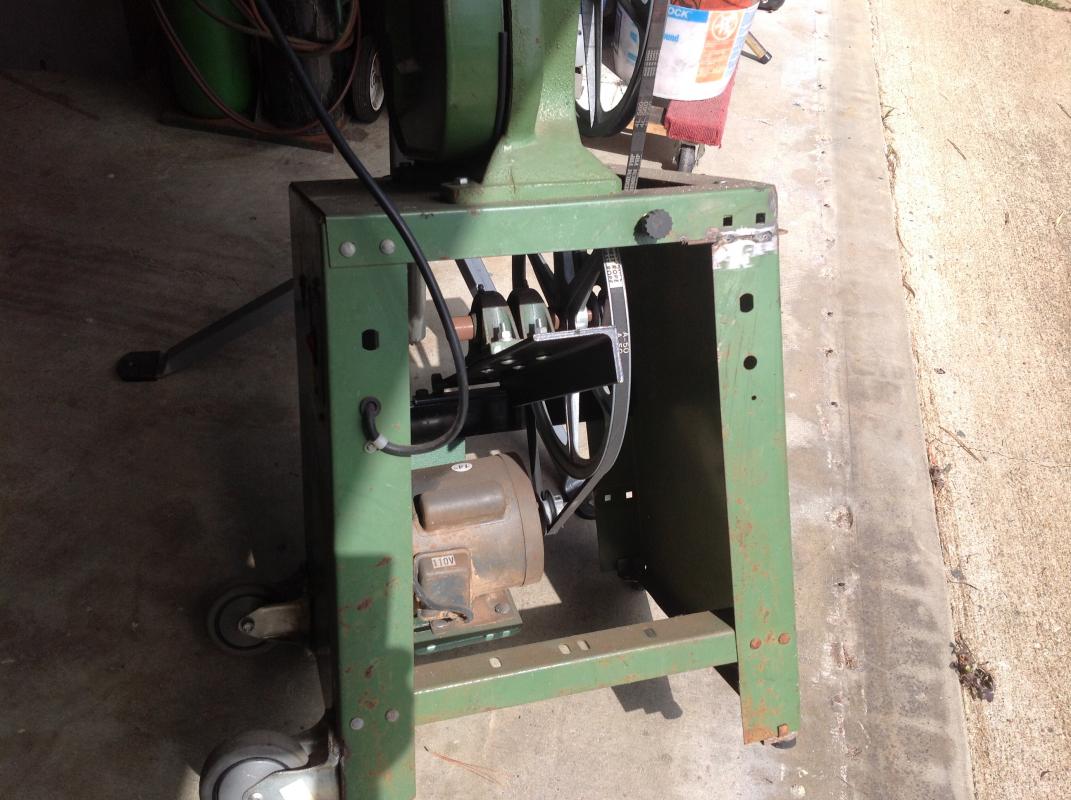

    I looked on one of the websites that you can plug in your pulley sizes and it turned out I needed to do a double reduction. It already had 1 3/4" on the motor and a 14" on the saw bottom pulley so going by the chart I'd be in the ballpark if I got another 1 3/4" and 14" and make a jack shaft/double reduction. This program even told me by my belt sizes. I also had some 3"x3" angle iron, 1" shaft and two 1" pillowblocks. I also had an old motor mount from a grizzly table saw that I got off of CL ended up being junk. The original motor mount is one of those nightmare things that stupid to tighten and get straight. So it was the first to go. Stripped all that out and made new mounts for the hanging old table saw motor mount. The idea was everything would hang off the saw drive pulley tensioning the belts. The jack shaft and motor. And you just lift up on the end of the angle iron jack shaft mount and pull off the upper belt then lower the motor to the floor and pull of the motor to jack shaft belt. Works slick unfortunately it's been all together now for several years but I tried my best to tilt it over to show some details. Here it is together with a belt guard I made out of some perforated aluminum I got from a artist who was moving. Sorry about the paint, I never seem to get to that.
    Guard off, looking down at the jack shaft.HFT 14" bandsaw mod-image.jpgHFT 14" bandsaw mod-image.jpg

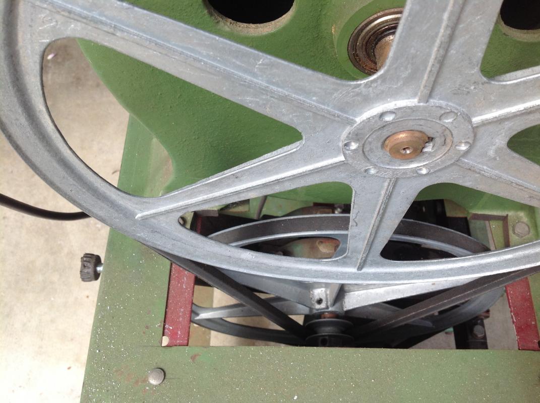

    Note the red angle irons on the sides of the cutout hole under the feet of the saw body. That got pretty weak when I cut out that hole so I bolted those braces in there and stiffened up.HFT 14" bandsaw mod-image.jpg
    Here's the opposite side.

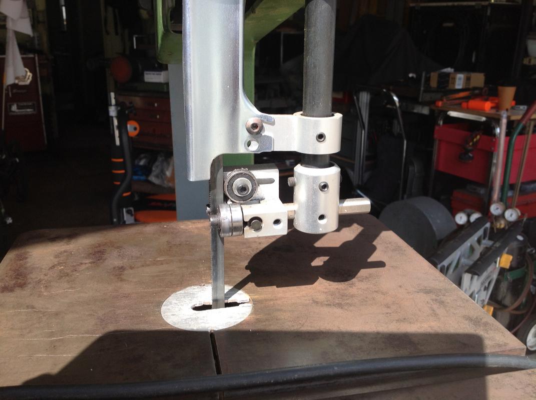

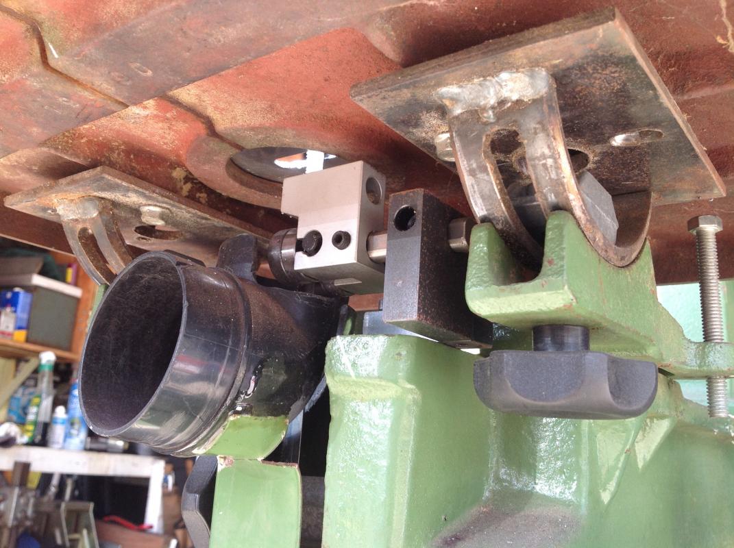

    I think I was getting to some critical mass with the pix so I'm continuing on....
    This is a shot from the same side as the last pic but I wasn't sure you could see the angle sticking out that the jack shaft is mounted to. This end just floats, the pivot being right above the motor. So this is what you grab and lift to loosen the top belt, and let down to rest the motor on the floor to change the bottom belt.
    HFT 14" bandsaw mod-image.jpgHFT 14" bandsaw mod-image.jpgHFT 14" bandsaw mod-image.jpg
    I think I've maxed my limit of pix tonite I'll try and see if a couple more details can make it on here tomorrow.

    The photos definitely help explain your modifications. The weight of the motor provides the belt tension. Buying the blade guide gets you running right away and probably one of the most important parts.
    Thanks for posting the photos. Lots of great ideas.

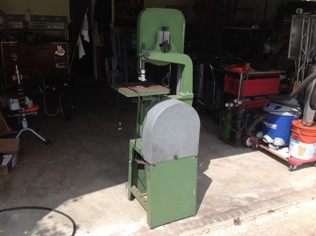

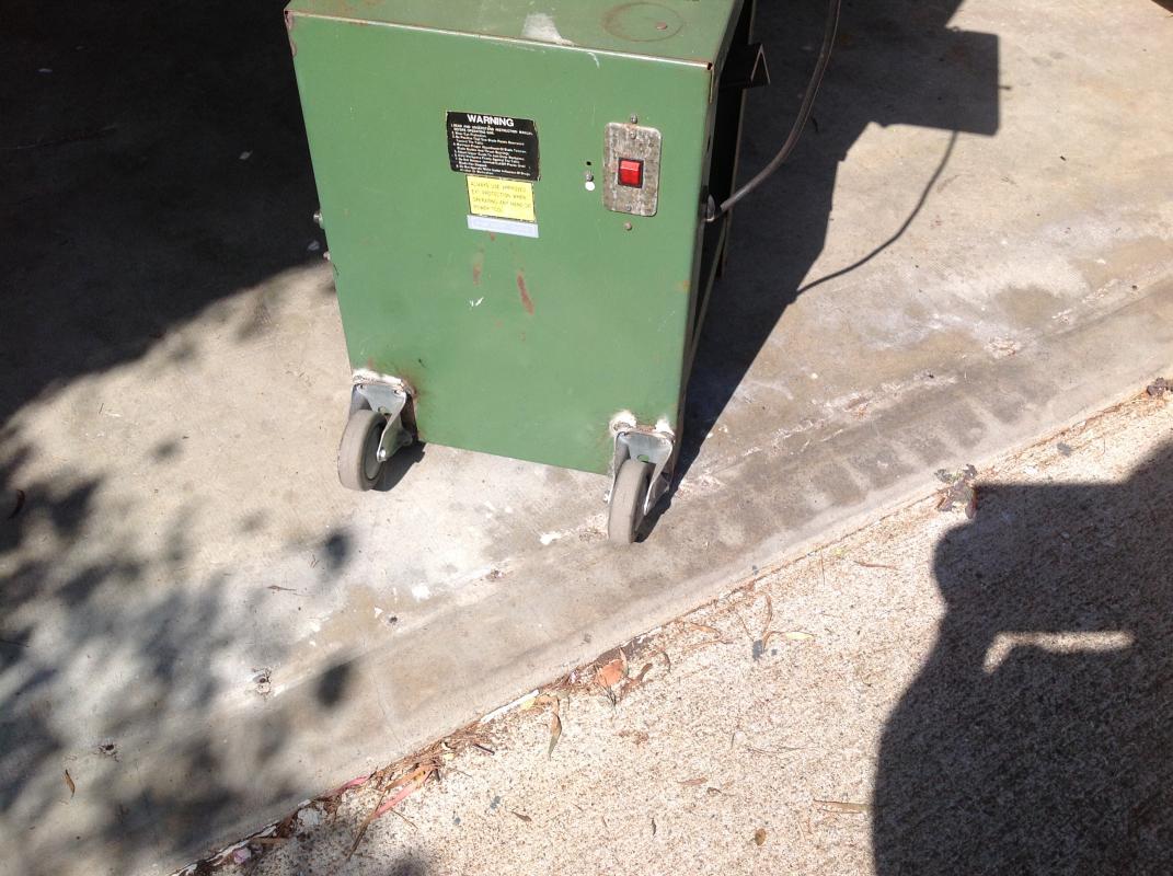

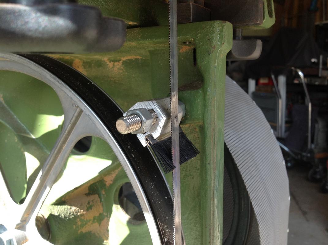

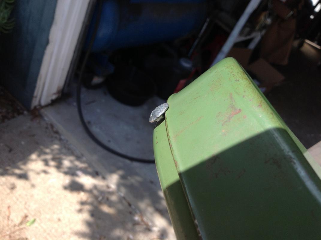

    I'll try to finish up and see if the server will let me upload these last pix. As all my machines this one has wheels so I can tilt it and move it wherever I'm needing. Because I work out of my garage I have to push all the unused machinery out of the way when not use and then redeploy when needed. And in order to grab the top of the saw where the upper wheel guard is and not collapse the guard and rub on the blade wheel I put 1/4" carriage bolts as stops.
    The other key to tracking and tire longevity is keeping schmootz off the tire so the metal cuttings don't embed themselves into it and cause the tire to deform. I had an old brush laying around from some fruit packing machinery so I incorporated it into the lower guard mount.HFT 14" bandsaw mod-image.jpgalong with a modified vac elbow mounted to the bottom guard.HFT 14" bandsaw mod-image.jpgHFT 14" bandsaw mod-image.jpg

    Thanks Paul. It's always tough to try and show what's in such a confined space without taking it apart.
    While I agree the two all ball bearing heads have a lot to do with tracking, the real problems I think we're the rubber tires and especially the tensioner/tracking adjuster. It was mangled and the tires were a mess. But the good thing is this is such a direct knockoff and such a popular saw, it was not only easy to get good after the market parts but they were cheap!
    I never really tried to use the saw in its original condition he just ran it when I bought it and that was it. When I got it home that's when I noticed the tensioner/tracker was broken and the tires were a mess. And I hate those old friction style heads and liked this all sealed bearing setup on Rockler so I ordered all the parts at one time while I started hacking and fabricating. The heads were over $200 IIRC and the rest of the pulleys, tracker and belt didn't come to more than $50. So the heads cost me more than the whole saw and repair parts. But I feel it was worth it. Especially when you see the EXACT same saw billed as a metal cutting saw for around $1500! I think I figured when it was all said and done I had somewhere around $350 in it.
