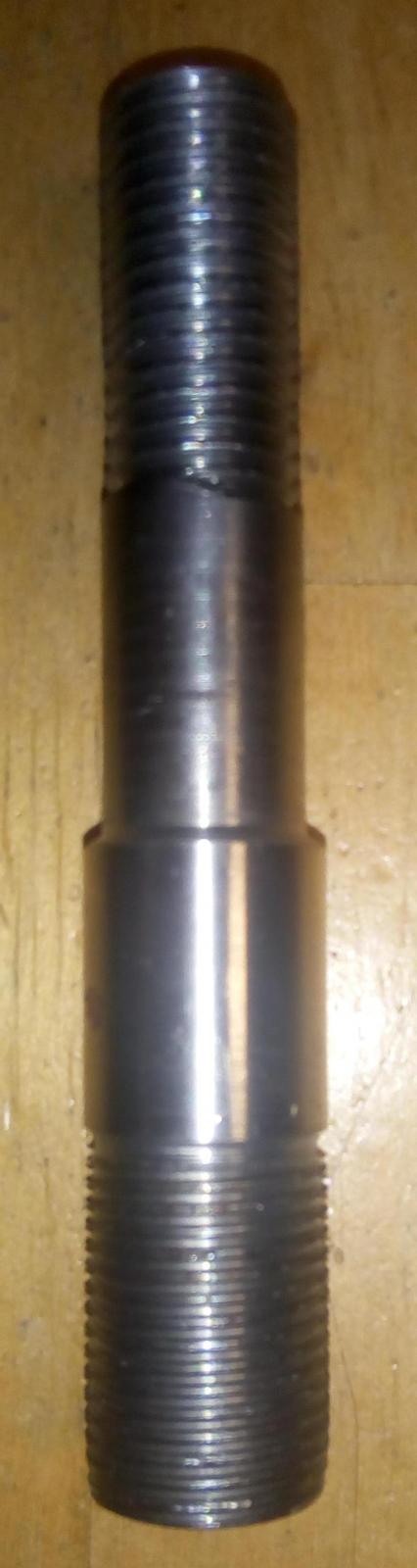

I made this adapter out of 0.750 drill rod and it worked great!
Don't tell anyone, but I had to make two adapters, part way through the batch of holes something shifted and the die jammed, bending the first adapter into an artistic, but less than usable curve.

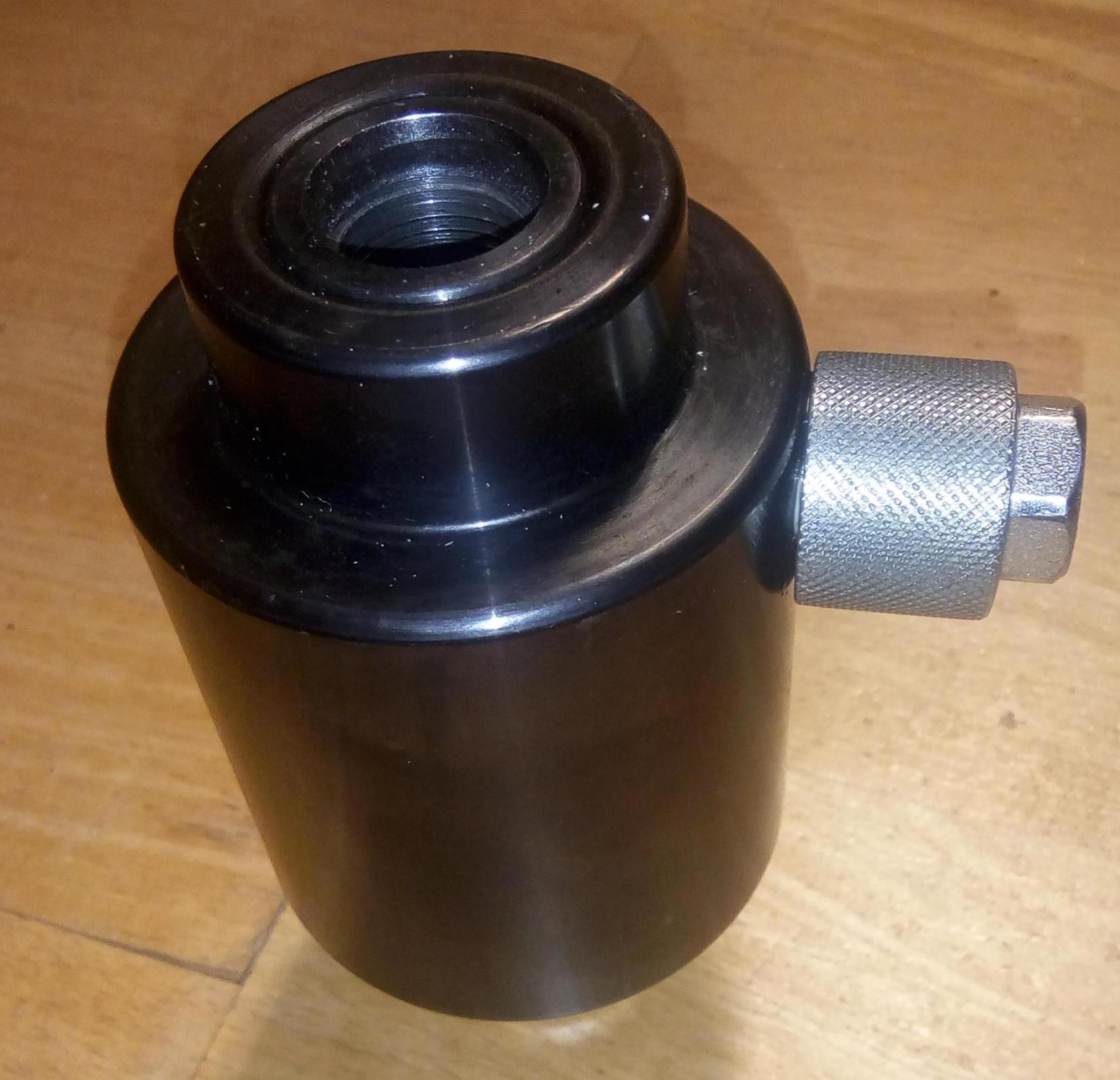

Puller
Attachment 29807
Adapter
Attachment 29808

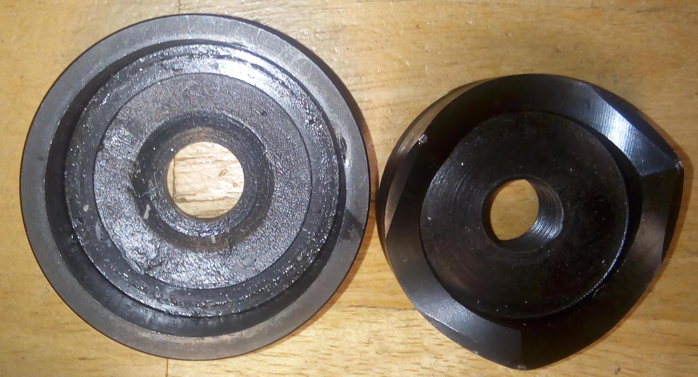

Punch and die hardly showing wear
Attachment 29809

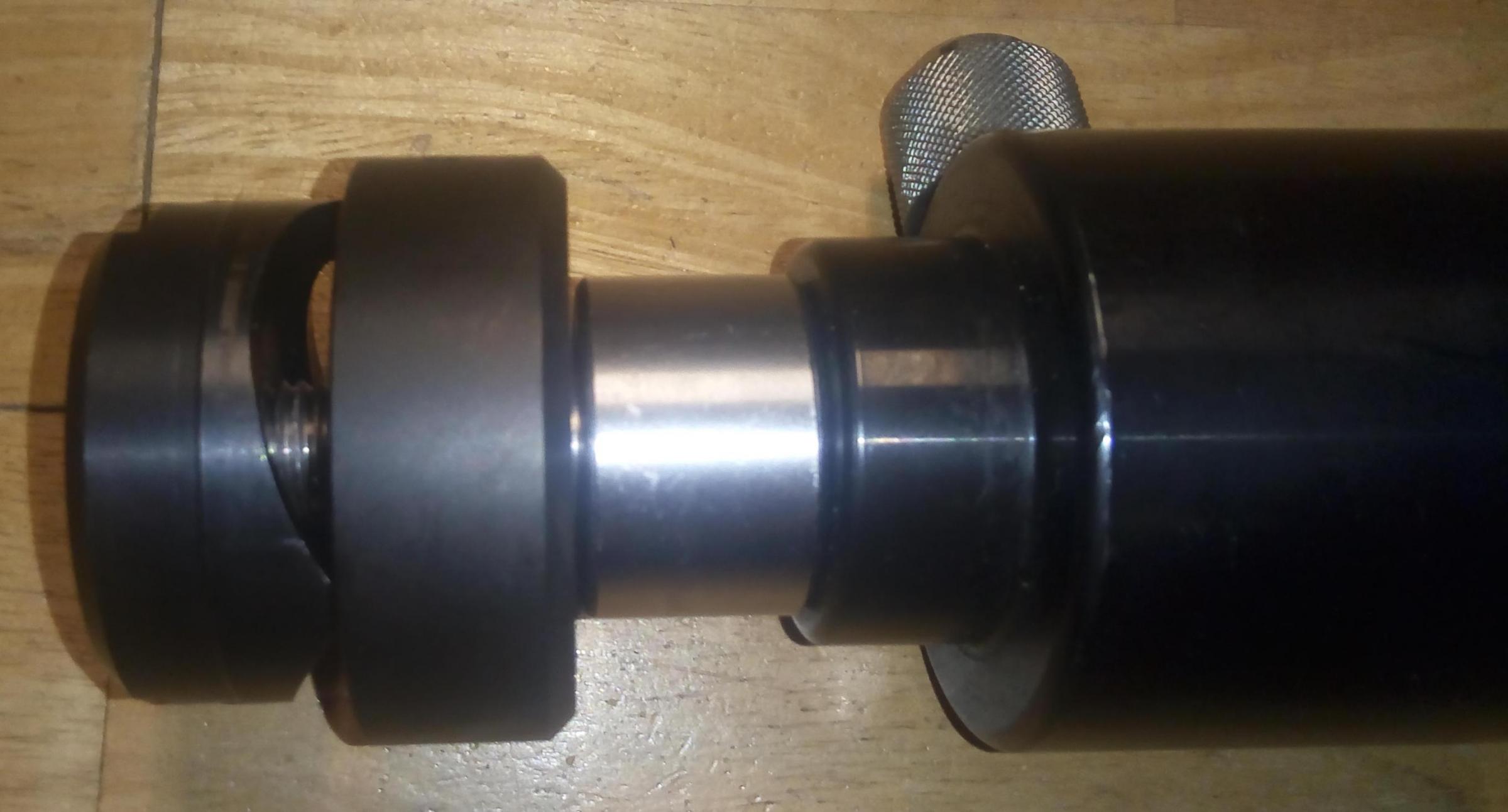

Partly Assembled
Attachment 29810

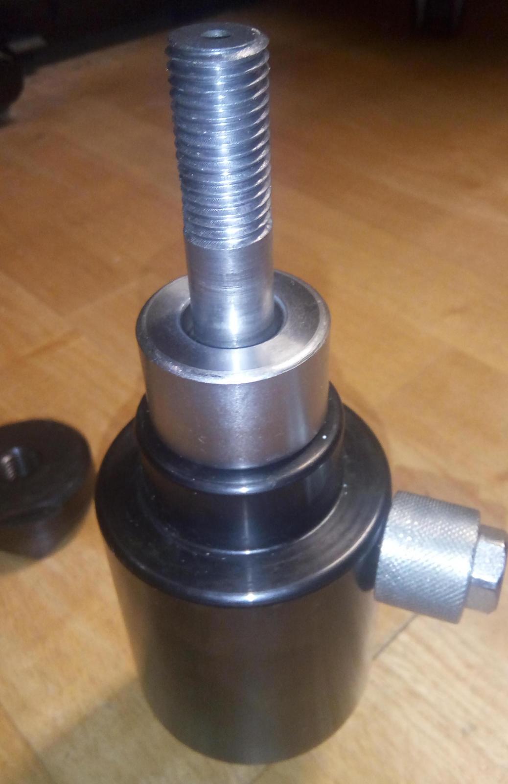

Ready to pull
Attachment 29811

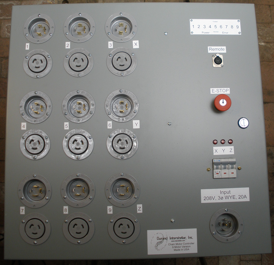

Part of one finished unit
Attachment 29812
